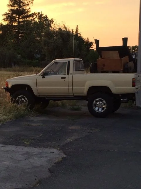

Great! Now I feel self conscience about my 2.5" lift and 31's... Thanks...LOL! :D:D
-Daniel Kent
Love me my little roller skate!!
That's a sexy truck! What colour code is that?
Thanks man!
I feel like it looks more bronze than it really is cause of the sunset, but it's what I call the "typical tan" on Toyotas. I'm honestly not sure what the color code is but it's a very common color. Is the code in the vin?
If you look at the sticker under the hood on the fire wall in the middle behind the engine it will have the transmission and axle code. There is a part that says c/tr and a 4 digit number that follows. That number is the colour code.

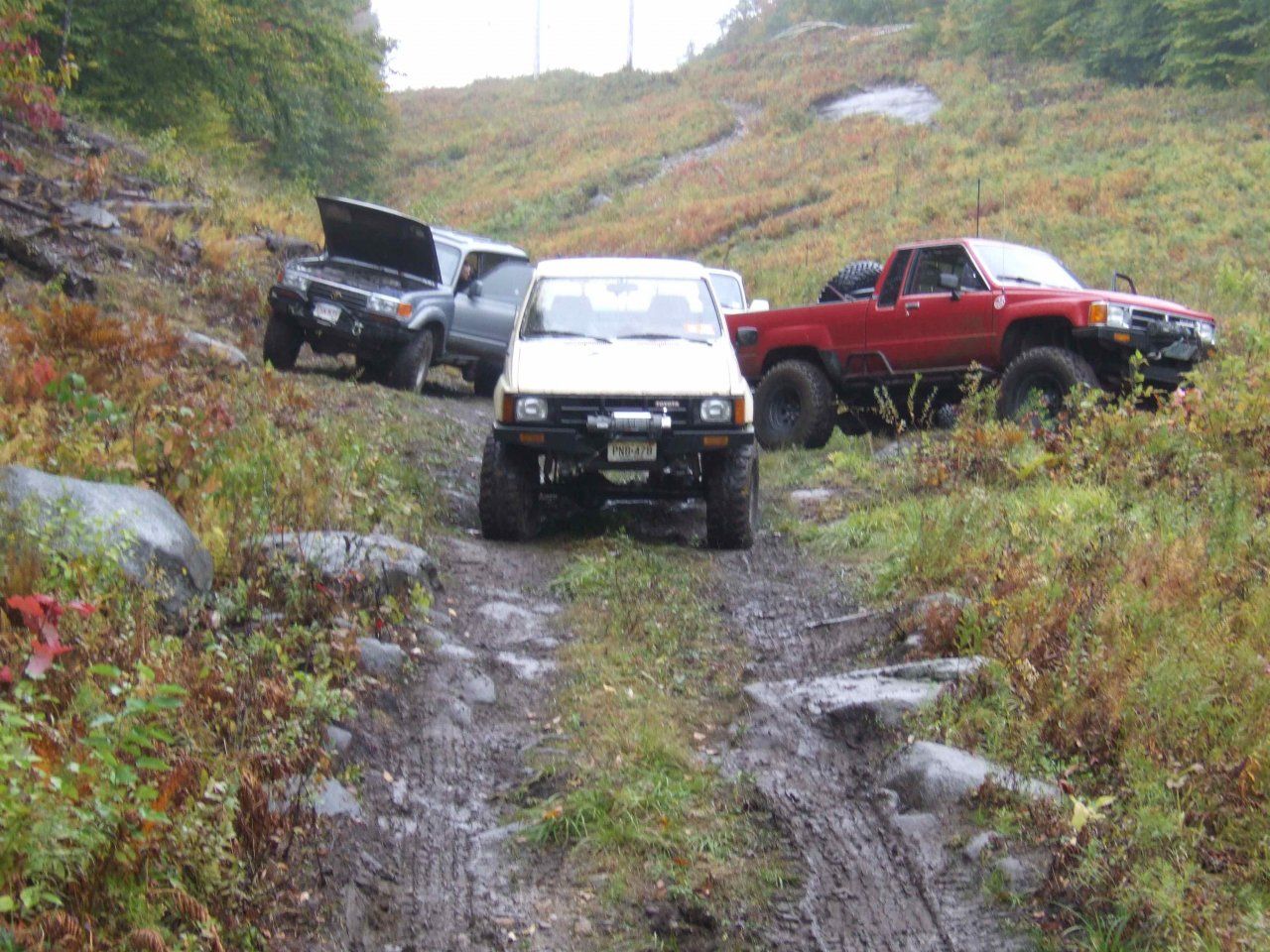

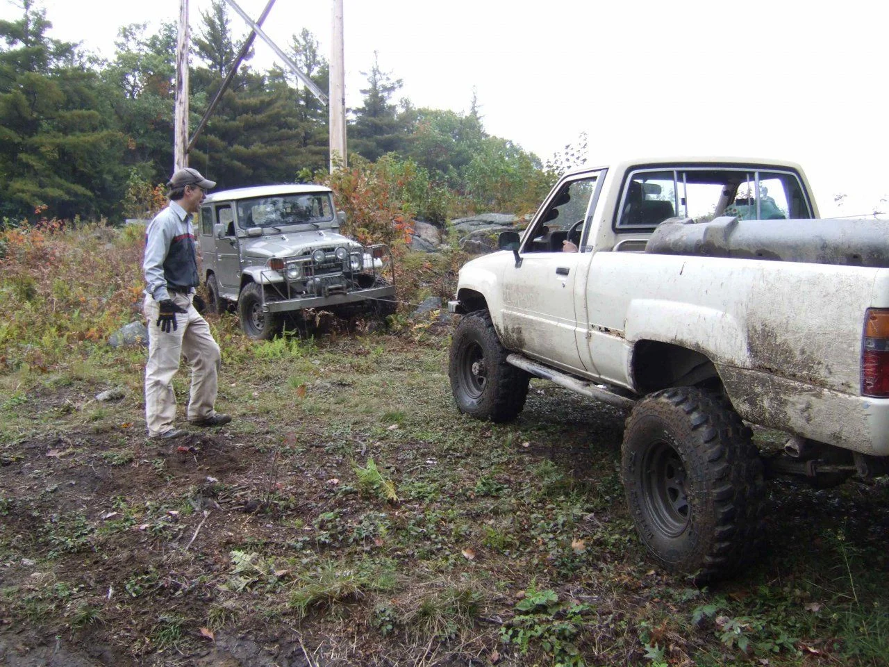

KLF's at Fall Gathering 2009 on the right, mine in the center facing the camera ...
And delivering the bad news that my rear driveshaft was no more ...
