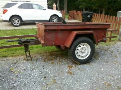

Well I bought an M416 trailer on a whim. Always have thought they look pretty cool behind an FJ40, so when one came available within 60 miles of my home, I jumped on it.
Plan is to hit with Rust Bullet and paint in same 6H9 paint as truck. Maybe paint the rims black. Below is a similar trailer I found on web. Obviously different color and I probably wouldn't put the stencil markings all over it (although very cool).
The 40 remains 1st priority, the trailer will come last. :D
