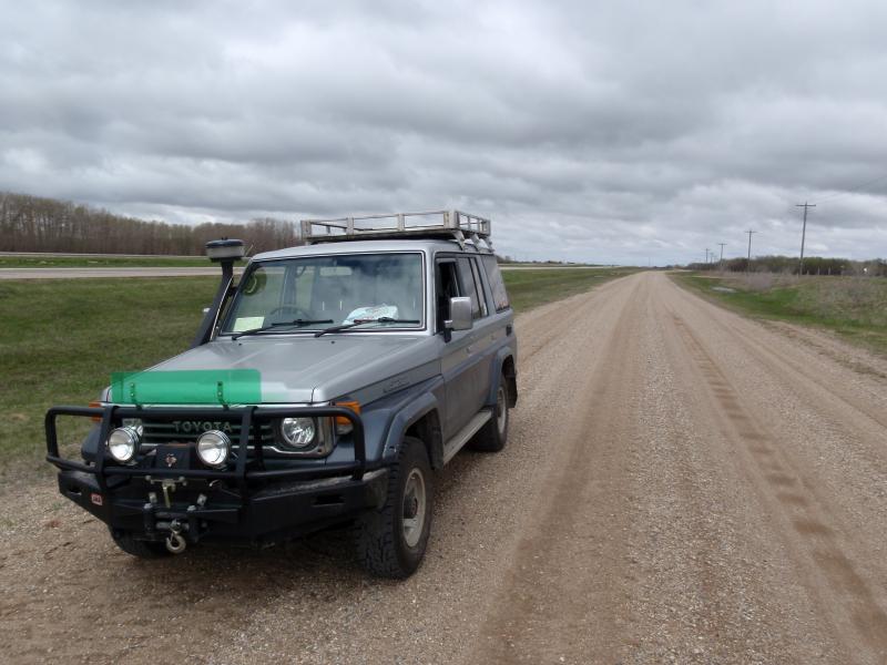

some pictures from driving it home after purchase. So far it's great driving and the last time I measured fuel consuption I got 10.33L per 100Km
Very nice ,
A new set of leaf springs and your set
That's great fuel comsuption ,you guys seem to get A bit better fuel Eco than a few mates here in Aus with 75s,79s
Yes it is a Japanese spec. I love it but the I think if I had the choice I would choose white, mostly so it couldn't pass for a prado to an untrained eye.
