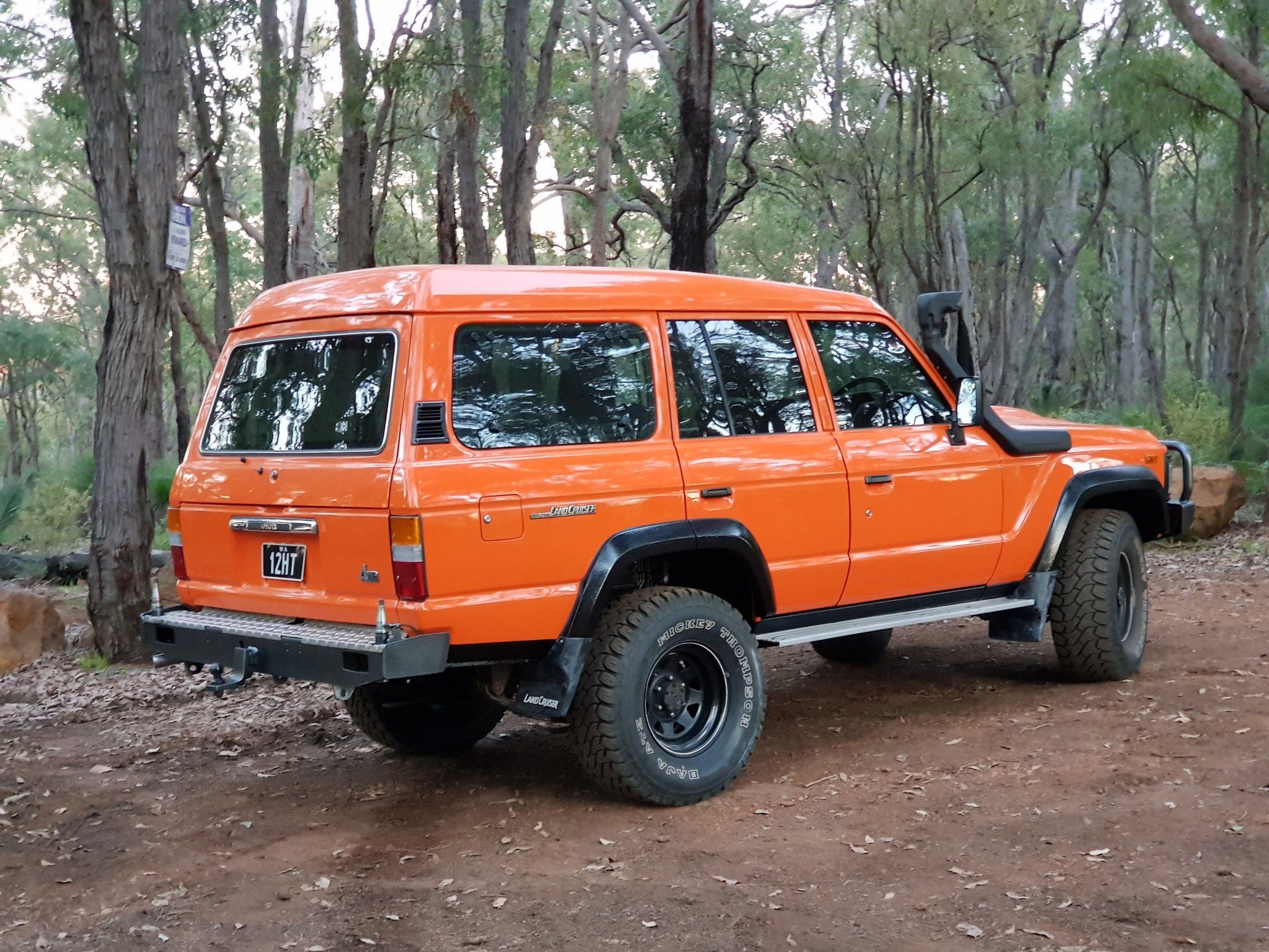

So I'm finally back home for a while and I've been able to get some tool time. Over the past week I've got the following fitted:
  • Rear bar fitted
  • Flares
  • Side steps
  • Headlights and indicators
  • Grill and headlight frames.
It's now at the stage where it can be driven on the road. As always, I'll just let the pics do the talking.

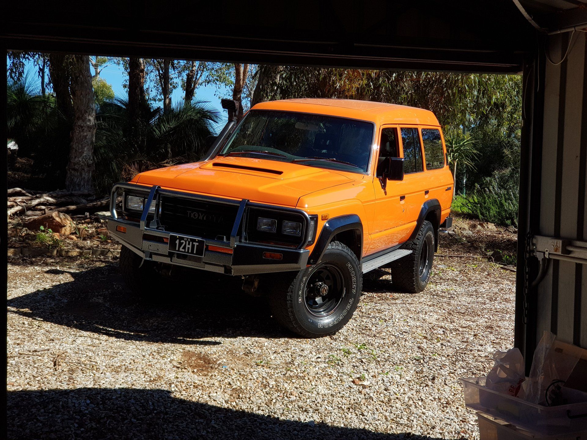

Time for an update. So now that the 60 is back on the road, I've been concentrating on getting some of the little things done. First up is some additional instrumentation, which is pretty much essential now that I'm running the new turbo.
For now I've just fitted the boost and EGT gauges under the dash, as this was an easy option. Ultimately I'm intending to fit a 3-gauge pod on top of the dash, which will include the oil temperature gauge.
Obviously it's not the best spot, but it'll do for now and at least I can ensure that the EGT isn't getting too high.
And yes, I'm aware that my dash needs a good clean!

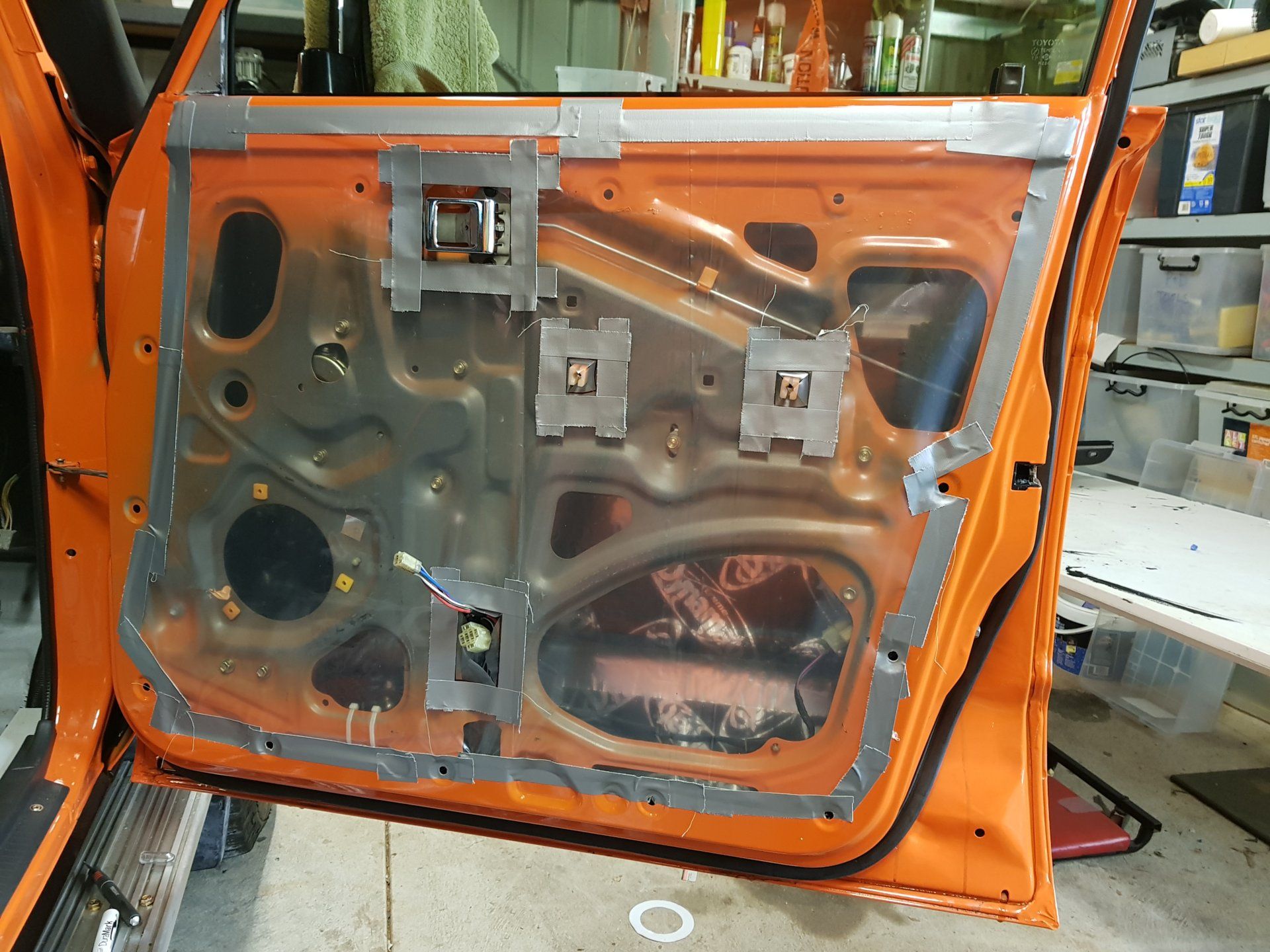

When I got it back on the road I was kinda rushed and didn't fit the door cards. Time to do that now.
I'm not really sure what's the purpose of the plastic lining that's fitted from the factory. Keeping moisture out? Noise reduction? Anyway I redid it. I used gaffer tape to attach it rather than the original sticky butyl mastic.

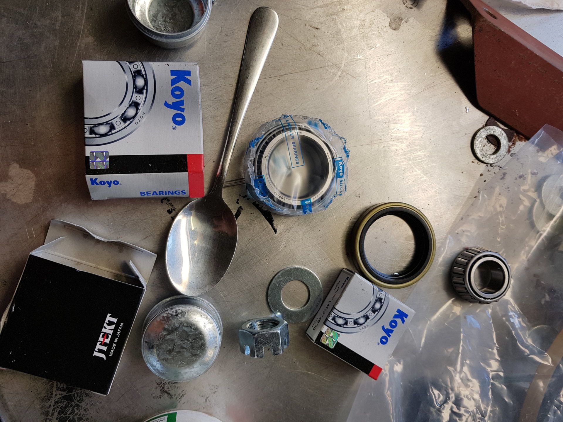

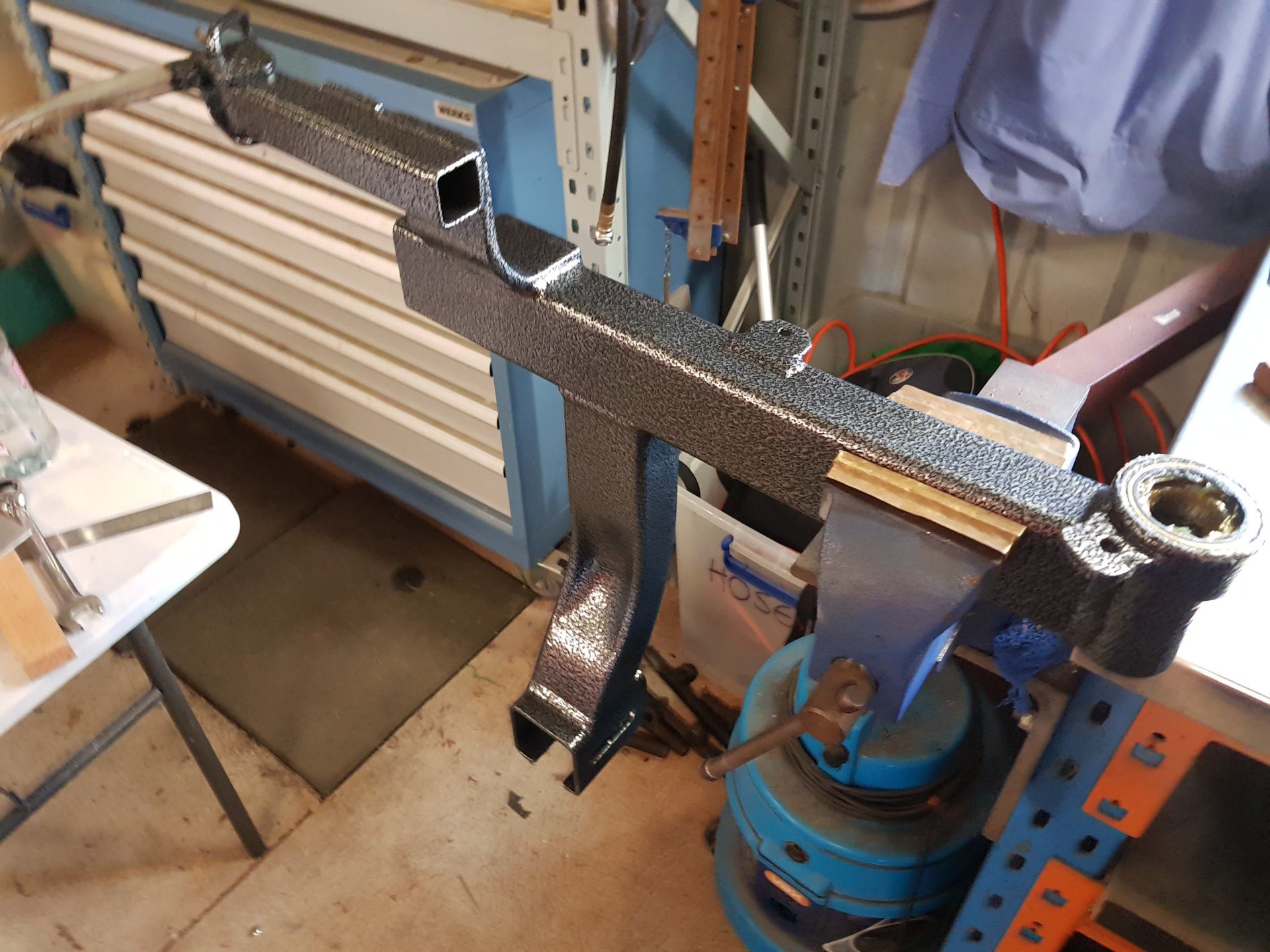

Time to complete the Kaymar rear bar by fitting the swing out wheel carriers.
New bearings and seals:
New studs for the wheel mounting plates:
Assembly:
One side done:
The other side done:

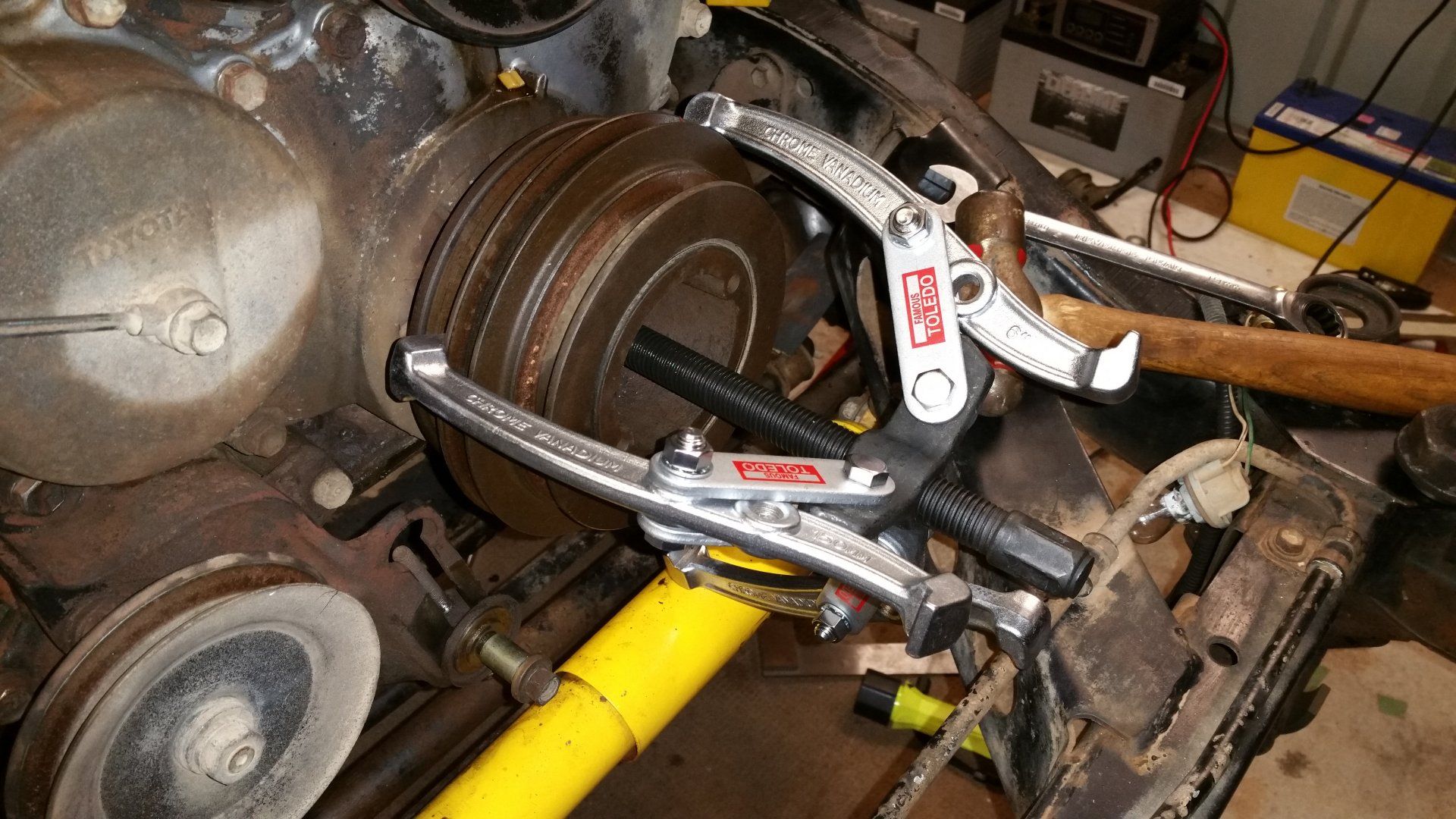

Next job was getting the front oil seal replaced. This was pretty easy with a decent puller. It took me all of an hour, including polishing up the sealing surface with some 600-grit paper.
The old seal was pretty much stuffed and was definitely the source of the front end oil weep.
New seal ready to go in...
Naturally I don't rely on torque alone for anything this critical. A liberal dose of Loctite 262 was applied to ensure that the pulley won't come off until I (really really really) want it to.
