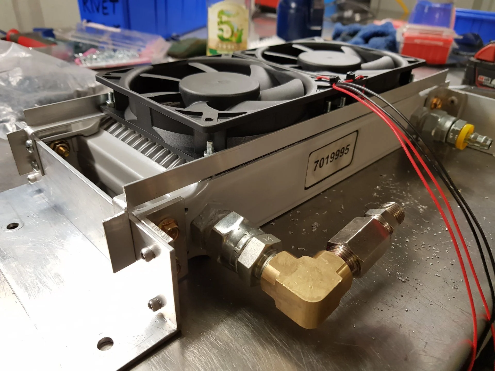

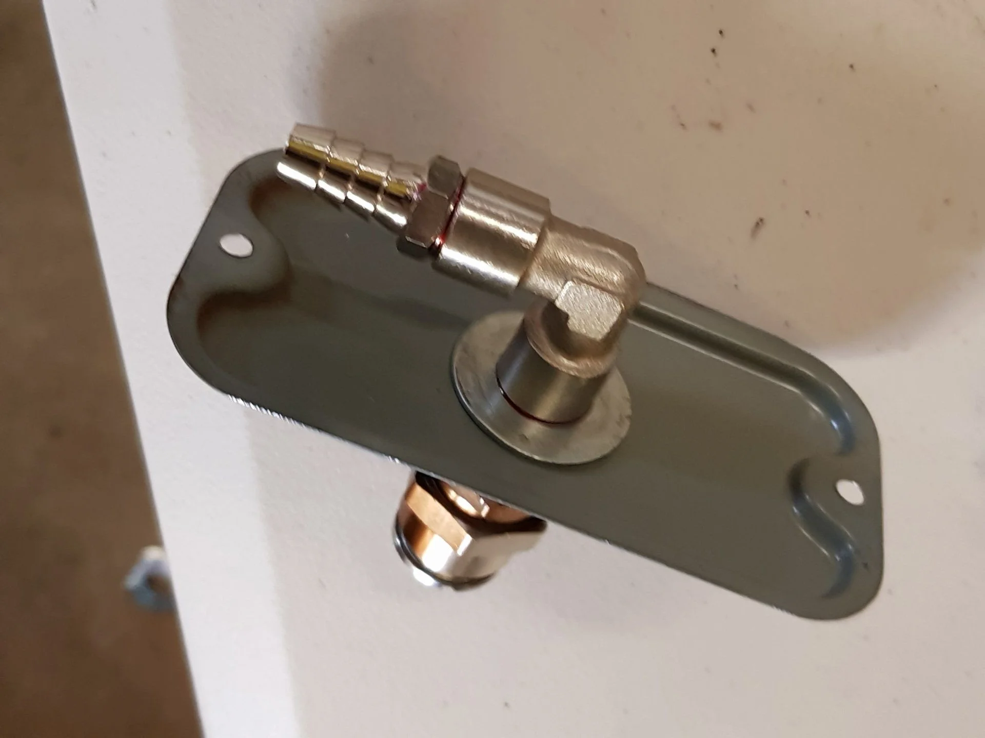

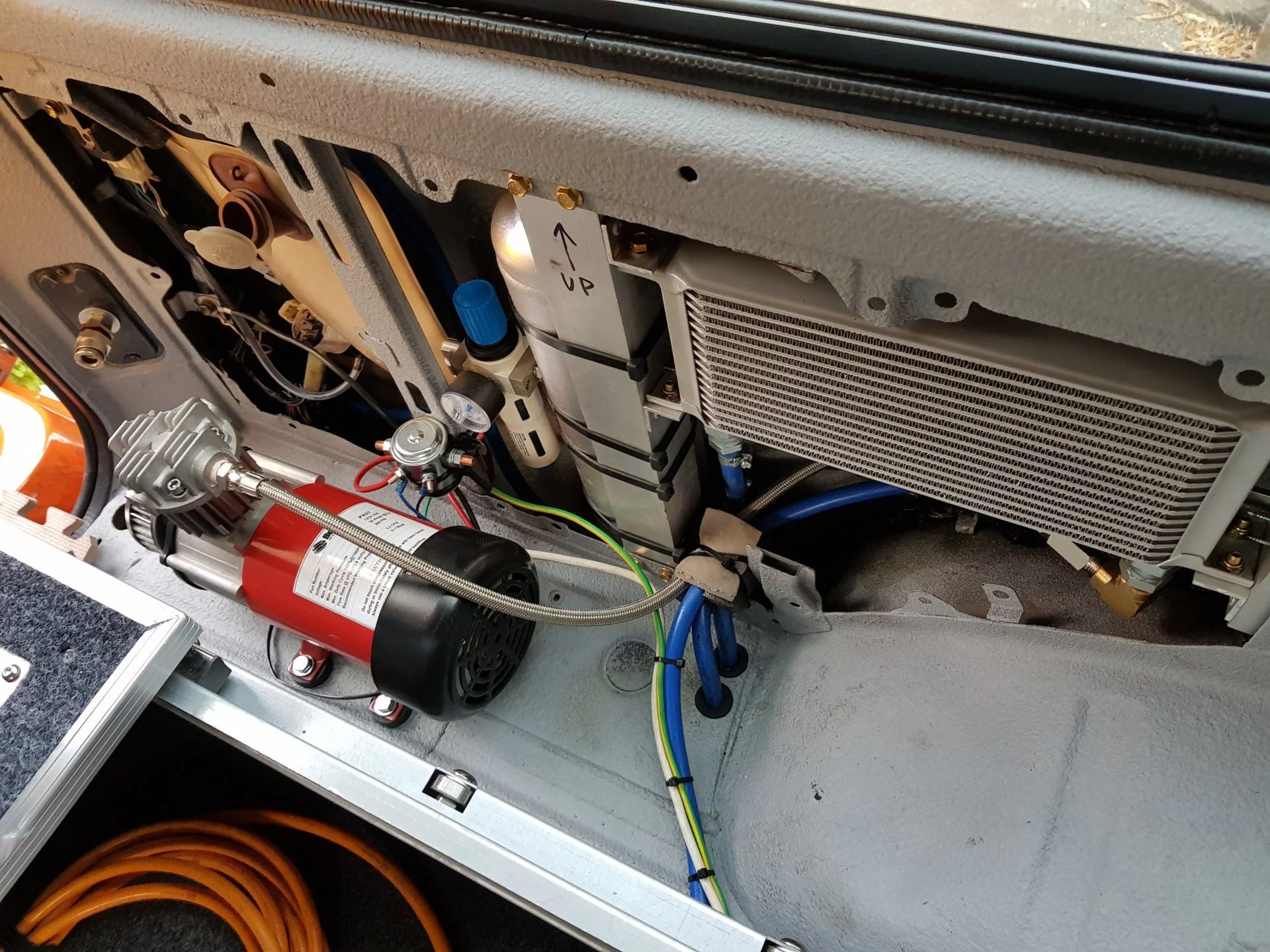

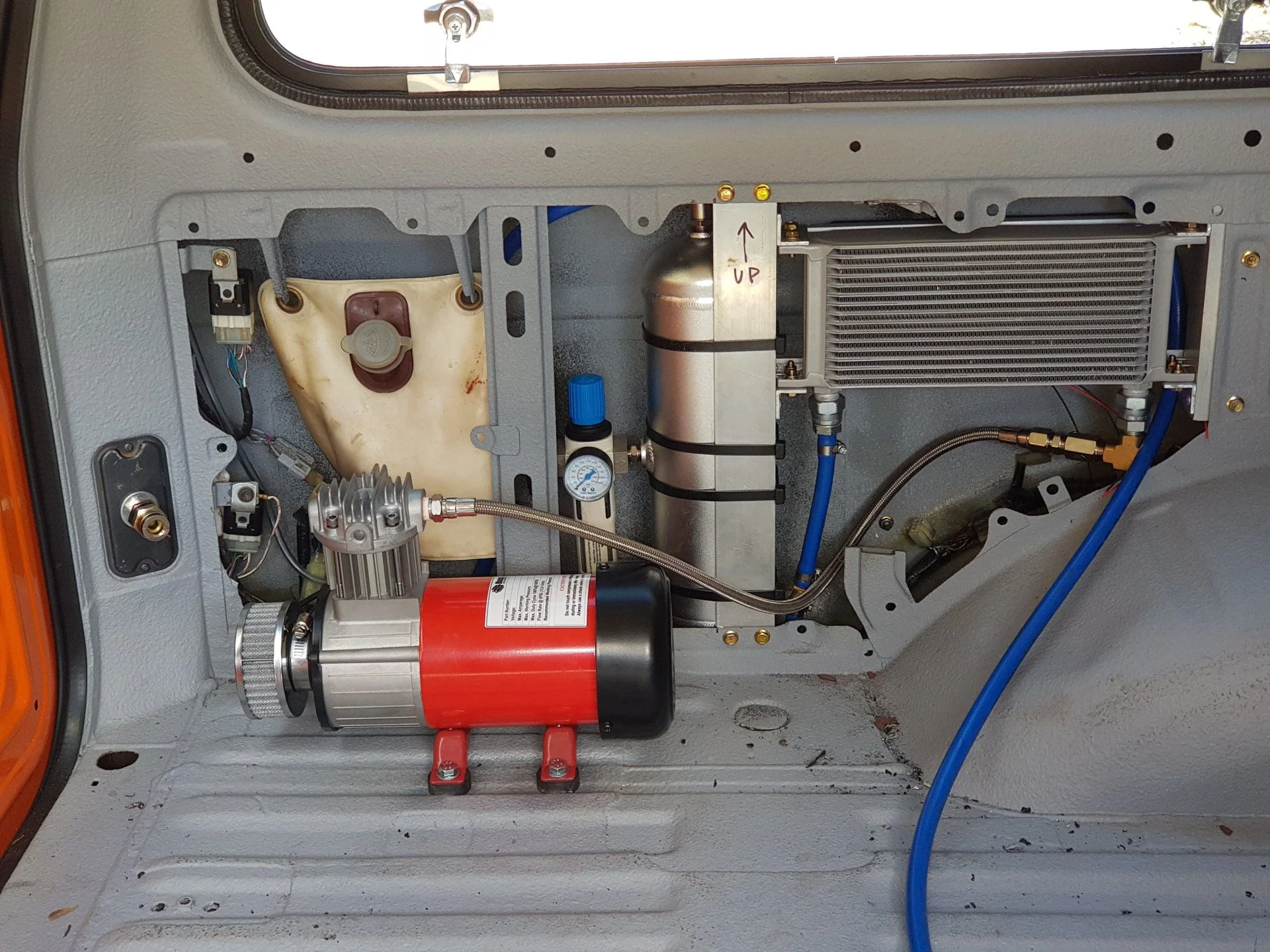

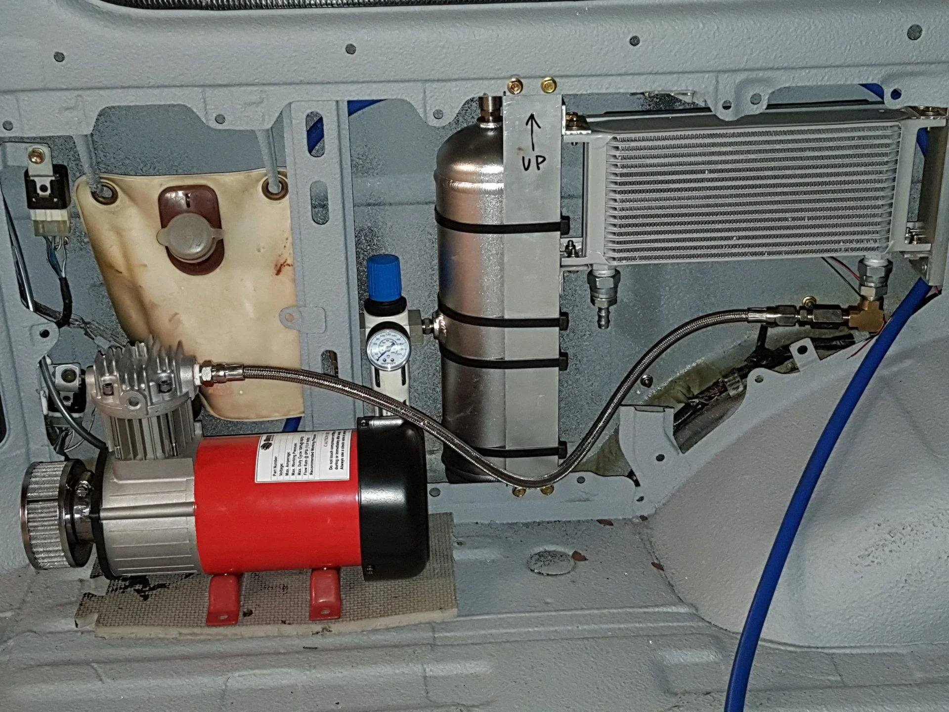

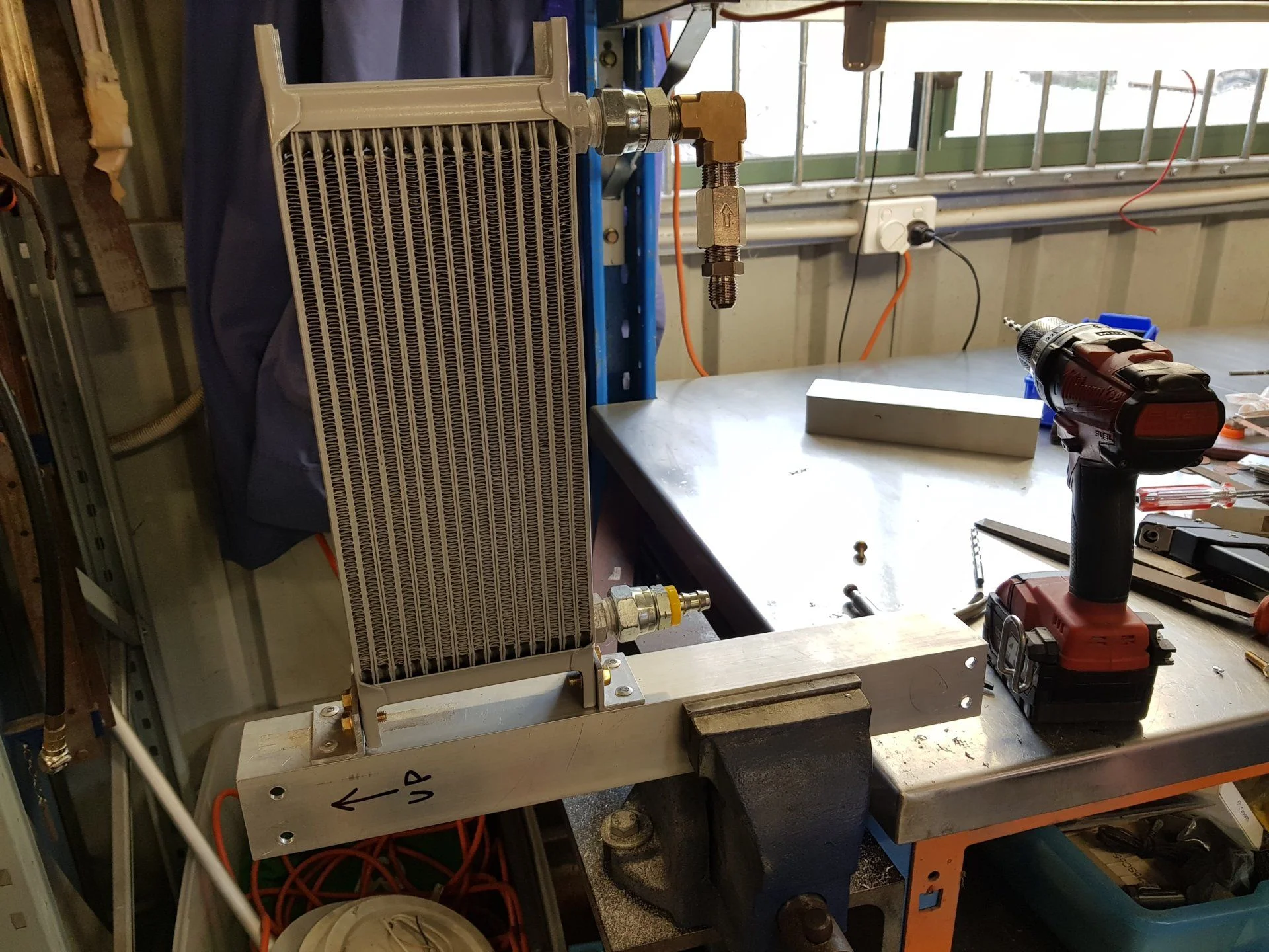

Let's start with a wrap-up of the air system. I really wanted to have nice clean and dry air for my system, especialyl with all the solenoids now on board, not to mention the air lockers. It always used to trouble me how the catch can for the air locker solenoid discharge would gradually fill up with oily condensate. That can't be good for the internals.

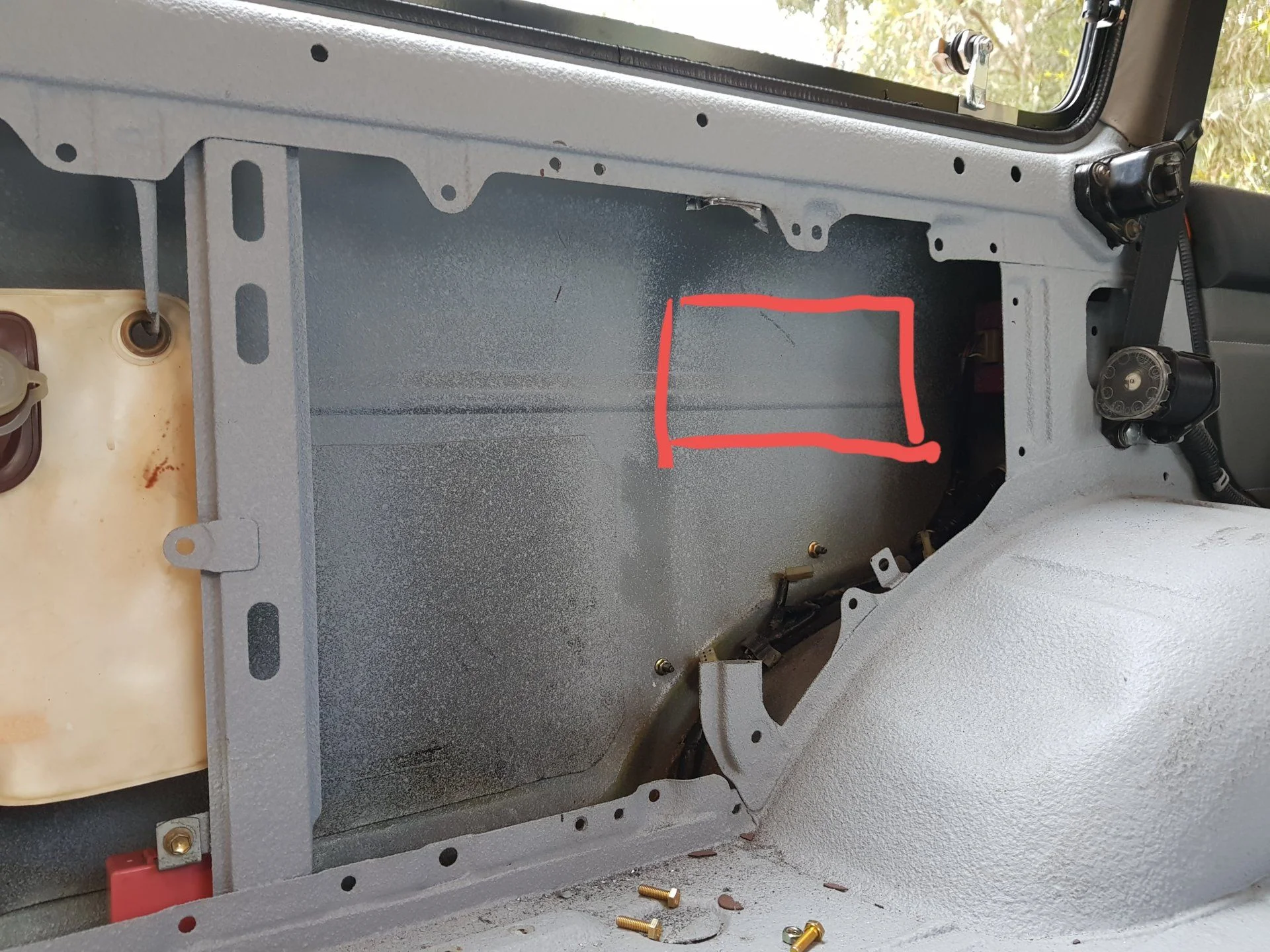

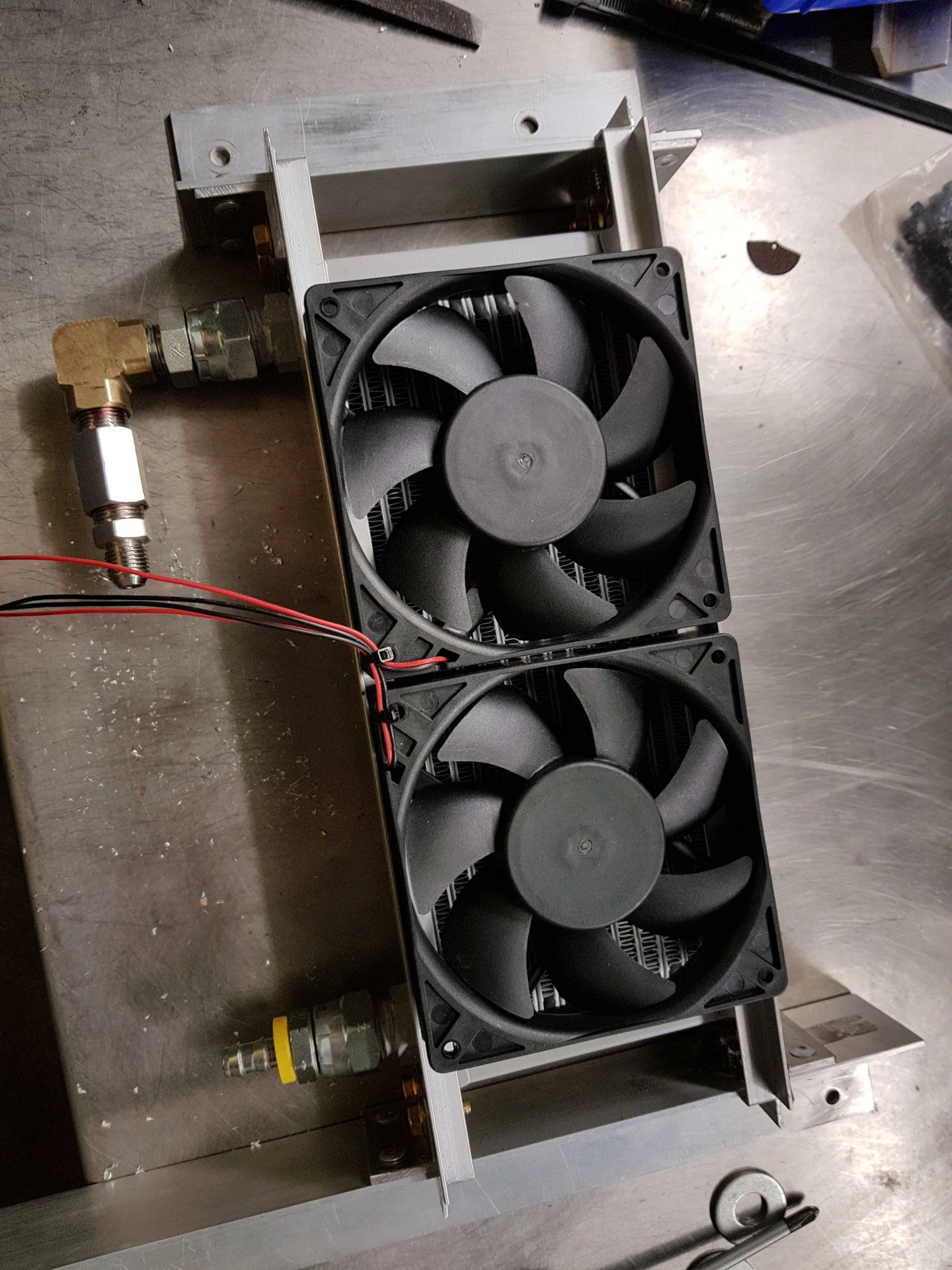

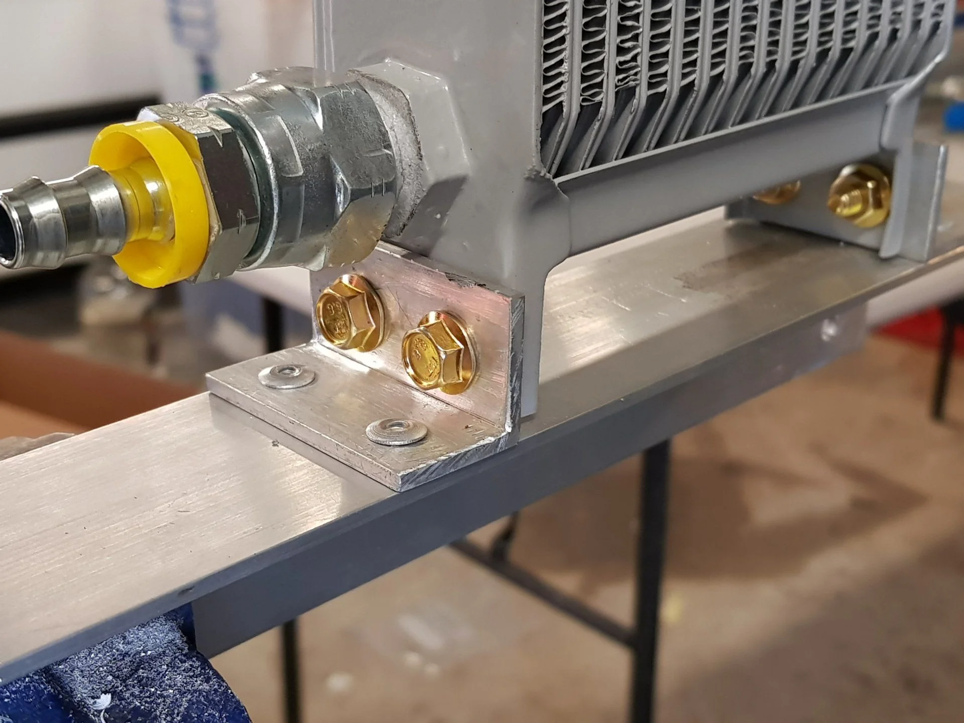

The main item to alleviate this is an aftercooler. I wanted to have this immediately after the compressor. There isn't such a thing readily available (that I was able to find) so I struck upon the idea of using a small oil cooler. That's what the last photo above is. It's tucked up inside the left rear quarter panel:

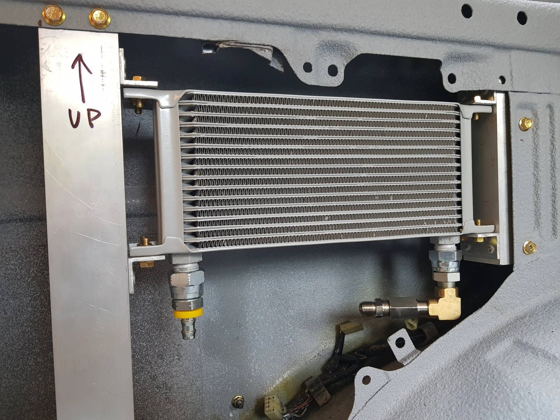

Here it is fitted into the quarter panel:

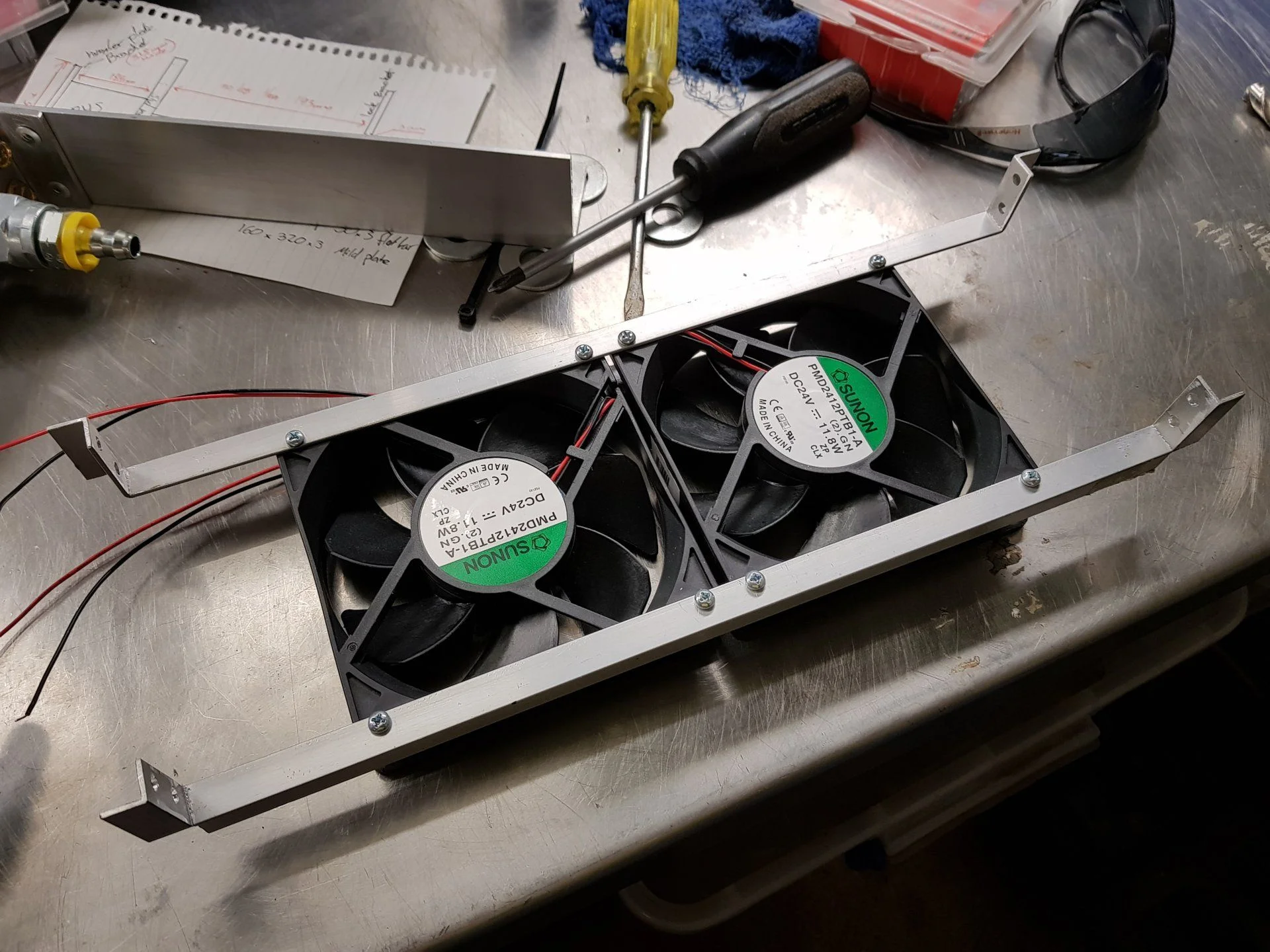

Obviously putting it in this location is great for space utilisation and to protect the cooler from getting knocked about. It isn't however that wonderful for airflow. I really want this to pull as much heat and moisture out of the compressed air as possible, so it needs some forced air flow. I found a couple efficient 5" fans to mount on the back side of the cooler.

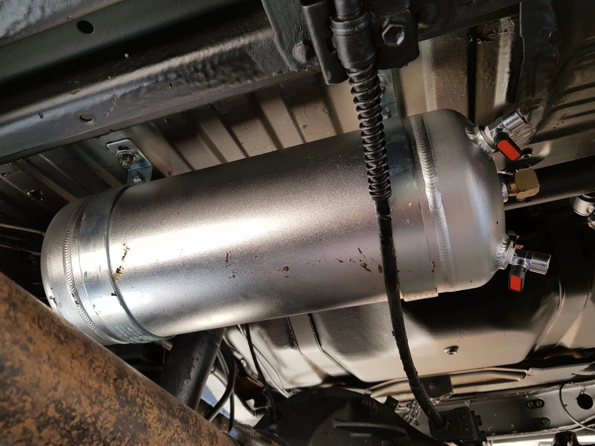

I'm kinda geeking out with this! So here's it is all fitted in alongside the secondary air tank:

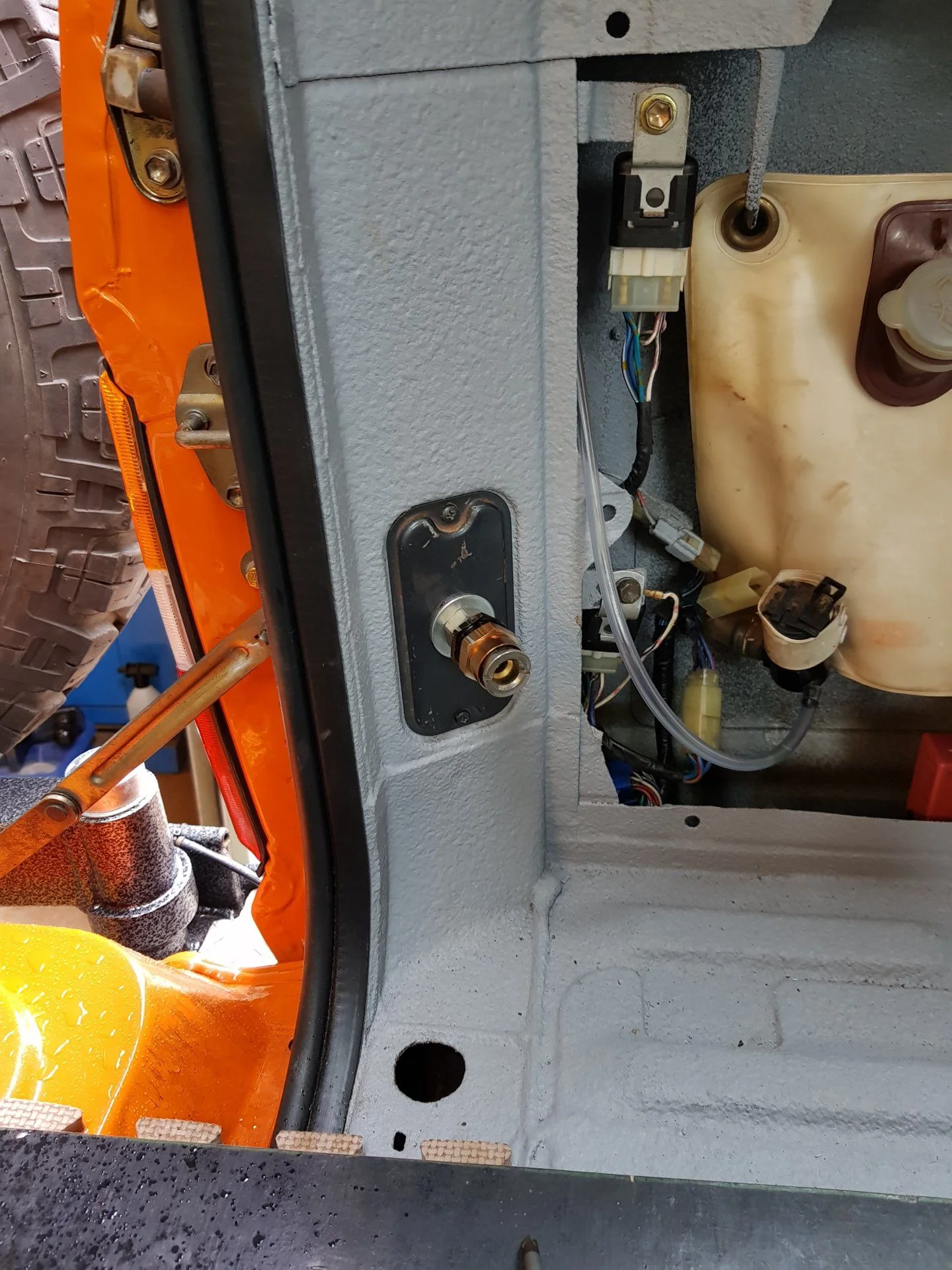

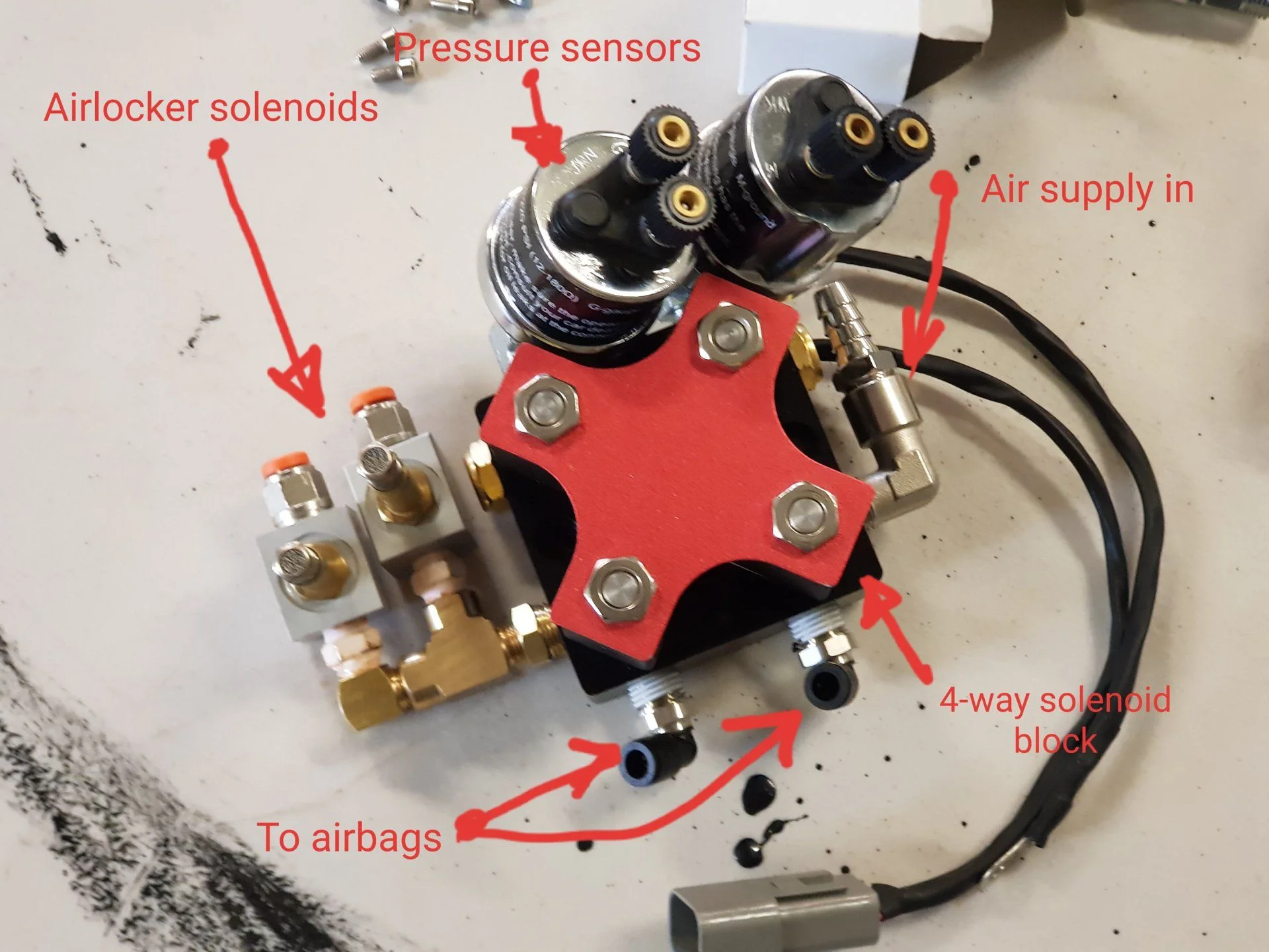

The right quarter panel houses the control solenoids. I bought a pre-made valve block for the airbags with raise and dump valves for both sides. Onto this I fitted the air locker solenoids and also pressure sensors to drive the remote display for the airbags.
Here's a quick video. Obviously it's not quite finished in this clip but you get the general idea.
The wiring was all pretty simple and only took a couple of hours. Connecting all the elements together with heavy duty hose was a bit more work but nothing too complicated. Here's the airbags going up and down :bounce:
Here's a shot showing everything pretty much finished on the left side.

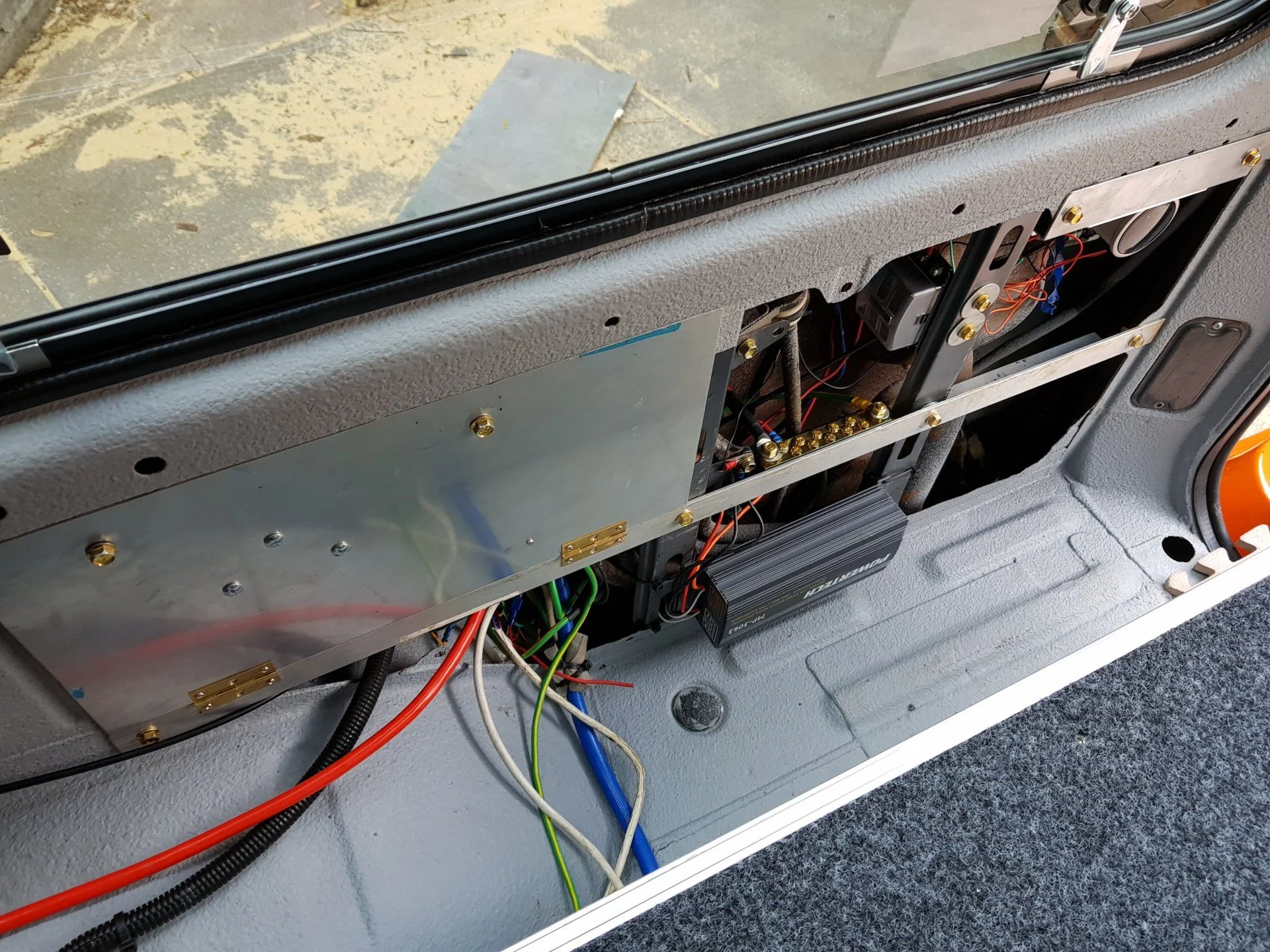

The right side is a work-in-progress still and needs some tidying up. But it's all working at least.

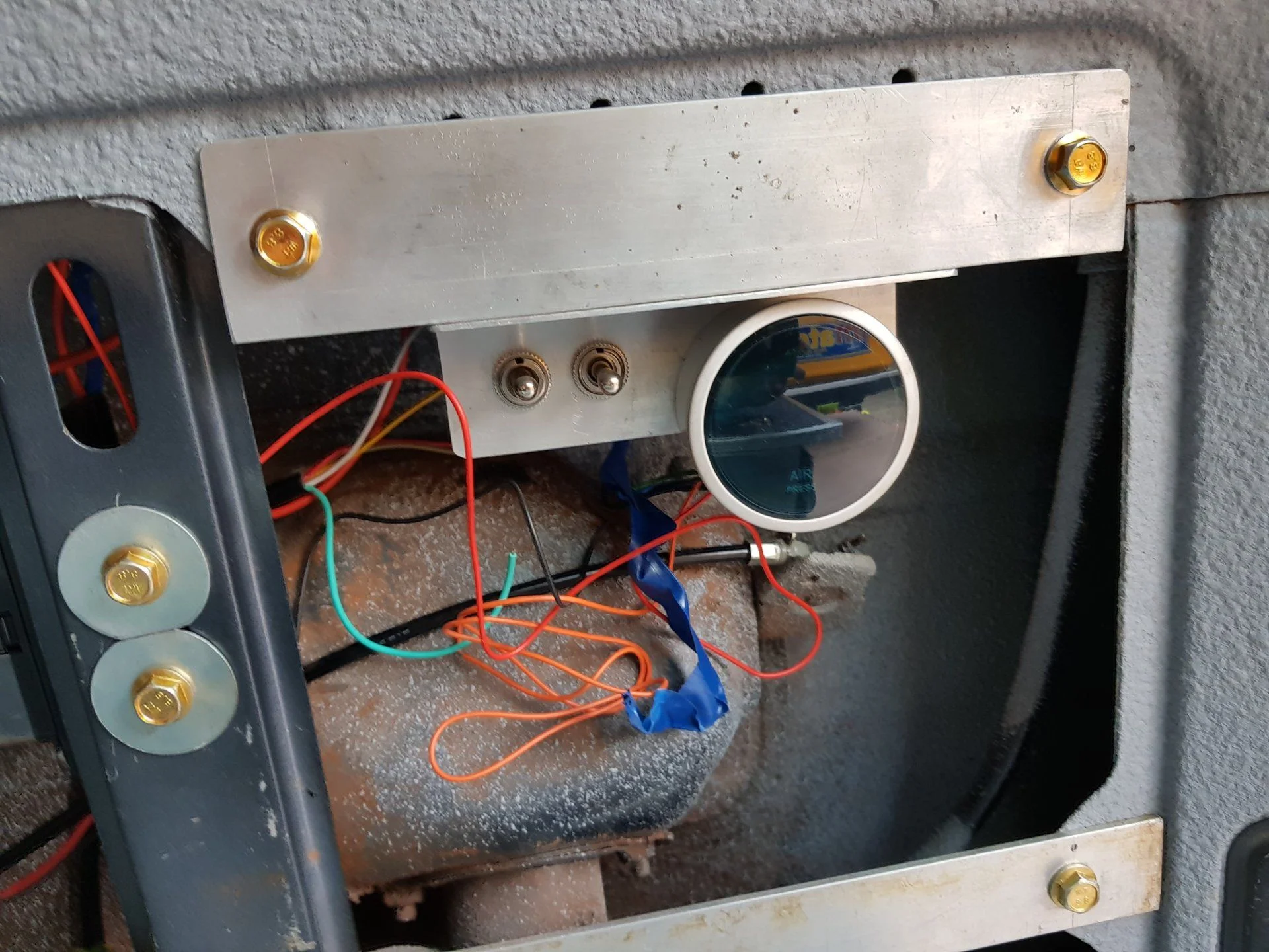

At the moment I've put the display and operating switches for the airbags just inside the tailgate. I did intend to put these somewhere on the dash eventually, although this spot works ok for now. To be honest it's reasonably convenient, as it's easiest to check the ride height and perform corrections when looking at the rear from the outside. So maybe they'll just stay here. I'll see.

Looks nice and tidy. So you will now have colder air going to the tank, or do you have an oil and water separator first?

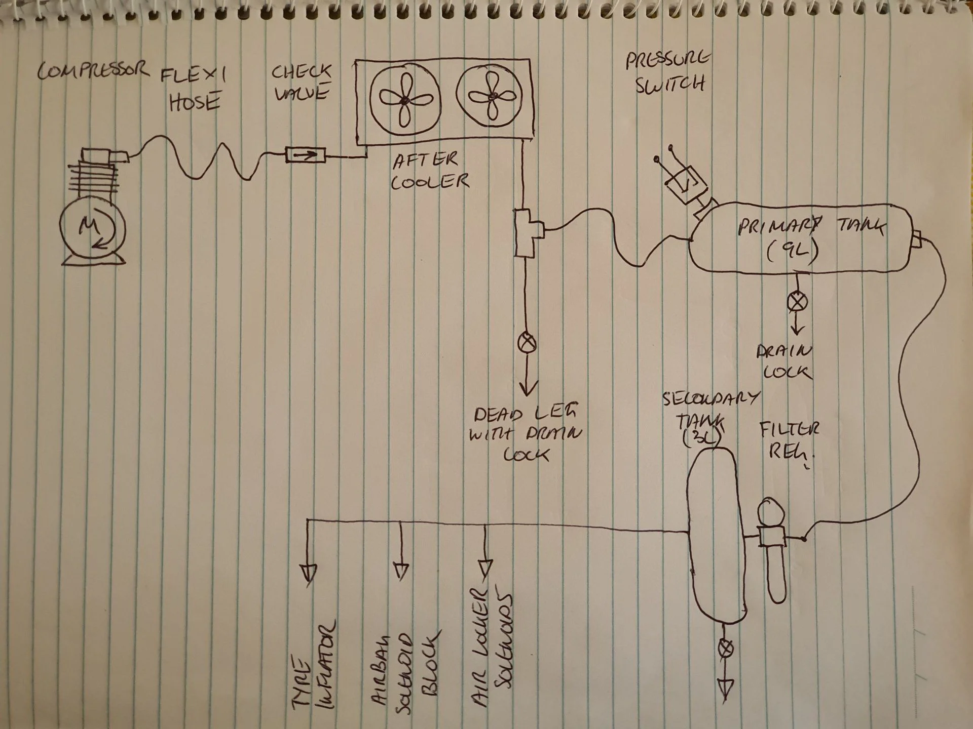

There's no need for an oil separator as such. The compressor is an oil-free design with a synthetic dry piston seal. The main purpose of the aftercooler is to remove moisture from the compressed air. The cooler is so effective with the two fans that it chills the air from ~200°C back down to ambient. This causes most of the moisture to condense out. There's a dead leg on the discharge of the cooler, so that most of the water drops down and collects in the dead leg rather than moving downstream into the rest of the system. There's a drain cock on the bottom of the dead leg that's accessible from under the left quarter panel just behind the mudflap. Periodically I open the cock and drain the water out.
Here's a basic system diagram that I've quickly sketched up.
The control solenoids for the airbags is this one from Boss Air Suspension:
It's just a pair of inflate/dump valves mounted on a common air header. The airlocker solenoids are attached to the end of the common air header in the 4-way block. I've also fitted a pressure sensor to each airbag port. Here's an annotated photo of the components.
Excuse the roughness, I just scribbled on it using my phone...

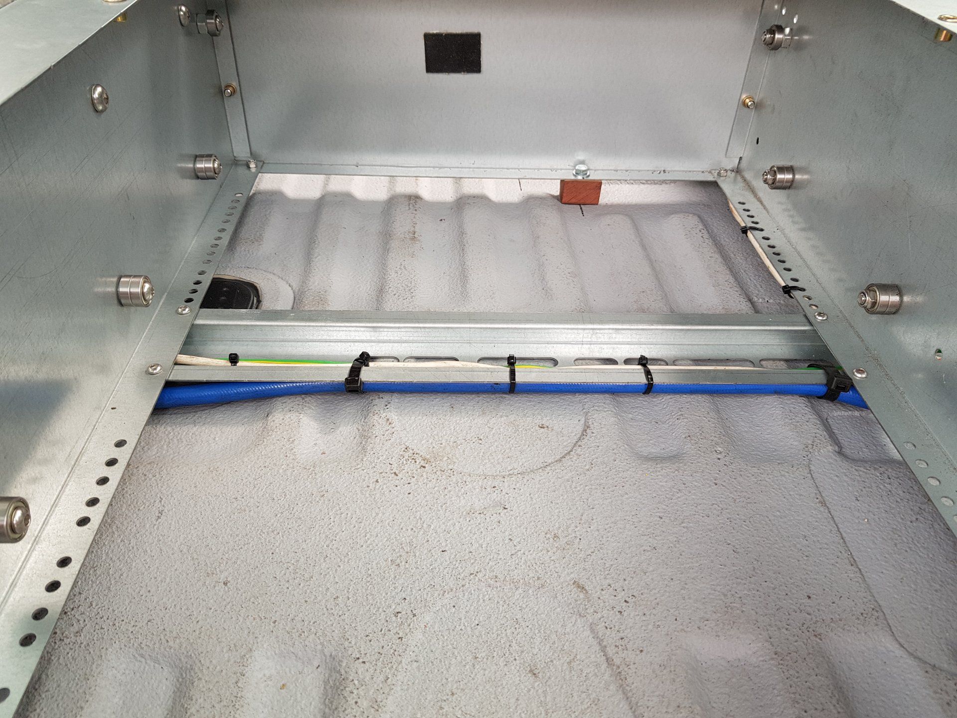

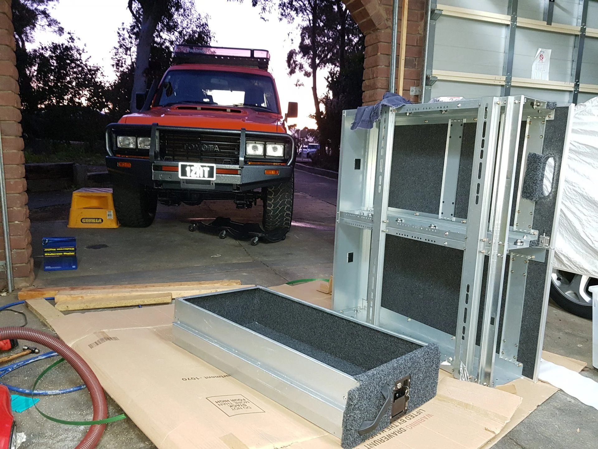

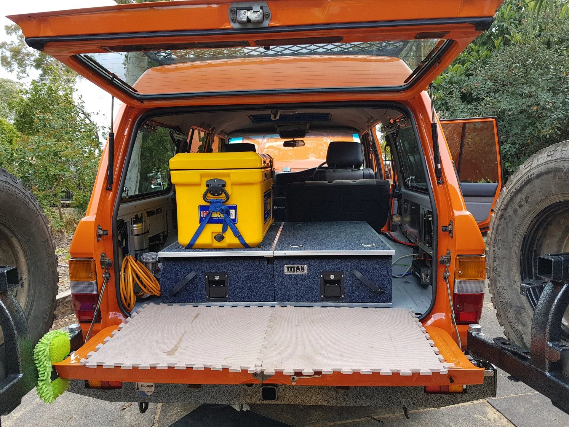

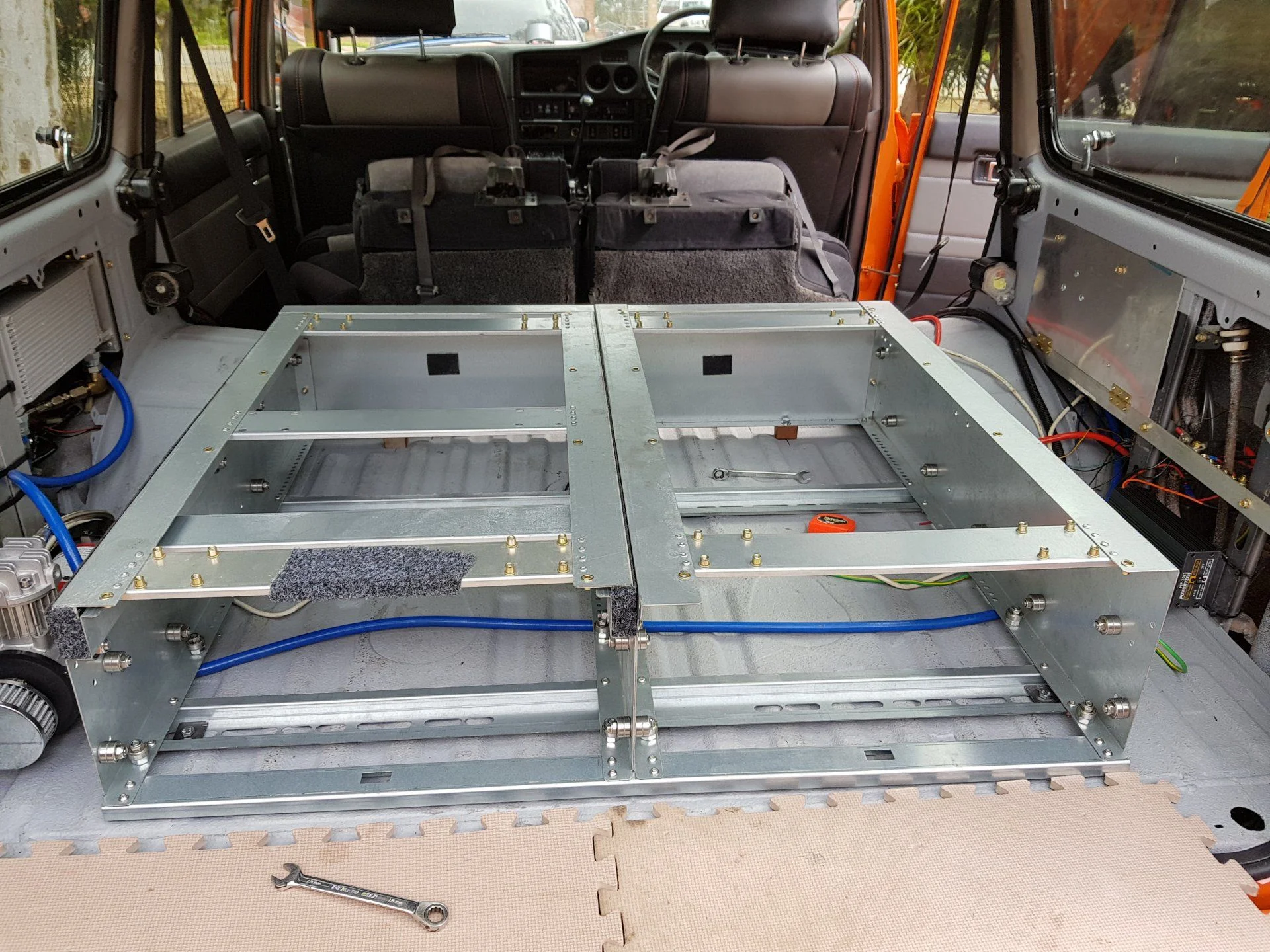

So I bought this set of drawers for the rear.

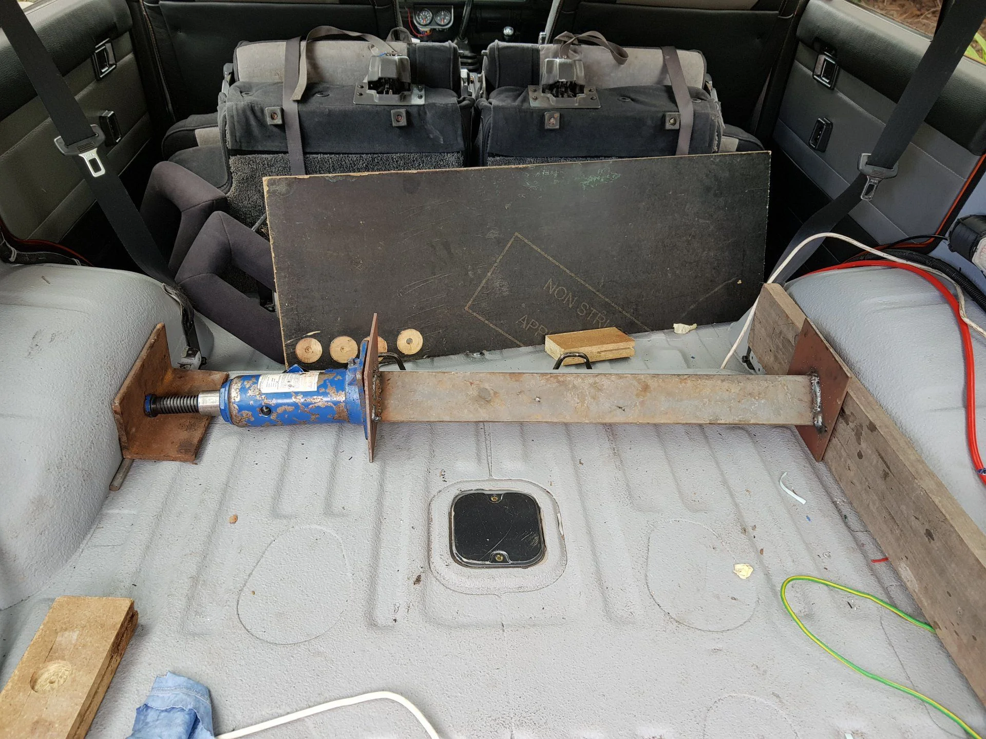

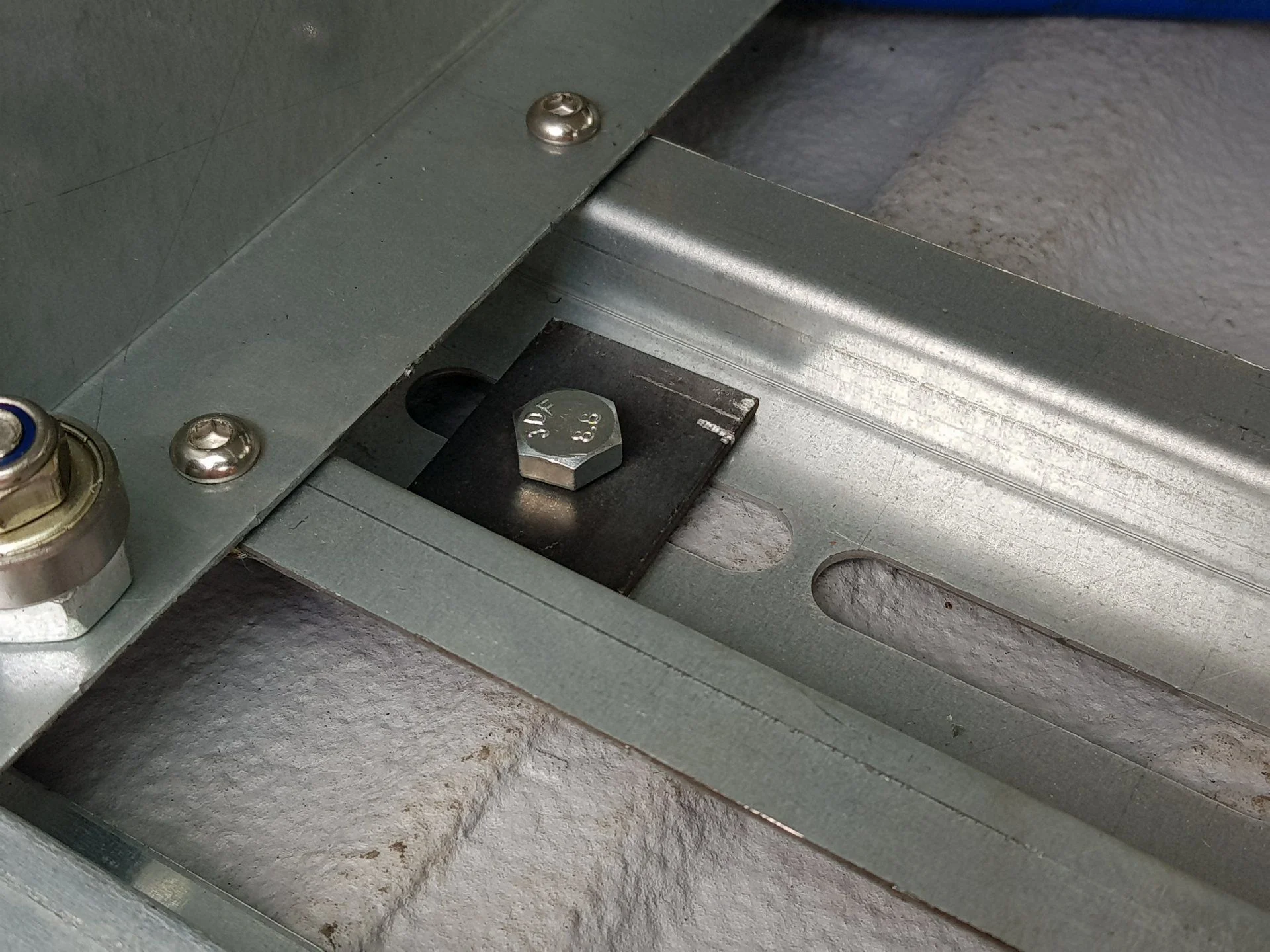

They're sized for an 80-series and are about 10mm too wide to fit between the wheel arches. Totoro Special Tool #354 to the rescue.
By pumping up the jack and applying the requisite force, I was able to liberate the extra space required and get the unit to fit.

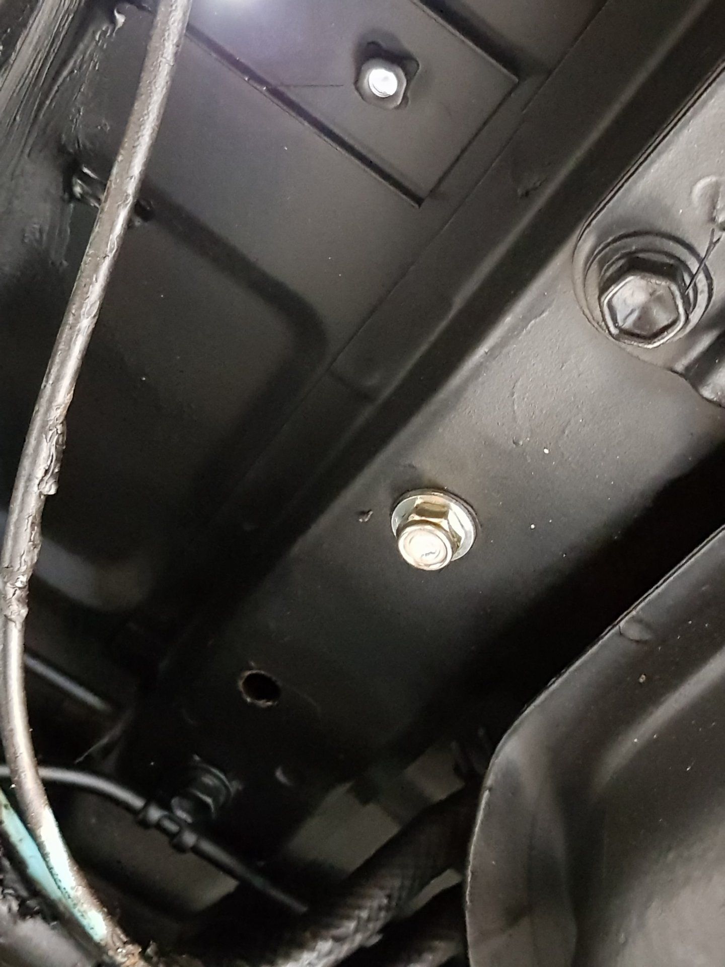

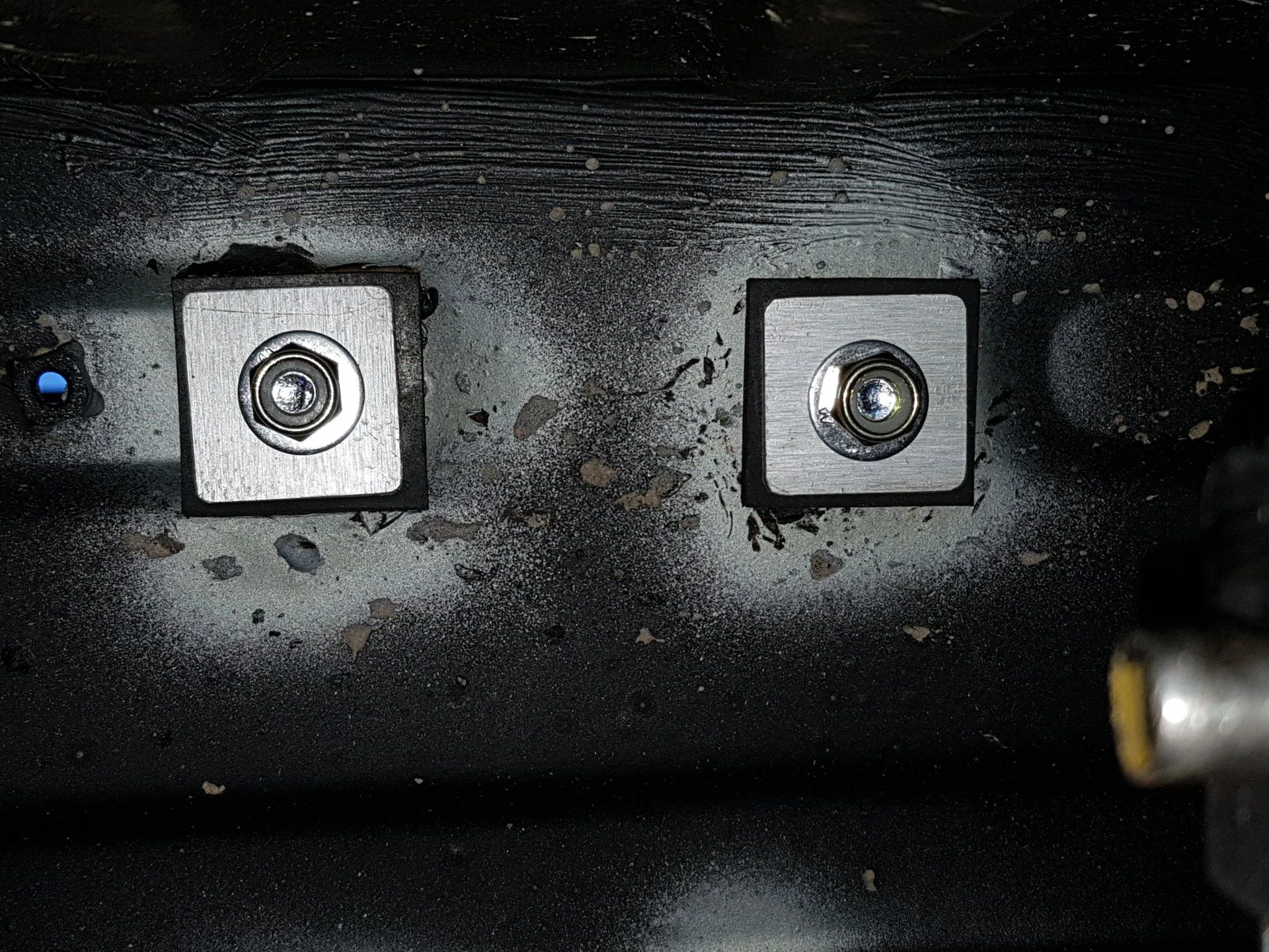

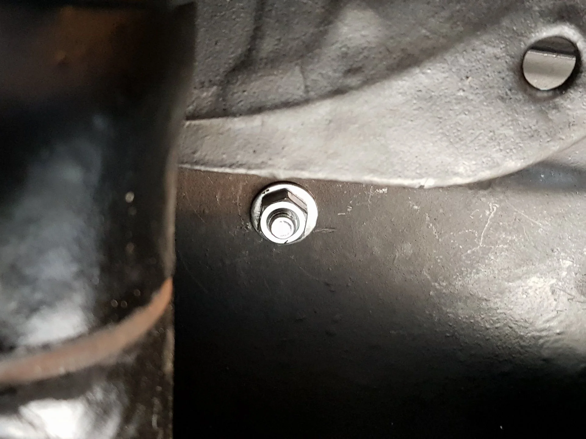

Getting the holes to line up with suitable locations on the body was a bit of a challenge. In the read, I settled on this.
At the front end, I managed to pick up the box section that runs the full width of the tub.
Wires and hoses for the air system cable tied in place.

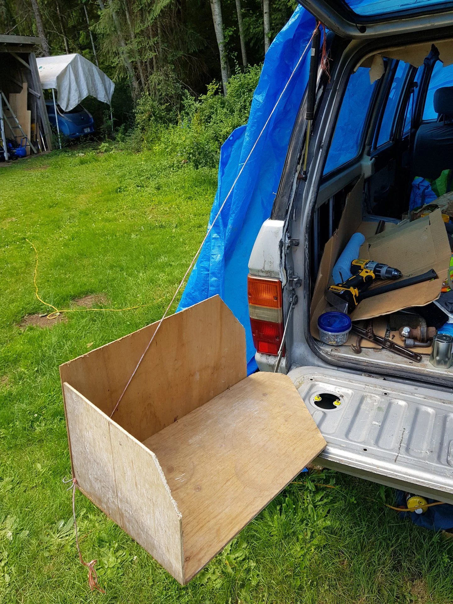

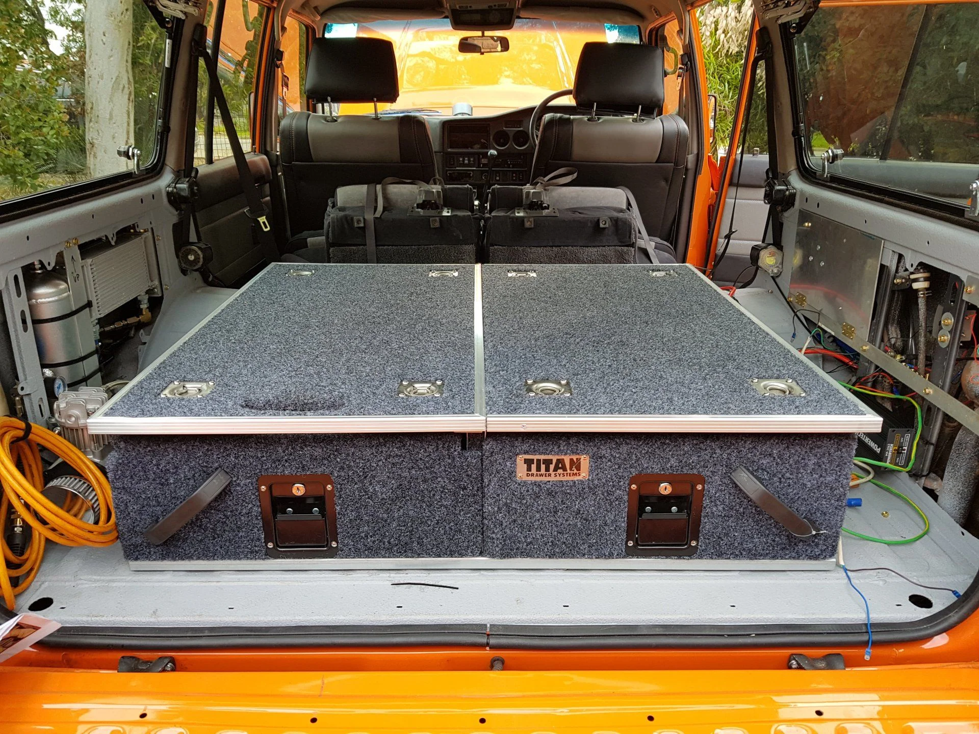

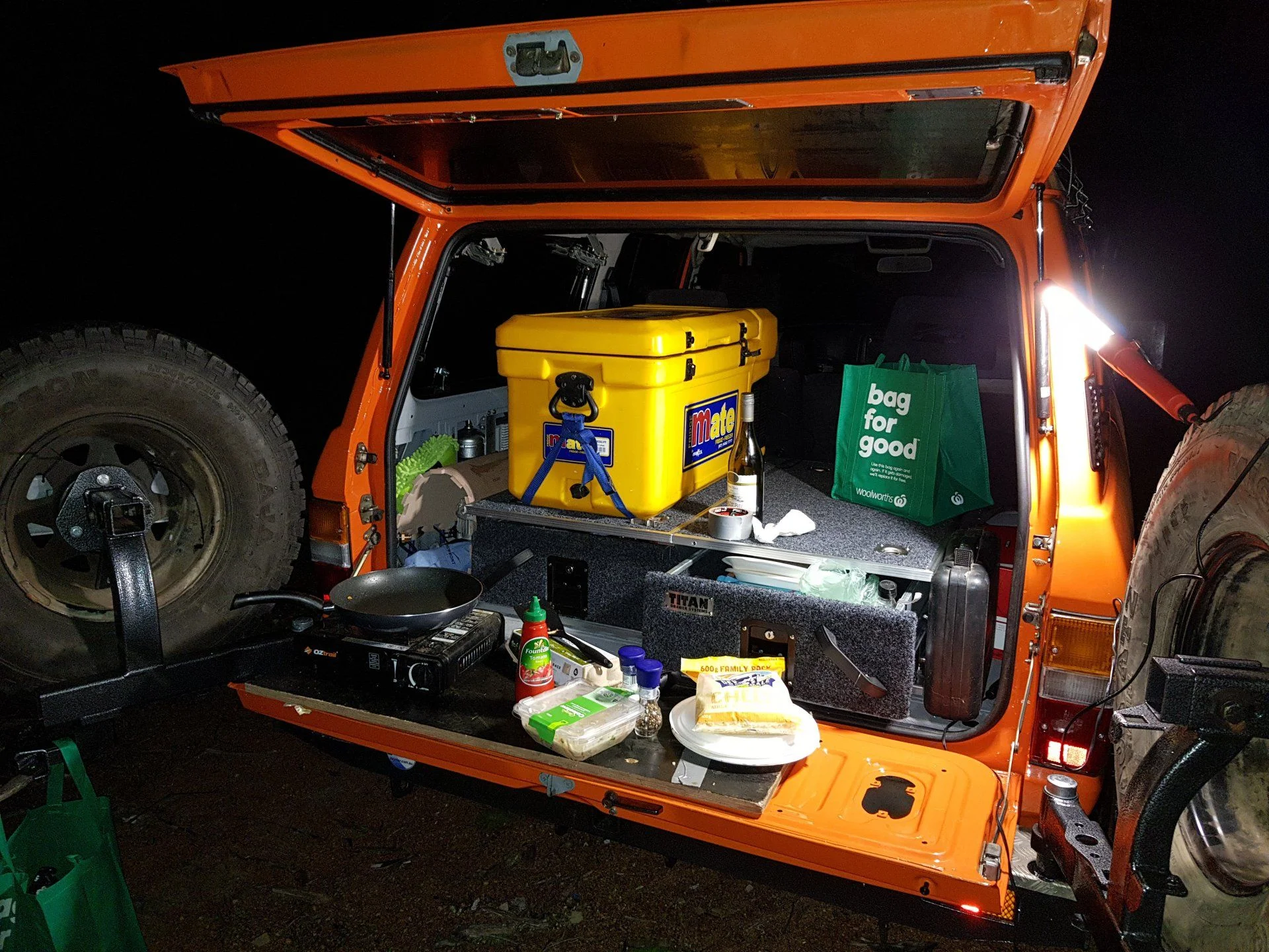

Nice drawers set. Your last photo shows my pet peeve with tailgates since the drawers knock all your food off. How do you plan to have a countertop? Separate standalone table? For quick lunch stops I'd rather just pull down a counter from the vehicle itself rather than set up a table so I just mocked up this foldout platform. Any other ideas?
20200709_170238-jpg.2366691
I've now fitted a painted plywood counter to the tailgate. To be honest, the positioning doesn't bother me greatly. My drawers mostly contain tools, spares, recovery equipment and other gear. Food mostly goes in tubs that sit above. For quick stops, it suffices. One just needs to think ahead a little before setting up. For longer stops and overnighting, I get the portable camp table out.
That's my dad enjoying his tailgate lunch...
My rear setup is still pretty rough'n'ready. I need to do some more work on it. I've been waiting until I have the air system and electrics done. It's all time 🙄

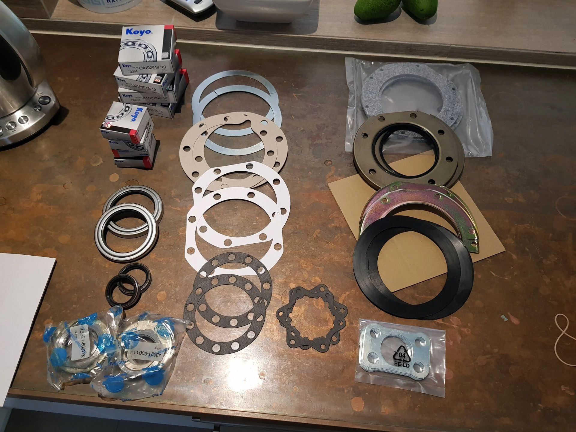

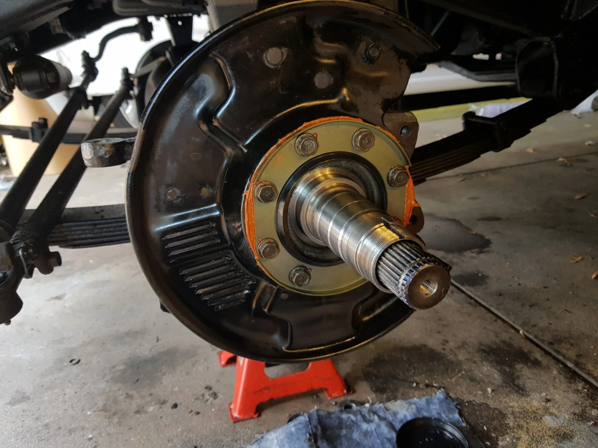

I've been meaning I'd been meaning to attend to the brakes and front hubs for a while. The last time I did the front brakes, I must've got a dodgy set. It developed a noticeable shimmy under braking that could be felt through the pedal. Plus the wheel bearings were starting to show some play.
So I decided to go right through the front hubs and brakes.
Full hub rebuild kit.

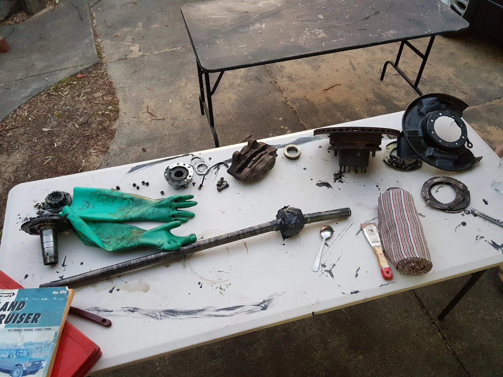

Stripping it down.

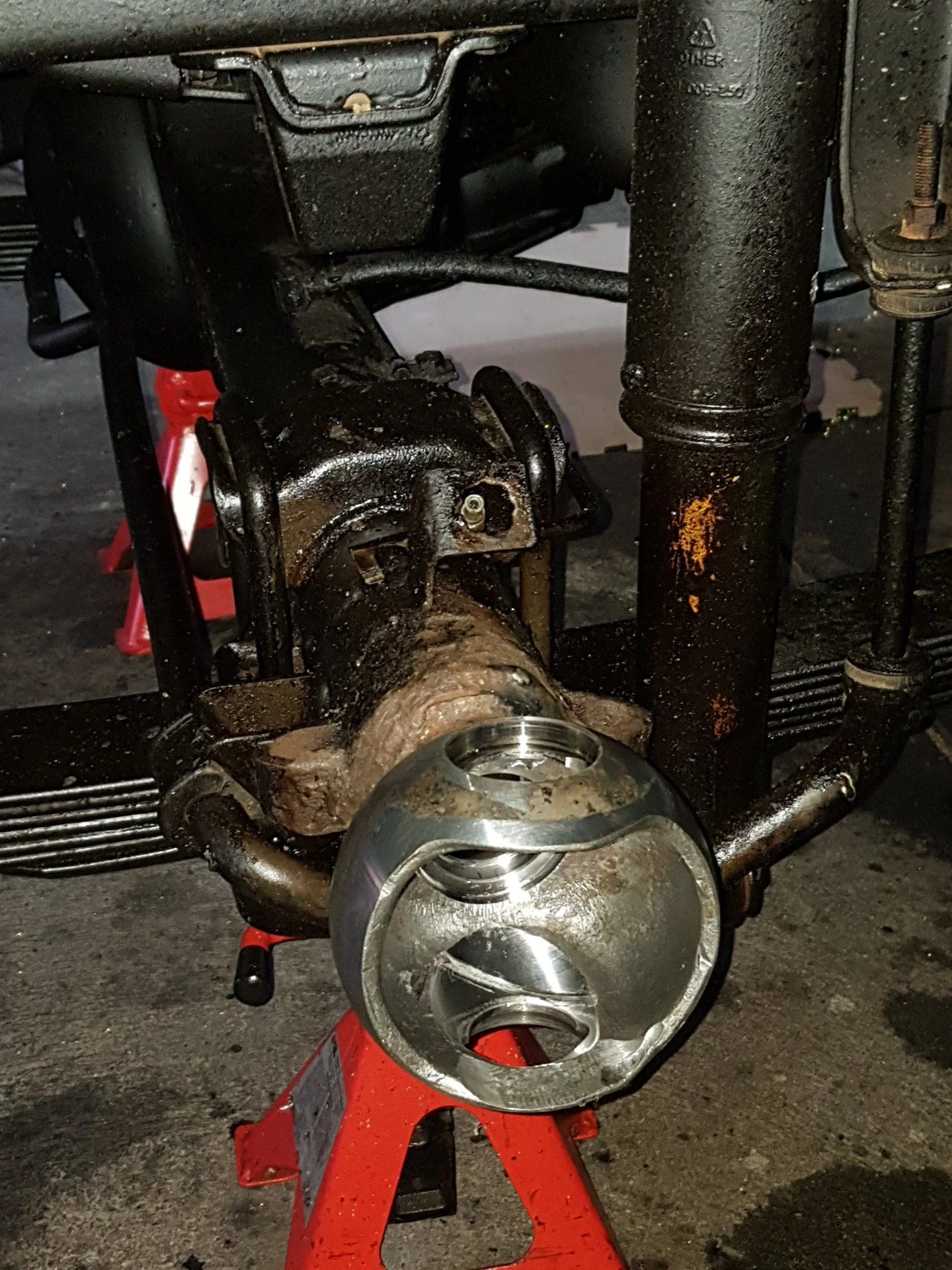

I did actually polish the swivel hub surface with some 600 grit sandpaper, but I forgot to take a pic before getting it back together.
