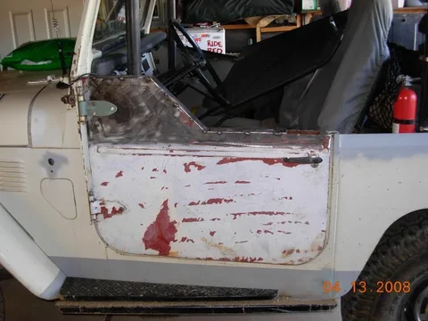

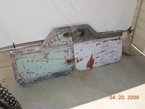

Getting ready for the Rubithon and I always wanted some half door. My buddy landcrusher910 made a set 2 years ago for Moab and I figured I had better get going. I got the doors from a parts swap from a Buddy in Iowa ( Thanks Tim ) the bottoms are rusted out but everything else is solid. After borrowing a welder for another friend calstyl2 ( Thanks Rob ) Today was the day. After cutting the doors down I went on a hunt for some angle iron Well being Sunday everythings closed then I remembered tommorow was trash day took a walk up the street and found a junk bed frame PERFECT 2'' x 1 1/4'' Took all day to get the passanger side done and welded up ( GOTTA LOVE GRINDERS ) fixed a few blobs made somemore cuts and Im happy with them :grinpimp: Tommorw I will get the drivers side done right now its time for a beer :beer:

Sorry all I got was the skins, Thanks Everyone in nthe next few days I will get some paint on them

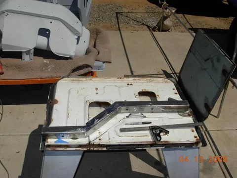

I am doing the same thing from some old door skins. Here are some pictures of mine.
I decidied to notch them for arm rest's. I used some 1 1/2 square tubing- it was thick and probally overkill- but hey- it's a cruiser:).
