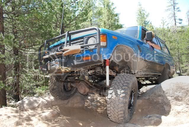

After a little bit of wheeling last weekend, everything seems to be working well.
  • Transmission crossmember held up well (Thanks again Matt)
  • Twin sticks work really well and operate way better than factory.
  • I need to bend the outside twin stick shifter (hi-N-lo) a bit from rubbing on the body.
  • Putting the toybox in 4.7 and leaving the split case in hi is perfect and then locking the split case into low is the ultimate stupid low.
  • 5th gear in a SOA wagon is just kick ass with 4.88's in the diffs and 35's

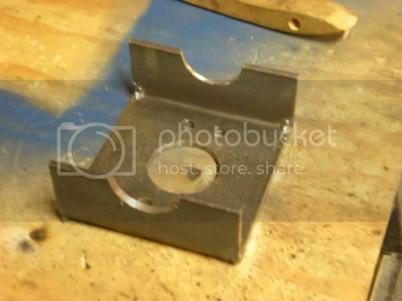

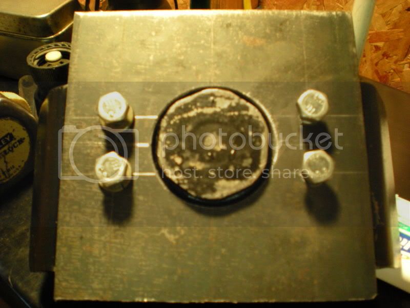

I started working on my crossmember and skid plate setup for the transmission and ToyBox finally :rolleyes:. The plan is to include both a transmission and crawl box mount with a 3/16" skin that will be removable from the crossmember. The tubing I am using is 1-3/4" x .120 wall DOM. Hopefully I'll have some updates this week. . .
Here is the base plate for the toybox mount
sides tacked on

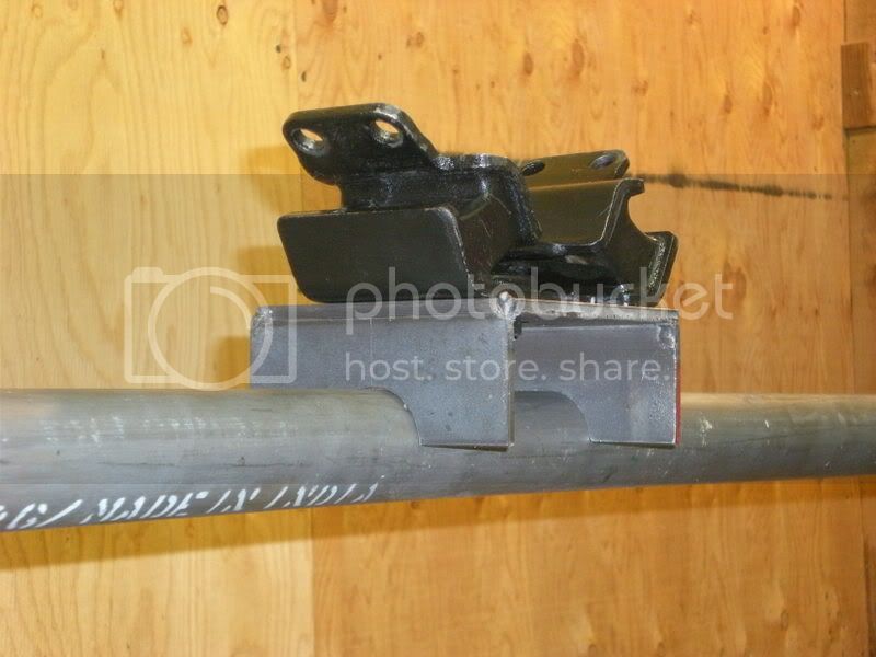

Base mount for the ToyBox mount.
Dylan
Thanks Clint. I have some pretty good ideas for this, I just hope it comes out like it is in my head.

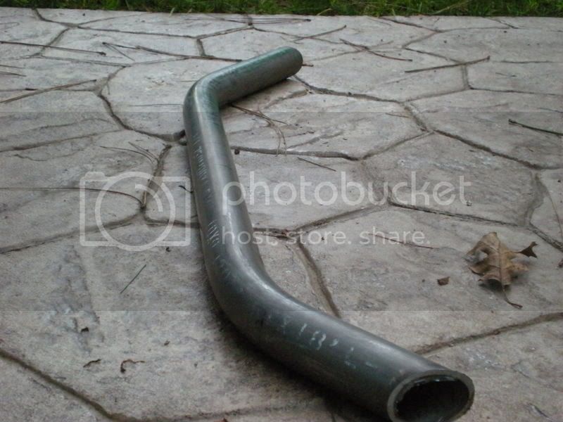

mini progress this afternoon. . . I was able to sneak over to my friend's house for a few hours and work on it a bit more. I have to work tomorrow, but I think we should be able to get the main frame done on Sunday. This is the piece that will go under the ToyBox and mount to the frame. Man tubing benders are cool, it took some getting used to as far as where to 'start' the bend, but once we had that figured out it was perfect.
