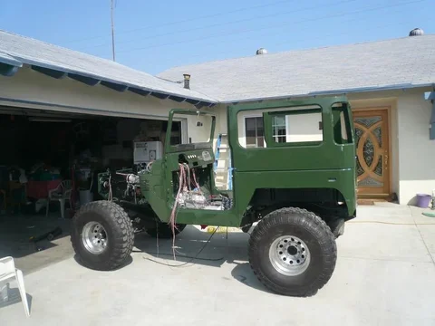

Wow, things are moving along pretty fast in this build.
Collor looks great.
What are you going to do with the axles, they kinda stick out with all that nice paint work?:cheers:
they will be replaced. moving along fast because i have sat on a lot of parts over the years and work is kinda slow. so i can put some hours in on the weekdays also ... thanks for the interest

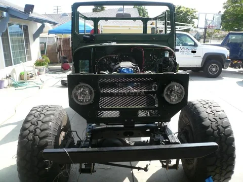

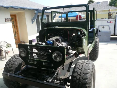

Looking good man, you're giving me hope for mine as I start to rip into her tomorrow morning! Keep up with the pics! How hard is it to convert to TBI?
Thanks
TBI is a little different than what i have. i am using a TPI. TBI uses i believe 2 injectors while the TPI uses 8. both are good a little more HP with TPI. as far as how hard it is painless kit is pretty basic, everything is labeled so it is plug and play.. kinda pricey. there are other kits that are good as well.(howell affordable fuel injection and i'm sure plenty more) good luck with your build..
been a while but here is so more updated pics
i used 3/16 steel for the sliders that was bent on a brake and 1.5 .120 wall dom tube .. gonna tie into frame later
