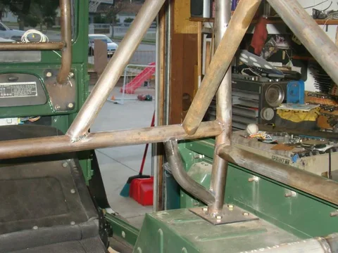

here are some more pics. let me know what you guys think. I'm no pro, constructive criticism is more than welcomed.

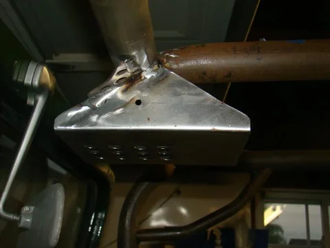

.035 wire welding on 20g steel was kinda hard. grinder fixed it. :hhmm:

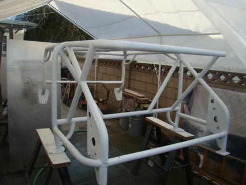

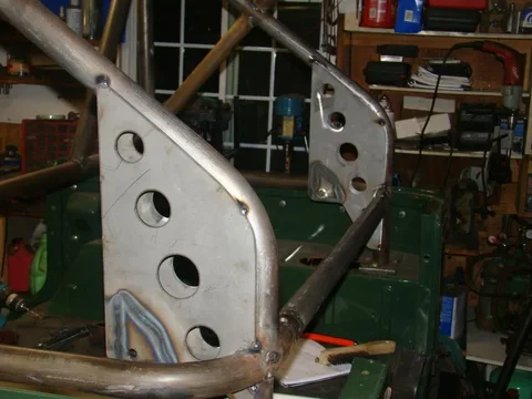

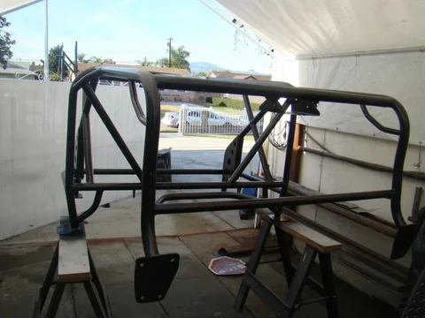

the cage is pretty much done welded and painted so gonna have to post more pics for you guys tomorrow . thanks for checking it out
welding this took longer than i thought
white primer (again rattle can) shows if you missed any welds real fast. i only missed under one tube.:hhmm: sand weld prime.

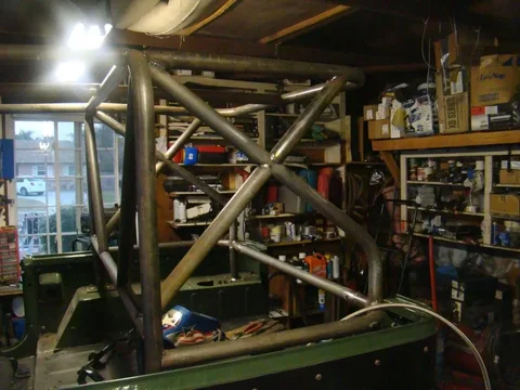

Love the build. Just picked up a green '76. I was looking at your cage. I'm a pretty big guy and getting in and out of my cruzer with the front cage is difficult. I see that yours looks as if it bolts to the area under the dash. Any pictures of that. Any concerns if you had a roll over?
the reason i did it that way was cause i am also a big guy (6'2" 350 i'm husky :lol: )
size 13 shoe so with a tube down there it would be a tight fit. i'll get some pics of what i did but basically i welded some 1/8" steel to the body first. if i do roll most of the protection will be right behind my head. i have seen people roll and just barely bend the windshield frame. also seem people not even damage their windshield. and i have seen pics of someone roll down a 100' cliff and :censor: everything up. i'll try yo stay away from that one.

YES! I'm feeling you. 6'4" 300 size 13 as well. I have a hell of a time getting my knee high enough to push the clutch in. I need to fab up some custom seat rails that allow me to push the seat back further. I will take any direction I can get on your cage set up on the dash.
