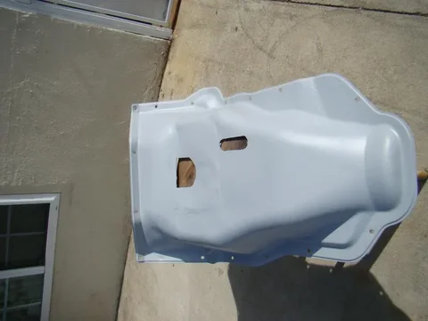

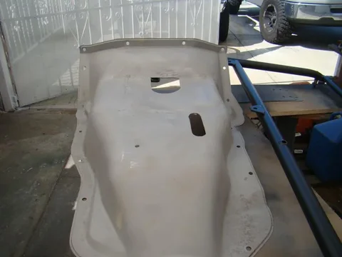

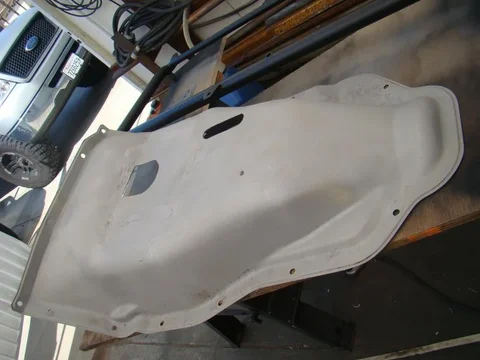

i guess my cell phone takes ok pics.. i made a patch welded it up and grinded it down .. i don't need it to be perfect i will be sparying a textured bed liner .. so just the grinder for now. took it to the sandblaster here's how it turned out so far
Coming along nicely. My brother just bought the same rims. He loves them too. Love your engine, I am just finishing up my TPI install tonight.

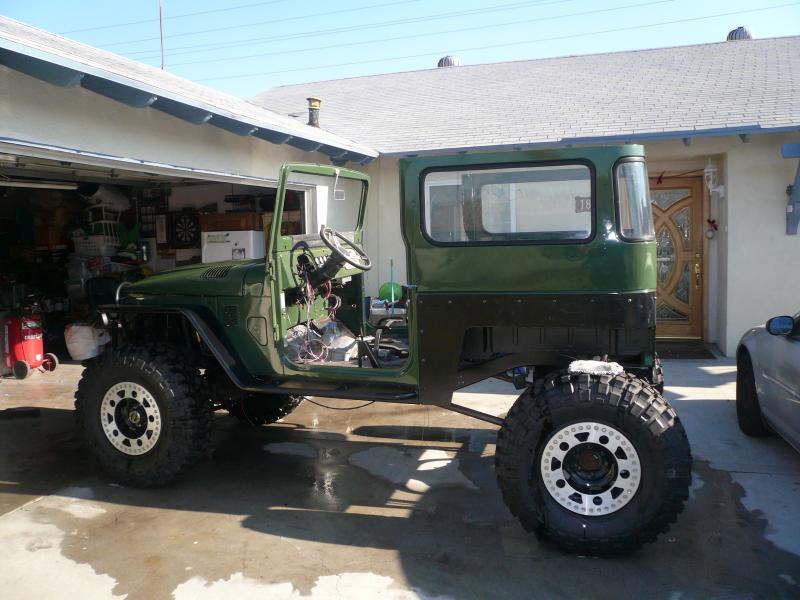

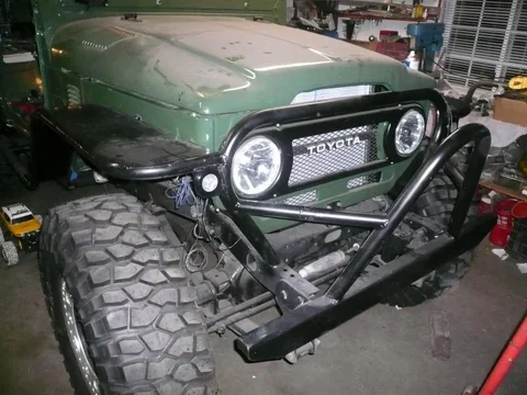

ok so here's where i'm at now.. sold the toy axles so i am gonna do a temp link set up to keep this thing rolling. here is what i started with..
Nice rig!

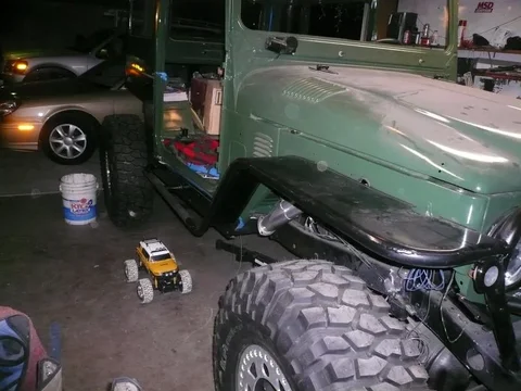

My quarter panels are so rusted, I plan to make similar panels for mine.
they were pretty easy to make. made a template for the shape and i had a old rim(or was it a 35lb weight from the bench) laying around that tack welded then heated to bend around it .. good luck

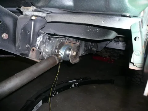

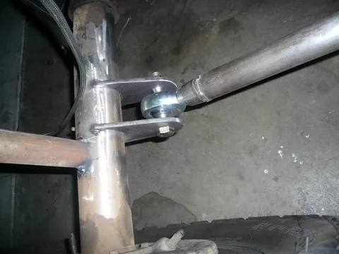

so i was going to link the front but decided not to. got a dana 60 that i am just gonna do a leaf spring on. i gave alcan a call they are gonna send me a quote .
Heres the question what other springs are out there with good performance?
running 37s wanna keep it low. So no lift right?
i intend on driving it some places but not a DD.
thanks for any input :beer::beer:

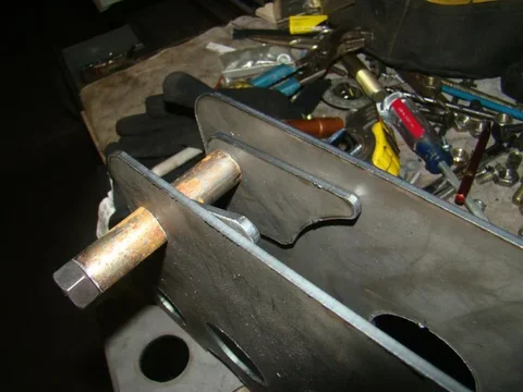

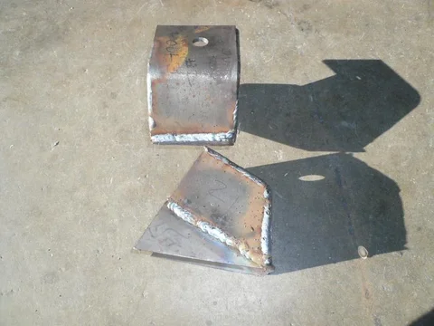

air shock or coil over mounts
yea i really haven't decided if i am going c/o or air shock yet ... but this is how they will mount.. it's kinda a cool when you can go to a friends shop and have him burn these for you real quick. ( i paid him of course)

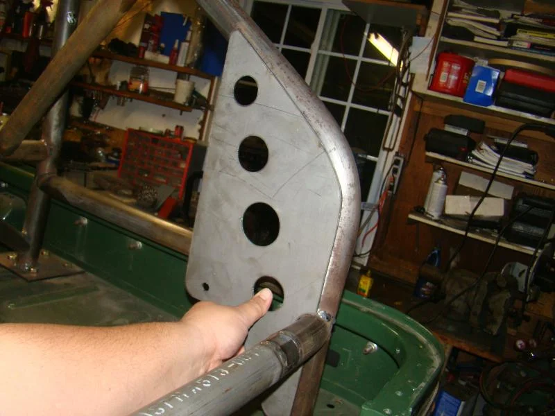

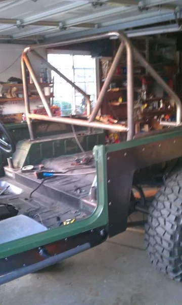

more cage work to come tomorrow .. hope you all enjoy
