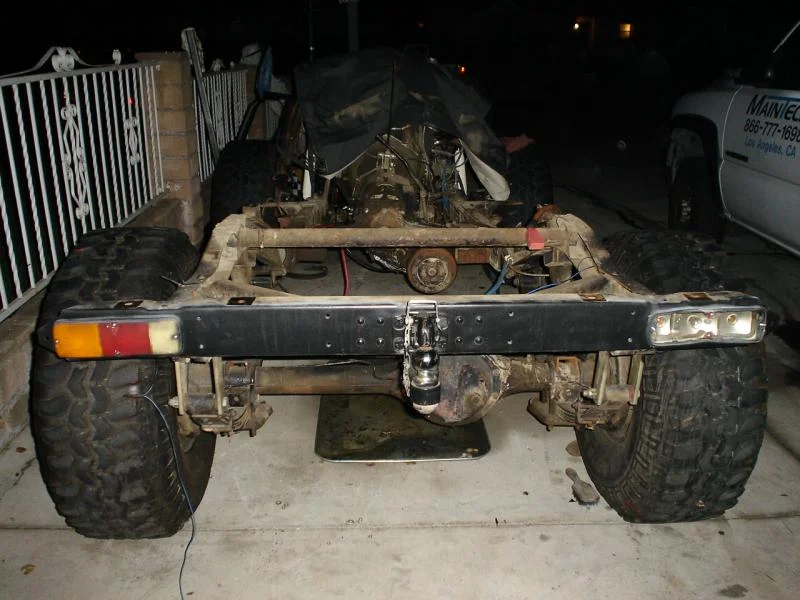

First hey all.. i have been tempted to start this thread for time now. i am using this to keep myself motivated on this project. i am pretty far along in this project but since i know we all like pics i will start from the start... So i saved this cruiser from being auctioned off at a tow yard.. long story short. truck was impounded PO was a friend and did not have the money to get it out.. so i took care of the fees and kept the cruiser.. this is what i got....

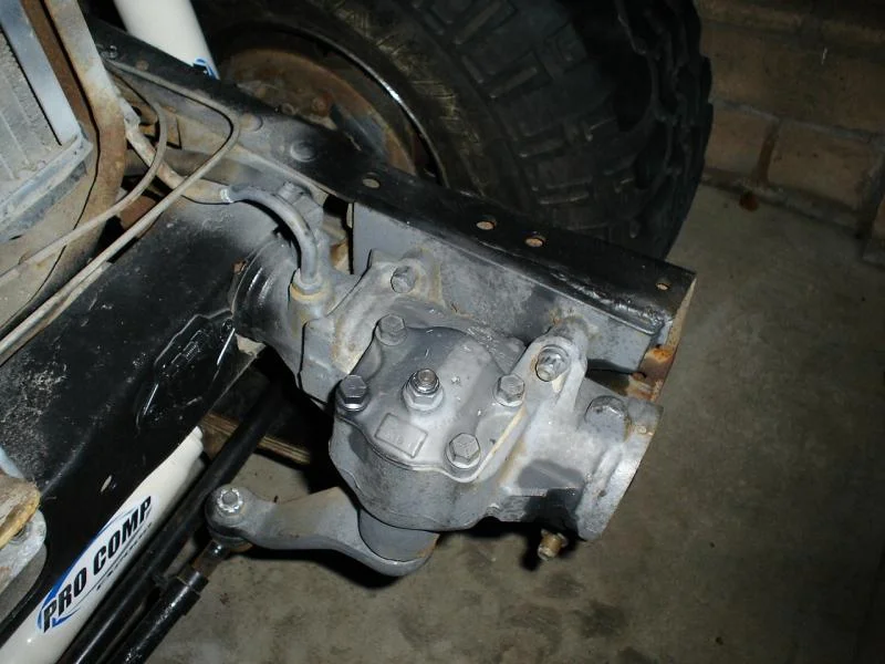

got it home and #1 brakes were terrible so i was gonna replace that.. my original plan was to KEEP IT SIMPLE ???started looking into the brake sit. and i got side tracked by this...

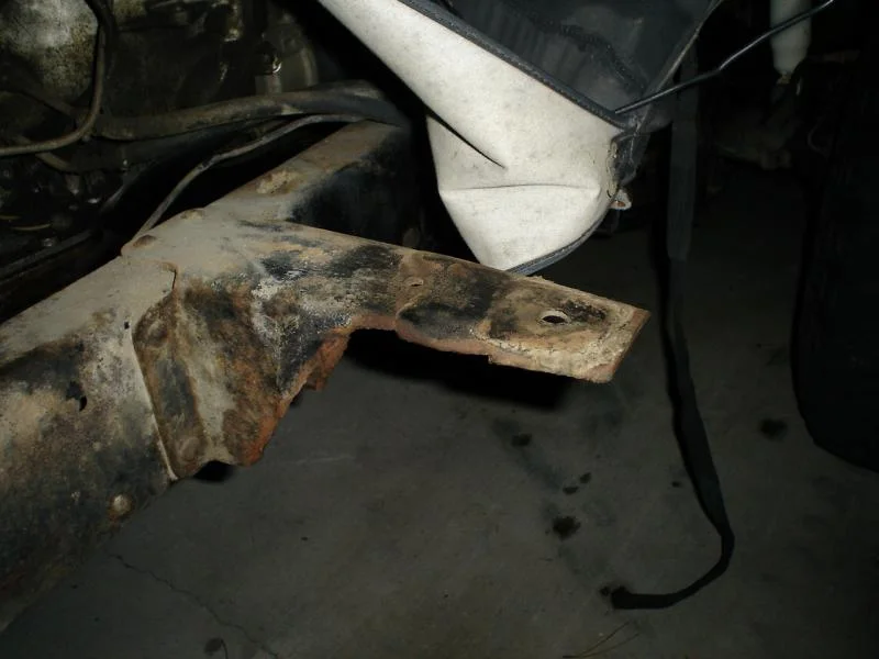

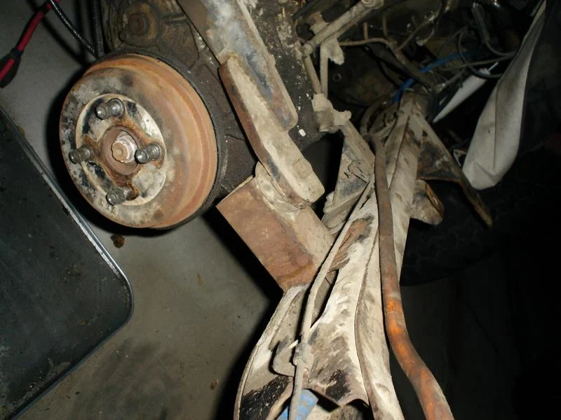

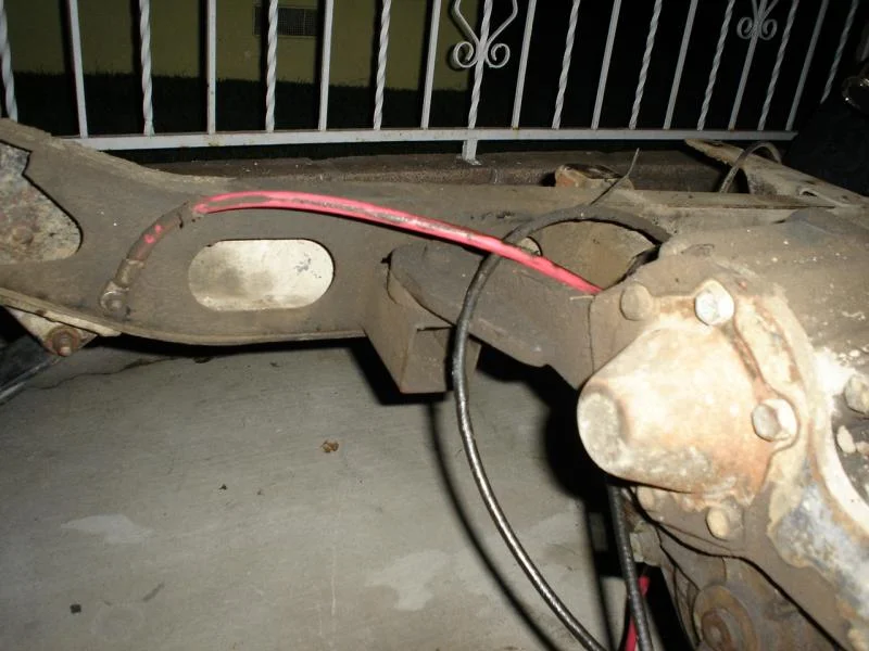

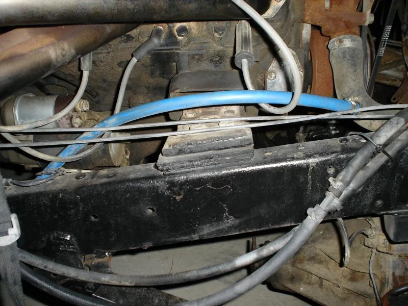

after i saw that i was completely sickened by it. so on my list as #2 replace those mounts.. and then i noticed these

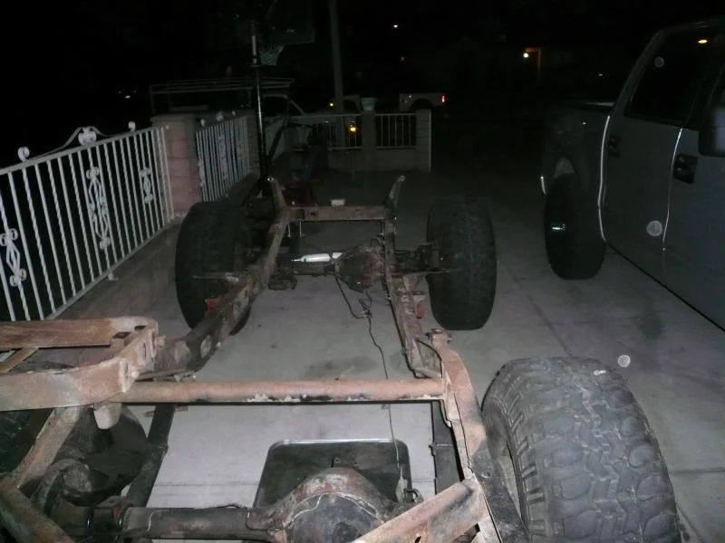

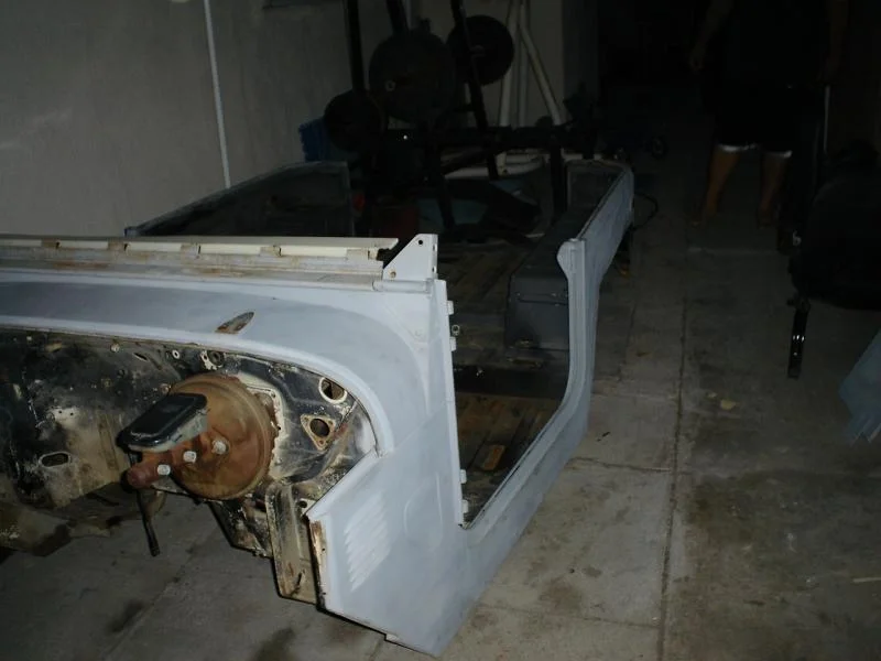

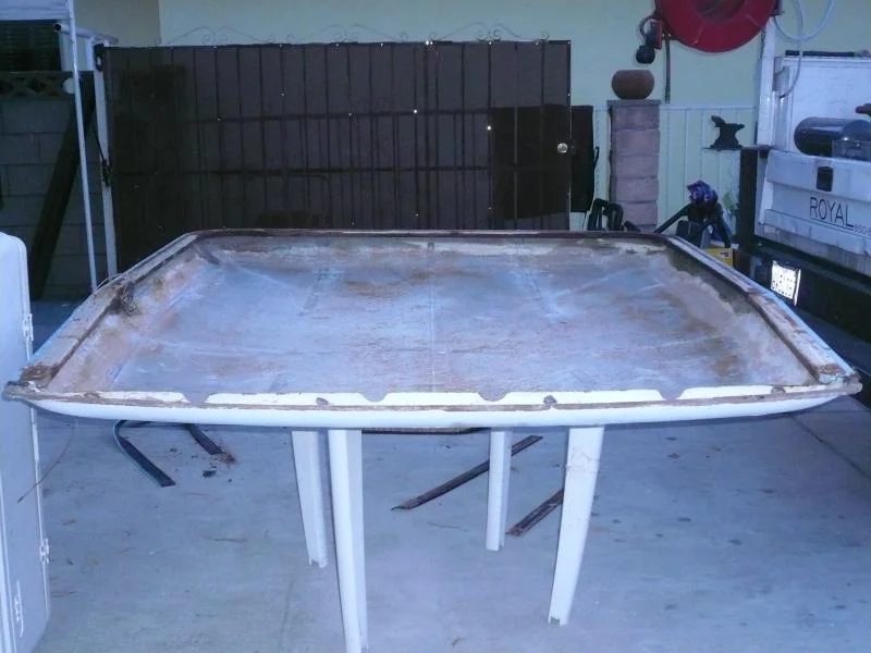

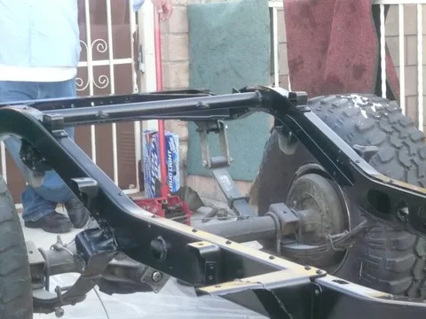

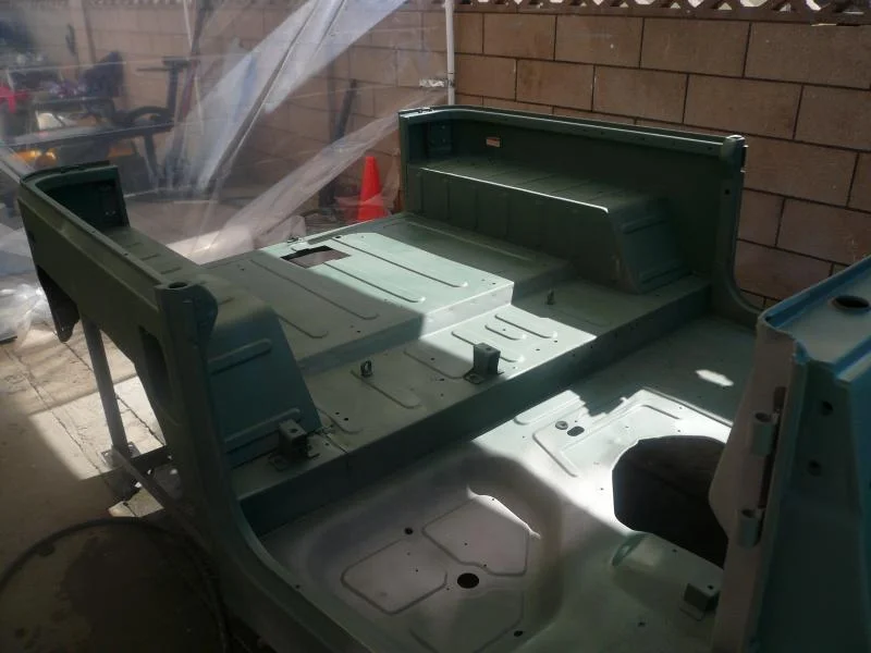

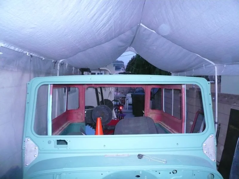

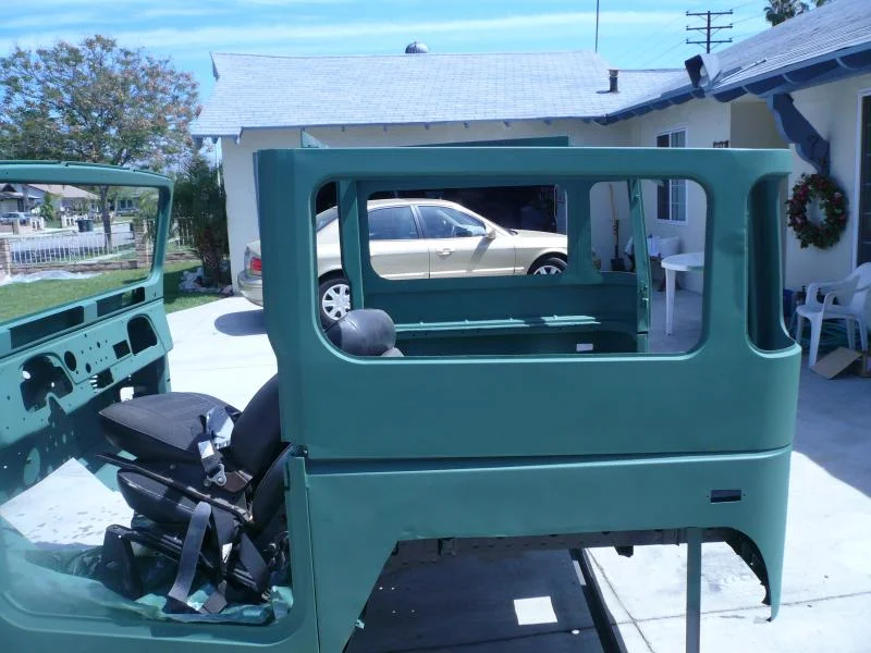

so after that i ended up stripping it all down .. didnt have time to take much pictures cause i was a man on a new mission. after it was stripped i was like hey a few more bolts and the body will come off.. and so it begins...
more pics i dont know who the fabricator was on this build but i think mickey mouse had a part in this.
note the 2 sets of t/c mounts :doh:

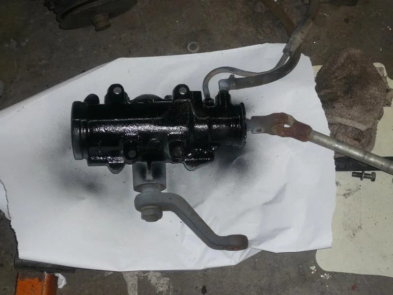

dont know what was the donor of this booster m/c some gm i guess
more beautiful work
wiring was complete trash.. it had 1 power wire to the lights that just turned lights on when the truck was on if it had light bulbs .

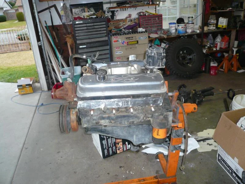

note the motor is slightly tilted

Those front mounts aren't a common rust area, so you could likely find a cheap used set rather than fabricating new ones.

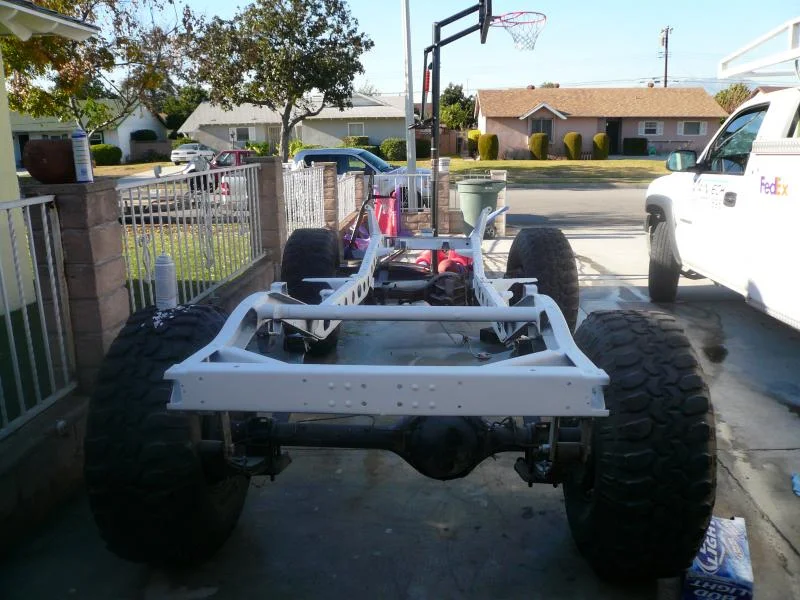

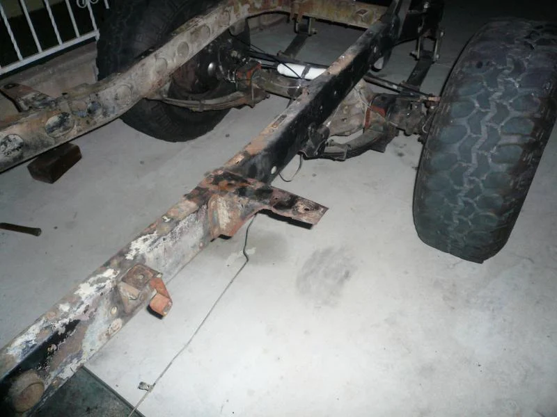

It looks like the frame is missing the middle cross member.:eek:

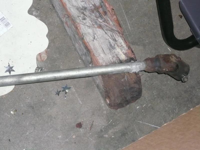

like i said solid shaft

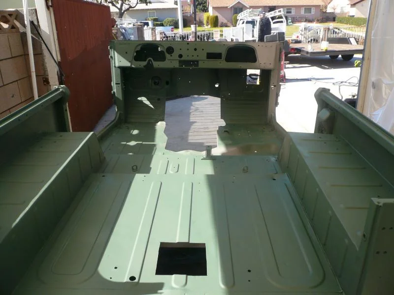

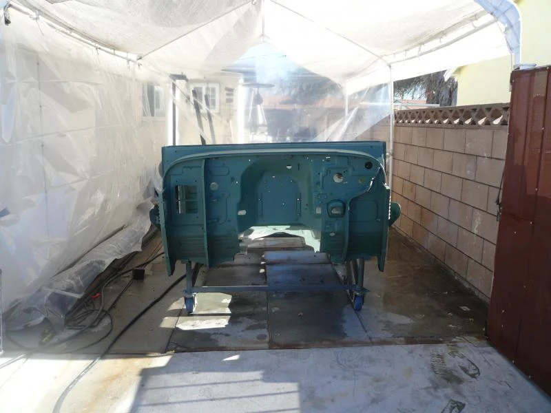

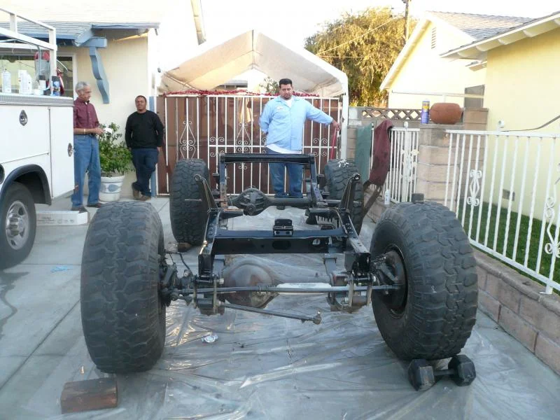

i used the rattle can method after i had the frame blasted for a few reasons. cost and i knew i would be welding on the frame.. also i live in sunny CA so dont have to worry about the rust issue..
Could have been a three speed frame which has the crossmember further forward than the four speed frame. The cross member appears to be in the way. I'm guessing you've got an automatic and they cut it out because the tranny is longer.

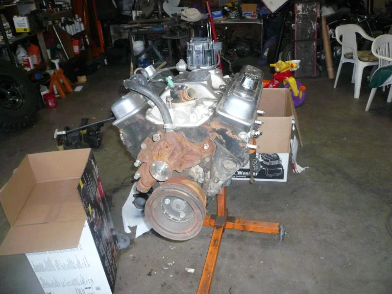

How close was the block to the fire wall?
there was a auto tranny in it so your prob right .. and i dont recall how close it was to the firewall. i do remember the drive shaft being all of 1 ft long..
You may have cooling issues if the block is too close to the firewall.
As a contrast, with a Toyota 4speed my rear driveshaft is one inch longer than the front. (more like 23 or 24 inches long I don't quite remember)
yea they were SOA 3rd member was not pointed up looks that way but i think i had such a bad pinion angle it just looks like it points up.. hole in back po had a fuel cell and it was for the sump..
