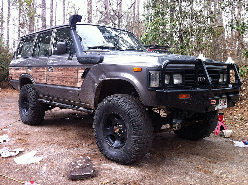

That would've been a good idea to take before and after pics hahaha. Heres the best pic i could find of the changes in diff offset. Before: http://www.flickr.com/photos/78182539@N07/11556777163/ After: http://www.flickr.com/photos/78182539@N07/11554182844/
From looking at the pics the gap between the tires and spring looks like a inch or two difference . Dose that sound right? Or are the back spacing different on the wheels?
Sent from my iPhone using IH8MUD
Yep sounds about right. From wheel mounting point to wheel mounting point, it's 3" wider than a 60 axle. I'm pretty sure 60 series axles are 60" and 80 axles are 63". But I'm not 100% sure. I know there's a 3" difference, that's about it haha.
80 series rims have a BS of 4.5" so that extra 1" figures in there somewhere.

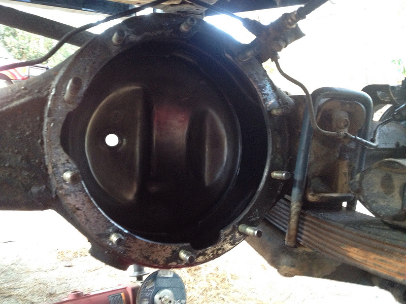

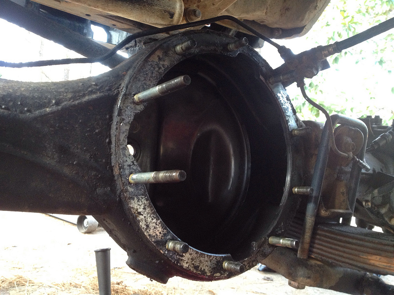

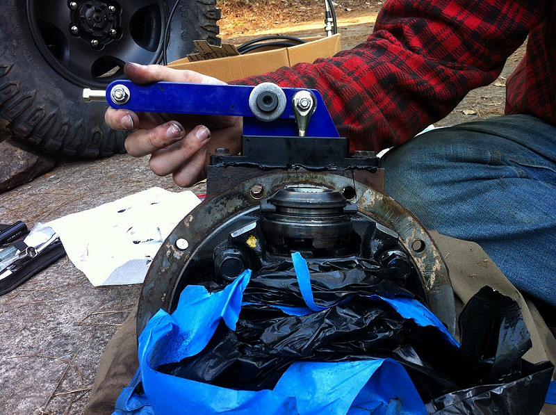

A couple modifications are necessary to fit the e locked diff into the stock 62 front housing:
You'll need to grind the housing a little on the left side so that the locking mechanism can fit inside..
And you'll need to swap in 4 longer studs..
-two really long ones on the left side
-two slightly longer ones (same length as the 1 and 5 o'clock studs) swapped into the 12 and 6 o'clock location
I didn't realize the top and bottom needed to be swapped, so my brother and I FIPG'd, stuck the diff in, and started bolting everything up, Then... Fxxx!!!! :bang:
Im sure you guys can imagine whats going inside, but heres a little visual reference..
UNLOCKED :frown:
LOCKED :cool:
INSTALLED!!!!

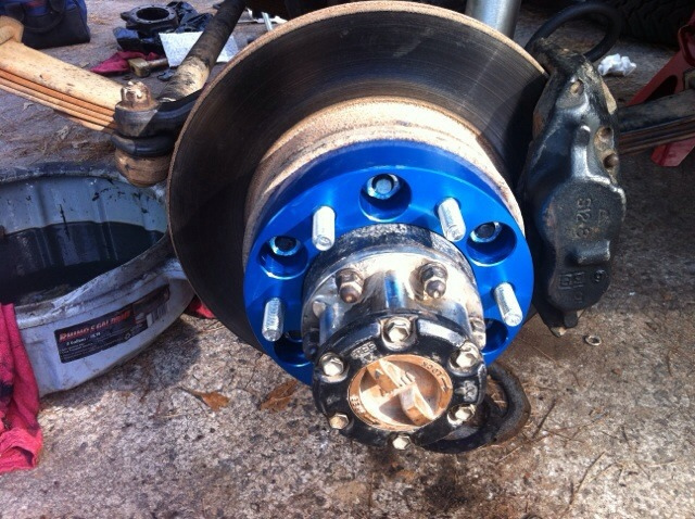

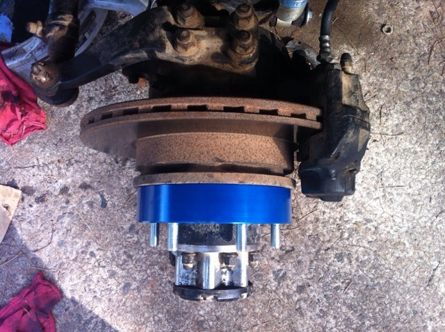

The beautiful longfields are hidden away, hubs are regreased, and the spidertrax is acting as the cherry on top.

I have been catching up on your progress good to see parts of the old girl living on. I missed why you opted for the life ending spuder trax over the sky widening kit for the front axle? I had two separate sets of them fail before i went with the sky kit. Make sure you pul the front wheels at least once a month and retorque the spuder trax,
Truck is lookiing good
Thank you! Yeah I don't plan on letting anything useful on your old truck go to waste. I went with spacers because the widening kit was ridiculously corroded to the rotors. Even after I finally got all the studs out of the back and let it sit in an annoyingly expensive bowl of PB blaster over night, there was no separating the two pieces. I'm not too worried about the spacers because most failures come from either incorrect installation or not checking up on them every once in a while like you said. I am planning on re torquing them every single chance I get just to make sure one of these things doesn't ruin my day.

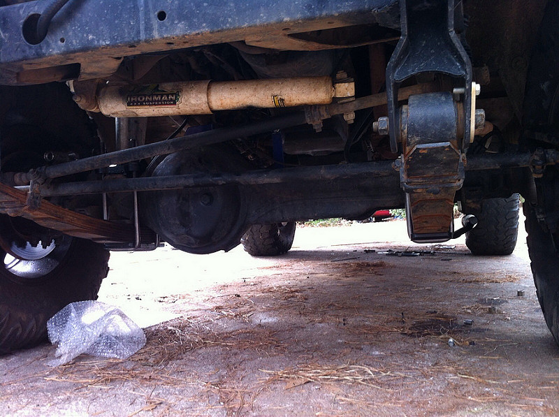

The new u bolt flip kit slid perfectly into place. Spending the money was definitely a better choice than trying to maneuver that old kit into place… That got old real quick :bang:

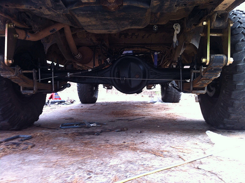

Front:

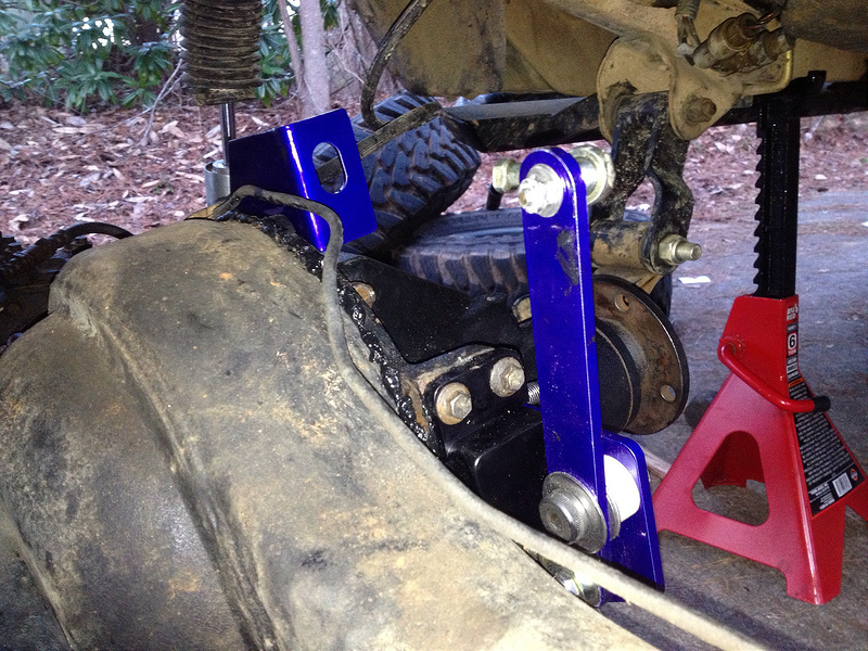

Rear:
No shocks in the rear because they're pretty much fully compressed at normal driving conditions, so i don't want to fxxx them up already haha. Zip tied the new LSPV "arm" to the axle and I'm happy to report that the LSPV i bought a couple months back from Ryaneddy16 works great! No more weird rear axle brake locking up!!!!!! And don't pay any attention to the brake line on the right, i disconnected then rubber gloved the fxxx out of that thing!

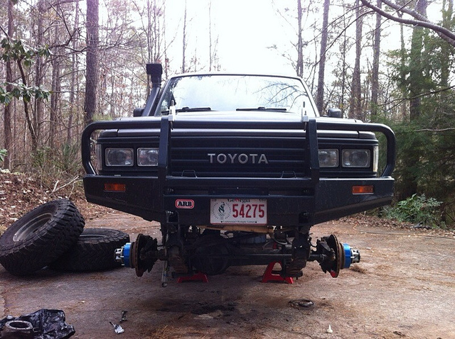

Im just really hating these tires, I'm not planning on using them, but on the short test drive, two of them went flat… after i spent like 30 minutes FOOT PUMPING them up with air… i really need a damn compressor. But the hub looks good.
So here it is in all its glory…
Ill hopefully have some better pics tomorrow :D

-Weld LSPV arm bracket onto the 80 axle
-All that other welding (shackle angles, Ford shock towers, rear upper shock mounts)
Then, probably done :frown: except for bumpers, lights, any other dumb BS i spend my money on :)
Why not eliminate the LSPV instead of welding a bracket onto the new axle?
I've thought a little about using the wilwood PV, but I don't really know anything about them. Mainly, I just didn't want to screw anything up haha. But it looks to be a relatively easy swap, just need to reroute the brake lines I think. It's something to think about for sure since its probably an improvement? It would subtract from the chaos on that rear axle, that's for sure lol.
