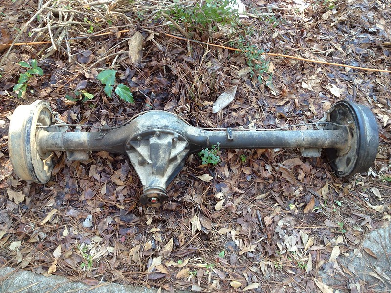

I need them because the rear 80 axle is 3" or so wider than the 62 axle up front. so yep just for the front

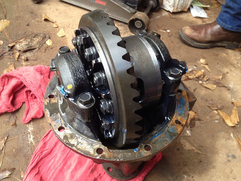

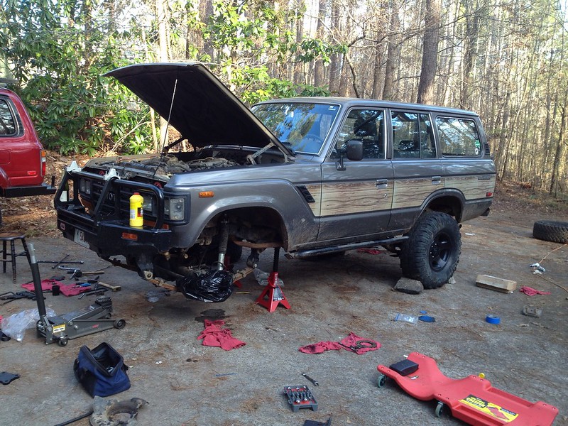

Just came back home from working on rusty and found the 4+plus u bolt flip kit shock mount waiting at my door :) My spidertrax got here last friday so now its safe to say i am about 95% ready to begin swapping axles, diffs, lockers, etc. I just need to wire wheel a few things, then paint, and BOOOOOOM… things happen!!!
It should be a busy next couple of days since its supposed to be nice and sunny for the rest of the week! hopefully, ill be pretty much finished up by wednesday.
heres what was going down today…
Removed the front 3rd, gonna grind and paint tomorrow morning :)
happy little pinion gear down there

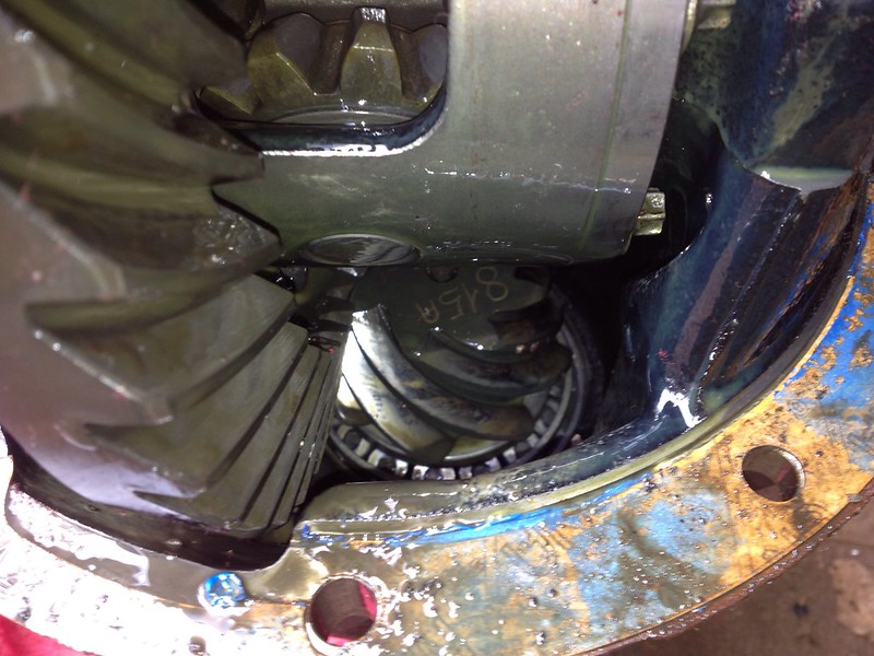

Big locker teeth
Other half of the locker teeth… from the back :doh:
(this is the part that moves to mesh the teeth together to lock and move apart to unlock)

After quite literally, minutes of planning, Aidan and I finally got to work doing thangs … Grinding and painting all the parts of the u bolt flip kit, as well as the new pass. side knuckle (caliper bolt is stripped and retapped), and fully assembling the chilkat actuators for installation…

Psh, leaky drum brakes, not anymore!!!
Ill have you know, we only dropped this axle one time while moving it into position hahaha.

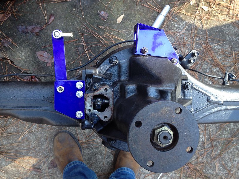

After spending many many more minutes convincing myself that the 60 series e brake would be wide enough for the new axle, it quickly became apparent, after i got a pin in one side, that it wasn't going to be nearly wide enough lol. Luckily, Rusty saved the day with its amazing parts. I got to learn how to remove/install an almost brand new 80 series e brake cable into a 62. That also gave me some good ideas on how to route the locker cables, so it turned out to be a good thing :)

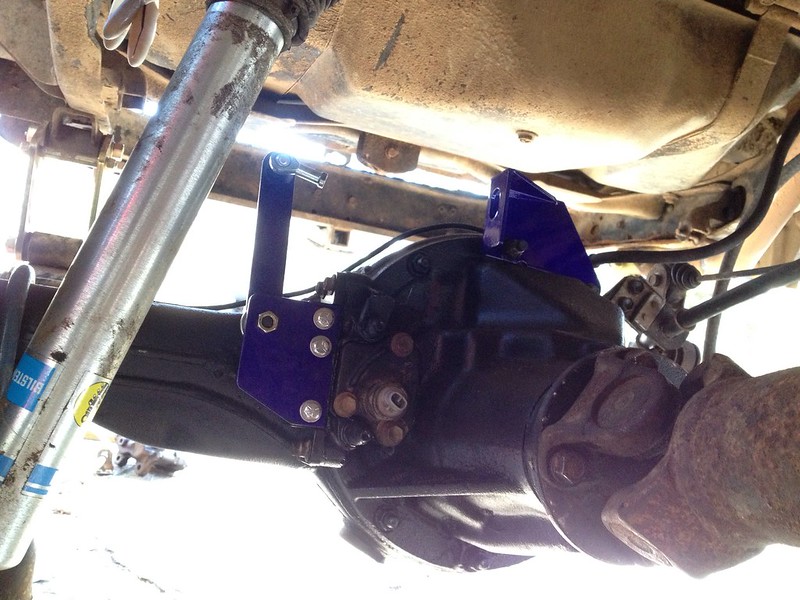

The rear axle brake line is another little annoyance, instead of connecting to the axle on the passenger side like it normal, the 80 series brake hose (and diff breather) connects right in the middle of the axle. Rusty has a wilwood proportioning valve right at the master cylinder instead of an LSPV. Im going to continue running the Load sensing proportioning valve, so Rusty had no easy swappable parts so i needed to sort of rig up a hard line + brake hose coming straight out of the LSPV leading to the axle. It will definitely need a more permanent location before any sort of flexing because the hard line will bend and eventually snap. Im looking to get a super fancy SS hose for that.
I was planning on replacing that little 3 bolt plug with a block off plate my little brother cut/shaped PERFECTLY (to my amazement) with a cutoff wheel and got powder coated purple, but after thinking about what the plug actually was there for (locker position sensor), i decided it would be a good idea to just add some lights in the dash that come on when the locker is engaged. Sad though that i didn't get it painted purple :o
Only problem i see is how busy the 4" section right next to the diff on the driverside is… Im supposed to fit the extended brake hose, e brake line, diff breather, fab up a mount for the LSPV arm, AND snake the locker cable through all that mess… WTF! :bang::lol::popcorn:

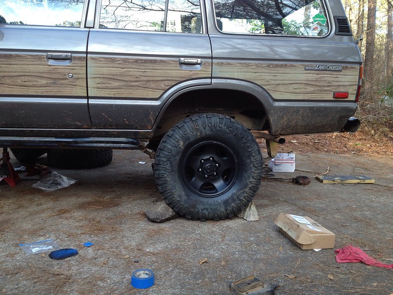

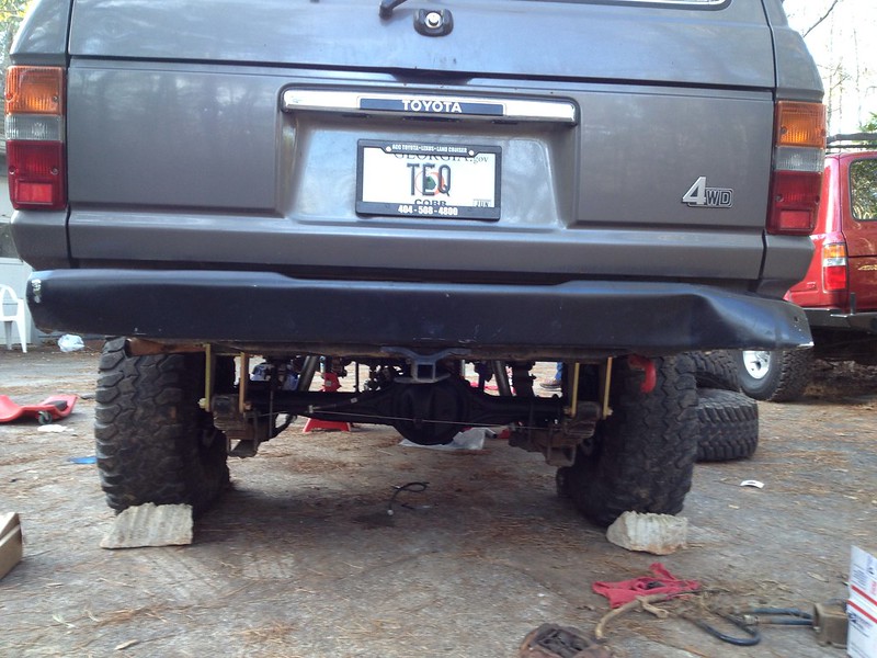

Super bald, weird sized (34x12.50r16) intercos looking mighty tiny in that spot.
And yes, i know that 80 rims on a 60 series looks a bit silly, they sort of remind me of those douchetastic Rockstar rims, but they are what I've got, so I'm running them until i get bored of them and try something different.
Got that Cruisa lean going on because that passenger side tire decided it wanted to be a useless flat instead of a FxxxING. TEAM. PLAYER!!!

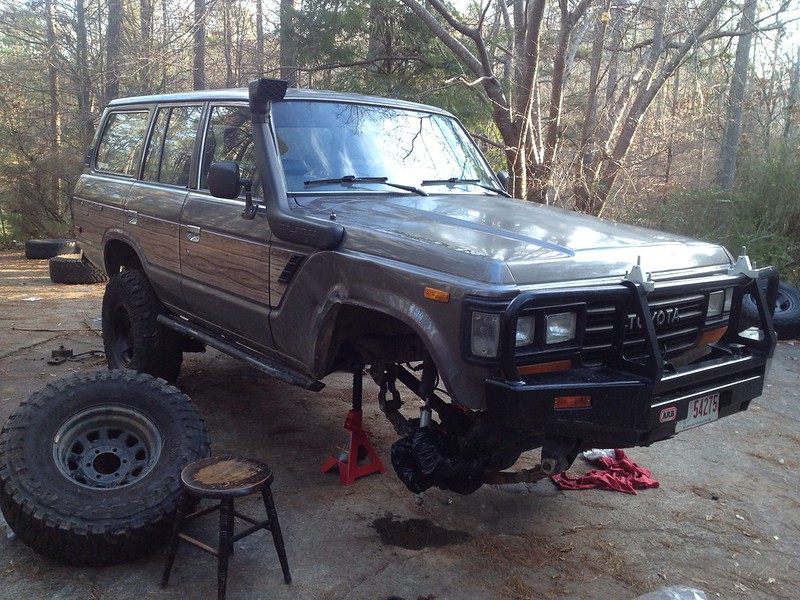

So now were about 40% done with the front, I didn't have all the red grease or diff fluid i needed and for some reason Autozone doesnt want to be open on Christmas??? so we stopped early after tearing out the old stock axles.
We probably should've done more (i.e. drained front diff, installed longer studs, shaved the side of the axle housing, installed new locked 3rd) but i was too annoyed at the front u bolt flip kit i got off rusty… because i have shims, the top plate didn't want to sit flat (parallel to the ground), instead it wants to point forward. Ive contacted LCwizard, so I'm seeing what he recommends. I may just buy new ones for the front. The rear part he sent me a few days ago is ALOT nicer than the older style kit i got off rusty that Dave probably made years ago.
