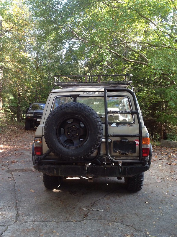

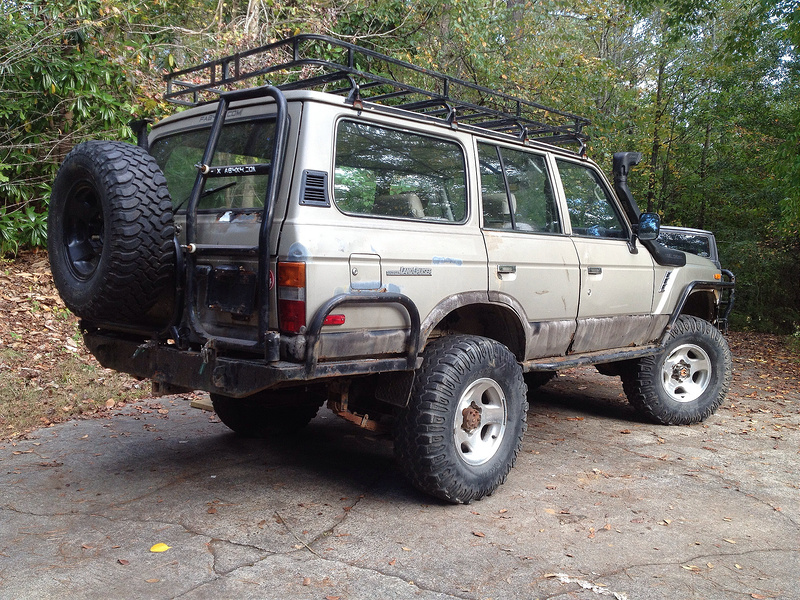

My Second Toyota... "Rusty". (I have no imagination... "Woody" and "Rusty")
1988 FJ62

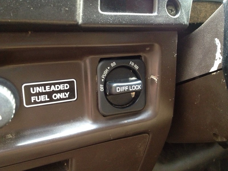

This thing has more switches than a space shuttle. But my favorite is this one..

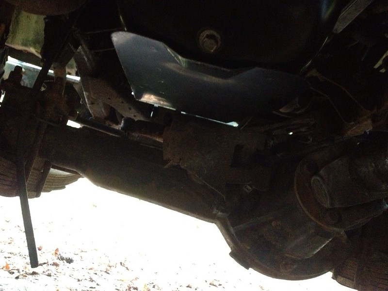

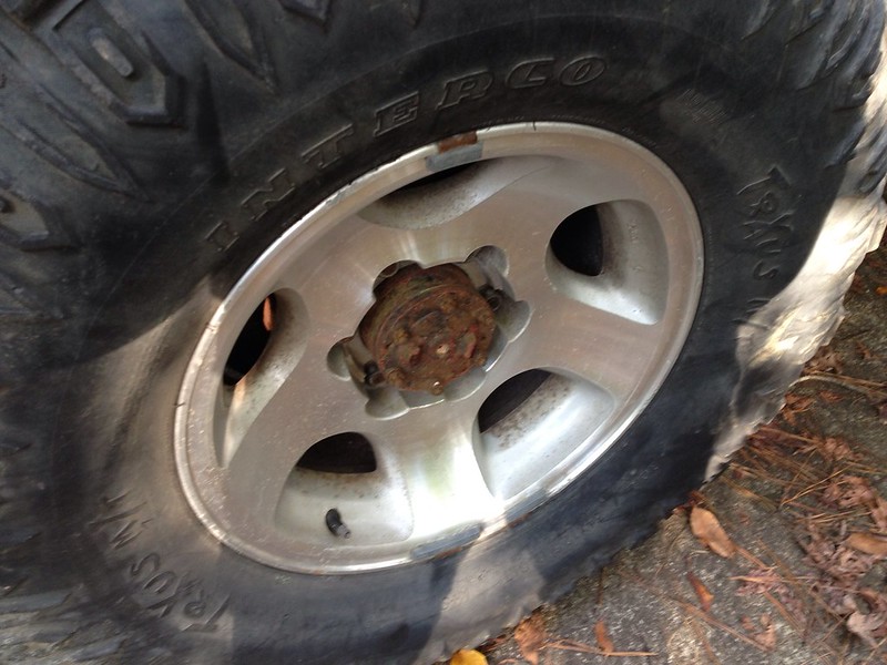

Front axle :eek:

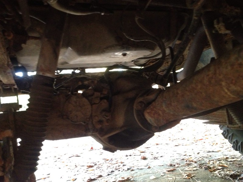

rear axle :cool:

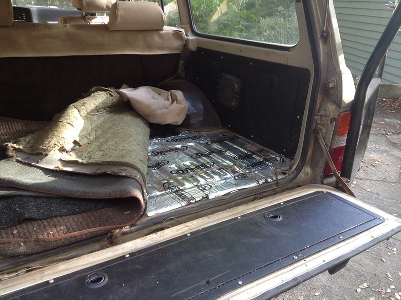

Trunk has more money in it than i spent on the whole truck :p I love Wagon Gear stuff!!!!

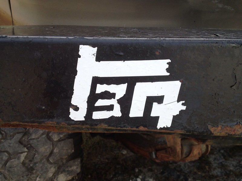

The Previous previous owner had good taste in stickers too:clap:

Im still in awe that i actually got it... I was really not expecting to buy another truck this week :cheers:
holy s*** yeah.. love it!!! sttip all the good parts and build up woody!!!
Lol hell yeaaa! When looking at the Craigslist add, you got the feeling that guy selling didn't know anything about it. He really didnt talk about any of the big important parts. So I was irrationally hoping to find a nice shiny new 12ht under the hood lol. I'm still hoping to find longs and a new gears in the diffs when I rebuild that stuff haha. One can dream... Hahahaha

- truck is locked front and rear with fzj80 rear e-lockers and wired to a fzj80 locker switch on the dash. And wiring is from the stock harnesses and wired to a control box that is mounted in the dr. side rear quarter panel
- the rear is a 94’ fzj80 axle with e-locker full floater and disk brakes
- the front is a stock 88’ fj62 front axle housing with a 97’ rear fzj80 e-lockered 3rd.
- long fields
- sky wideing kit on front axle to make the width the same as the rear fzj80 axle
- both axles are running Yukon 4.88 gears
- both axles were rebuilt with new Toyota parts and have less than 6,000 on rebuild. Nothing was wrong with them at time of rebuild just figured while I was in there I would put new bearings seals and gaskets in.

- Dynamat extreme sound proofing has been used on t The insdie floors /walls /doors/ and tailgate 3 full bulk packs used
