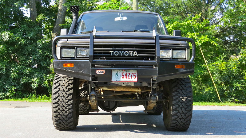

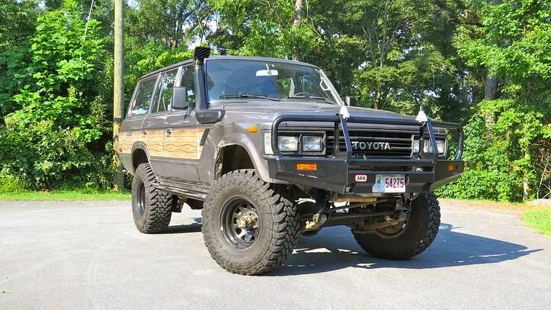

Finished pics...
looks pretty good IMHO :D.

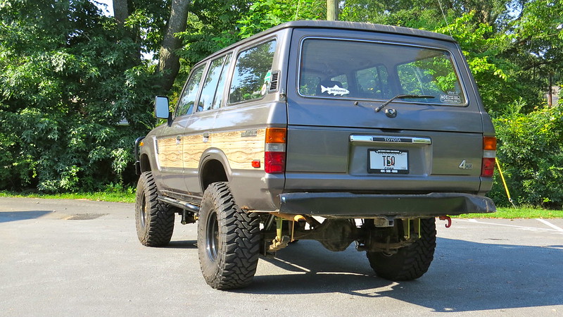

Big ol' shackles... Seriously, they're HUGE haha.
front shocks (bad picture, adapters aren't even in the photo haha)

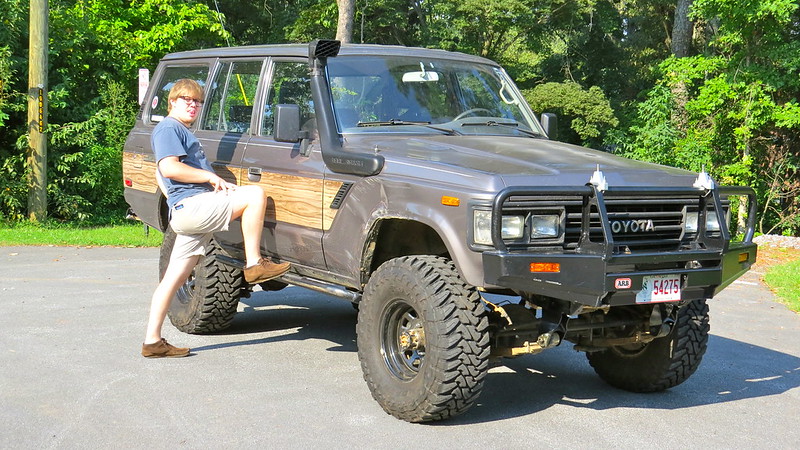

And to give you an idea of the height of my truck (I'm 5'11ish)
Oh... Do y'all not take pics like that with your truck... YOU GUYS ARE THE FREAKS, NOT ME!!!!!!!!!!!!!!

That's really tall, unless you lower your bumper a notch it looks like the average small car will go right under in a head-on collision; but you might lose approach angle...
P.S.- Does the lower part of the bumper block your headlights at all?
In case of a head on wreck, I'll make sure to aim for a 1/2 ton pickup... so it's fair.
Edit: No, headlights are not blocked. Blinkers are though, but they're on the bumper as well so it doesn't really matter.
Patrick do you have a pic of the shackle angle in the front? Just curious, as the Ironman leaves are longer? Your rear angle looks to be similar to mine (straight up and down). How does she ride with the Bil's?
I was curious as well as to what angle the Ironmans would give me, but it's pretty much vertical. But some pretty smart cruiser guys told me to not worry about it, so I'm not haha.

sweet looking rig man, have you measured how much up travel you have in those shocks? Using the stock mounts I really doubt that the 12" travel shocks will cycle correctly.
measure the distance from your bumpstops to the axle and compare that to how much shaft you have exposed while at rest. You do not want your shocks to bottom out before you hit your bumps.

craaaaaaaaap... i see what youre talking about. I was wondering why the boots looked so scrunched up even when they were on level ground lol. looks like ill be going back to acc to measure travel with the shocks attached this time and see whats what. Thanks for looking :cheers:

ok, but don't flex it out with the shocks on it will destroy them.
you need to do this up front:
1980 Ford F250 shock tower
part # E5TZ*18183*A
then you're gonna have to inboard the top mounts in the rear kinda like this:
or you could get crazy and bring the mounts into the cabin like I did for my 14" travels... but don't do this, total PIA
all in all these mods will get you a ton more travel, you really have no choice because you as of now have no useable uptravel. Make sure to get extended brake lines if you havnt already.

edit: Robust can you post a pic of your rear shackle, it looks like it's straight up and down.

edit: Ill get the pics up of my perfect shackle angles tomorrow ;)
