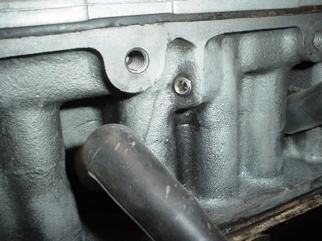

Location on head. Above and slightly to the right of the 5 plug hole from right to left (or front of block to back)
It's a known potential problem on 2f motors that this plug can fail and fall out. It's an alumiunum plug that covers up where Toyota had to drill an oil passage so they could route the oil up to the top of the head through one of the head bolts.
If it fails it will allow oil to come out. Ususally all of it. As Mark W said "It's on the opposite side of the exhaust so usually there is no indication that it has failed since it doesn't hit the exhaust". When this happens your engine locks up and means an expensive rebuild.

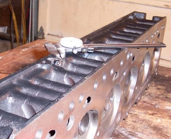

The fix. Drill out the plug. I used a center punch and then drilled it with a 1/4 bit and then stepped up to a little larger size. About half way through the plug started rotating and I pulled it out with the bit. The plug is right at 7mm wide.
I have seen a few people who tap this out with an 8mm 1.25 tap. I chose a 5/16 tap just because I knew and allen set screw would be more availabe in this size. A 5/16 tap requires using a f drill bit. Where the 8mm tap doesn't require any more drilling.
Basically drill and tap. As a note. I have the head off. Some have done this with the head on. If you do it with the head on you want to try to keep any metal shavings out of the head. https://forum.ih8mud.com/showthread.php?t=113830
Make sure you use cutting or tapping oil. Go slow turn. Once the tap gets in a few turns and is good and centered it good to turn in a 1/4 turn and out a 1/4 turn then back in a 1/2 a turn. This will minimize a tap breaking. Then screw in the the set screw with some red thread thread locker or pipe sealant.

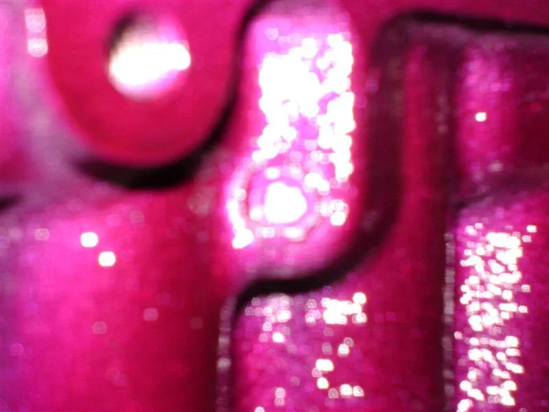

This is the other side of the plug. This is where a headbolt goes.
And the other side. This is where the oil galley to the head is. It goes into the rockers to provide oiling.

Now I know what a 3F combustion chamber looks like.
That's a 3FE combustion chamber with oversized Ferrea flat faced vlaves, ported and polishes and not stock:D
Lot more pics of the head on page 4 of the Mule or see links below.
I'm sorry, but that looks like a still pic from a colonoscopy:eek:
You're not supposed to know that, Ed. I was thinking pseudomembranous colitis...
Yeah originally I had this pic as the first one. Once I saw it I thought it might scare people away. Though kind of fitting in a gay way.:D

Calipers
Oh those, Marshalls' digitals. Ya, I use a set of Starrett digitals all the time at work. I prefer the ol school dial calipers myself (no batteries). Na I didn't say anything because the ol Trollhole was using communist, I mean metric units. Started thinking you guys are making sense (maybe trusting the alu plug is not such a good idea, went out to take a look at my rebuilt head and Lou and behold. looks like Bearing Service did it for me (dang, maybe those guys know what their doing.) I was wondering Marshall, Did you drill and tap all the way through? Because the set screw will work best if it has something to bear against. And that would be the head bolt then. The loctite red should do it, hell, epoxy or jbweld. The darn thing never needs to come out again.

Nope just about half way. Just need to be able to get a good seal. Oh and I have a set of dial calipers I got those at Northern Tool.:D Unless it's a tool I use a lot I'm not forking cash out on it. Plus I'm not kind to my tools. I'd feel real bad if I stepped on and broke a nice tool.
