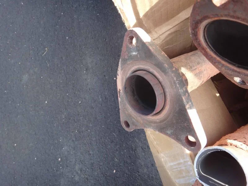

I did have one question and sent it to Baktash suggesting he include instructions. The install is pretty straight forward, but I was stalled for a bit
The point where the midpipes attach to the Header had me stumped for a bit.
The OEM midpipes have a groove and an extension of the pipe like shown in the picture. This enables use of the donut type OEM gasket. EMS midpipes are flat with no groove. I played with using the gasket, but it didn't seem to work. I ended up bolting the flat EMS midpipes to the Flat DT headers with no gasket and tightened it down. Seems to work fine. I am assuming if I had a leak there I would hear it and it doesn't seem like there is anything.

I shipped you a new pair of the donut gaskets that go between the midpipes and headers.
Here's a photo of the donut gasket situated on the header flange. The EMSPowered midpipe does not have the pipe protruding out of the end like the stock midpipe. So when you are doing the installation it helps to out something sticky such as a very small dab of RTV on the donut gasket to keep it in place on the groove in the header flange while maneuvering the midoipe into place.

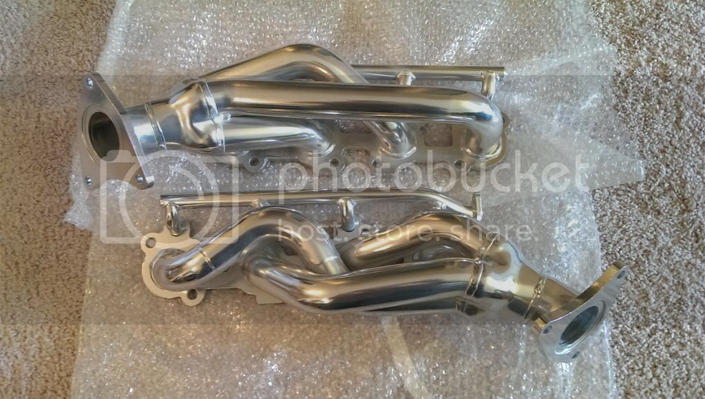

Do we know the DT headers have the Groove, I thought they were flat? The OEM midpipes also had this groove but yours did not
Great info, and thanks for sharing.
Thanks Rob, I didn't get those gaskets in my shipment. That's where the instructions would have told me I am missing something
Thanks Baktash for getting those out quickly.
Good question. I know the stock headers have the groove. Not sure if the DT headers do or not from memory.
Looking at photos it looks like the DT headers have the groove like the stock headers.

DT headers do NOT have the protruding pipe to center the gasket. I'm speaking about the second run DTs.
The header flange shouldn't have a protruding pipe. It should have an inset groove. Take a look at the photo I posted above of the stock header flange.
The header flange shouldn't have a protruding pipe. It should have an inset groove. Take a look at the photo I posted above or the stock header flange.

Here is the way this setup was designed by Mr Toyota
This stock mid pipe has a grove to hold half the donut style OEM gasket. It also has a protruding pipe to hold the gasket to insure proper placement for seal

The headers (DT Headers in Pic) also have a grove to hold the other half of the OEM Donut gasket
[URL="http://i135.photobucket.com/albums/q151/masimatt/IMAG0213_zps2d0d05b0.jpg~original"][/URL]
Now picture the Donut OEM gasket riding the small pipe half in the mid pipe and half in the header making great contact. The flat part beyond the center can have a gap or be touching as long as this type of seal is in place
