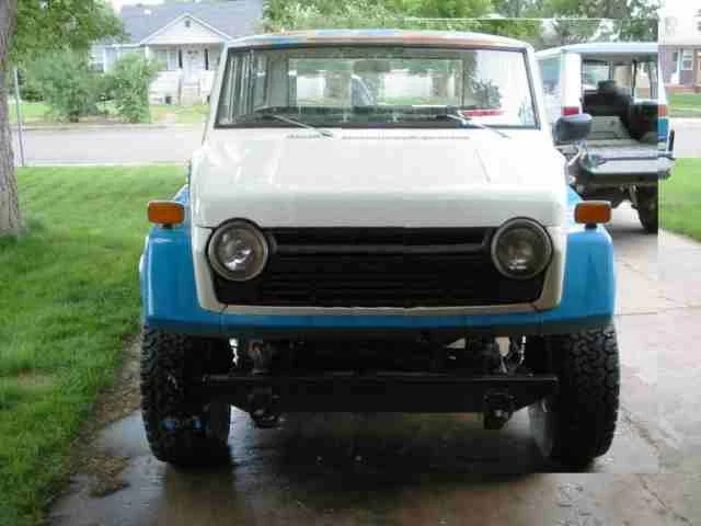

Gumby, what do you mean? Did you already trim your fenders and relocate your axle? In the picture I posted, the 37" MTR's stuff perfectly in the fenders. I will probably bumpstop them 1/2" out just to be sure. I wanted to go with 40" tires thats why I am looking for people that have or are willing to move/open the wheel wells.

I've got 37s on my SOA/coiled pig and it needs considerable axle relocation and fender trimming to get them to fit.
With 37s i had to cut all of the lip off and hit them pretty hard in the front and rear when stuffed.
I even hit them with 35s a bit.
When I did the coil conversion i moved the axle back and I'm cutting the rear of the fenders even further.
With 39s or 40s you'll have to loose the inner wells and fab new ones if you want to keep it anywhere near low.

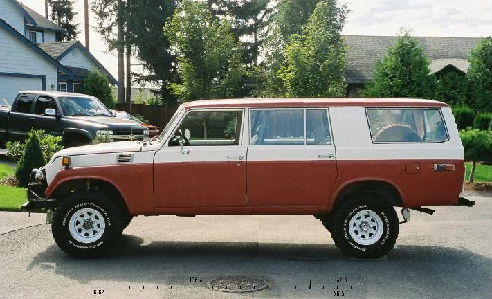

Well I was bored at work so I did another chop from scratch. I lengthened the doors by 6.6 inches each and added 13.2 inches to the rear behind the door, Giving us a good towing length of 132.7ish. I think I like this one the best, except for the FJ Cruiseresque C piller.
My main concern for these is the glass. The rear glass and a gasket would be a bitch to find or make. I figure the door channeling and what not wont be that bad to figure out from JCWhitney.
It'd be a major bitch to do, but I gotta think both the front and rear passengers would benefit greatly from some added door length. The B pillar is right in the way for a driver of any height. You don't want to add a 3rd row or haul a sheet of plywood and 5 people, you could have a lot of rear leg room too. Another 13 inches of passenger compartment would go a long way.

glass for a pig is easy, its all flat other than the windshield. as for custom gaskets, they can also be made. almost every cross-section is available from the distributor we get auto glass from in bulk rolls.
just food for thought, carl

I have always wanted to do the exact same thing but with a 45 pickup. I really don't have any photoshop skills, actually I just downloaded photoshop last night and started playing around. Here is what I have come up with.

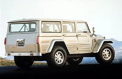

You would basically have to do what Rod Millen Motorsports did to make their custom rig, they used old 45's and widened and lengthened it. This the rig that actually got me first interested in doing an old TLC wagon, then I found out about the 45LV's. I also included a pic of a crew cab 45 that is out of Brazil. The only place they ever made these. :mad: This crew cab was sold by TLC for supposedly 85K.
