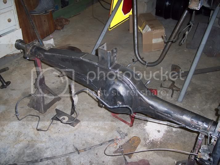

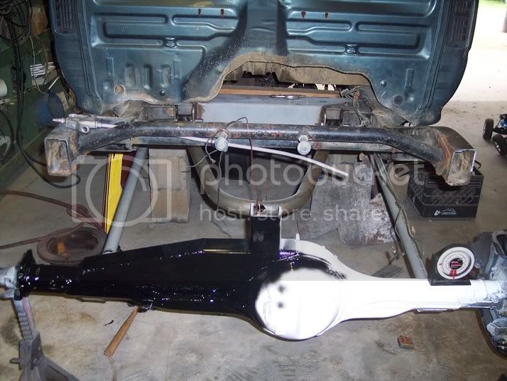

After I got that to a point where I couldn't continue(due to the threaded end) I started wire wheeling the rear axle and the diff so I could paint it and get it finished.

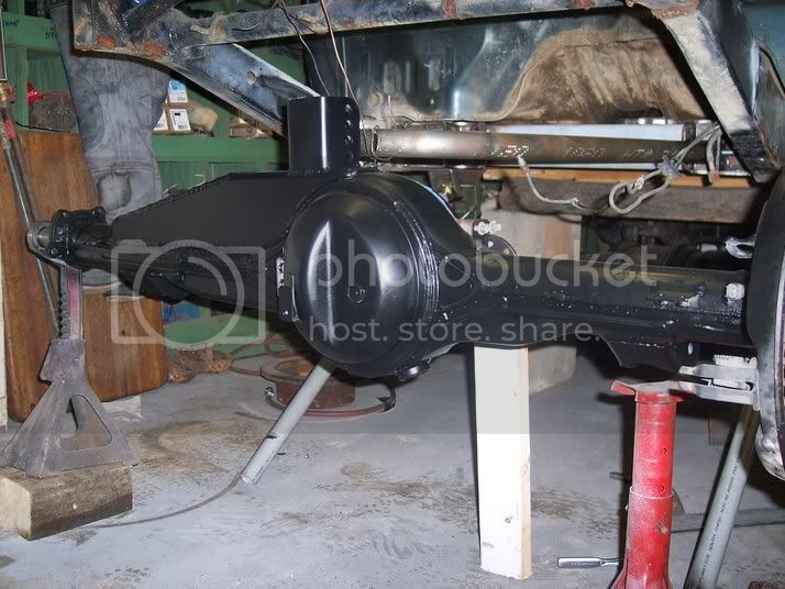

Once that was done I reinstalled the rear 3rd and painted it. I shot a good coat of rustolem and then some gloss black.

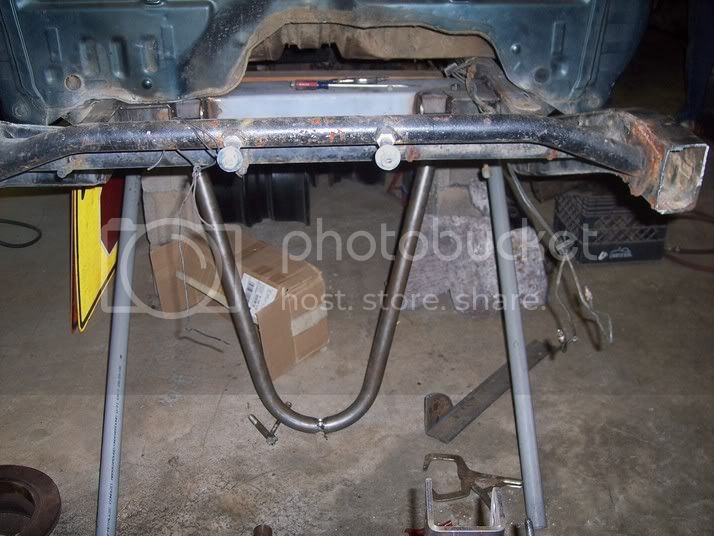

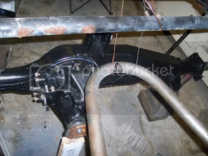

Well, after a much needed vacation, I am back at it. Bud dropped off the piece to my upper link that had to be threaded yesterday. Today I had enough time to use the hot glue gun an put it in its place. I haven't had time to build the gussets for it yet but, I have a good idea of what I want it to look like.
I figured out that my lower links will be around 45-48 long! I also determined that I can lower my rig another 1 or 2 inches.
