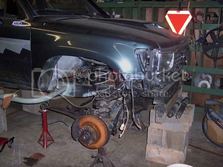

I also brought the truck cab/frame up into the shop and started the cleaning of the frame so I can mount my brackets. I have been toying with the idea of running a 3.4L and coils up front as opposed to air shox and a 2.7, whatcha think?
go for the gusto man, put in a 1uz or 2uz V8. Little bit more difficult but the badass factor is through the roof.

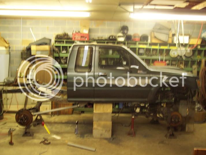

I actually had to go 4" higher than I am in these pics(31" to bottom of frame rail is still pretty low for 38's)

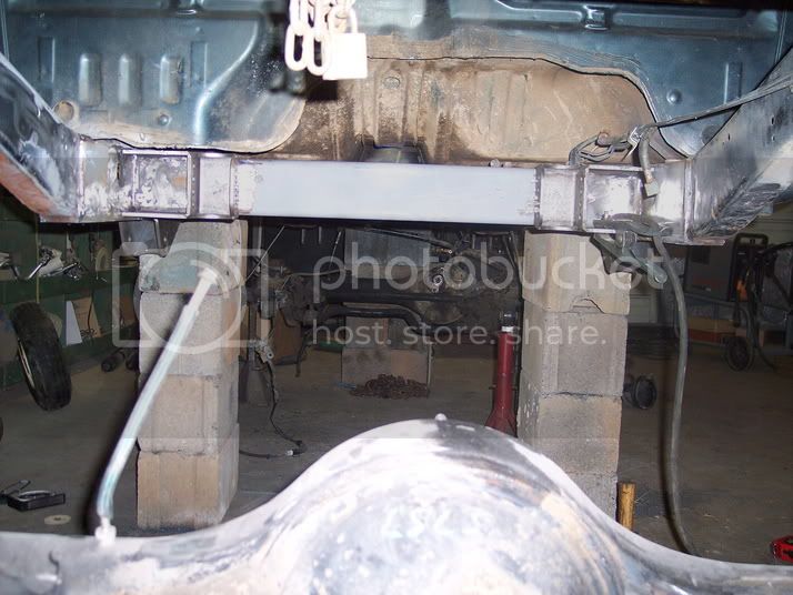

The X-member will be notched for d-shaft clearance

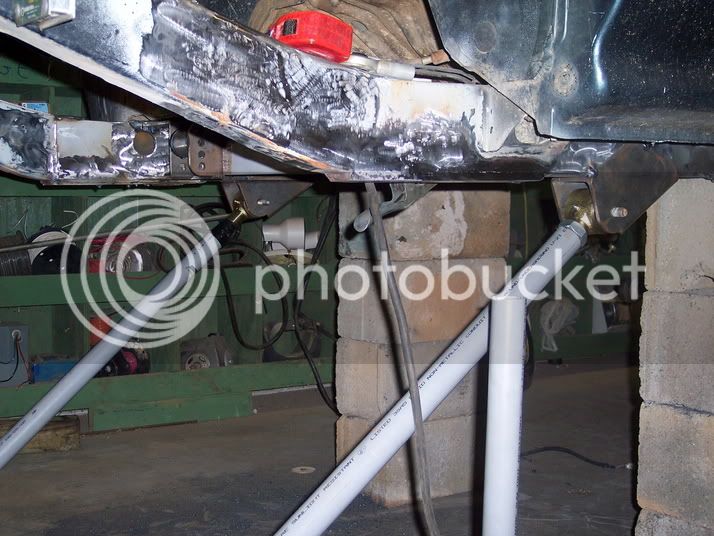

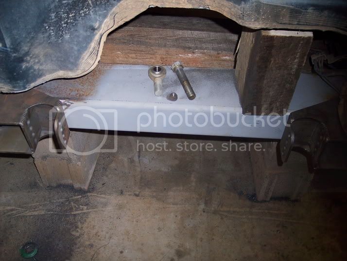

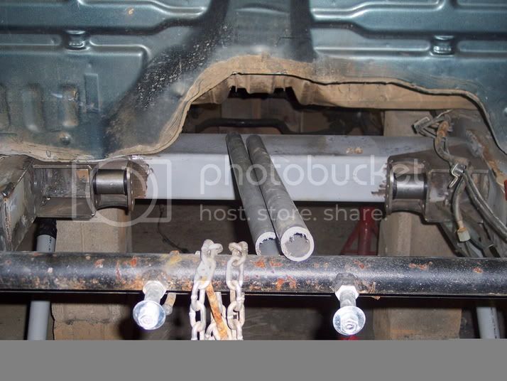

Upper tri- 3link monting brackets(tacked in place)

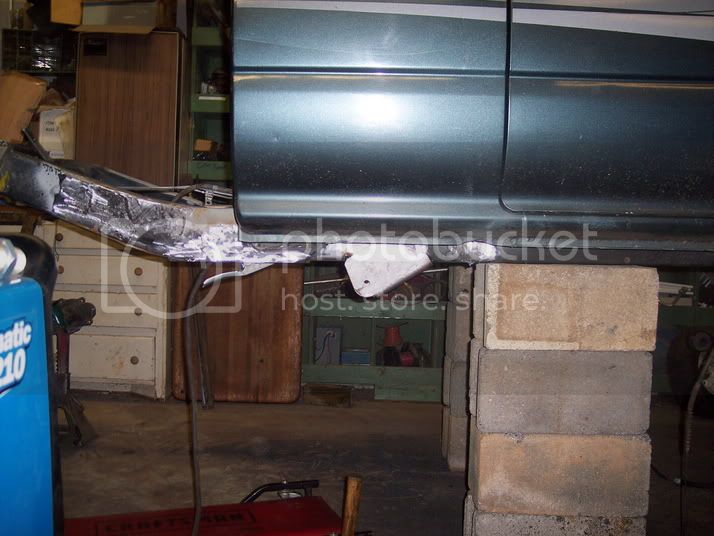

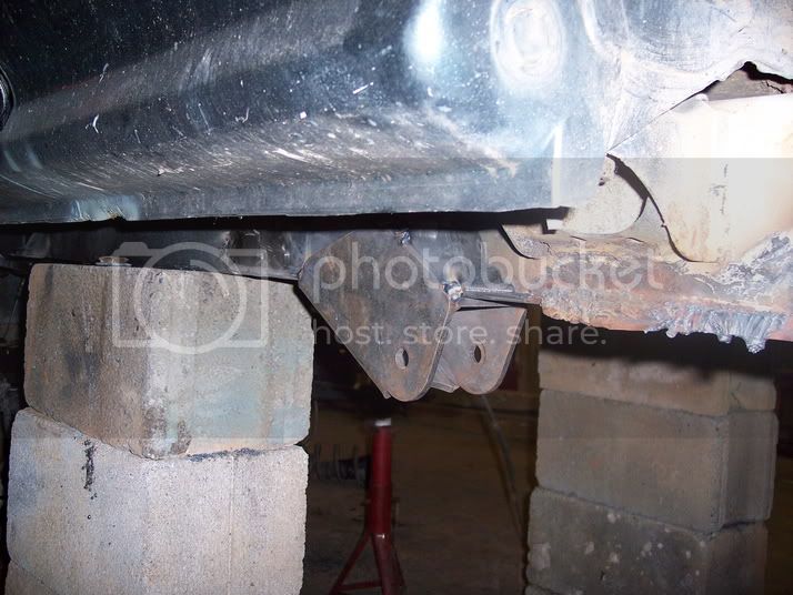

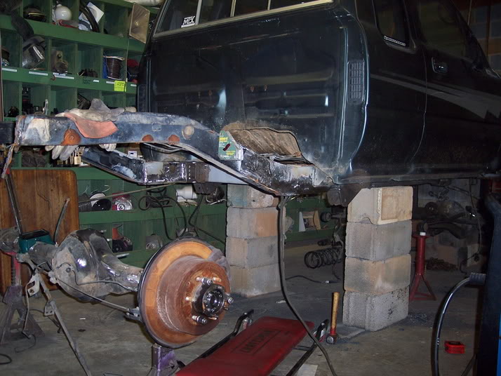

Lower link mounts (pass. side)
Rear view
lower link mount(driver side...I see grinding that needs to be finished)
As far as powerplant's go...I'm going w/ a 3.4L and coils up front....the V-8 is too heavy
actually the 1uz is an aluminum block and only wieghs a c hair more than the 2.7 four banger. Not that I'm trying to steer you away from the 3.4, it deffenitly is a great motor. I just have some sick infatuation with the 1uz. Keep up the good work, looks like its going to be quite the capable trail rig.

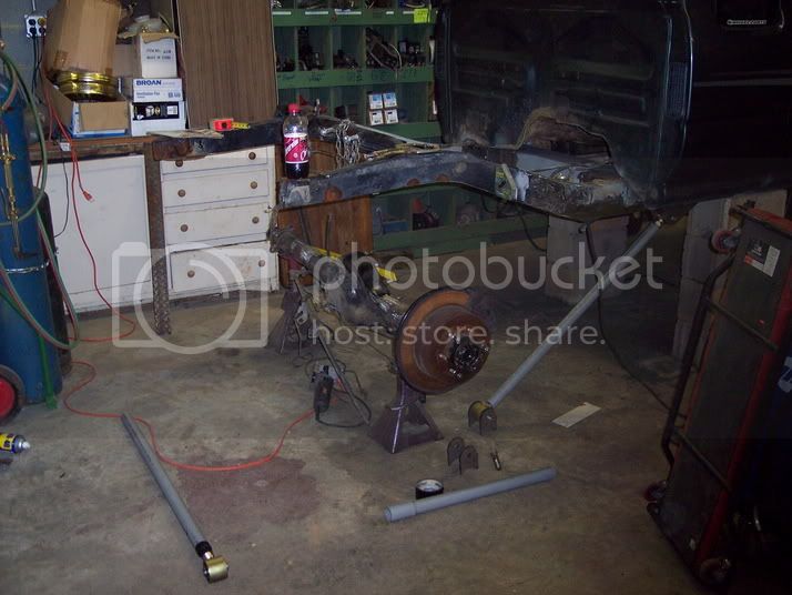

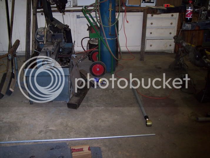

It makes mock up so easy...think about it-tubing cost 9.00 a foot(for what I'm using) PVC conduit is VERY CHEAP(I'm an electrician) and light :)
Progress 5/18/06

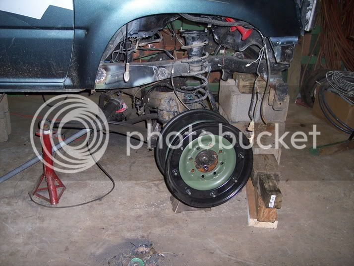

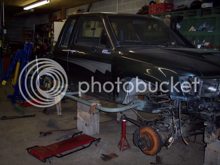

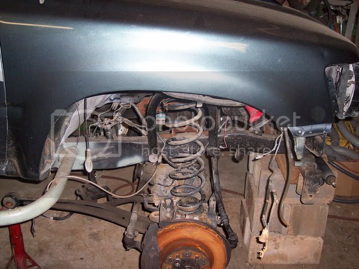

I set my frame height tonight. I am liking 28.5" to the bottom of the frame rail. I have roughly 6" up travel (rear). I cut the old shock hoops out from under the front end and ground the slag off. I determined that I am probably going to need to reinforce the front end(due to the coils). But since I am dovetailing the front clip I think that I'll just cut the inner fenders completely out and rebuild it with tubing. Attach the fenders/hood/winch/grill/headlights and all my fender mounted engine components to the tubing(after writing all that down it sure seems like alot of work) I want to put a stinger on there too.

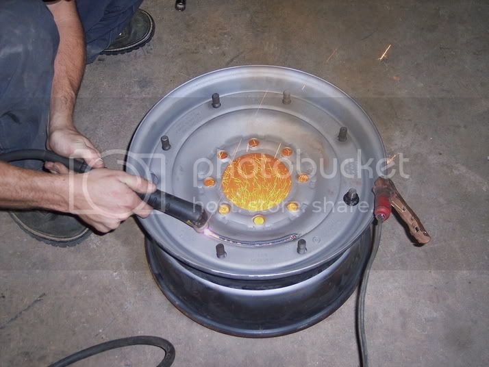

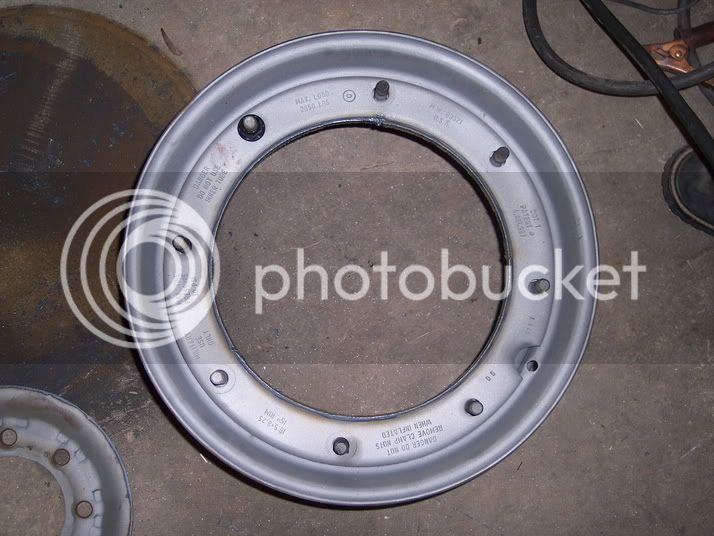

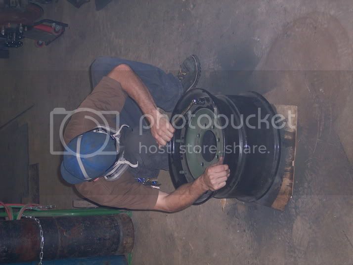

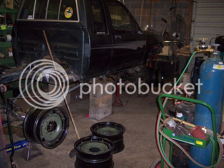

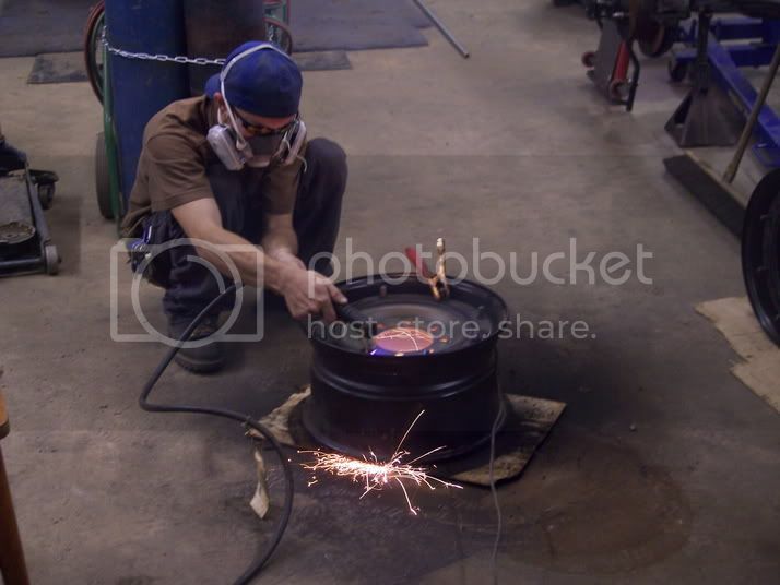

I'm gonna go and pick up my wheels tomorrow... :) I got 5 H1 DBL beadlocks that have been sandblasted and por'd for $225! HA! I am gonna order some 6lug centers in a day or two.
