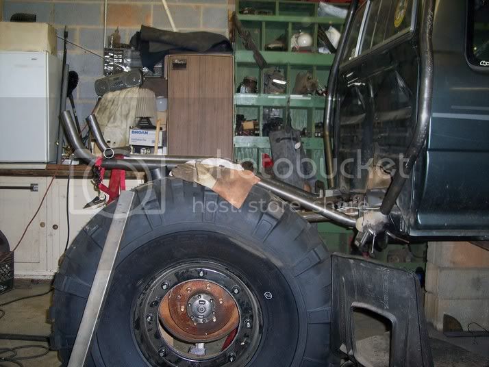

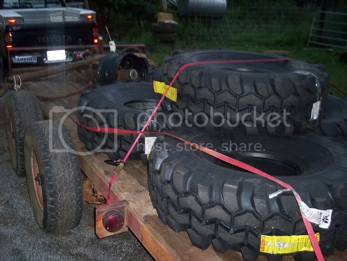

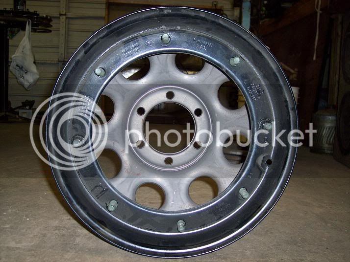

I got my tires!(5) 42x15x16.5 TSL's(thanks interco!) I am trying to scrape some $$$ together for my wheel centers(6-lug for the H1's)

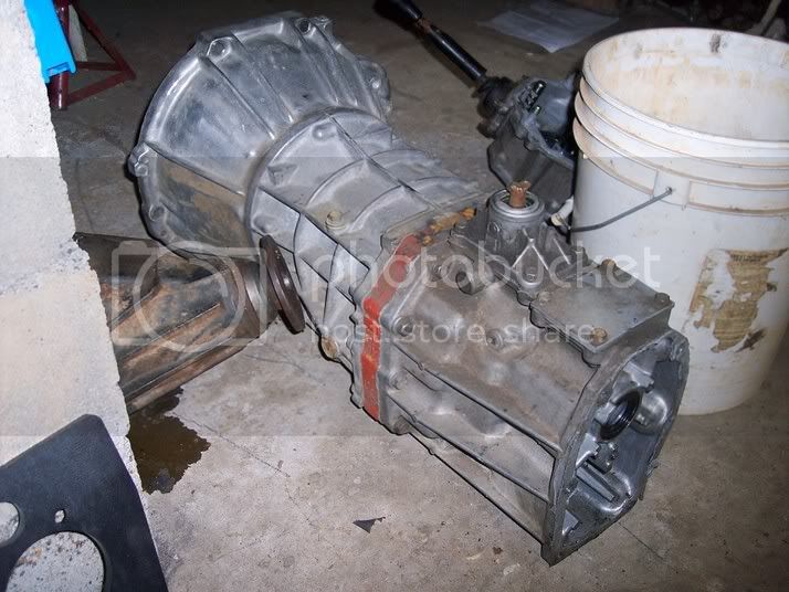

Last week I got a kickin' deal on a R151F with T-case...so it came home with me(oh BTW: FRESHLY REBUILT!) T-case isn't picured

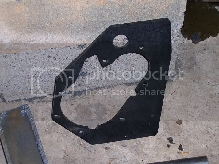

I stopped by Bud's( www.Budbuilt.com ), I told him what I got, then I got this from him :D

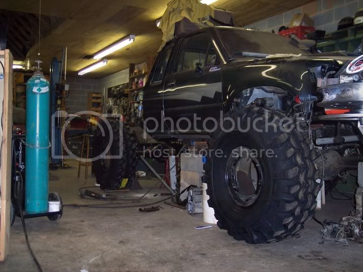

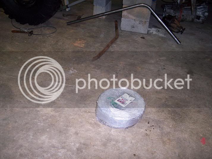

I also got a donation to my project...I got a free Co2 tank! I sold my york210 to a buddy, and now I've gotta buy a regulator. :D

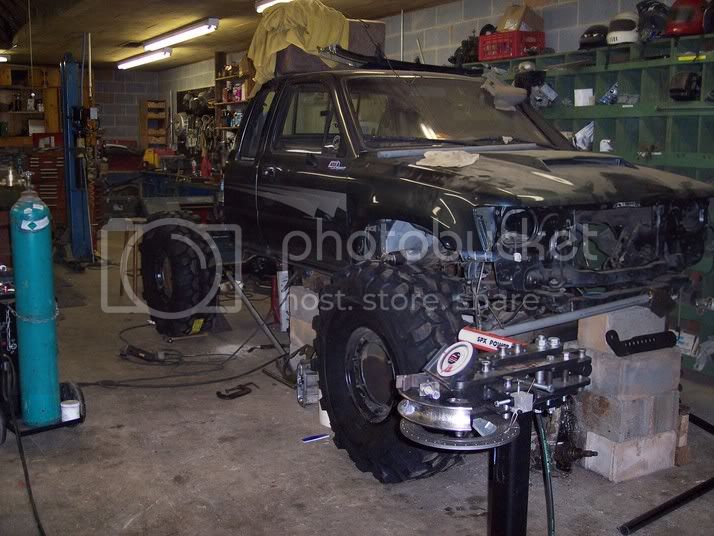

I've got my bender now but I couldn't do complex bends with rotation...I can now. I took some initative and built the tool to lock on the tube so I can measure the degrees I have rotated.

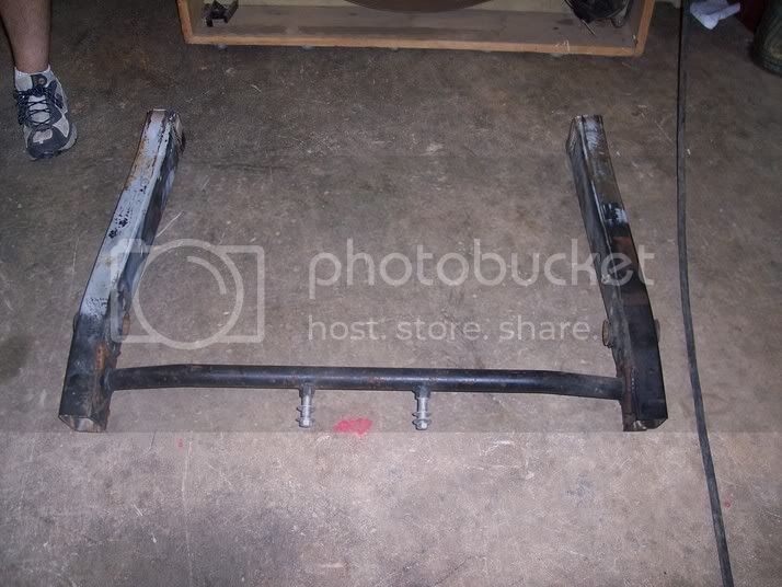

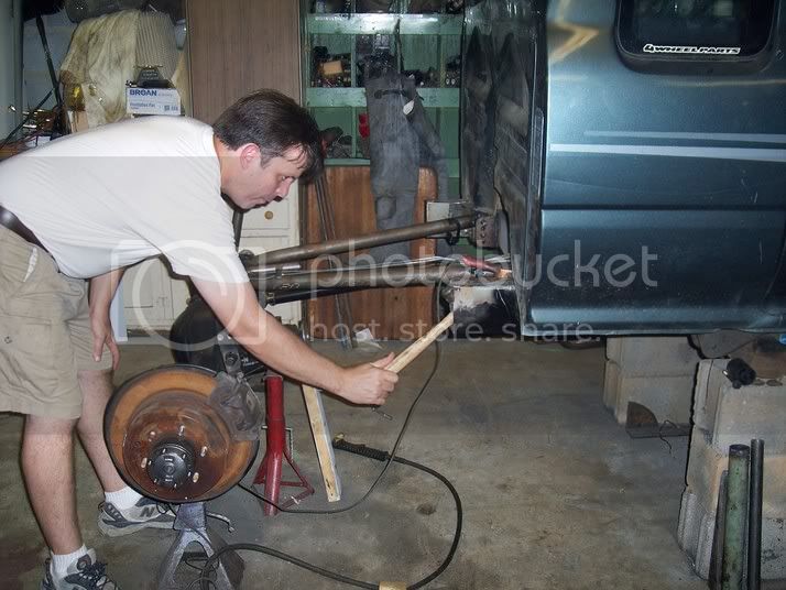

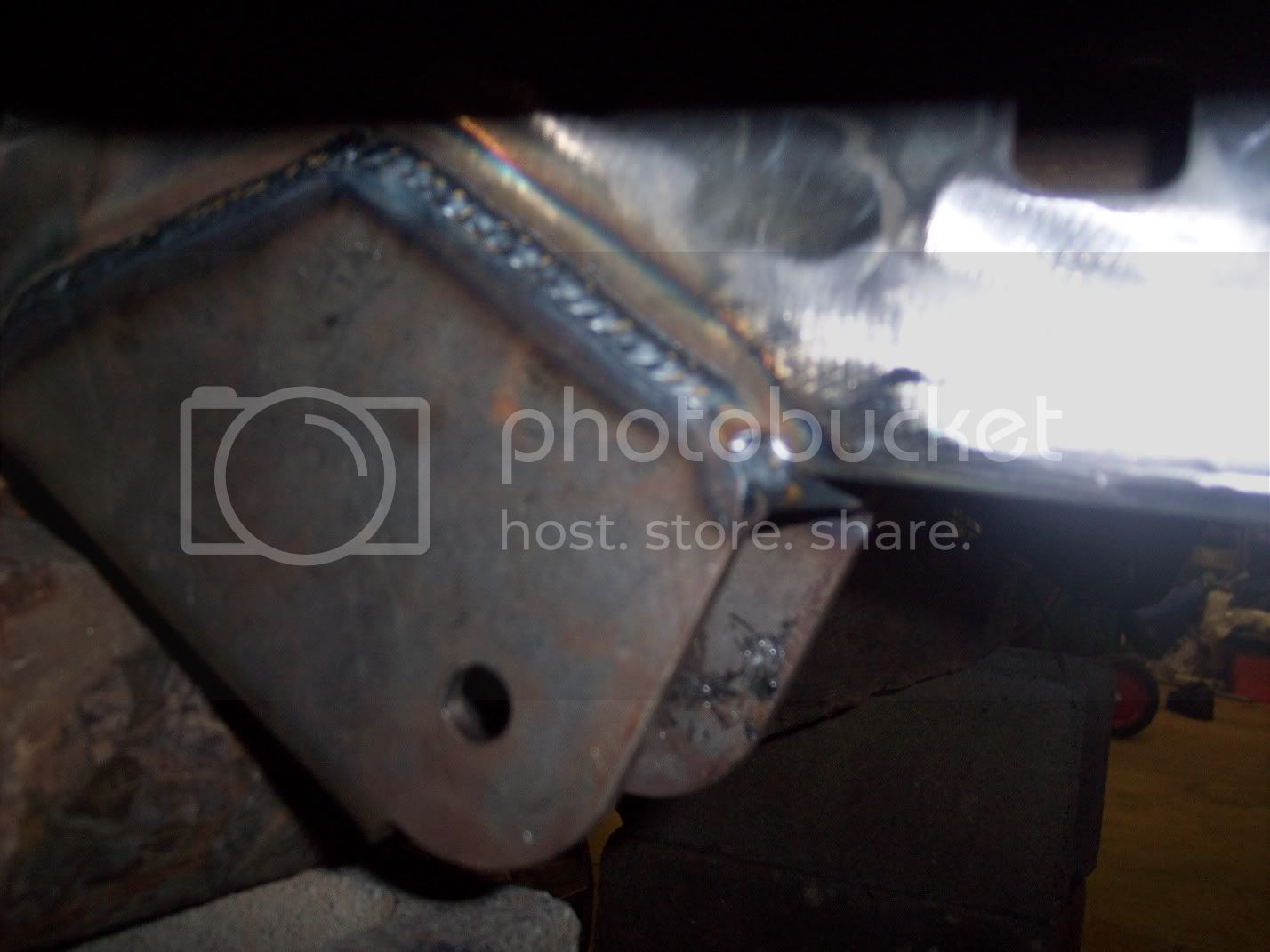

Tonight I finally burned in the rear lower link mounts...wasn't too bad. They are PERFECTLY ALIGNED!
SMOKIN'

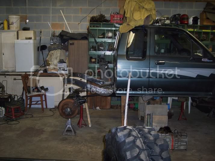

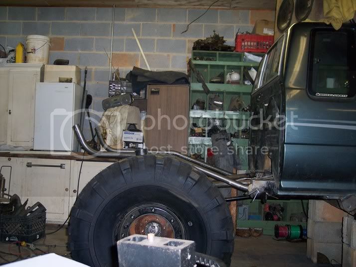

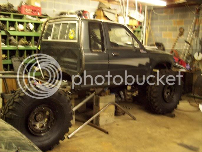

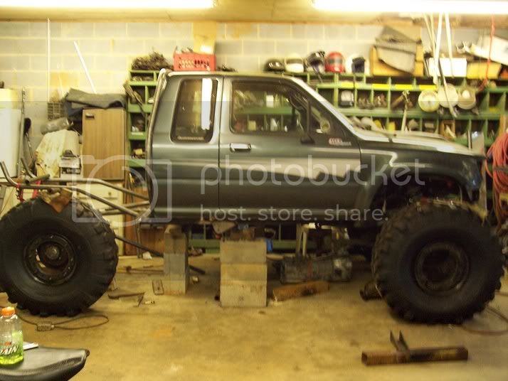

I have been contemplating installing a 1.5" body lift onto my rig. Mainly because of the MC08 R10 and wanting a flat belly. I cut down 3" body pucks...they ended up being 1 3/8" after leveling them up. I still don't know if I want to do this or not though.
But here are some teaser pics for ya!

I just got off the phone with USA6x6 and now I have 5 6-lug centers and O-rings in the mail.:cheers:

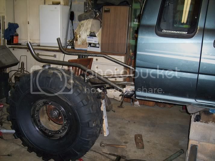

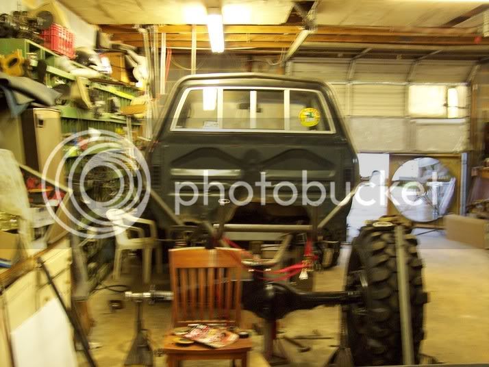

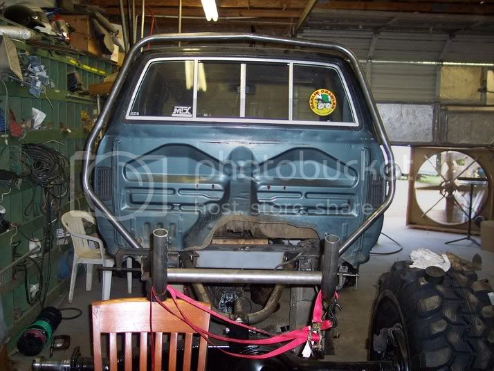

Still making progress! I got the 1.5" body lift on(I know it isn't that much work)

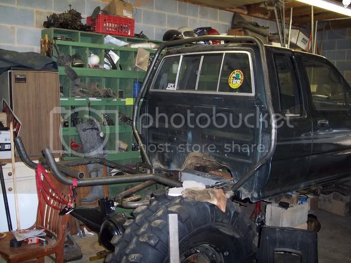

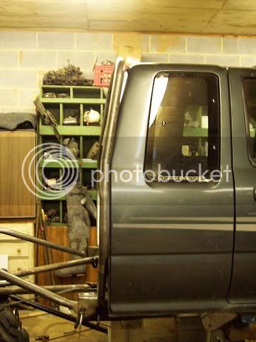

Here you can see how well the main hoop follows the cab lines
Sweet
I like it. The bends look sweet. Multiple bends are confusing. I'm not smart enough to do them.
I like the tubing. What did you have to give for it? Was is cheaper than DOM?
JR.
lowtideride said:
How hard was it bending the tubing to follow the cab line? lookin good man.
I took me all day long...9 bends 6 of them complex(rotation)

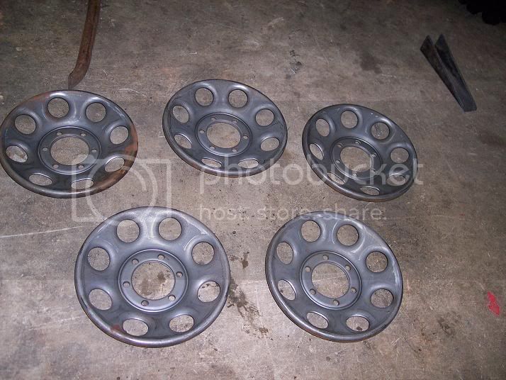

So, FedEx came by the house today. Again. And once again, they left me a present.
I opened it and guess what was inside? SWEET! My 6-lug centers!

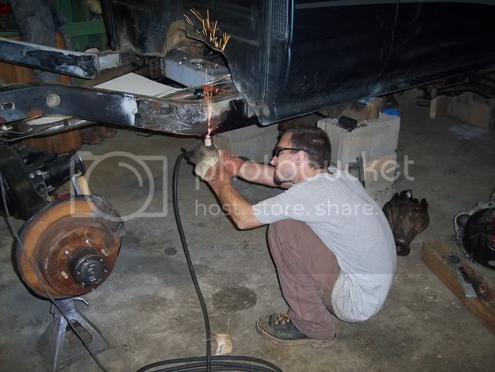

I finally took the time to breakout the grinder and smooth up the edges where I plasma cut the factory 8-lug centers out. When I cut them out I couldn't cut close enough tho the edge without a risk of cutting too much out(geez, that sounded repetative). It left about a 1/8 of an inch all the way around...it took me about 30min and 1.5 grinder discs
Before:
After:
