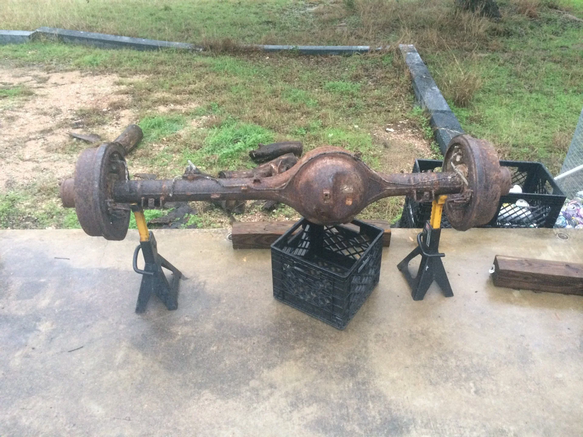

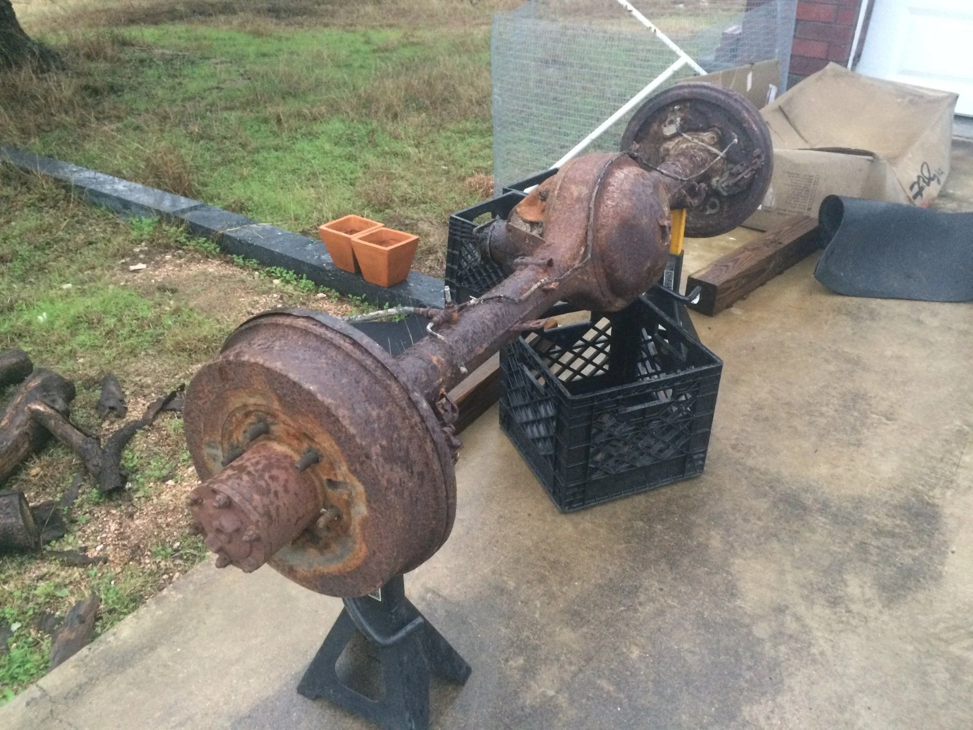

I picked up a full float 40 axle yesterday. Thanks @joekatana! It's going to need blasting, paint and a full rebuild. It's probably way overkill for what I need but I want all my vehicles to be full float front and rear. It's what I am used to working on and it makes changing tires much easier by resting the wheel on the hub. I also bought a HF sand blaster over the weekend for this project. Should have time this coming to weekend to play around with it if the weather clears up.
