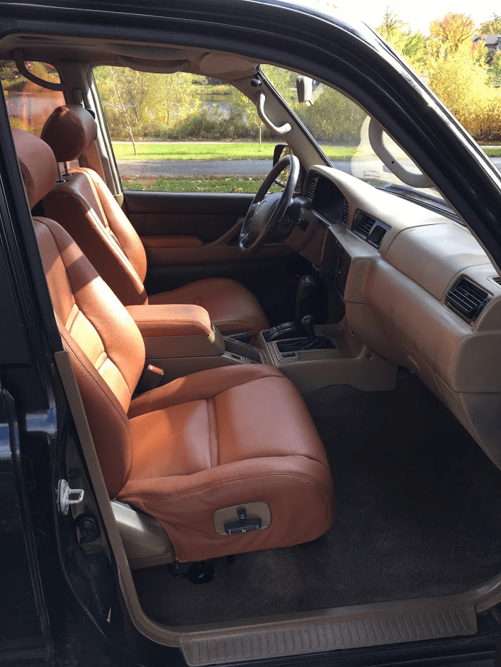

First Test Piece. Proved it could be done.
Final interior. You'll see some blue/grey pieces still prevalent - notably the steering wheel. Pieces left were done intentionally as they were either very hard to attempt to remove from vehicle (door handles) or were a hassle for minor impact (seat belt buckles). I ended up liking the blue/grey accent pieces to break up the browns throughout - adds a sort of era-appropriate styling. The steering wheel is actually in very good shape - still smooth and conditioned leather. Re-leathering is doable (plenty of videos online), but I didn't want to mess with it as there was plenty else going on with this project and it doesn't need replacing.

I bought the seat kit for the front and back seats (not third row, no putting them back in) from Lseats. To break up the lighter trim and sort of grey/brown capret, I went with their Tan color, which is more like a basketball in color I'd say. Redoing seats is a job. Boy. First time I ever used a hog ring pliers (first time I knew one existed). Not fun. While I had the front seats out I worked on their motors/gearing.
Bought some new weird white screw things (you know), and then cleaned/de-haired (yeah, 20 years of crap gets in those worm gears) them before re-greasing them. Before, both seats had a stuck gear so moving back and forth was futile. Now they both work (though I'm careful to gingerly and infrequently move them as they will always be finicky).
Also had the seat belts rewebbed so they matched the new interior, plus they retracted like crap (front ones - most used) after years of absorbing dirt and grime. Rewebbed belts look great, pull and retract smooth. If yours are original and retracting slow, it's likely the webbing and not the actual mechanism. Send them to Safety Restore like I did. Worth the $75 (each, I did all four).
Before:
After:

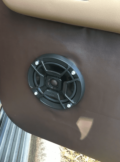

Speakers
  • Polk Audio DB 652 6.5"- wanted as big of speakers as I could fit in the doors as I only wanted to run four speakers in the whole rig and didn't want a sub to get adequate bass
    • These fit the front door speaker opening, but would be too deep to sit inside door panel like factory setup, so that's why mine are mounted atop the door panels
    • In the second row doors, I had to dremel a slightly larger opening as the factory speakers are like 4" or 4.5" only
    • I ran the speakers off the amp using 14 gauge speaker wire from AmazonBasics (good quality)
      • Running speaker wires into the doors like the factory stuff is tricky/tough as the factory grommet setup is super snug...fortunately, this wire from amazon was wrapped in a decently heavy insulating jacket so it could handle some rough pushing/pulling thru tight spots
    • They provide great sound range, and respond well to both head unit EQ adjustments and amp settings for high and low range
    • Plus they are marine rated, so I guess I can get them wet and be fine 👍

Front Driver Door
Rear Passenger Door
