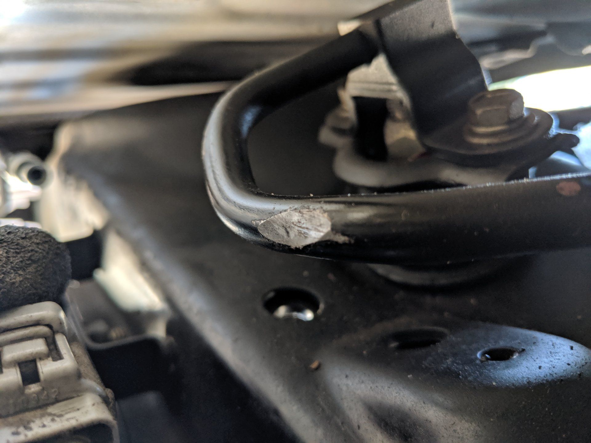

I had a similar issue, leak from near the driver's side rear. Lost fluid and the vehicle was stuck in low. It happened while I was driving slowly offroad so I noticed right away when the fluid hit the exhaust and was smoking. I pulled the AHC fuse to save the pump and drove it the 100 miles back home in low rider mode :). Initially, I thought the leak was coming from the top of the shock but eventually found it to be two lines that crossed too close and wore a hole in one. I bent the bracket that held the lines further apart, replaced the two lines and bleed the system again with new fluid. Been good as new for the last year.

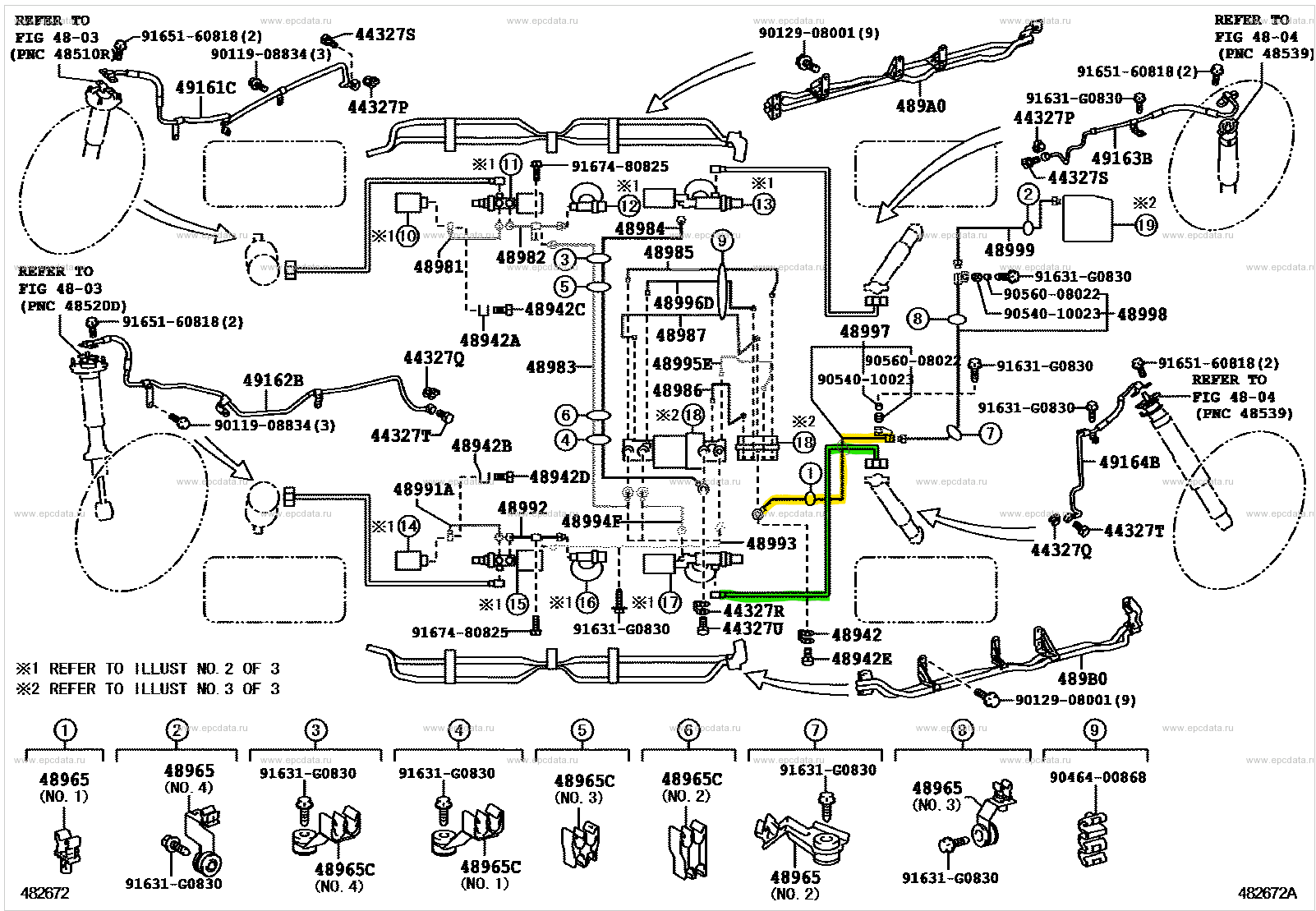

Here is the parts schematics, highlighted lines below. Where they cross circled in red is where I found the pin-sized hole.
Here are all the parts and part numbers I used, removing the muffler provided lots of room under the vehicle and I replaced all the gaskets which I think are single use:
Part NumberPart NamePriceQuantityTotal
49164-60023Hose Suspension Con260.871260.87
48997-60010Tube Height Control66.85166.85
48942-60020Gasket Height Control2.6412.64
44327-30040GASKET, PRESSURE PORT2.6412.71
08886-81221Suspension Fluid13.81796.67

The rubbing location was about 5 inches from where the line attaches to the top of the shock.
This is the bracket I needed to bend, I now have about a 1 inch gap between the two lines.

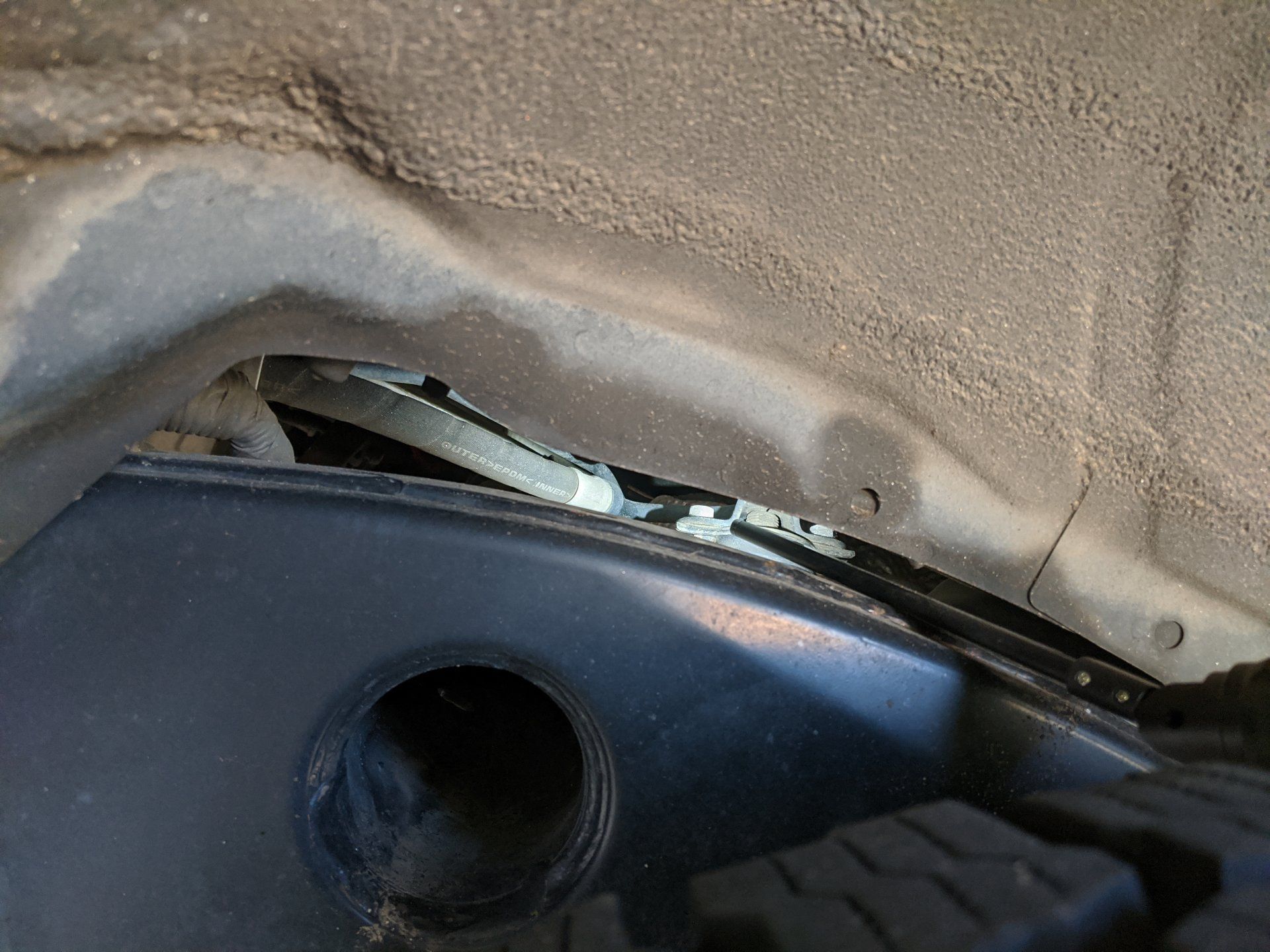

With the AHC in high and using a flash light, you can take a quick peak from the wheel well. I was able to see where the black paint wore off and it was shiny but it is hard to see how close the two lines are without looking from below.

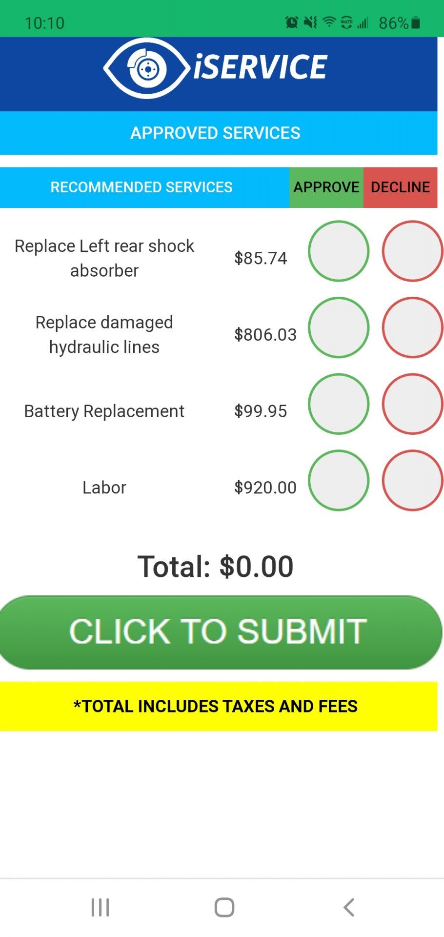

Here's the estimate I received. $1,911 total. Seems very high to me. Idk what their labor rate is.
Do you need to remove the spare to see from underneath?
Need no, but with it removed you can get a real thorough look at everything up there.
I havent had a chance to call him yet. I'll be able to talk to him later this afternoon.
He said it was rust. They are reworking the quote based on the fact they just inspected and flushed the system about 8 months ago and didn't give me any notice that the system had issues.
