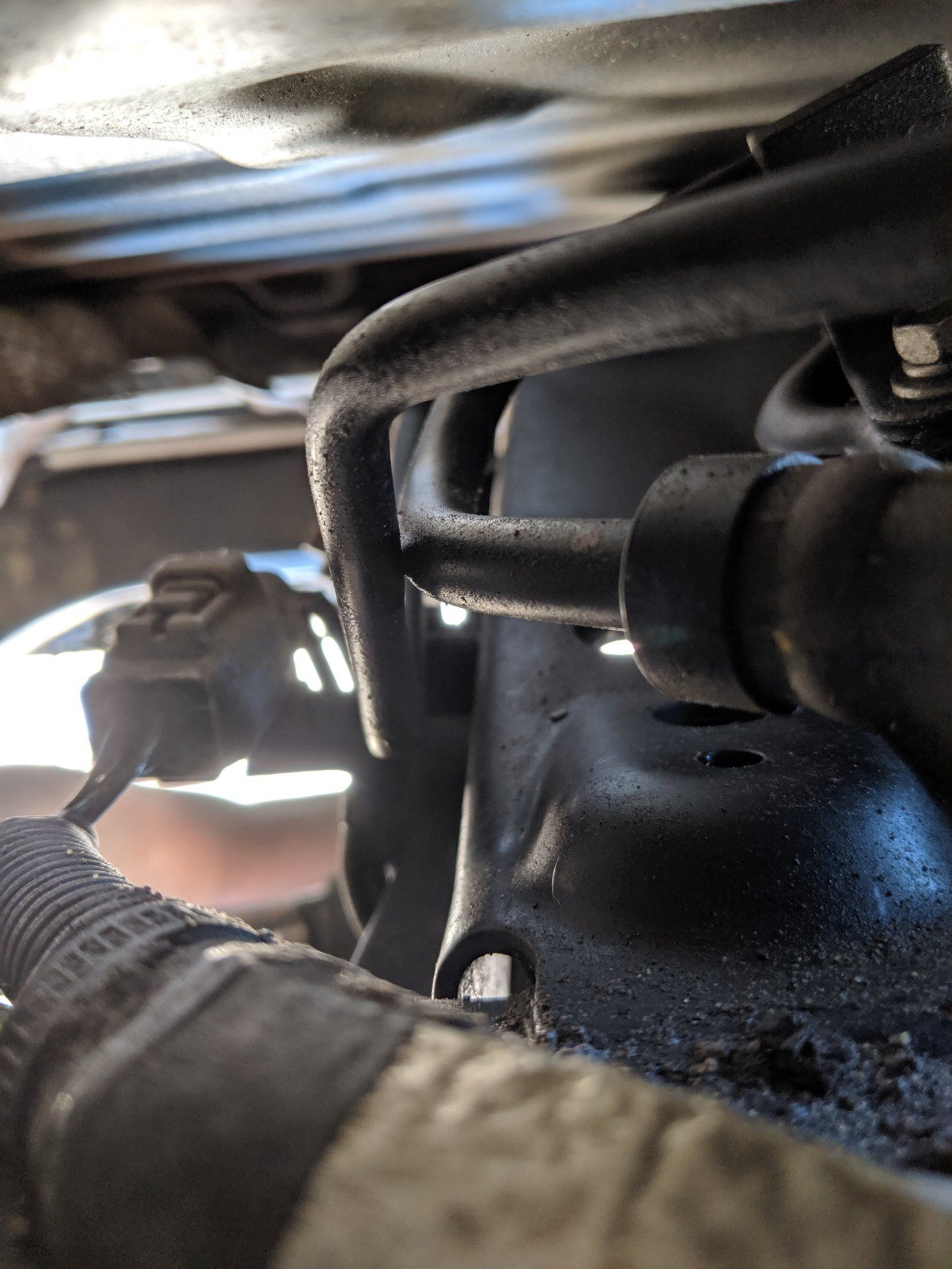

My '09 seems looks fine in regards to the two lines. There's about 3/4" of clearance.
Coming from underneath the chassis forward of the rear axle, one can stick their phone up to take a video and see pretty clearly if there's an issue.

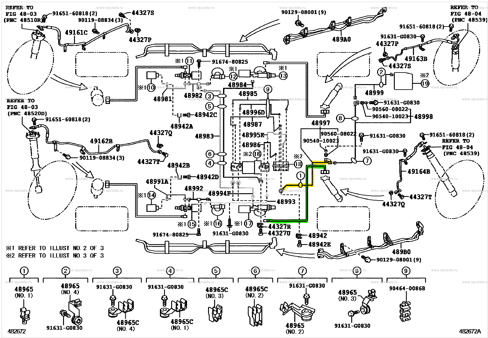

I had a similar issue, leak from near the driver's side rear. Lost fluid and the vehicle was stuck in low. It happened while I was driving slowly offroad so I noticed right away when the fluid hit the exhaust and was smoking. I pulled the AHC fuse to save the pump and drove it the 100 miles back home in low rider mode :). Initially, I thought the leak was coming from the top of the shock but eventually found it to be two lines that crossed too close and wore a hole in one. I bent the bracket that held the lines further apart, replaced the two lines and bleed the system again with new fluid. Been good as new for the last year.
Here is the parts schematics, highlighted lines below. Where they cross circled in red is where I found the pin-sized hole.
Here are all the parts and part numbers I used, removing the muffler provided lots of room under the vehicle and I replaced all the gaskets which I think are single use:

The line that pops is on the driver side above the exhaust. What causes it to corrode is the heat wrap retains moisture, and slowly eats away at the line itself. Here's a pic of a line that I've changed with the heat wrap peeled away :
Edit : When I do change them out, I remove the heat shrink on the new line and coat the lines with either fluid film or cosmoline, and apply copper anti-sieze to the new line's threaded fittings.
