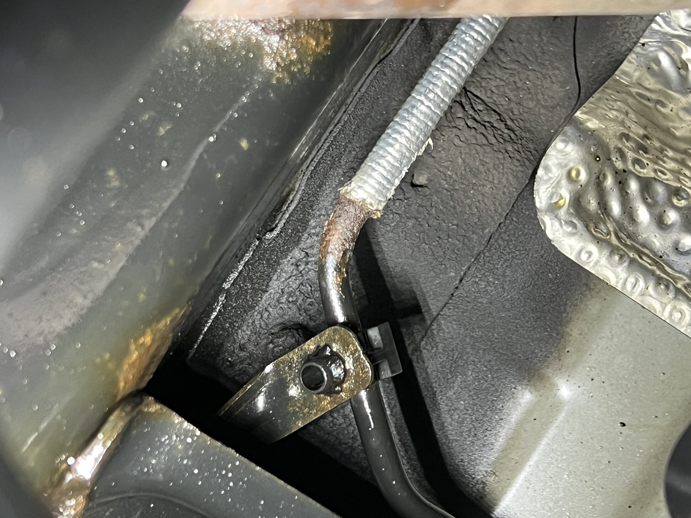

The line is just above the rear axle running right in front of the crossmember. The lines connects to the line that might rub right at the rear driver side shock/ spring. In the two pictures, the red arrow is the line that might rub and the green arrows are the line that rusts. The second pic is looking at the crossmember from the front to the rear, right above the rear axle

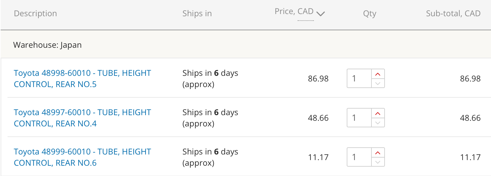

Want to resurrect this topic :) I have the same line problem. Can someone share that part number?
Thanks!
@NYC570 - it looks like you are the most experienced on this topic :)
Thank you for reply! I've ordered it through one of the local dealerships and will receive it in a day or two...
Stopping by to revise this topic due to my dreaded rear line going out on me. Shout out to @NYC570 for swooping in for the win with the part number.
@ofreema, if you don't mind me asking did you ever complete this job, or did you have the dealership due the job for you? Any info/knowledge that you can share with us Lux Cruiser owners would be greatly appreciated 🤙🤙🤙
Bumping this up, I am seeing 3 part numbers mentioned previous (48997-60010, 48998-60010, and 48999-60010) but the line that is so prone to bursting above the muffler is 48998 correct? My lx just went through the lovely driver side puddle today

Here's a short video of the tube that failed because of rust on my 13 LX. At this point it's partially removed. The picture shows the new tube compared to the old one. If you don't want to replace any brackets, you only need to unscrew the tube at three places. I decided to replace the two brackets that hold the tube as well. They're fairly cheap.
The part circled in green is easily accessible and wasn't that much of a problem. The part circled in yellow gave me the most trouble. It's very tight in there. A mixture of fixed wrenches with different angles as well as a set of ratcheting wrenches helped a lot. The part circled in red is where my tube failed because of the heat wrap. I painted over the heat wrap on the new tube with high heat temp paint to prevent this from happening again (blue arrow). I'll monitor the tube yearly to see how the paint holds up.
Overall this isn't that bad of a job if you have a decent set of wrenches and don't round one of the bolts like I did. I also had to unhang the exhaust from the three rear rubber hangers to allow the old tube to come out and the new one to go in.

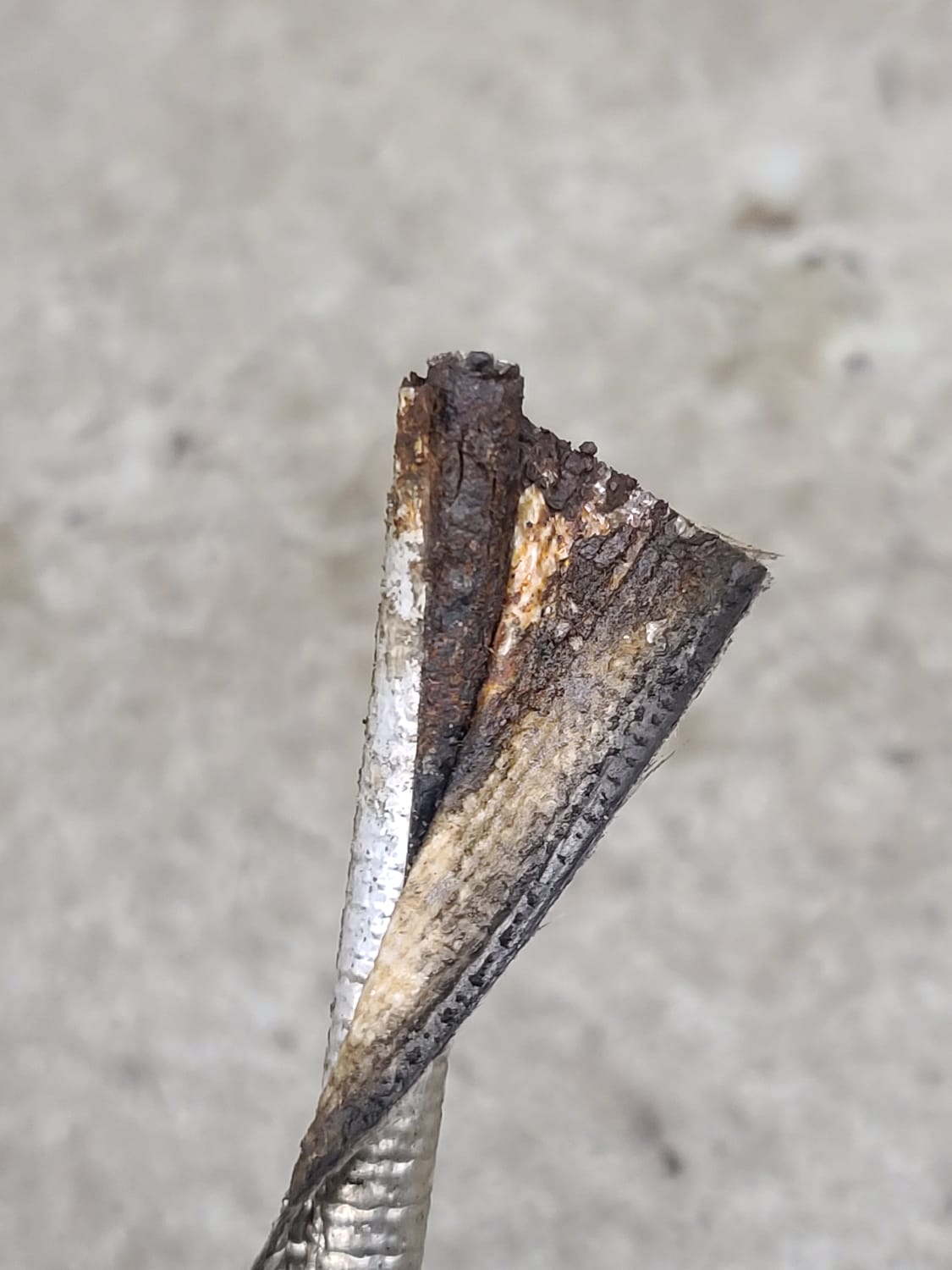

The line that pops is on the driver side above the exhaust. What causes it to corrode is the heat wrap retains moisture, and slowly eats away at the line itself. Here's a pic of a line that I've changed with the heat wrap peeled away :
Edit : When I do change them out, I remove the heat shrink on the new line and coat the lines with either fluid film or cosmoline, and apply copper anti-sieze to the new line's threaded fittings.
