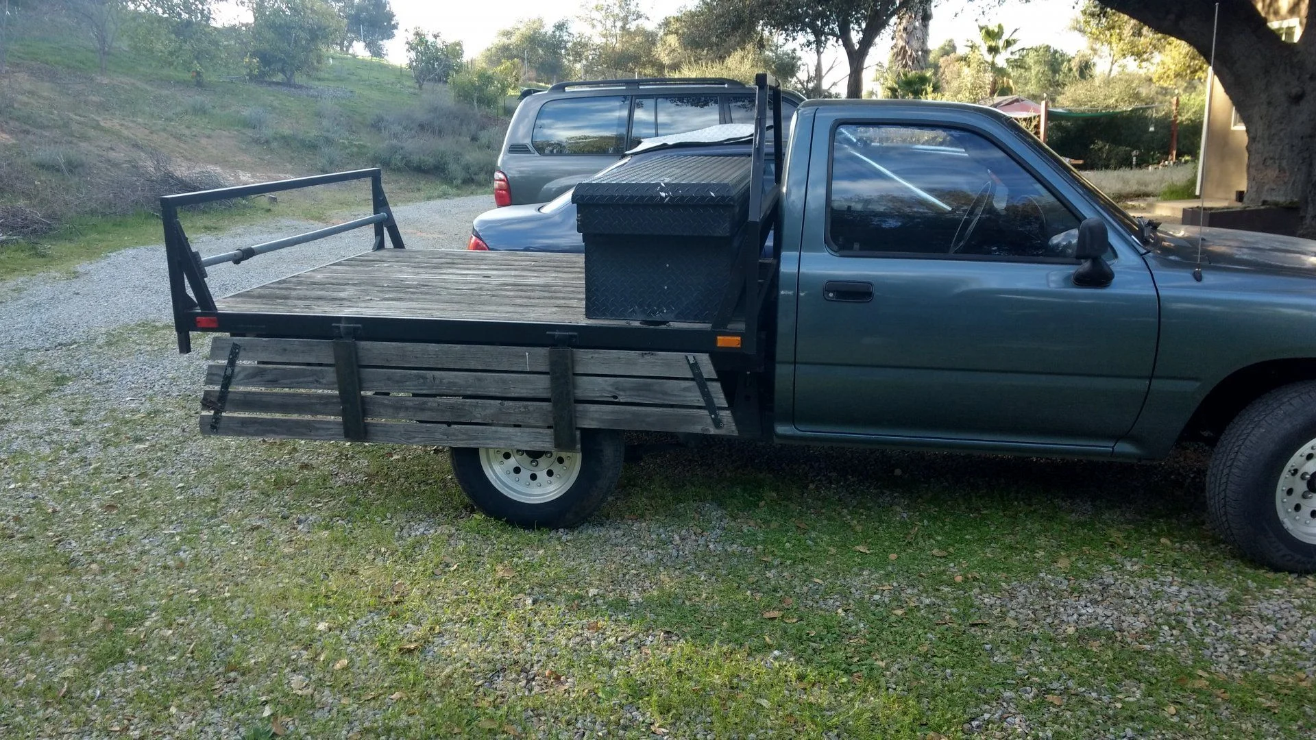

I know it's not 4wd but I love it just the same.
Specs: 1992 Toyota pickup came from the factory with 22re, 5spd manual, no AC, no power steering, no radio

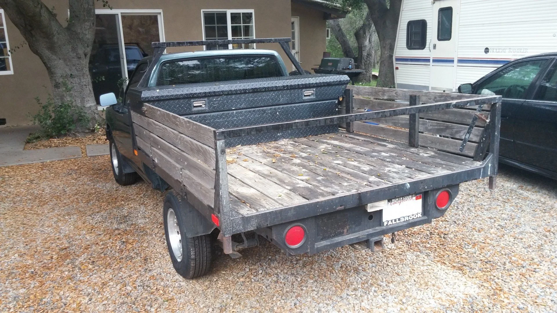

Built a flatbed with custom raising rear bar for lumber rack duties. Made the flatbed to the dimensions of a fullsize truck toolbox.
Lengthened frame at the back
Sides fold down for forklift and can be removed.
rear springs upgraded with custom pack.
rewired lighting system to include daytime running lights and sequential front blinkers. Converted rear lights to American style single light brake/turn.
Built custom subwoofer enclosure under flatbed.
What I added from the junkyard
sr5 4runner gauges with oil pressure sender
AC from a pickup
AC condenser fan and relays from 4runner
4runner clock
4runner front speaker pods
4runner map lights
4runner glove box light
4runner cig lighter and ash tray light
4runner intermittent wiper switch
4runner oh crap handles with trim
4runner steering wheel
87 1 ton dually front brakes
tokico shocks
F250 trailer hitch
