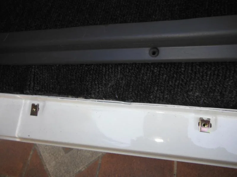

Fitted the door trim today but it had lost two of the plastic clips that receive the screws. Fortunately these little brass clips saved the day.

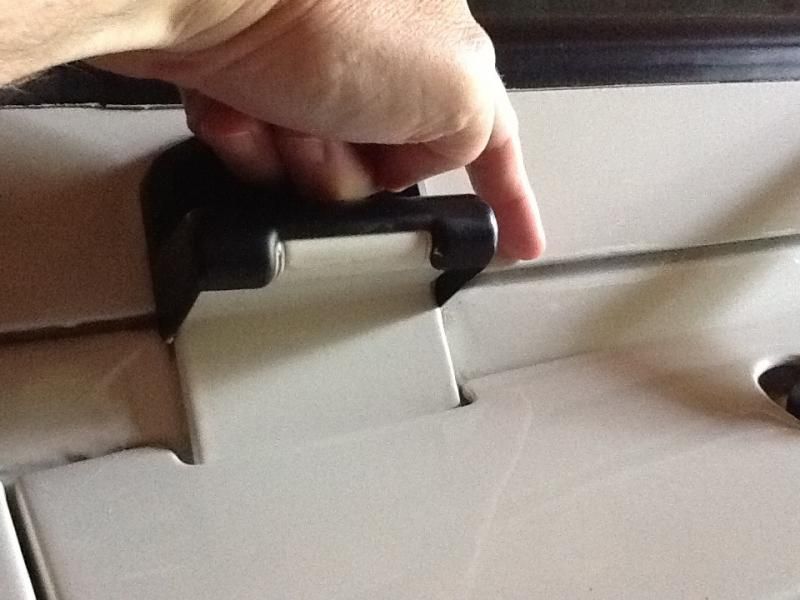

This is the seam I am referring to. It was filled with silicone and the leak stopped.
