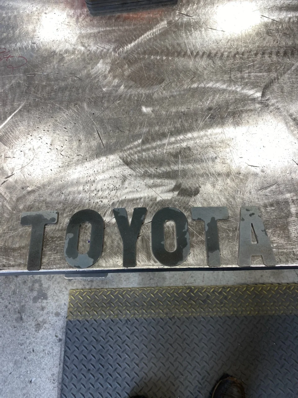

Got my letters today! I was a little bummed because a coworker of mine who does custom fabrication work on the side told me that if I would've told him sooner that he could have made me some dimple dies to stamp each of the letters into the tailgate, giving it the factory raised letter look. This would have been really cool to have done but its a little too late now.
No biggie though, Im glad that I got these letters and will make them as close to factory as I possibly can.

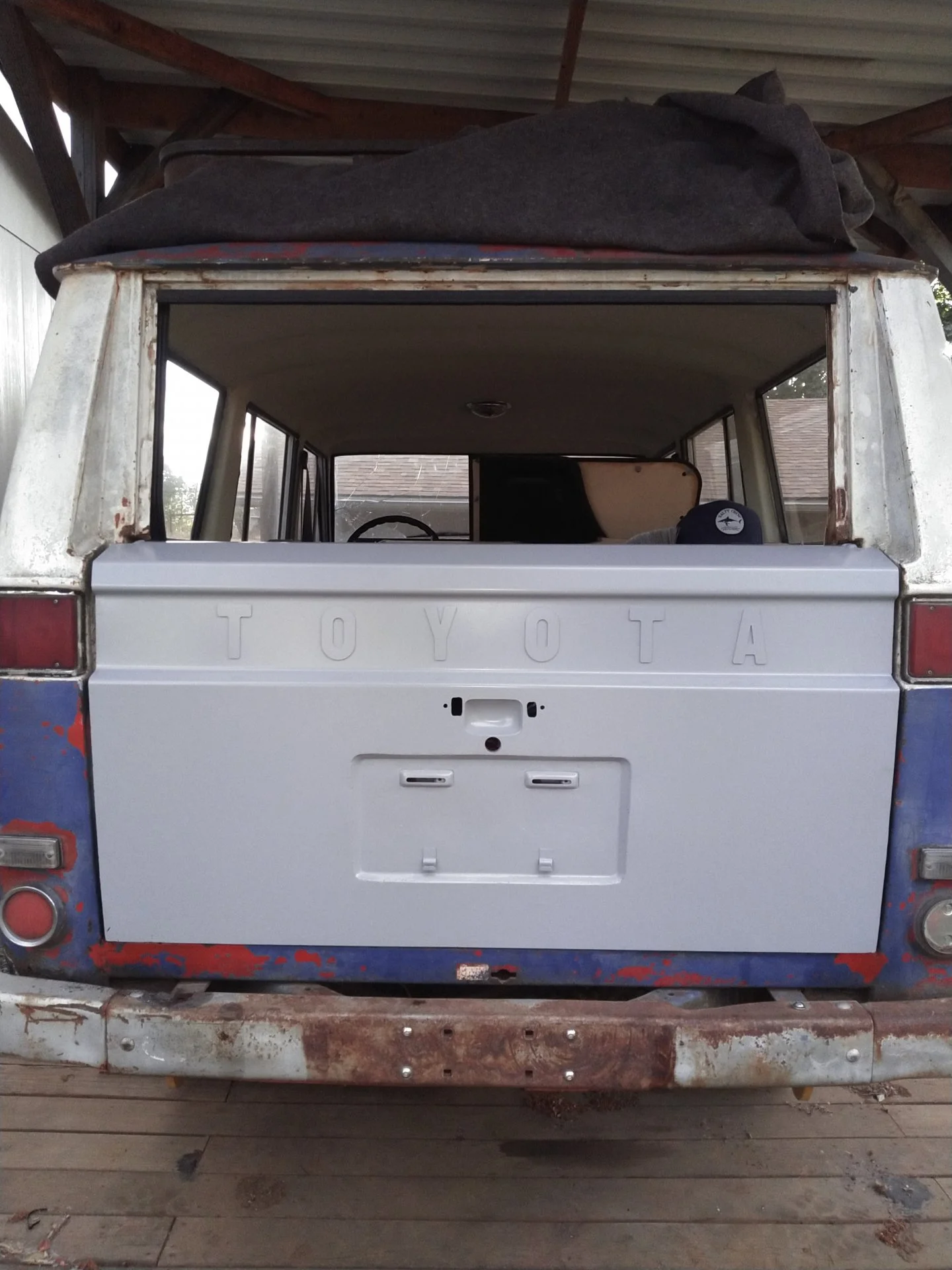

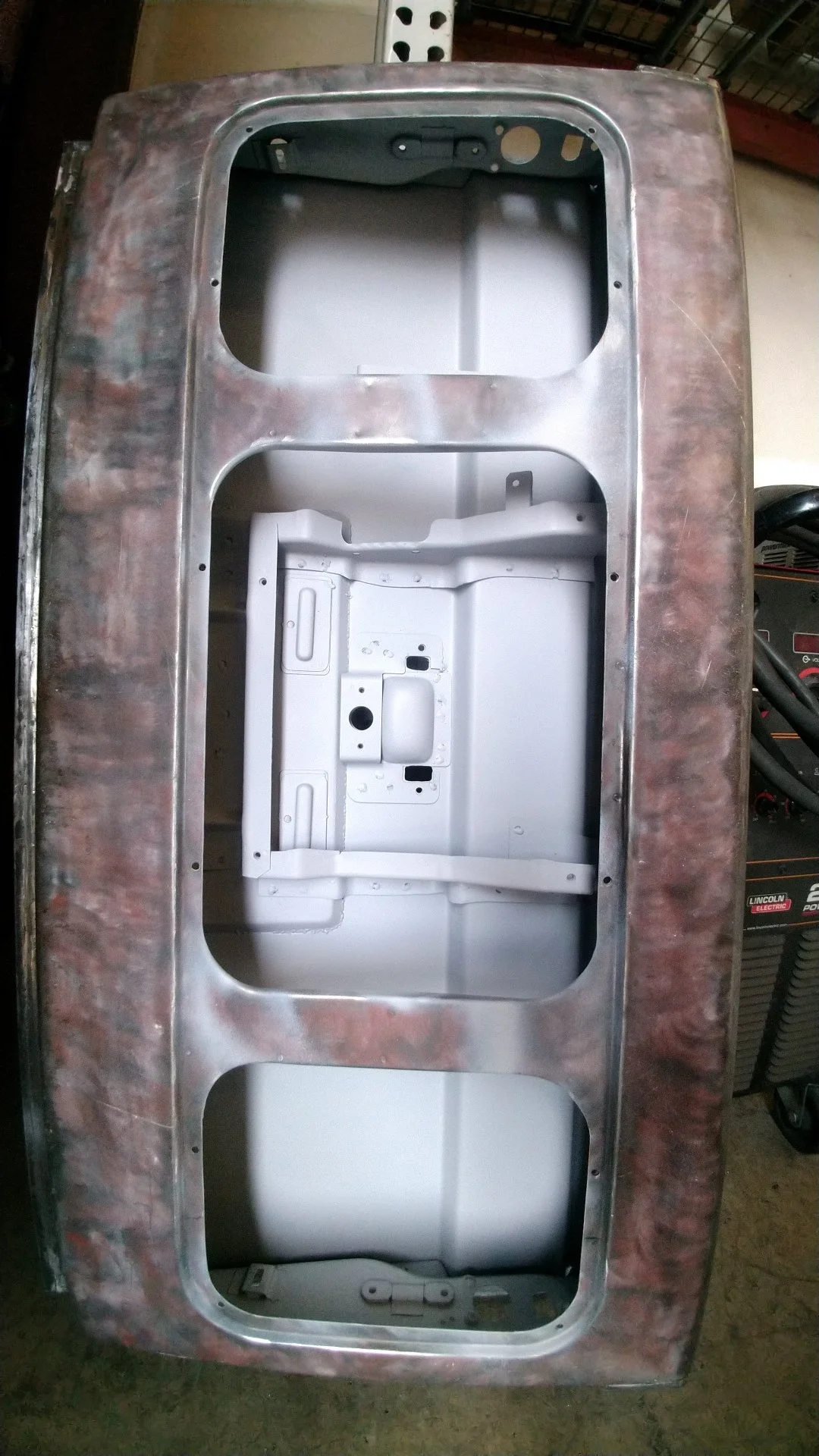

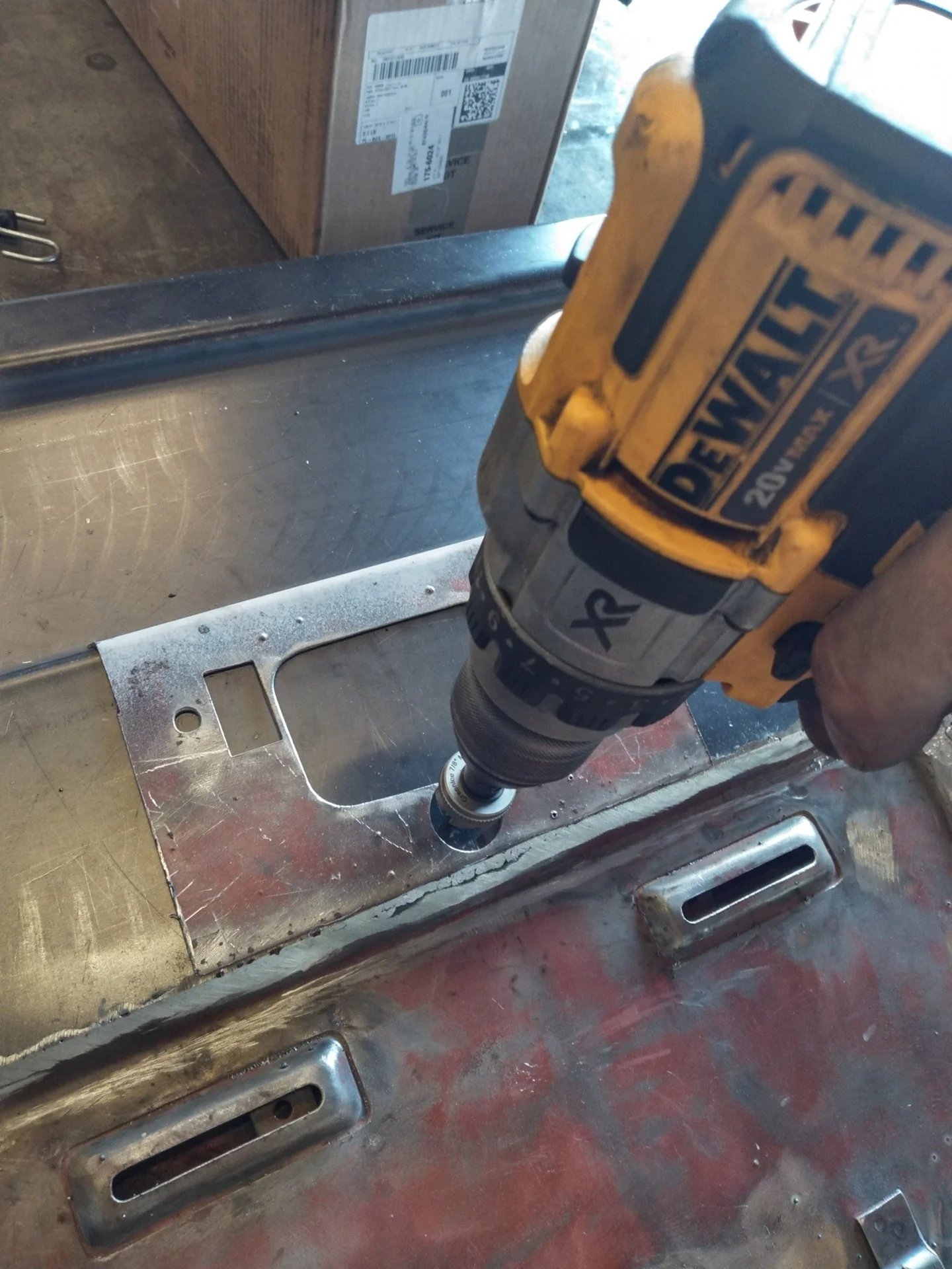

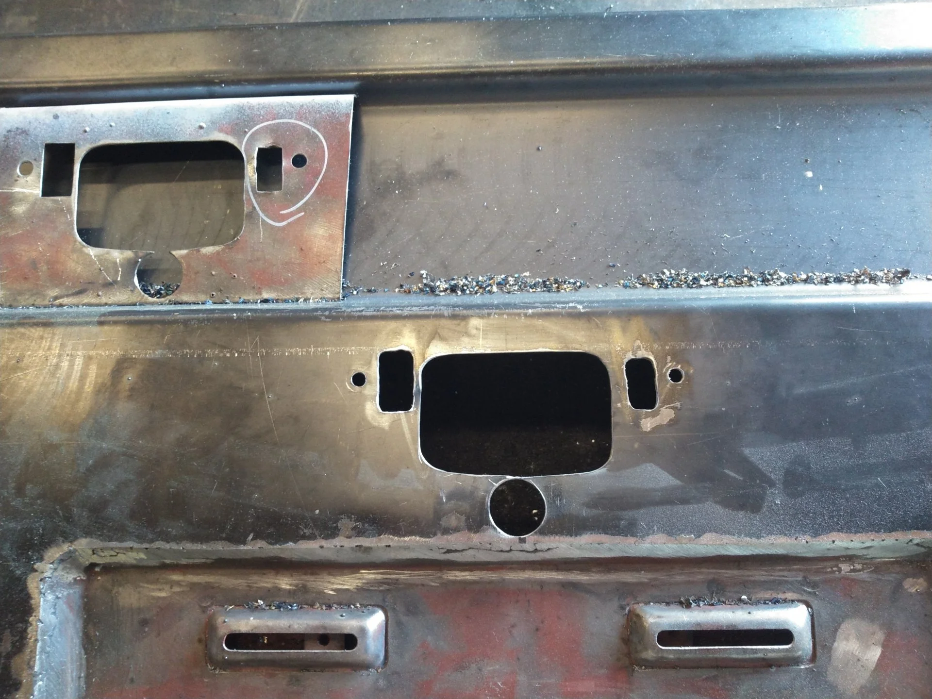

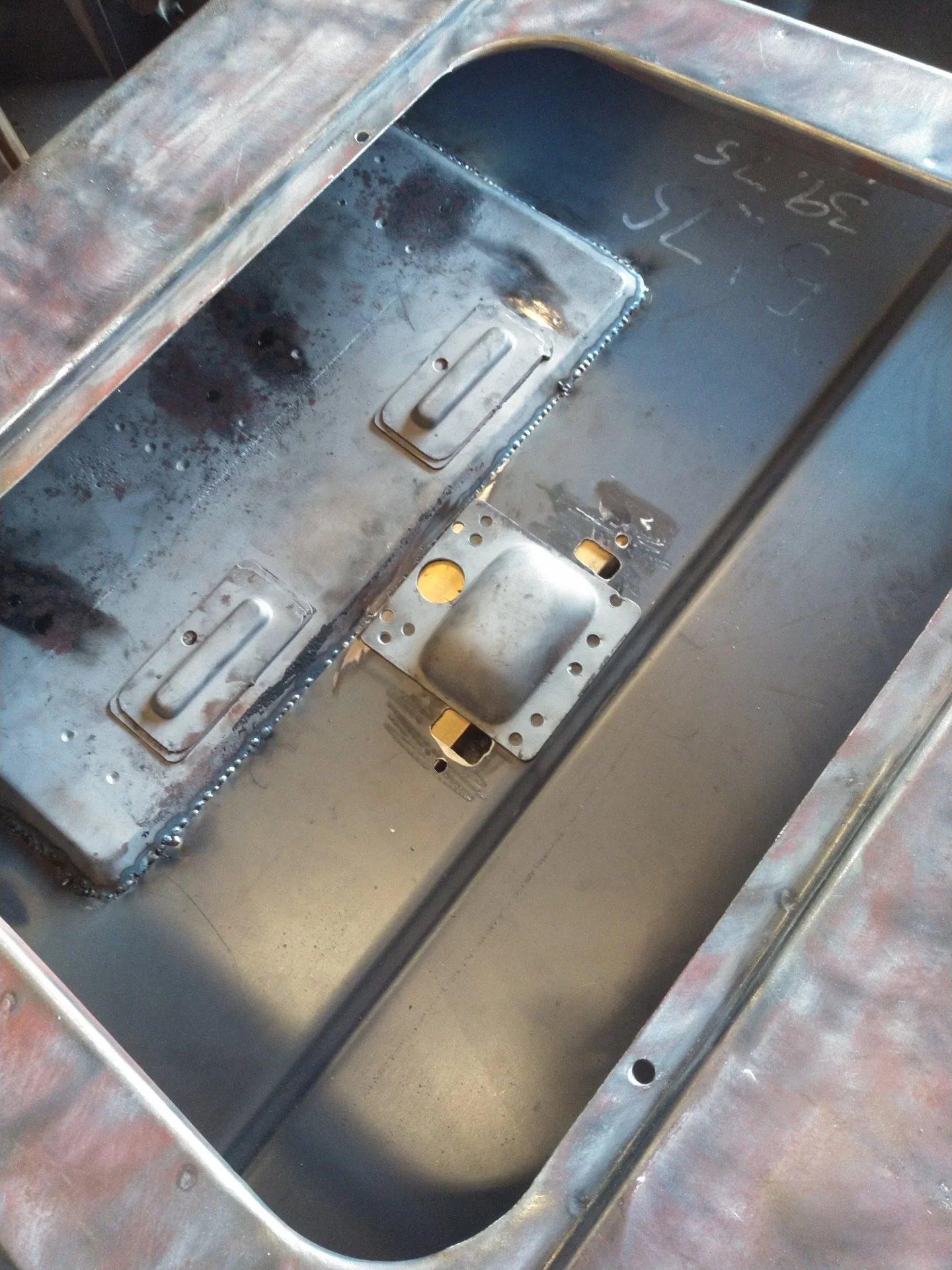

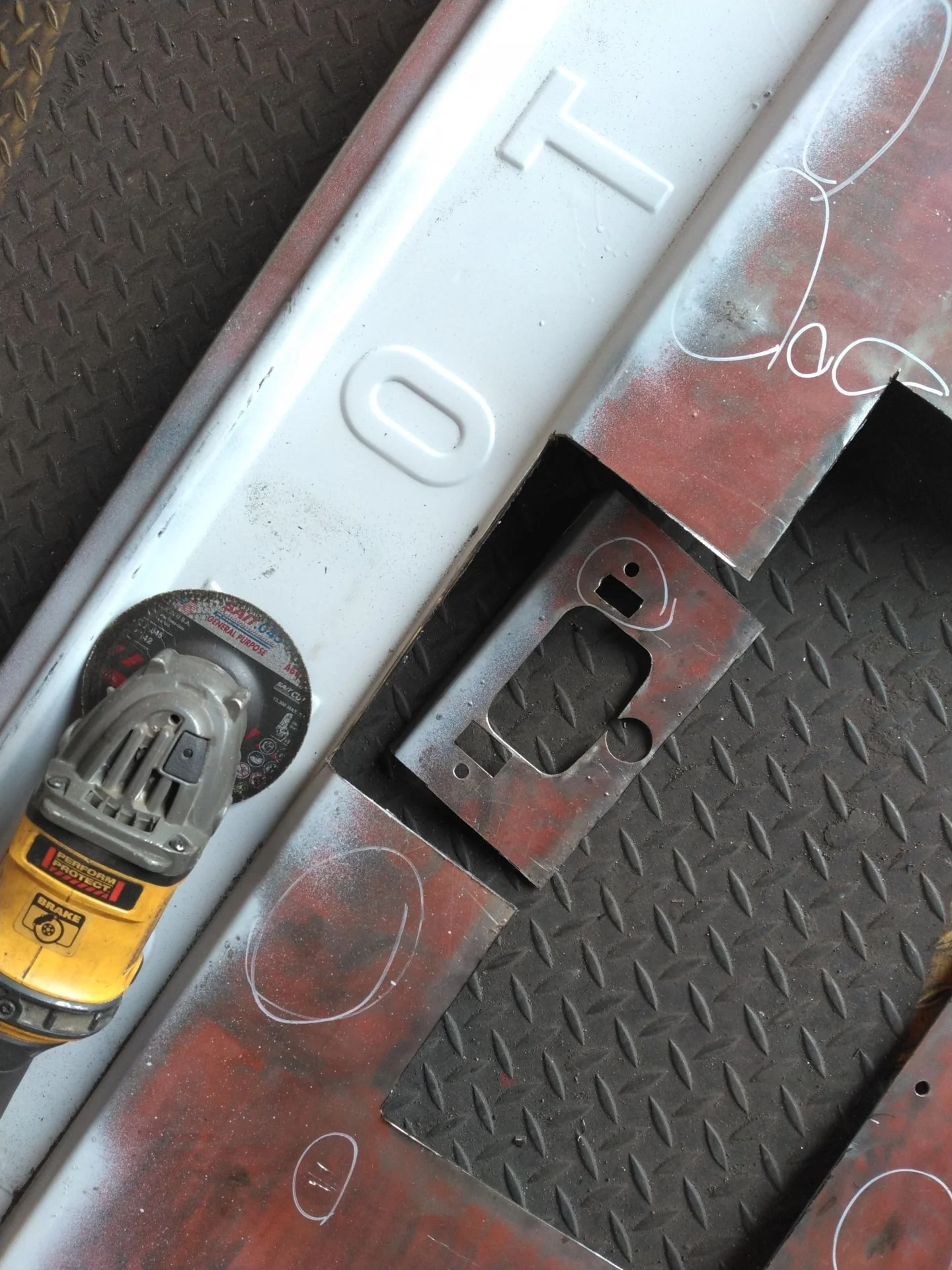

Git the window regulator mtg. Bracket in and sprayed primer on the inside. Still gotta do some work on the hinges and then I think I'll be ready to reassemble everything in the tailgate. Oh yeah, still gotta install the letters. That's probably going to be next on the list. Hope to find time soon.
Had a moment today to work o a little more on the tailgate!

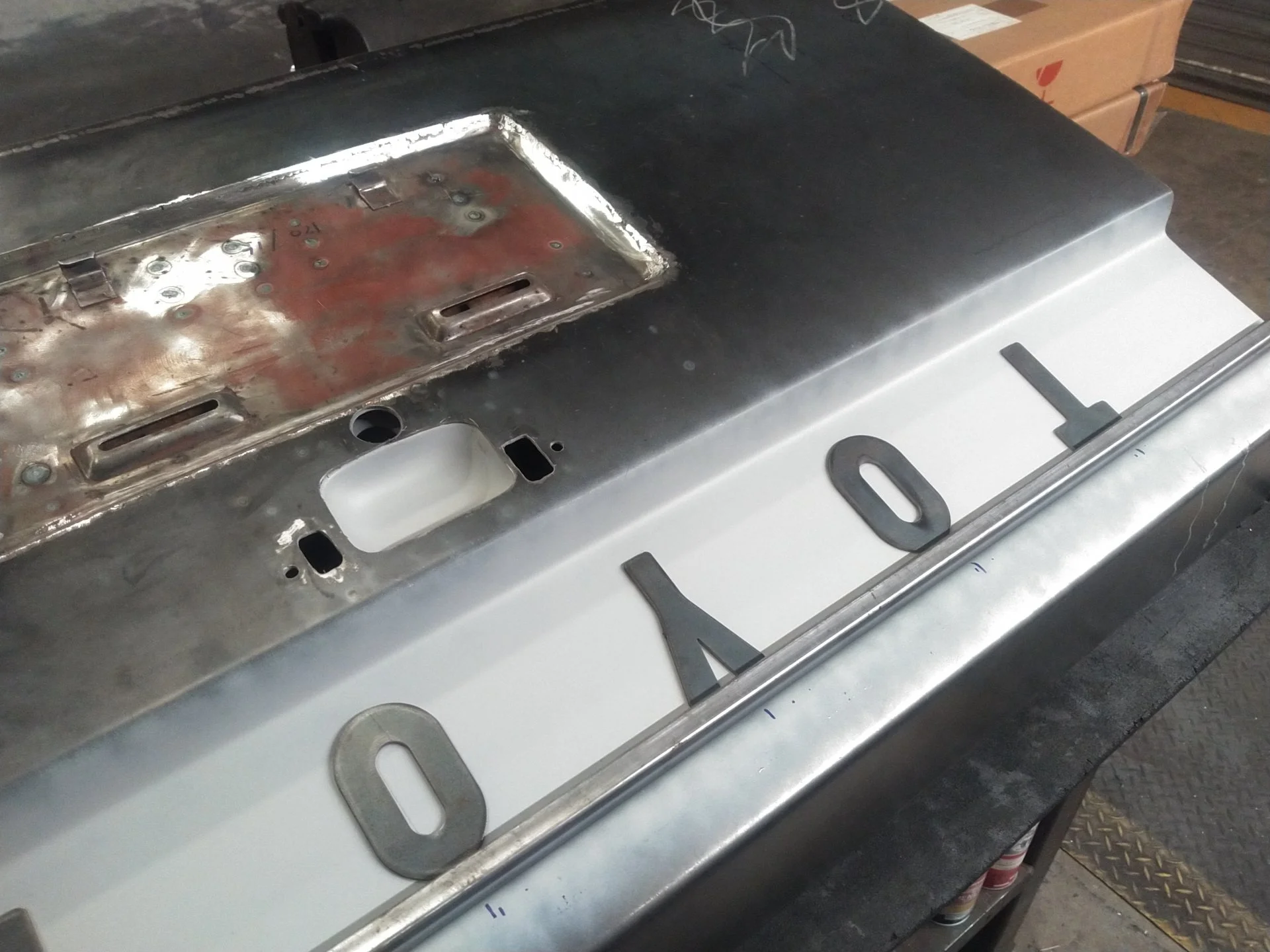

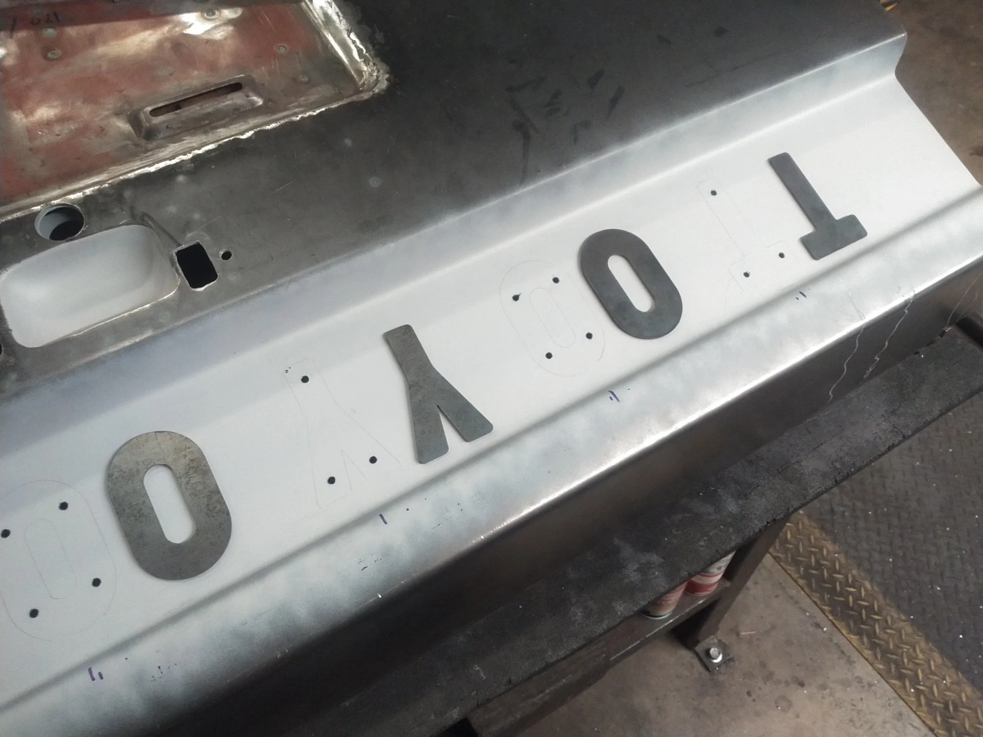

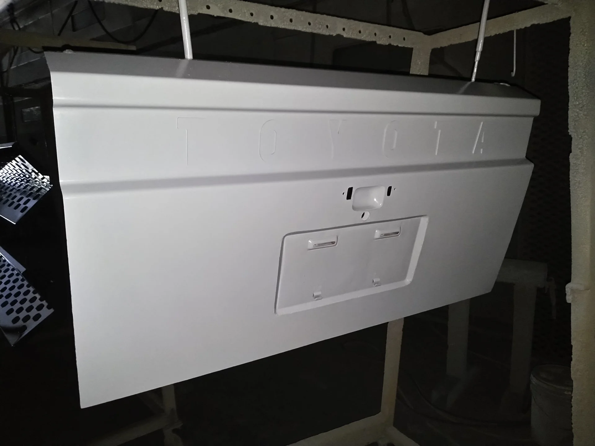

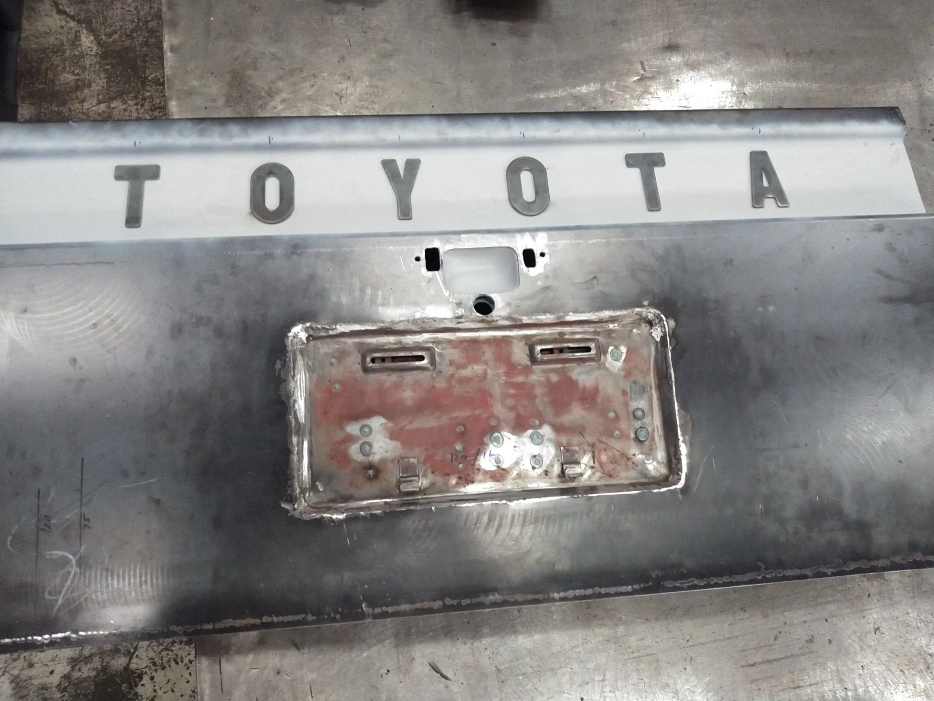

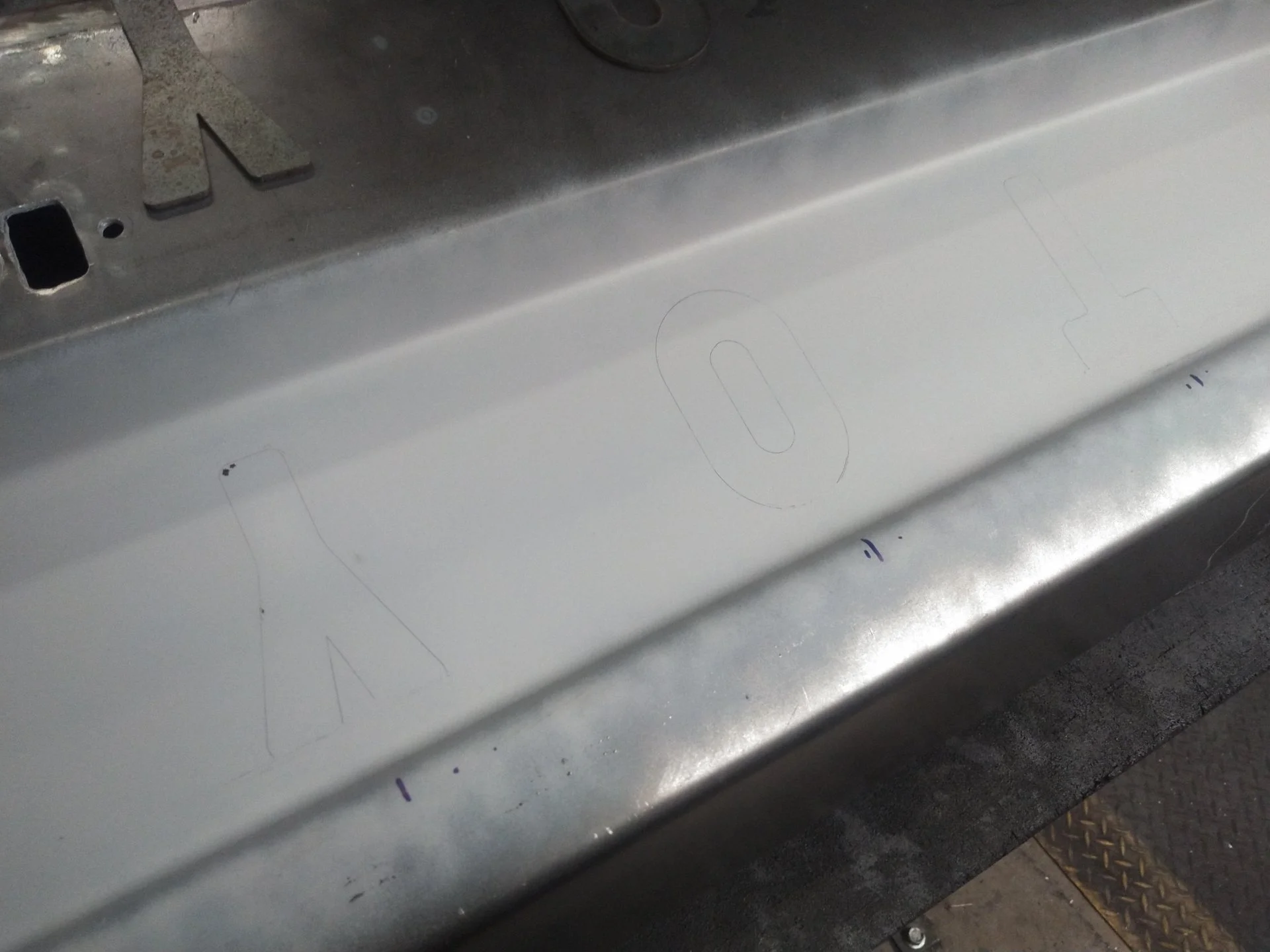

I laid down some primer and outlined each letter with a scribe. I then drilled a few holes for each letter and tomorrow I plan to spot weld them into place via the holes from inside the tailgate.

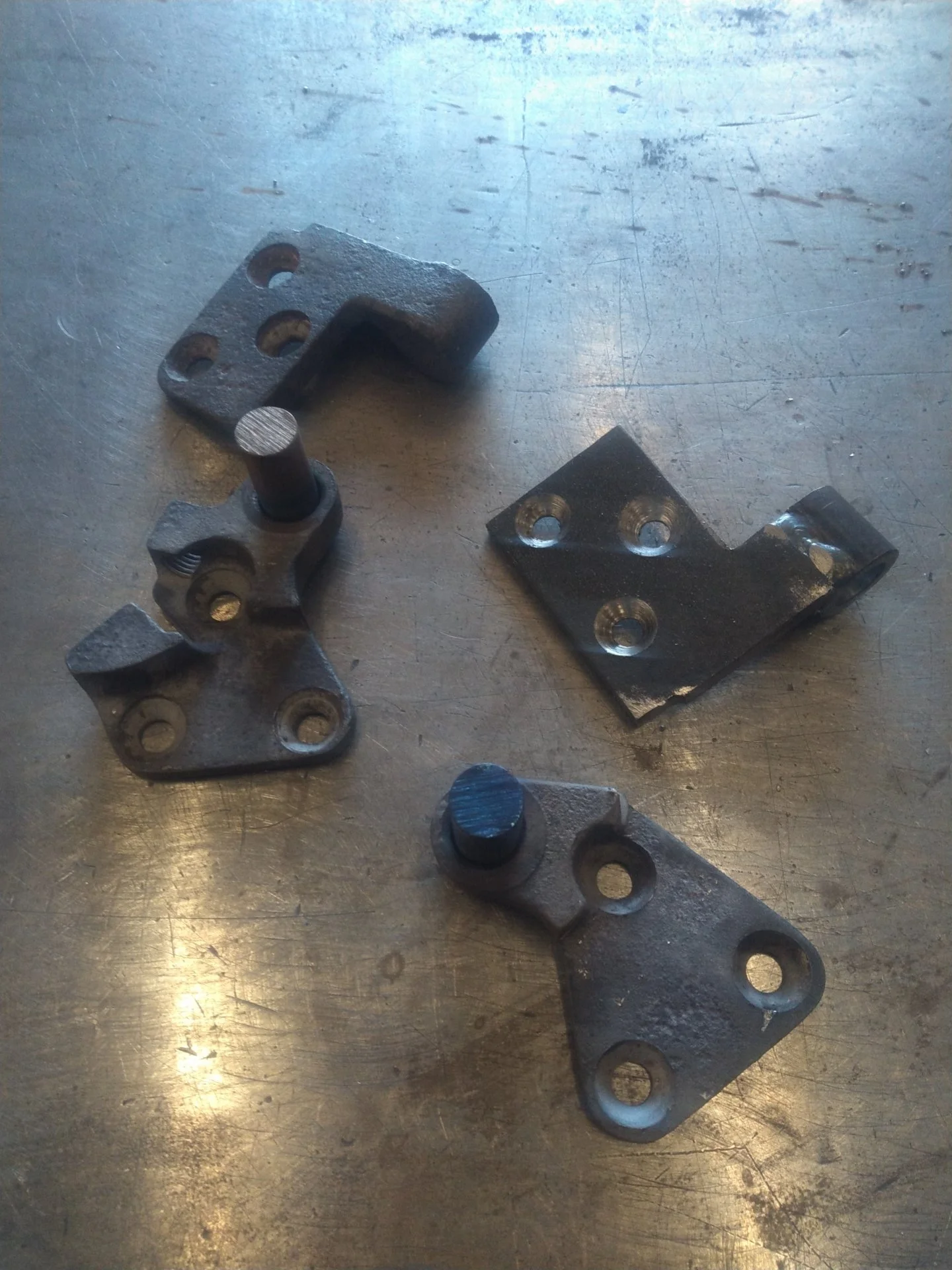

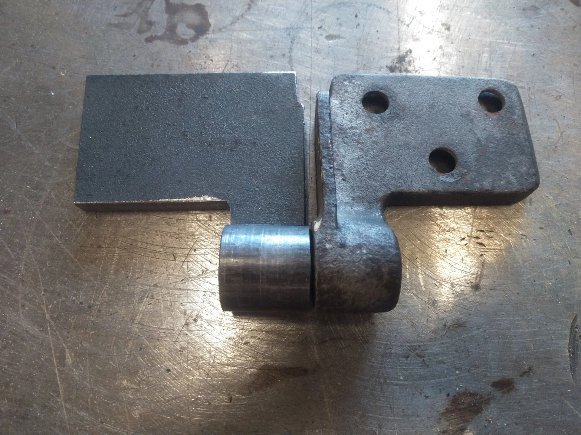

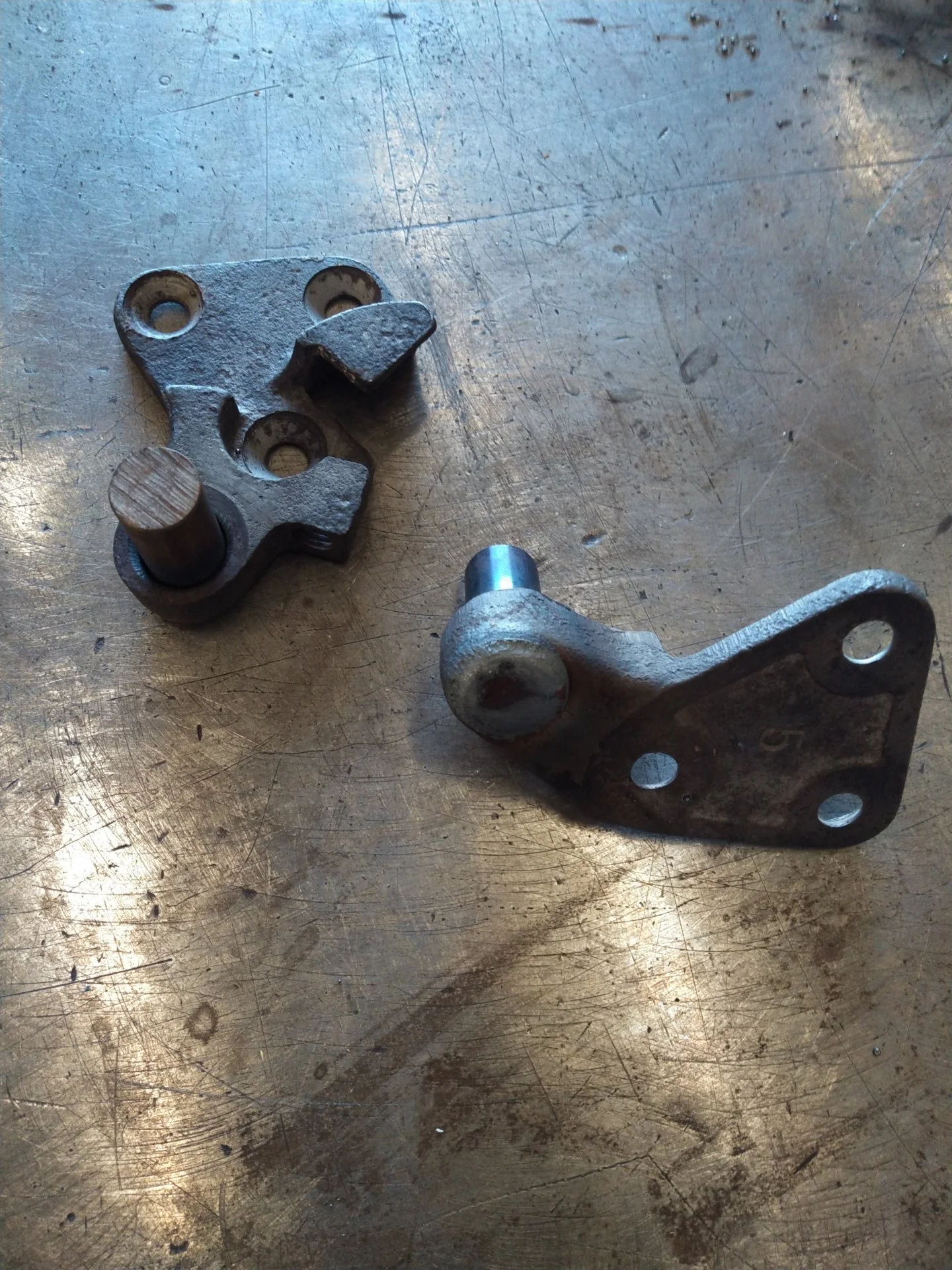

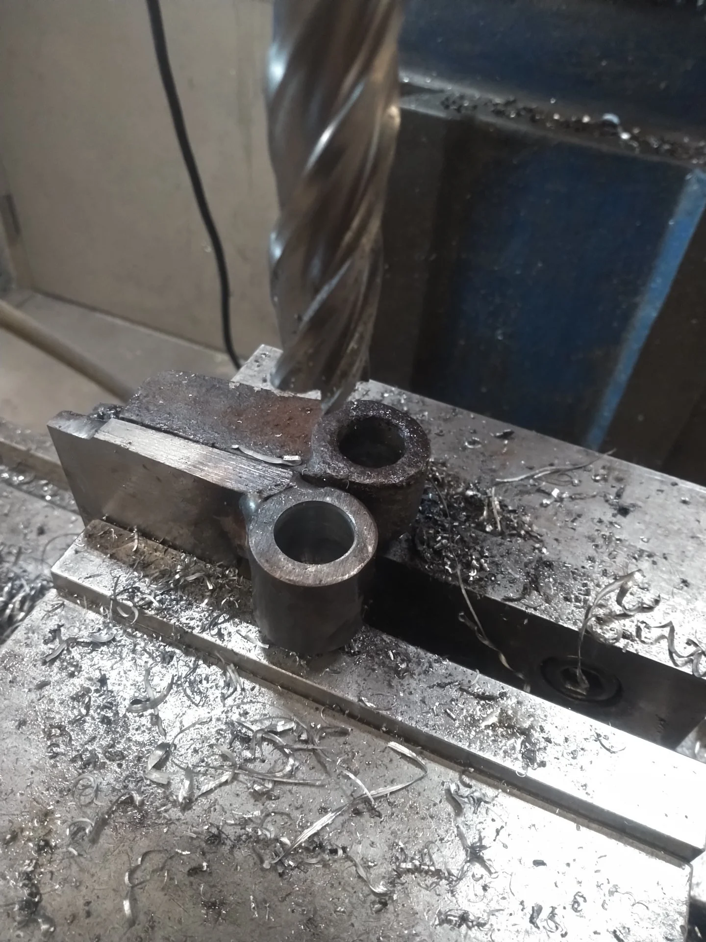

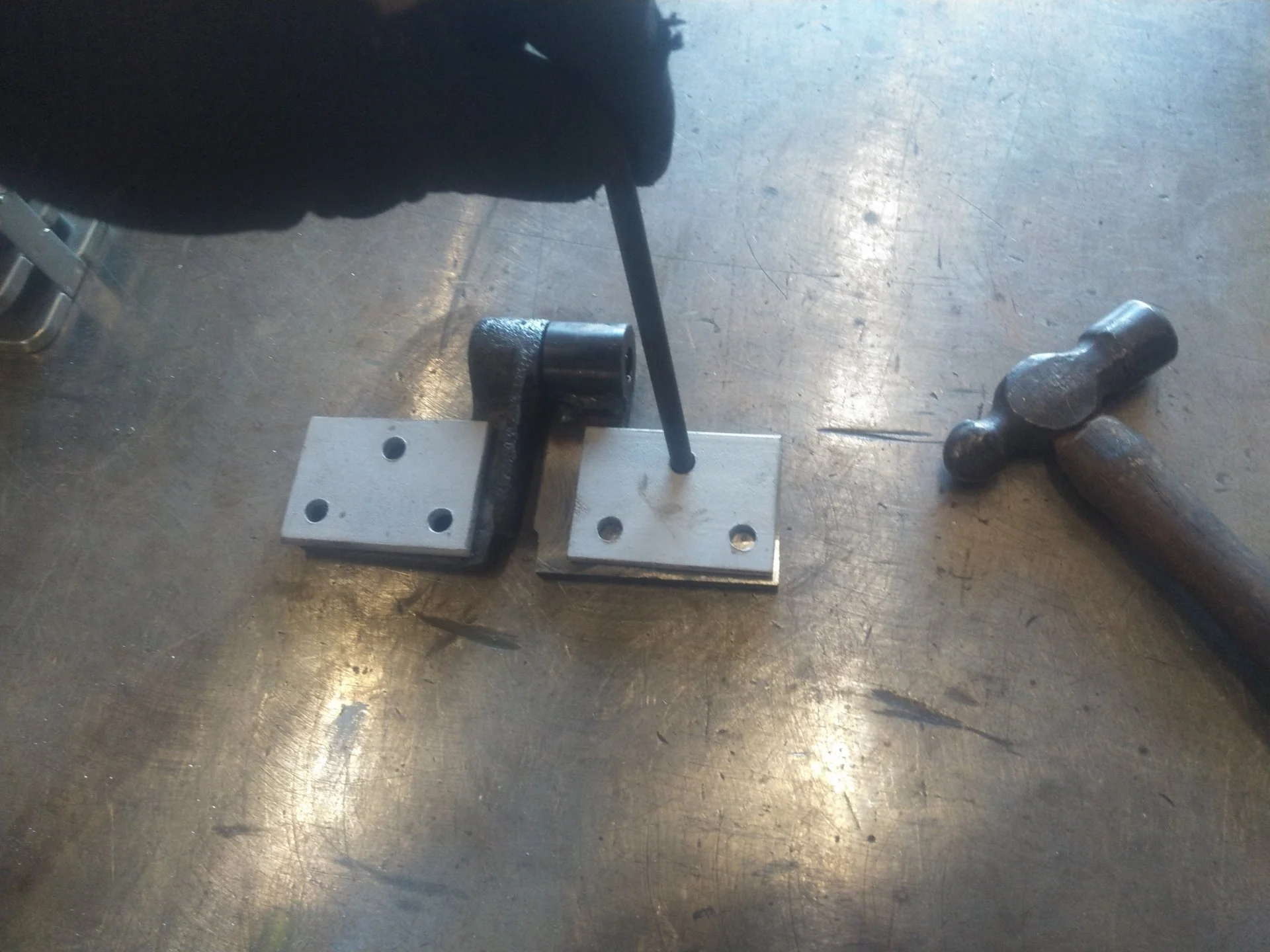

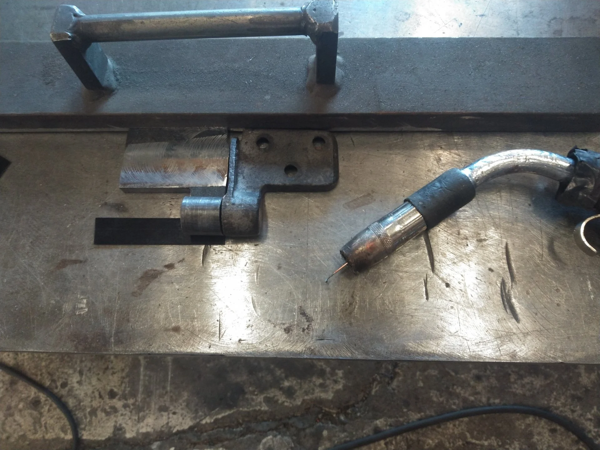

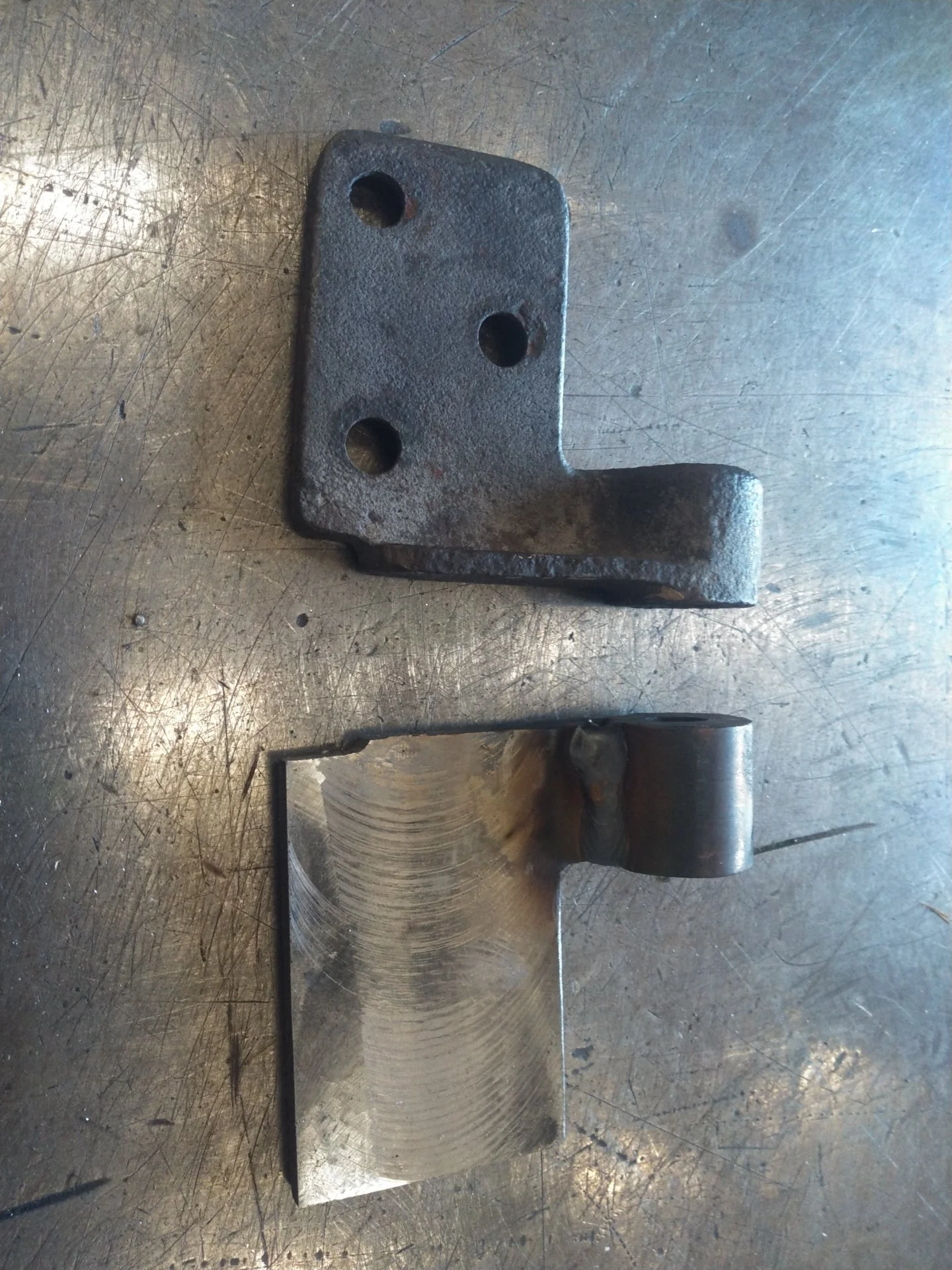

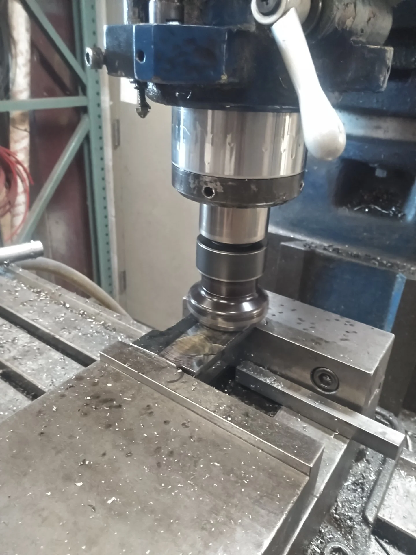

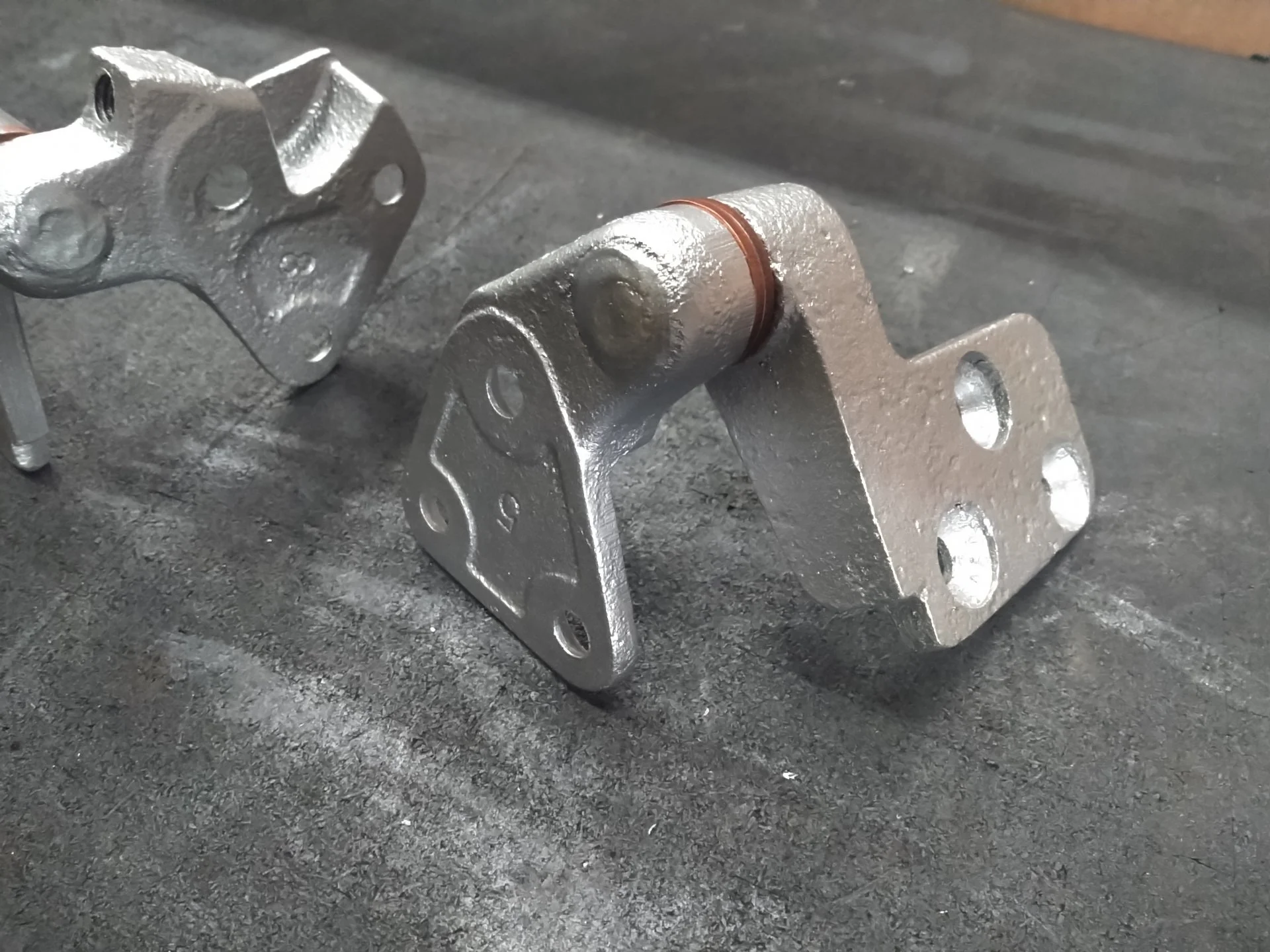

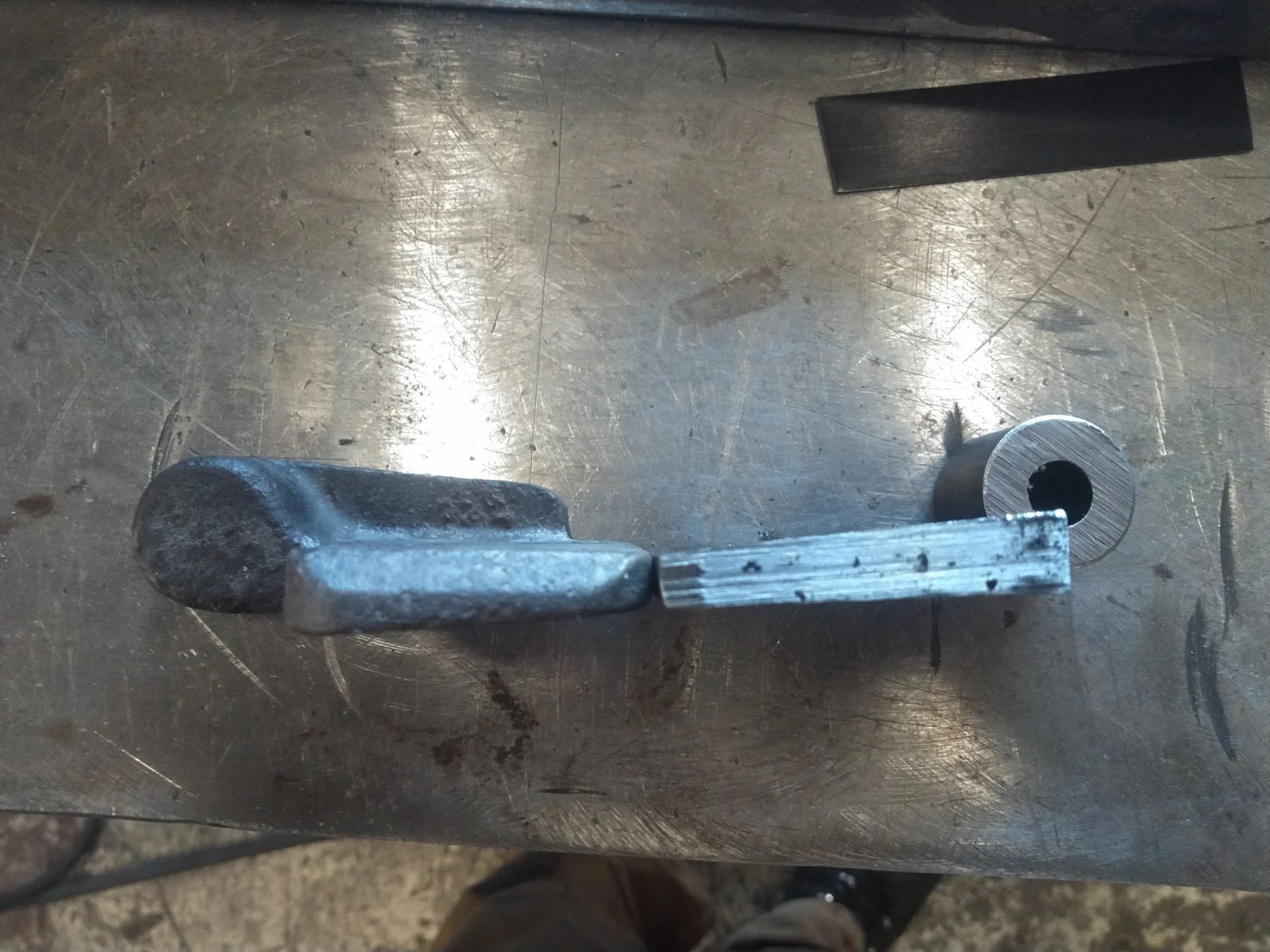

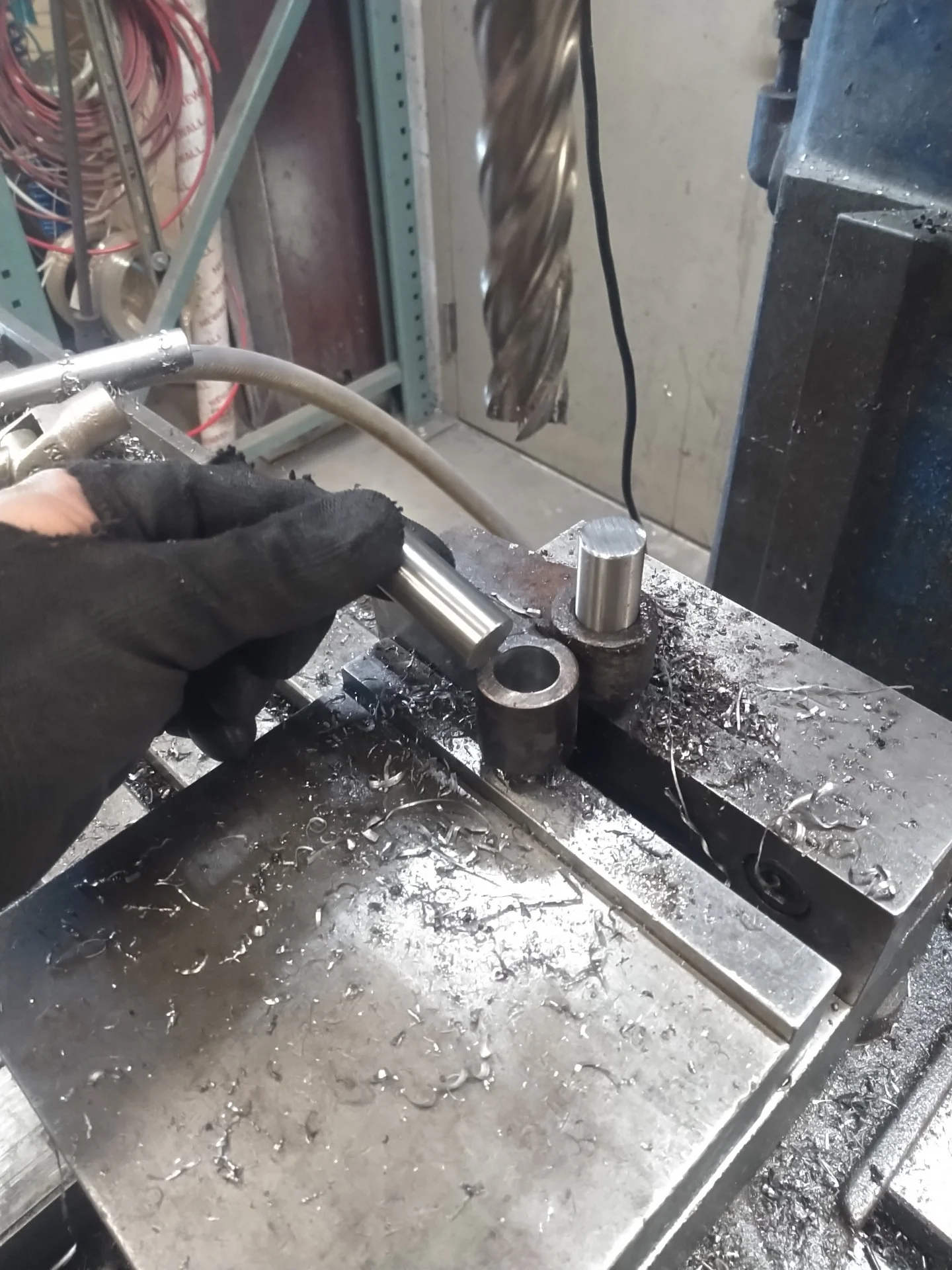

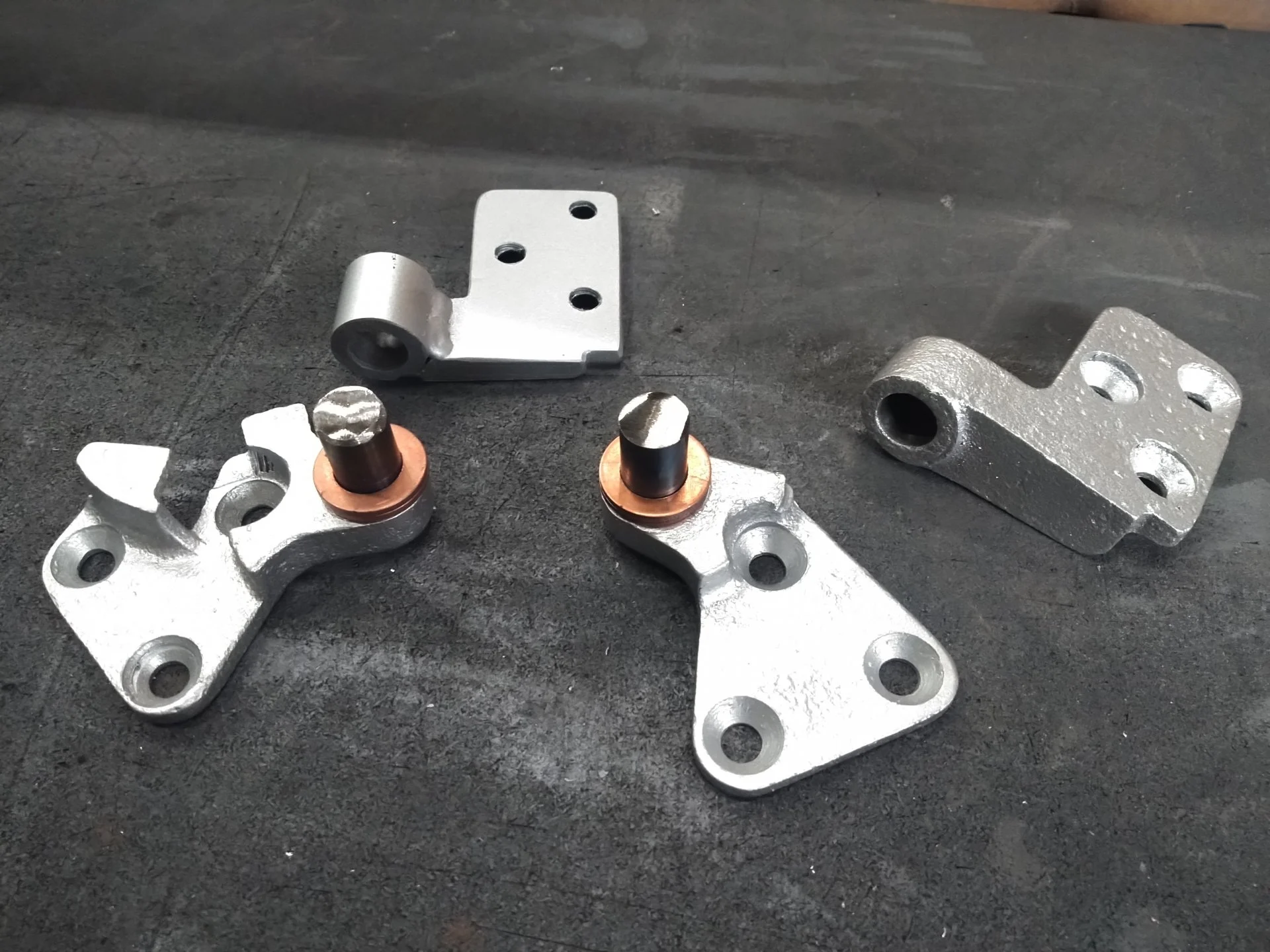

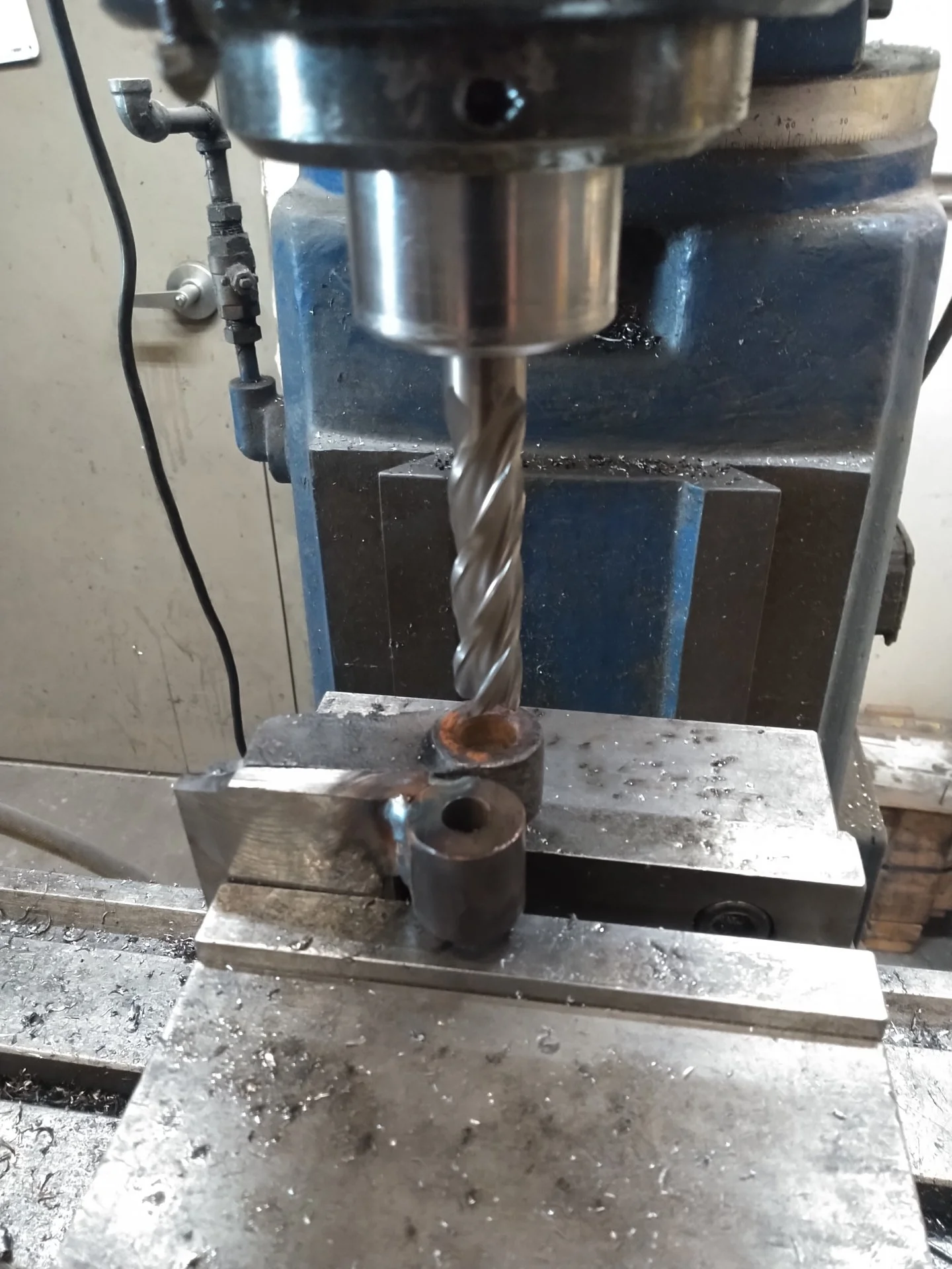

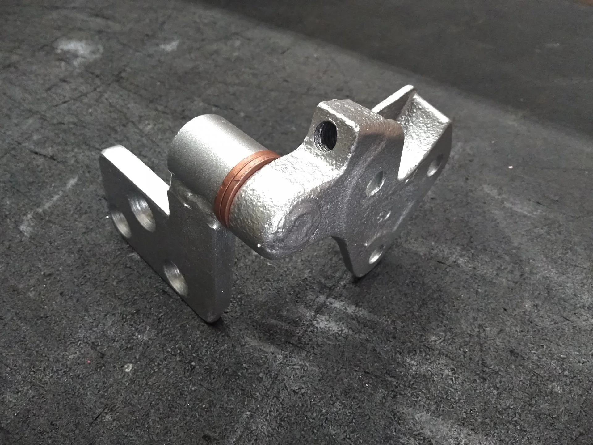

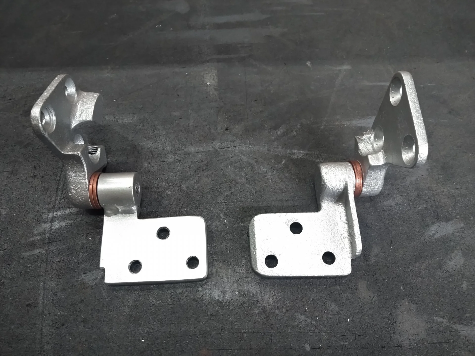

I also made some progress on the hinges. The old hinges were pretty wore out, not to mention I misplaced one of them and had to build it's replacement from scratch. I originally planned on adding brass sleeves at the hinge point but decided to bore out the receiving side and enlarge the pin instead. They are turning out nicely. They are currently in the booth getting painted and will be ready for installation tomorrow!

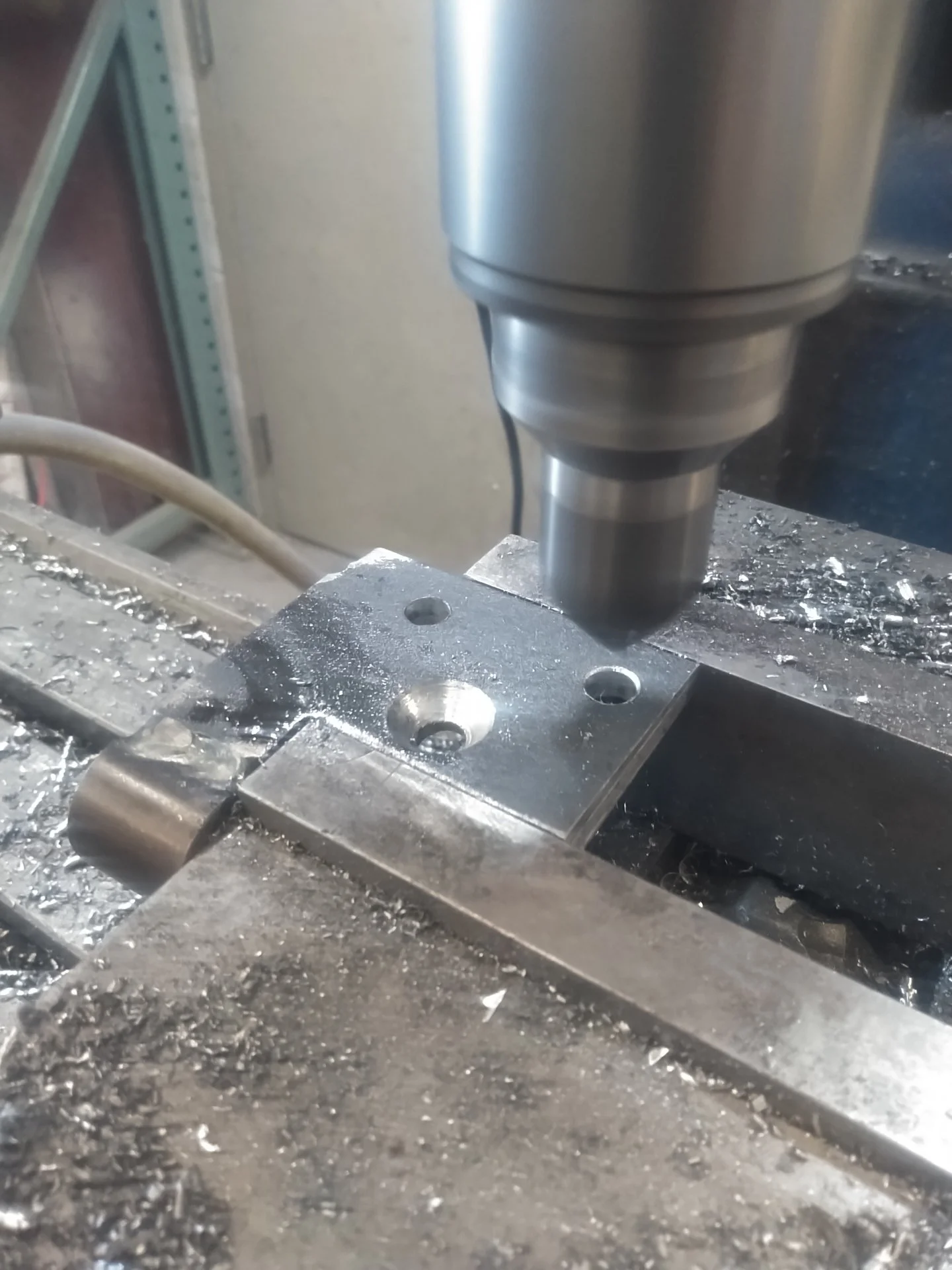

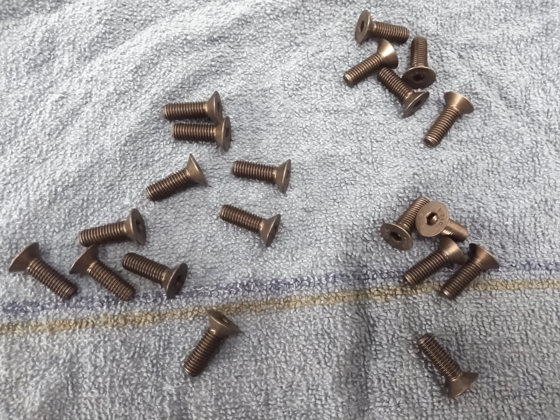

I know several of the countersink Phillips head bolts that came out of mine got destroyed. Still contemplating the choice between going Phillips like OEM or trying some Allens.
I picked these up yesterday. I decided to go with the Allen. I bought 20 of them for the tailgate. The cost was $5.

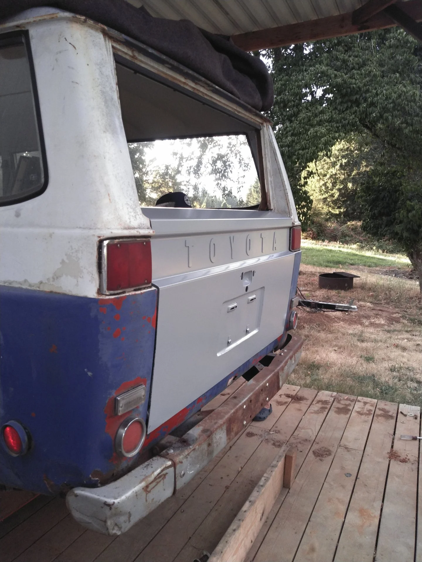

I Hope to have the tailgate installed back on the rig soon!
