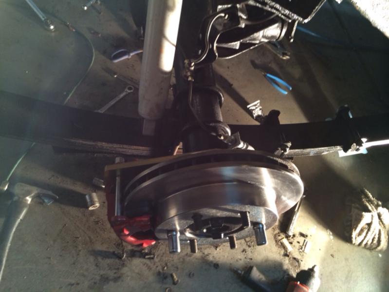

I installed the booster using an adapter from JT Outfitters to clear the firewall rib. I had to grind the front of the clutch master as well as part of the booster rib to clear. Not enough to hurt the diaphragm on the booster so I think it will be fine. It fits albeit tight but it fits. Even the stock air cleaner clears. I welded up a lengthened pushrod too. I am converting the rear to disc brakes at the same time. I got the brackets from JT as well. And the calipers and hoses & hardware from a 85 Monte Carlo and rotors from a 90 GM K1500 from The parts store.

Finally Discs on the front and back! I also put a adjustable proportioning valve, All new 10mm brake lines, took the rear end all apart and adjusted the preload. Installed new pinion seals and wheel seals and u joints that I got from cruiser outfitters. Along with some magnetic drain plugs. Now it's time to bleed the brakes and see if it all works.

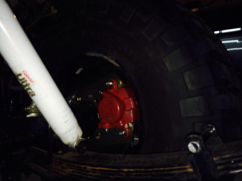

I have been thinking about the position of the calipers. I did not like how they sat so low. I was worried they would get hit on rocks or get mud stuck in them ect. So I rotated the mounting bracket up so now the calipers are up and out of harms way. Much better now.
I also have been thinking about the wheel studs. With the conversion they just did not stick out far enough for me. So after some research on mud I found that the Dorman 610-414 is the way to go. So I installed them today as well. Much better as well.
