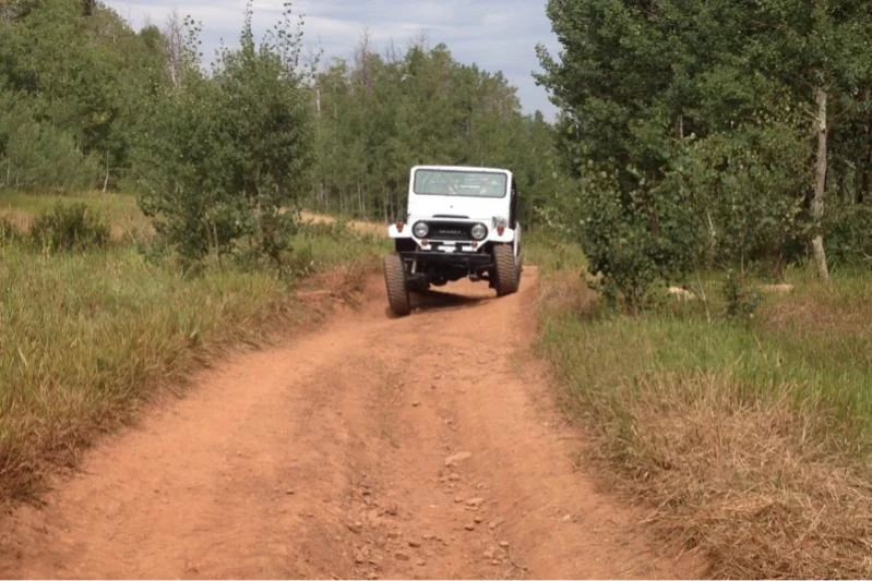

I took it to the mountains today for the first time!
I'm very impressed with it. I love this thing!!
I'm so happy I decided to keep it. Can't wait to take it on a few trail runs!
Here are a few pics of my maiden voyage.

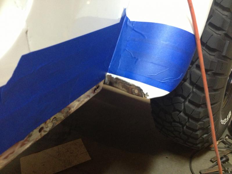

I made some side steps / sliders today.
When I took off my old steps the bottom of the fender looked like crap. Soooo after much thought I cut the fender. (My felt sick to my stomach the whole time) I still have to round off the corner to make it look better. So far though I like the steps. I made them longer so it will be easier to get to the rook rack I will be putting on later.
P.S. always wear your gloves when using the wire wheel kids.
How did you bend the tubing? That looks great. Nice job.
Everytime I see you truck I get jealous....those rockers look fantastic!
