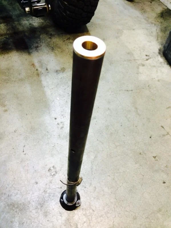

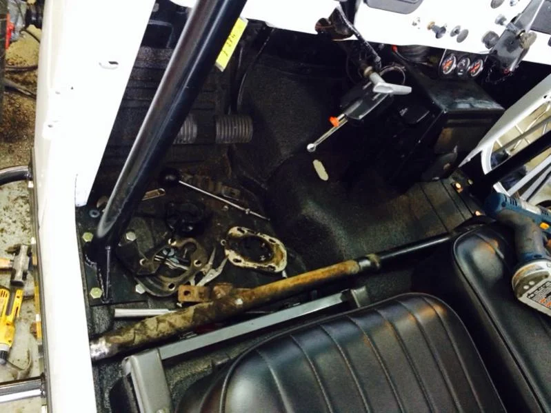

I have been work on my steering. I first cut the shock tower like I have seen in other builds. The box cleared but the u joint on the steering shaft would not. Also once it was all cut away it looked weak. So I decided to just take the stock shock towers off and switch over to ford F250 shock towers. Got them ordered. That will do a few things for me. First I can move the gear box a little more towards the firewall. I do not want to have to cut onto my bib like I have seen others do. And give me plenty of clearance for my steering shaft. The cool thing is I don't really have to buy anything. As far as the steering shafts go. I used the shaft from the box to the steering column out of the fj60 parts rig I bought. And I disassembled the donor rigs steering column. Took out the shaft that went from the tilt U joint to the firewall. I will cut that shaft just after the u joint and weld it to my existing steering column shaft I cut off my manual steering gear box. I just have to buy a column bushing from Kurt. I will fab up a plate to mount my column to my firewall.
Then figure out the steering arms. I thinking between the two rigs I can cut splice and weld me a good shaft together.
I got the Column bushing from cruiser outfitters today and started work on my steering shaft. I also fabed up a plate to mount my steering column. Made it out of 1/4" plate. It's a little overkill but that's what I had laying around. I welded the u-joint on to my shaft and it works very nice! I dig how it Looks like it belongs there. Not a bunch of s*** welded together like it really is. Once it's all painted up it will look factory-ish

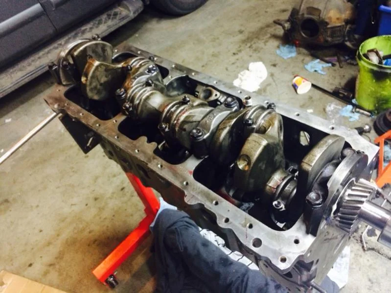

The crank look amazingly good. I measured it and it is std size and with in spec. I plastagaiged the bearings and they where all at the close side to max wear. So I will replace them.
I bought a bore gauge (I like tools) and checked each cylinder and they are all with in spec.

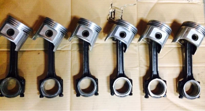

The pistons look good and are with in spec. I will hone the block and replace the rings with std size ones.

Checked all my bearing clearances with plastagauge. Checked thrust clearance, Checked ring end gap, piston to ring side clearance. Ect ect ect. I'm really impressed with this motor. It had 159,000 miles on it when I took it apart. Still has stock bore and std size bearings. I did not have to turn the crank or bore it out it all was in speck and looked good. I have rebuilt SBC and SBF with half that many miles that where worse. Toyotas at just bad ass. The head did need a valve job and had to be decked. And the cam was very worn. But that could have been from a too tight valve adjustment by one of the po's I guess. Anyway Time to start assembling
