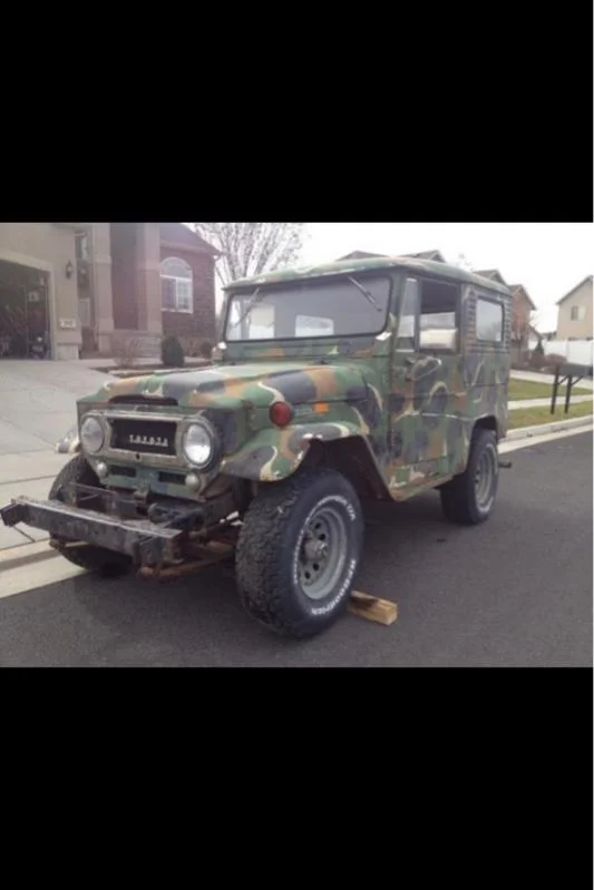

X2 on the before and after pictures. This 65 has come a long way in the last 9 months. Looks great, now it's snow camo. :cool:

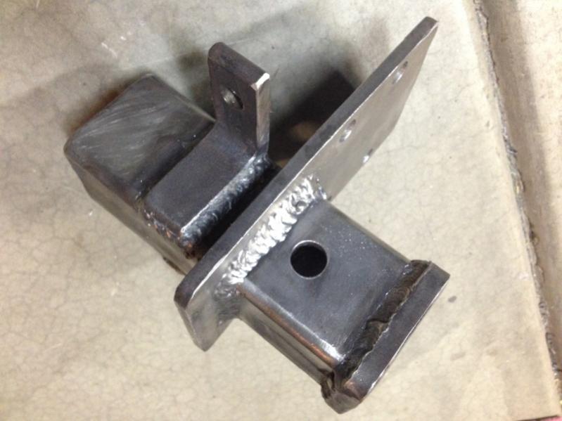

I started making a receiver hitch today.
I'm still deciding how far out I should put it. If I leave it almost flush it looks a bit better. But if it sticks out a few inches it can be a step as well.
Thoughts??
Thoughts??
I did mine flush and it looked good to me, but was a pain to get a pin lined up behind to keep my bike rack or trailer ball secure. So I think it sticking out enough to see the pin hole or enough to install locking hitch pin would be good. And it could then be used for a step like you mentioned. Just my experience.

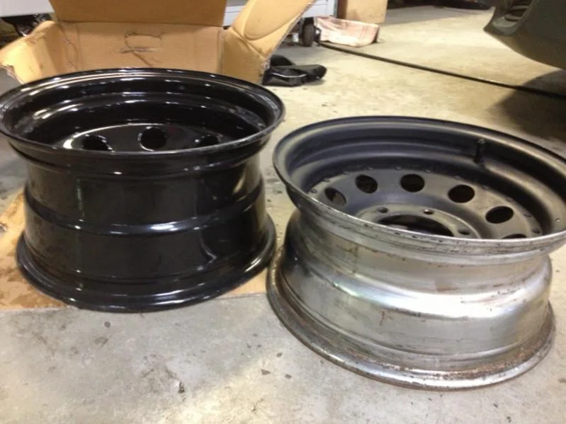

I got a new set of wheels today. I really thought my old wheels where 15x8 so I ordered those. But turns out they where 15x7 oops. O well they looks fine. My old set where bad off they took A LOT of wheel weights to get close to balancing.
New ones are soo much nicer. They look very similar just gloss black and fewer / larger holes. Best part is I got all 5 delivered for 234 bucks!!
Finished building my receiver hitch today. I decided to let it stick out. Then I can use it as a step and it will be easier to put the bike rack on like corleykj said. It won't be pulling any big trailers but will work just fine to haul my mountain bike around.
