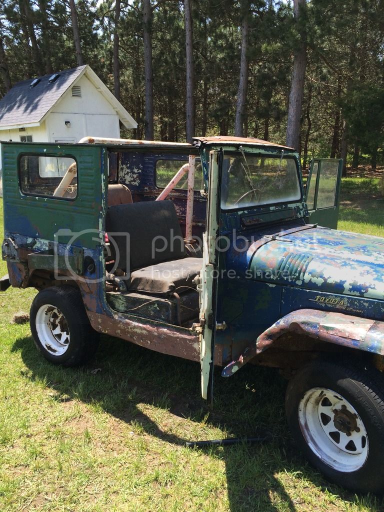

Anyways, back to the story. Not a lot known about this thing, it was sitting on top of a mountain in Tennessee for what looks like the better part of a decade, at least. Even upon first inspection it was obvious that it would need A LOT of work, but I'm young and have never done anything like this before so I guess I just didn't know any better. Plus, its the first real contact I've had with an FJ and the price was too good to pass up.
Side story - Early April, two weeks before I picked this FJ up my wife and I were in Nashville on vacation and late one night while walking back from Broadway to our hotel we were talking about the FJ, the plan, etc and to our disbelief we walked up on an FJ40 in the road. I believe I said, "OMG, look an FJ!". As it turns out it was a younger guy about my age and he'd run out of gas, so we gave him a push and off he went rolling down the hill and into the gas station. I think it was a 70s model, and I think it was red? Not sure if he was a Mud member, but if this sounds familiar to you let me know! So, THAT was actually my first real contact with an FJ.
Back on track again. The first time I saw my FJ was the day after the story above. Then my dad and I drove back down a couple weeks later to rescue it. Here's a couple pics from the rescue operation.

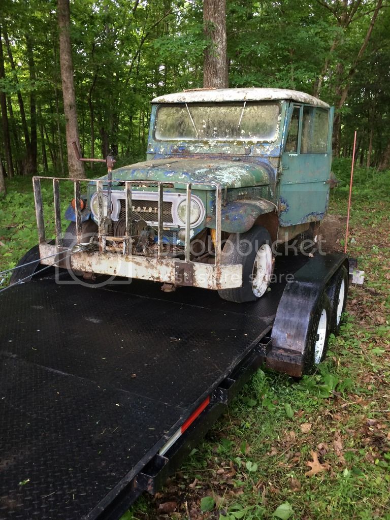

First glimpse was pretty special
Trailer winch coming in clutch
Surprisingly, two of the tires still had air in them. I know that because they popped as we drug it up onto the trailer. Turns out both front hubs are locked up as is the rear end, so we literally drug it onto the trailer, it didn't roll.

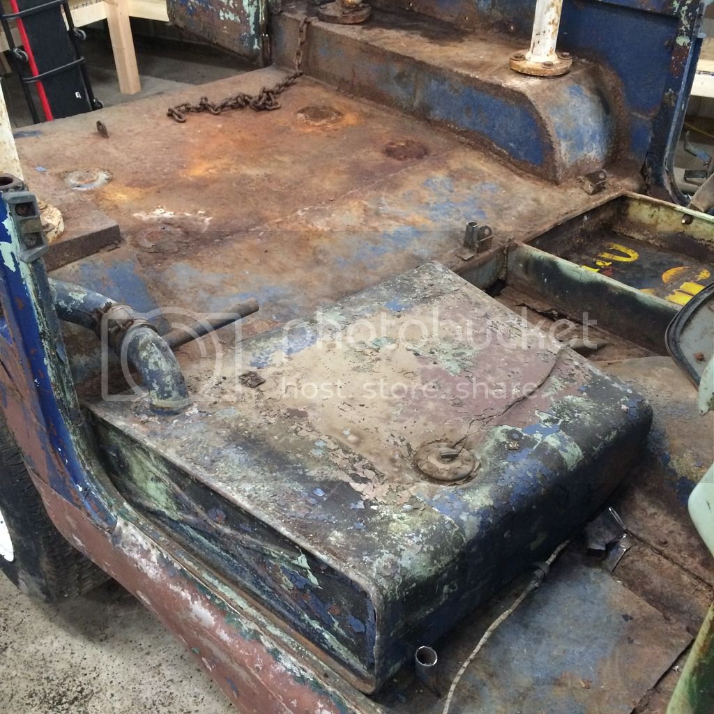

Once we got all the old trash out of the interior it was VERY OBVIOUS that the floor in the rear had once been replaced, and new metal was set in the floorboards to keep Fred Flinstone from driving this bad boy around.

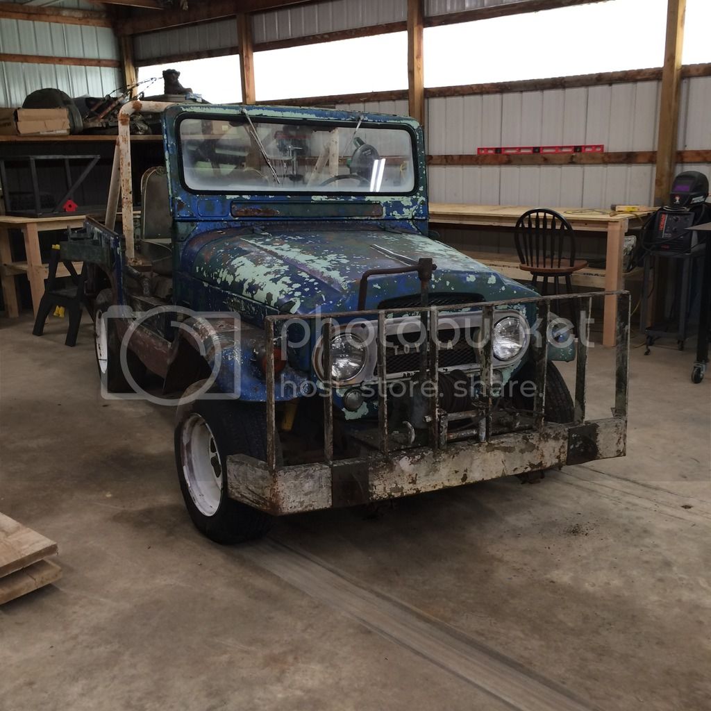

Since all four tires were locked up it was interesting getting the FJ into the back of my barn. We ended up using my old truck to push it, bumper to bumper, around the yard and into the barn. :grinpimp: I wish I got it on video, but it was only my wife and I and we were both needed to pull it off.
How about that front bumper! :rolleyes:

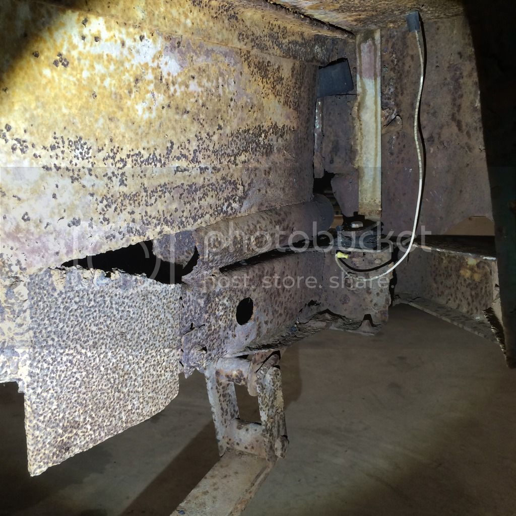

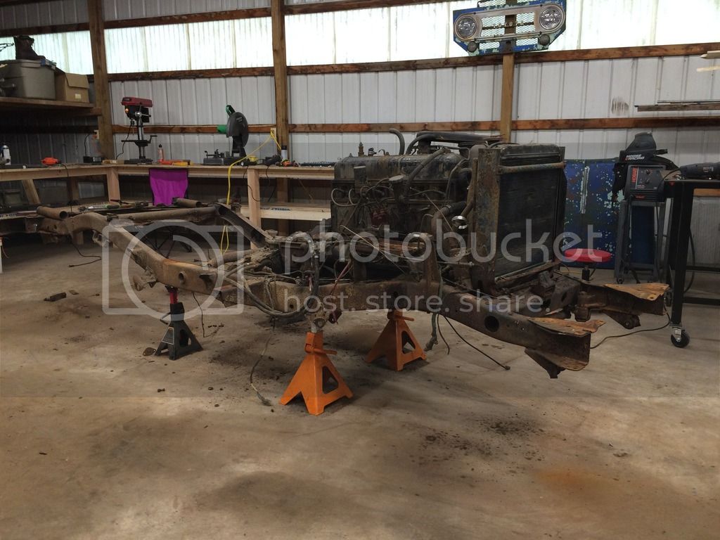

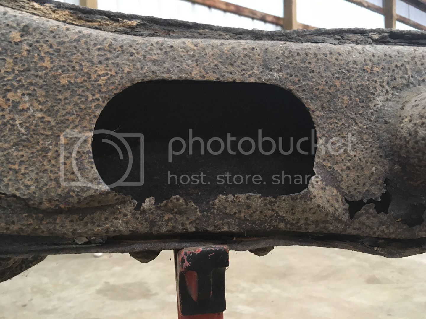

As mentioned previously, even the frame was in bad shape. I knew from the start that I was going to chop and replace the back part of the frame to give me extra room to stretch the wheelbase and fit a big axle. Once I figured out I was going to have to completely rebuild the back half of the tub I figured what better time to stretch it than now, right? I knew that eventually I wanted it stretched anyways, and besides, stretching the frame would be the easy part. Dangerous rabbit hole for sure.
So after the tub was off and motor was pulled I got a chance to really inspect the frame. Do not like.
Lots of that - even areas where the frame was boxed it looked really bad, very weak and even thin in some spots. CRAP!
A lot of time was spent staring at it trying to figure out what I've got myself into and what to do about it. Not too late to run...but I REALLY want a 40!
