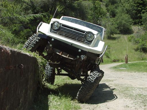

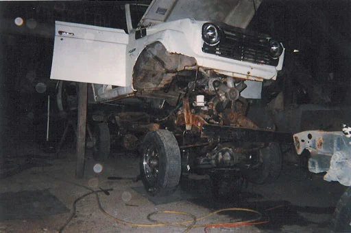

here are some pics of my blazota project that was done back in 1992 or so. the green 55 in this thread was mine back then too. strange that it would have the same fate as the spider truck.
the spider was hit by a semi and the frame was ruined. that incident sparked the blazota project.

heres a few more
ramps pretty well with the stock rear chevy leafs and 55 rears in front. 38.5x11x16 boggers look a little small.
my buddy dom, who bought the green 55 (in this thread) from me named it 'guacamole' before ken hanna bought it. it changed hands again before it got the blazer chassis.
-luke
