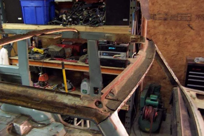

Its hard to get a pic of the damage but there are a hundred or so dimples from the inside out from someone beating out dents from the inside.Also rust in the common roof areas.
Another shot of the roof.
I think I am going to go for something like this idea for the roof.

Im gonna do the rest of the top like this pic (cut out the center)but leave a little more after the windshield and make a soft top for it.Want to keep it somewhat element free in the cab :D

Got the cab off this weekend :grinpimp:
