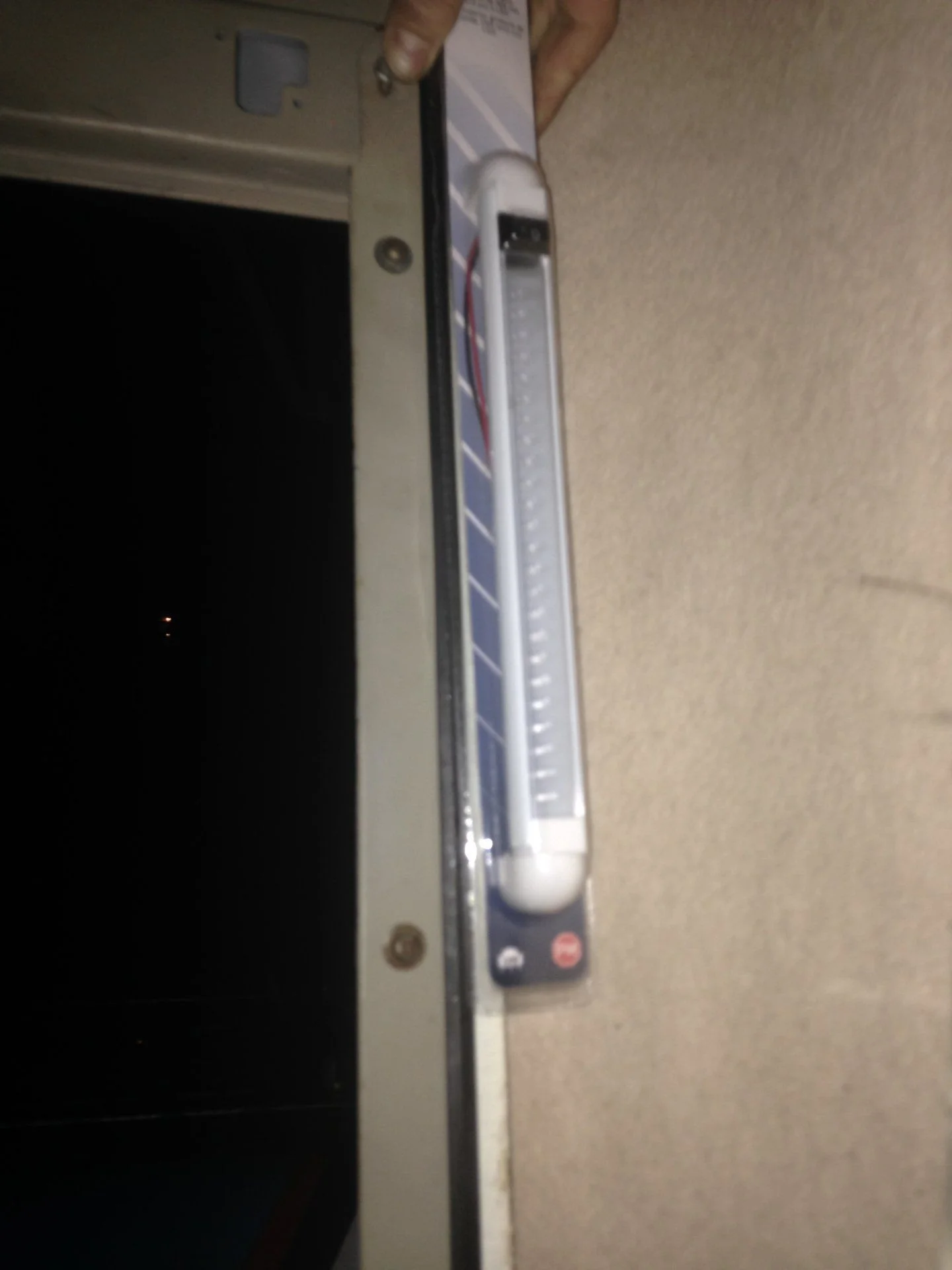

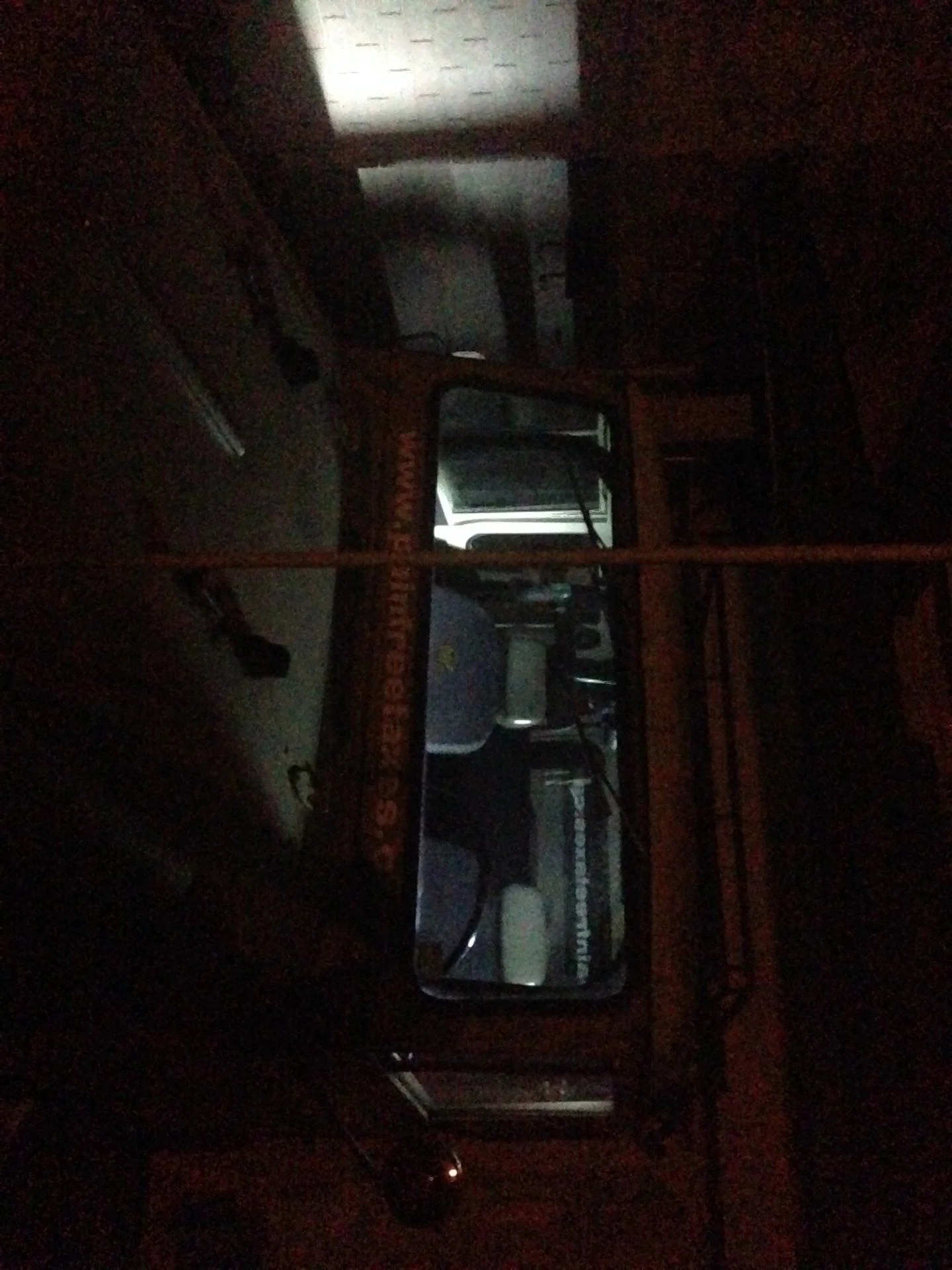

Wired in the interior LED light. It can be aimed for indirect or direct lighting. It also mounts without making any new holes.
As for brightness... if the passenger door was open, it would throw enough light to set up the campsite :D
Found this 'Dome light' on clearance at Walmart for $9. If you can find one, it looks like it'll fit the factory bolt spacing. :D

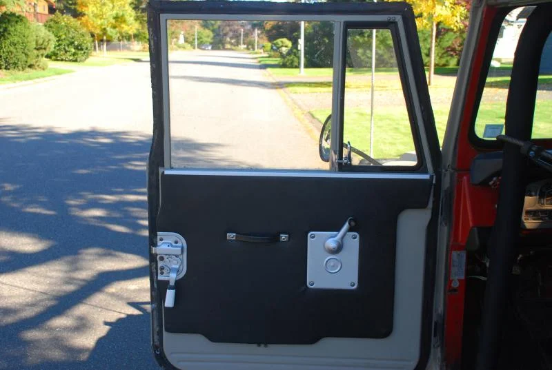

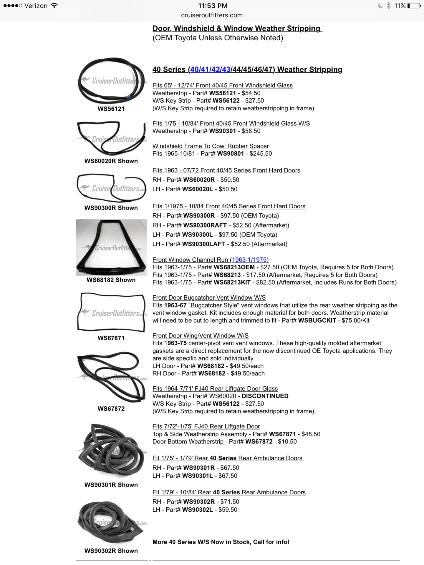

Any recommendation on the best suppliers for weatherstripping for the front doors. Looking at 72 OEM weatherstripping.
I still need to give Kurt a call. I've got a quote from Beeno. Shipping to Canada is also unavoidable. Any other recommendations?
View attachment 1641183 Any recommendation on the best suppliers for weatherstripping for the front doors. Looking at 72 OEM weatherstripping.
Give us a shout, we stock all the OEM and many aftermarket options. Canada is no problemo shipping :cool:
View attachment 1619066View attachment 1619067
Now that I've sorted out the ground, it's crazy bright... and the install couldn't have been easier. It mounted using the existing bolts and connected to the existing wiring. Its angle can be adjusted for either direct or indirect light. $9 well spent at Walmart.

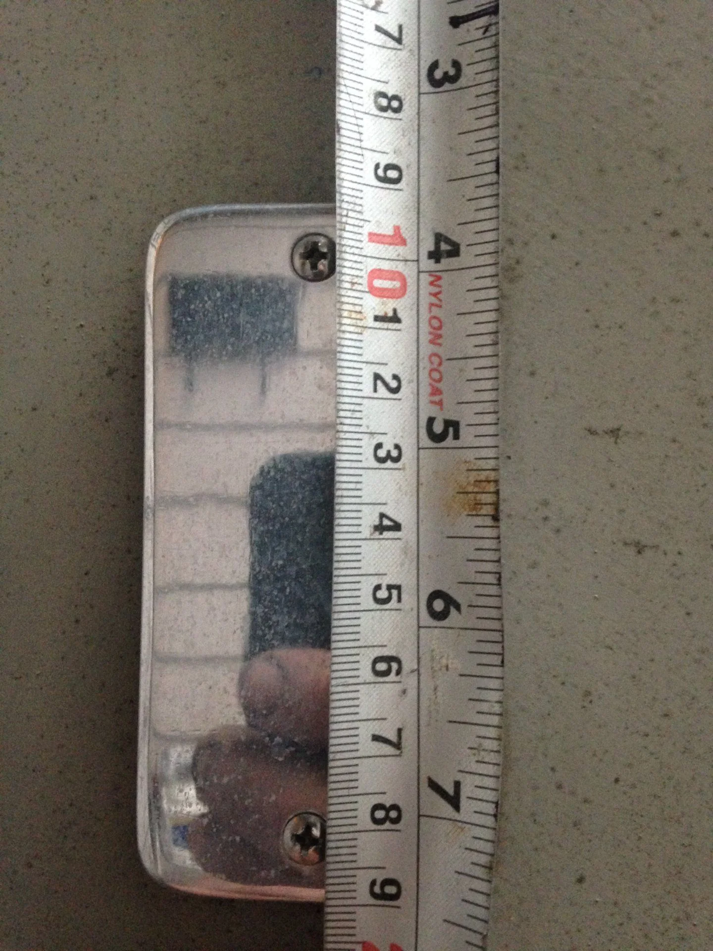

Does anyone know the width of the spring perches on a 40/45 rear axle vs a 60 rear axle?
The reason I'm asking is that I'm wondering if a newer 60 sway bar could be mounted to the back of my FF 45 axle versus mounting one in the original position and connecting to the front.
Anyone know the width of a 60 rear sway bar? Or the C-C width of the springs on the rear axles?
I know the front are wider than a 40, but don’t know about the rear spring spacing.

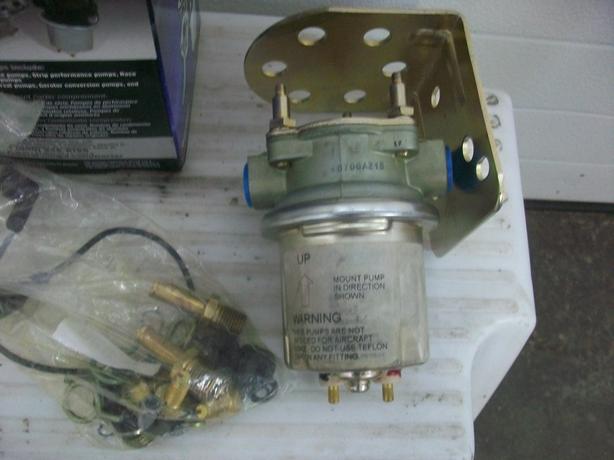

Bought an insurance policy. The P4070 I installed in ‘96 is still going strong, but after 22 years I figured I should at least carry a spare. The old pump seems noisy but I’m not sure if has got louder or if the truck being quieter just makes it sound loud.
@Solace in Solitude bought a pair more recently also. I ended up buying a new one from a hot rodder that he carried as a spare. It was new in the box and made in the USA.
There seem to be two versions of P4070 pumps. Some are 2-4 psi and others are 4-8 psi. I don’t know if the ones made now made in Mexico are lower psi or it’s unrelated that the newer ones are made in Mexico.
I feel more confident in a NOS pump made in the USA rather than a Mexico pump. I don’t know that a Mexico pump wouldn’t be just as good, but a drop in rated pressure in many of the newer pumps makes me leery.
What I do know is that my 22 year old pump pump was made in the USA and I couldn’t be happier with it. Well I would be if it were silent... but better isolation should help with that... besides it’s not like the 40 is silent.
