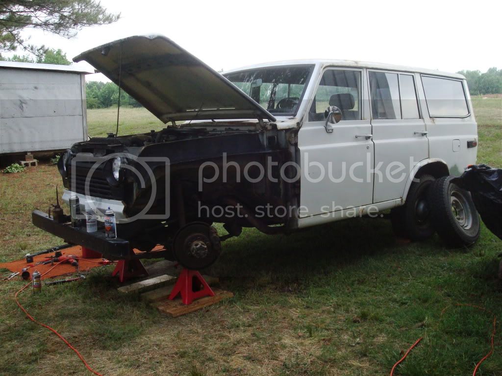

I have had this pig for a couple of years now (Hauled it back from Boone, NC) but I just started getting around to taking it apart. She is a bit rusty in some areas, but an overall complete pig. I am planning to get as much rust off as I can and get it back to stock. I bought a 2f for the pig but am thinking about putting another original F engine back into it. The original engine had a baseball sized hole in the block and I never had much time to work on it.
Last month I had some extra time on the weekend and started taking the front end apart to get the engine out and taking on the "fun" task of getting it running.
Here are the pics:
#1. Complete when I first bought it but rusty.
#2. Interior
#3. As of last weekend

Thanks bob. After I get the much needed bobm rockers and rear floorboard, ill hopefully be able to manage the rest of the rust and once I get a new engine in there im hoping to take it back to the original blue and white with maybe some 33s
