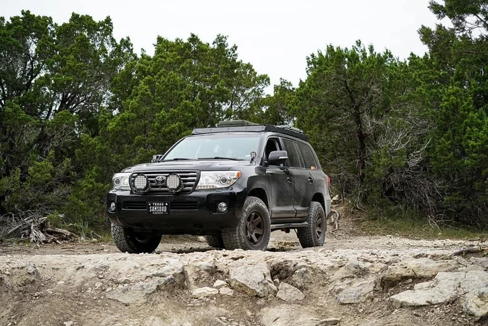

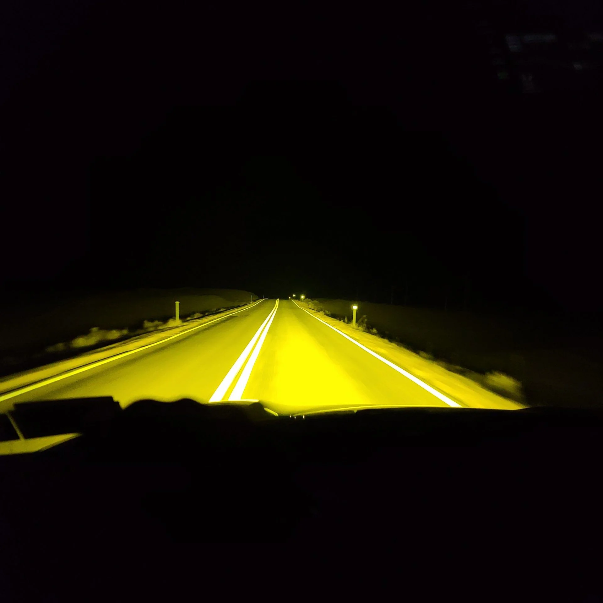

FWIW, the IP6's are tight. Switch in area where a key would normally go works well. Yellow tint is aggressive but we'll see if it's worth it in a few days :-)
If yo happy with the functionality I‘m interested in a set. Let us know when you have an idea on pricing. Thanks👍
Super happy. Front of car remains unchanged and both on highway and trail, they project clean and well. When I first got them, I noticed the steel mounts have a little flex to them... in practice, it's great. You can see them in the front camera but still retain functionality.

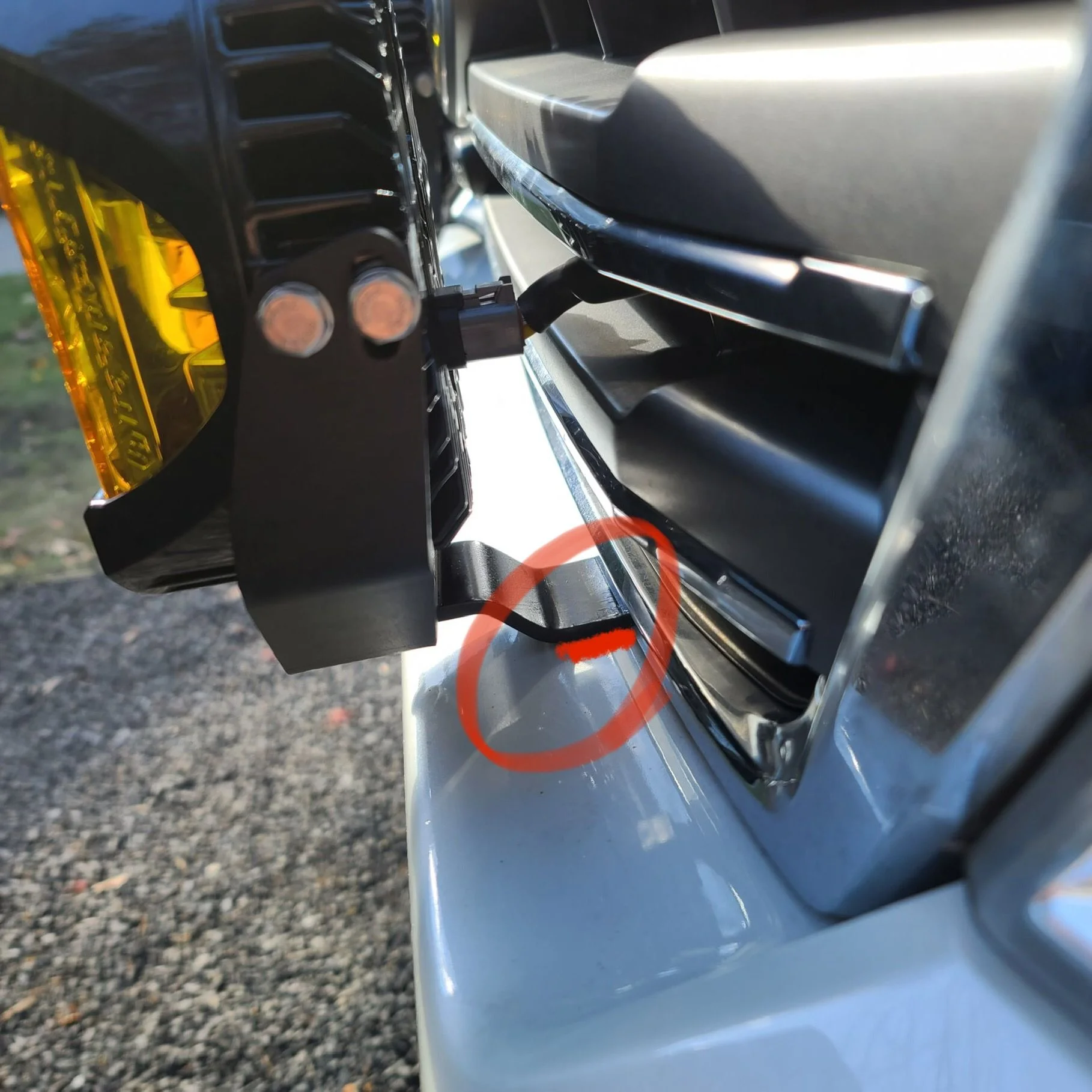

My only concern with this design is marring of the bumper from the mounting tabs deflecting due to the weight/leverage of the driving lamps at the end of the tabs. Maybe this is not a big issue for pavement driving, but I would expect some deflection of the tabs offroad - especially washboard roads. Any feedback on this? From the photo you posted, it looks like there is little to no tolerance between the tab and the bumper? I circled and highlighted the area in question in the below photo:

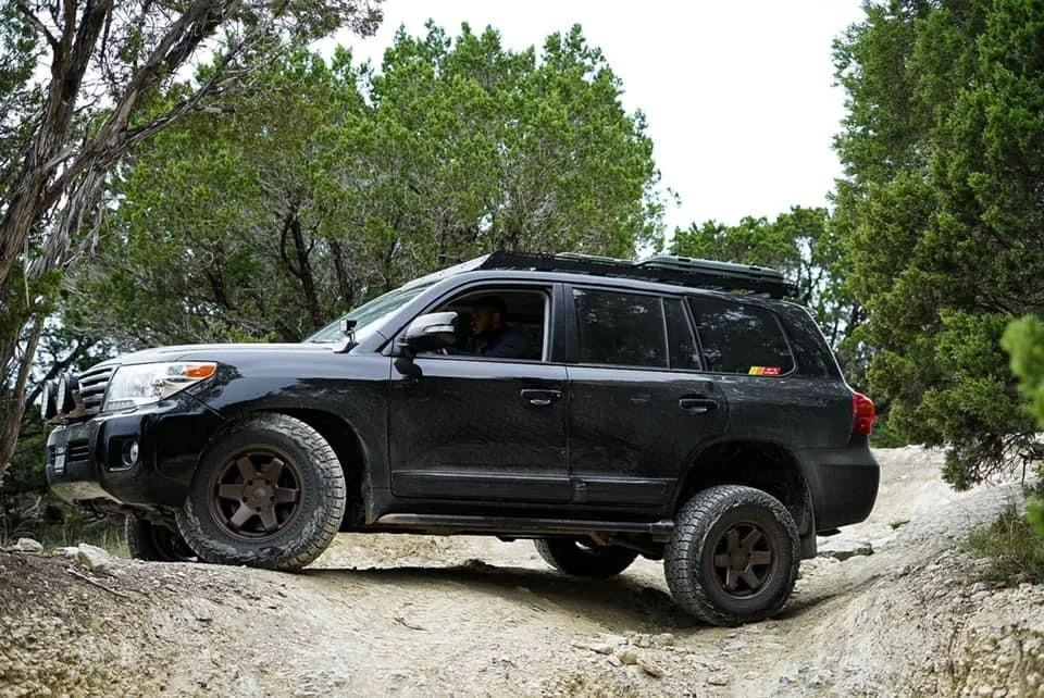

@yonah - This was my concern as well.... figured if it broke, I'd go ARB. That being said, I've got 4k miles with them now and am currently sitting in NW Montana, 25 miles from the closest pavement and have at least 500 dirt miles with them. Good as new. Tiny bit of surface rust on my tabs but the run would be done in aluminum to make that a non issue.
The lights have a slight bit of flex in the mount and the metal seems to absorb the bouncing more than the bumper. Nothing is loose, just a slight bit of flex in the metal.

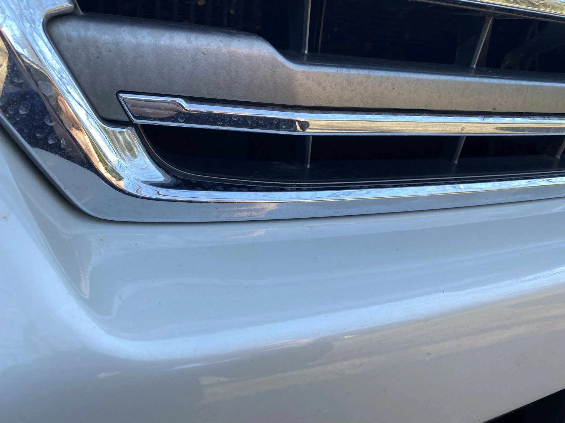

My issue is that on my cruiser at least, that gap is almost nonexistent. For a piece of flat stock to be stuffed through there something has been flexed out of place, likely the bumper skin because the grille is harder plastic. This means the bracket would be rubbing on the painted surface of the bumper, possibly require trimming of the back edge of the bumper, etc. But I think they did this to make it easy to support the bracket for front to back movement.
I’d want the bracket to protrude through the slats in the grille, personally. This would require no modifications to the bumper skin or grille, and if done well wouldn’t contact any painted/prepped surface. This would complicate the forward/backward support, probably requiring a separate horizontal leg off the vertical bar to tie into the metal bumper support, vs just bolting the light mount bracket itself to the top of the bumper support.

I’m attaching pictures of the gap on my 2013 cruiser. It is about 1/32” without pressure, squeezing as hard as I can that grows to less than 1/8”. Not wide enough to get material I’d think is stiff enough through, let alone without contact.
Just back from 5600 miles with plenty of washboard and trail thrown in. All good. Texted the guys to see when they might be able to run a batch of brackets. Lights and brackets worked great. Little bounce at 80 mph on chopped up cement but not sure this would be fixed even by a metal bumper :)
