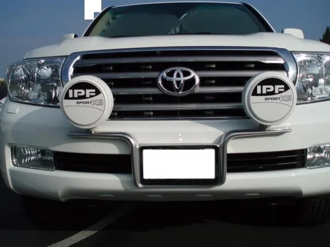

I uploaded the IPF 900 xs HID lights mounting pictures. I had the dealer installed them by mounting using Light Wing CARR product. The procedure is a little more involved than hanging it through the existing license plate holder. What they did was removing the bumper, insert a heavy galvenized steel plate between the Light Wing and the bumper in order to make a rigid mounting surface. The rest is all good. The product is made out of solid aluminium and it does not flex or bow. This gives me a good off road lights when needed. One thing good about using your authorized dealer....if it falls off......back to the dealer it goes.
Hope this help.

Neat Idea....wonder if they wobble at all.
Hope this help.
That looks TIGHT!!! (As in space!:hillbilly:)
But it's not too shabby! ;)
I guess the picture didn't reveal the whole mounting set up. They shock isolated the hardware by using a combination of washers and hard rubber mounting plates with a good application of loc-tite fluids. The Toyota dealer in my area did a great job and guaranteed all their work. Internal electrical harness and ballast box were well positioned and professionally mounted as if they were factory installed.
Tested out at a trail near where I am at .....trail rating at a 4... (1 = easy to 10= Rubicon type difficulty) and these lights held up very well. Under worse-on-worse condition (i.e. I was bouncing up and down in my seat) they did wobble a bit but so does the entire OEM headlight beam. Of course, this is not a substitute for ARB bull bar, but it answers my specific needs for now.
