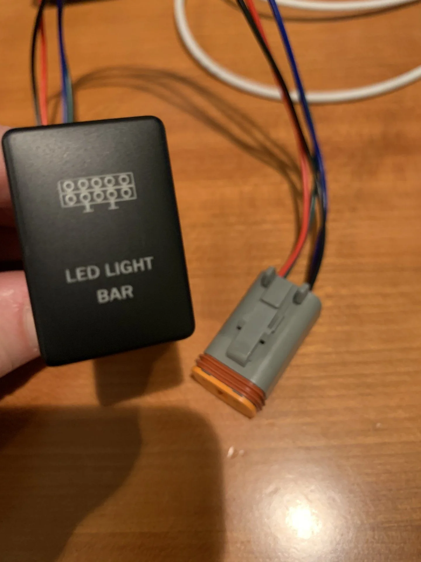

I added Deutsch connector to the switch. I have a faceplate on order to change from light bar to circular driving lights. Eventually I'll find a good source to match the "soft ramp" of the stock lights when they are illuminated (these switches light up completely when on, and also the lower text optionally when the OEM dash backlights are on via a separate wire). But not a priority right now.

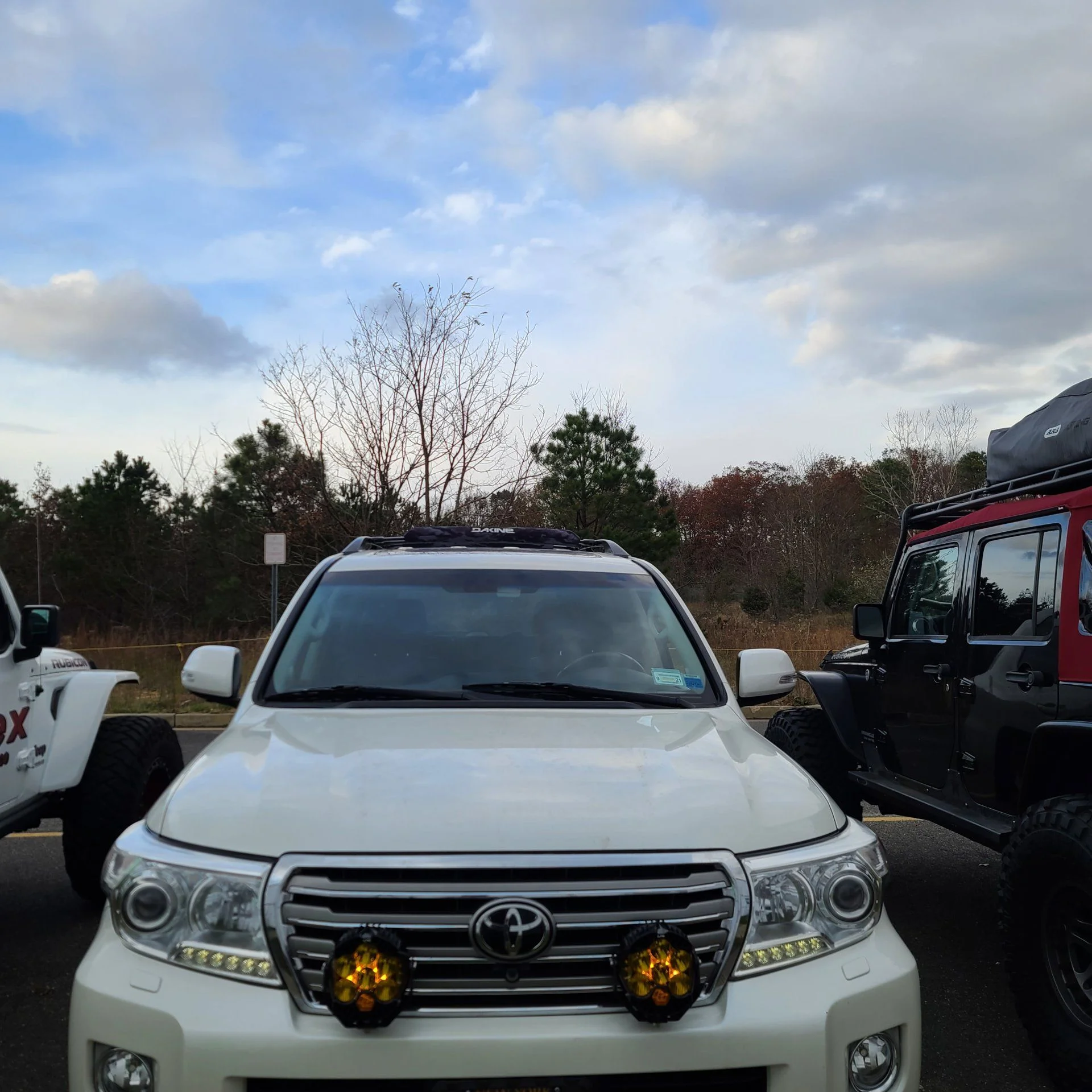

Lights did pretty darn well. Over ~6 hours of driving with a mountain pass and semi-quiet wide open desert-ish highway. The light to the sides is unbelievable. As in the reflective road signs are unreadable due to the reflection. They pretty much overpower the stock high/low combo. When going over a bump and the auto-leveling kicks in the line from the lows can be briefly seen. No jitter from the mounts that I could tell, but with this much light its probably impossible to tell unless it is major. I'm still going to weld on side pieces to make it an H frame. Because if nothing else, I need a lot more hood time is to get my welds back to respectable.
This is nitpicking a little but I was hoping for a bit more distance light. Beauty of these is that as @KilaCruiser mentions above for ~$75 you can get replacement lenses with different optics. So not a huge deal to switch to pure spot. This alone is a reason to go with BD lights. After ~6 years the lens on my Rigids that I ran on my GX were pretty chewed up.

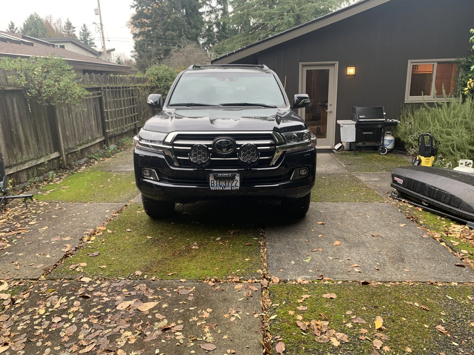

6's are on and they were able to use the existing holes on the bumper, behind the grill.
If the mounts work well over the next week or two (cant see why they wouldnt), the guys said they'd be happy to do a run with CNC'd aluminum.
Front camera works fine but you see the lights... Radar/sonar seems to work fine as well.
