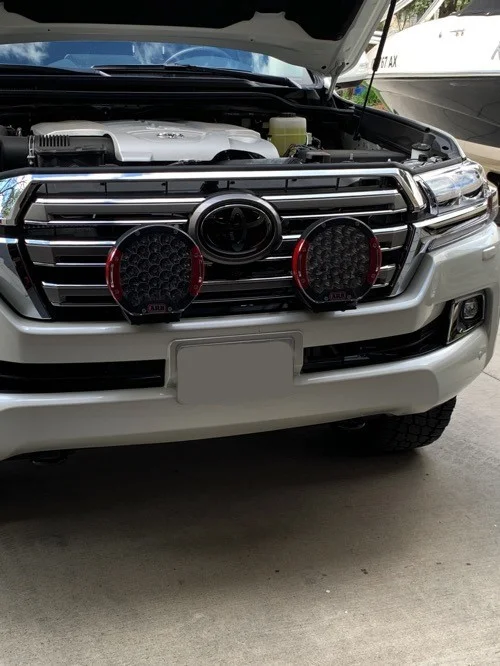

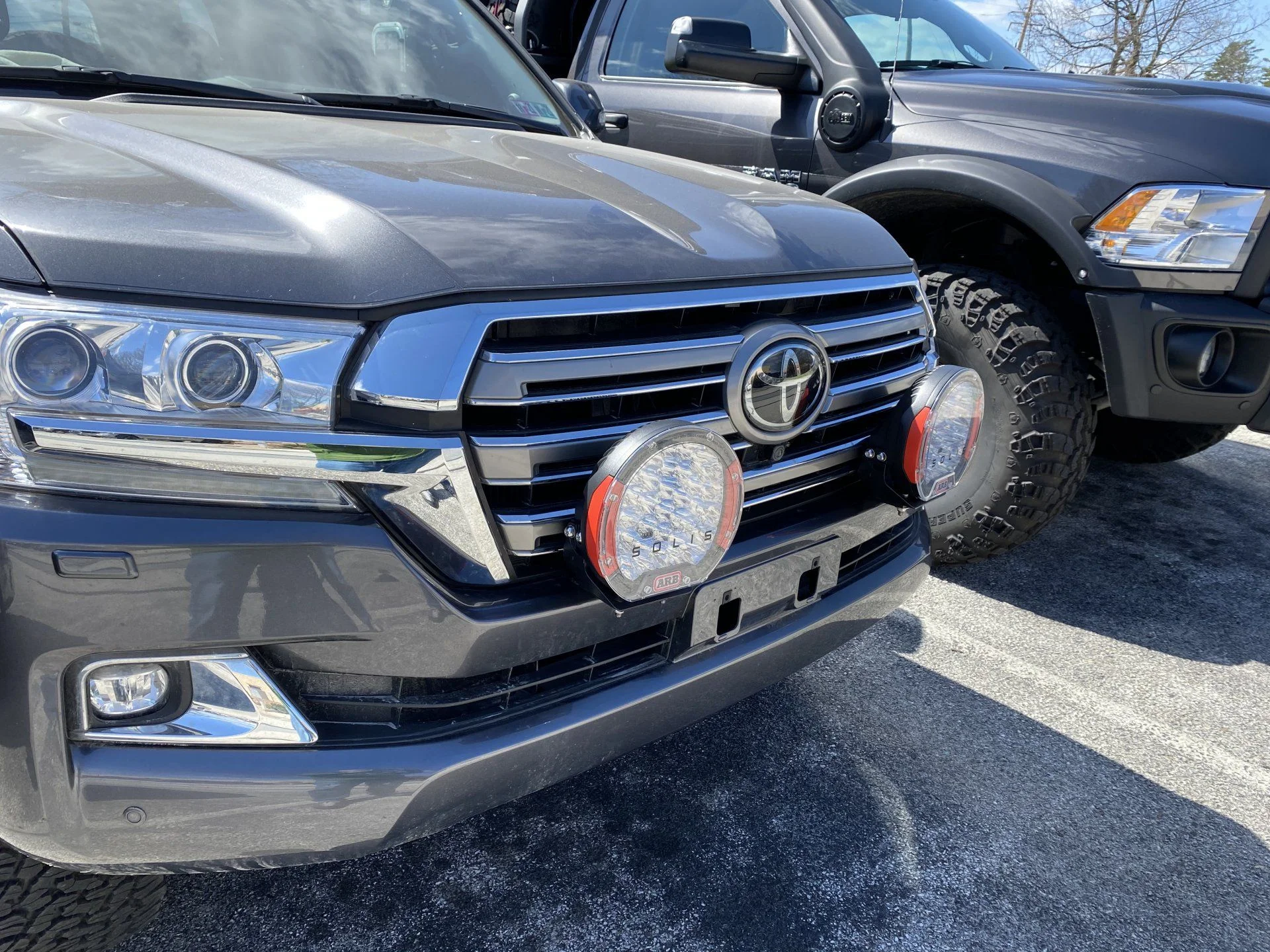

Email sent, did you have a final pic of your rig with lights mounted?
Curious to see the final product and install requirements.

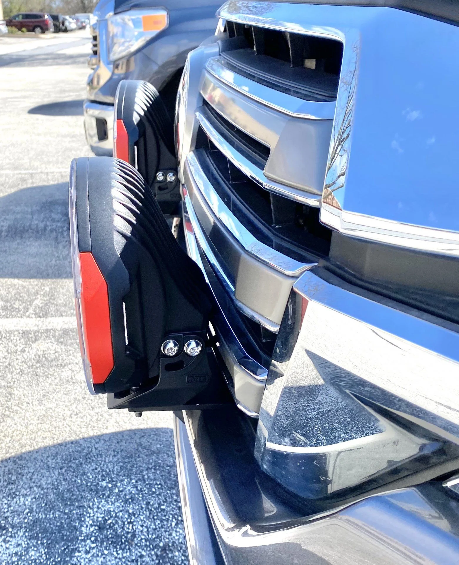

They dont look any different than the original photos but that I've swapped the yellow winter lenses for clear.... bracket changes were behind the bumper. Wish I could help on install requirements but dont know much beyond they used existing holes and DID remove the bumper cover...... My (uninformed) understanding is that the art was making the brackets and that the install is relatively simple.

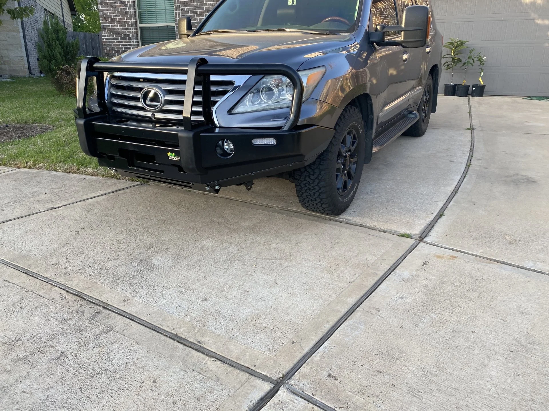

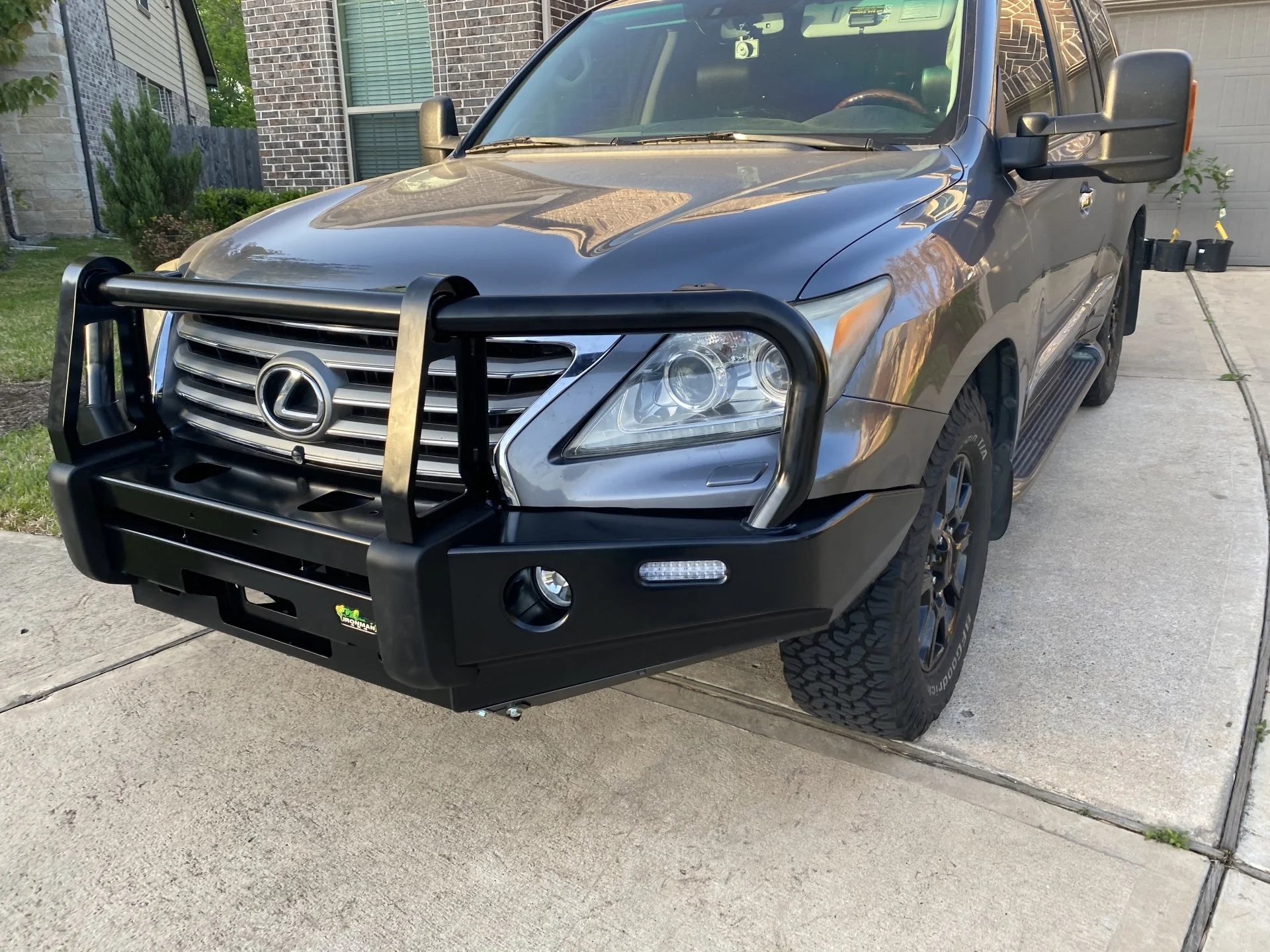

I know this isn’t an ironman thread, but to followup on your question, the AHC does a beautiful job of keeping everything at the right level. The LX drives perfectly and I don’t even notice extra dip when braking or anything. I’m really happy with the bumper so far. The first bumper ironman sent me was damaged by UPS and they were really cool about shipping me another one really quickly and with a different freight company. The second one was immaculate.

Yep, thanks. I probably do and will play it by ear. For now I’m just glad to have the vehicle back after it being down for 3 or 4 weeks while I waited for a second bumper to be shipped. The first was damaged.

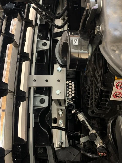

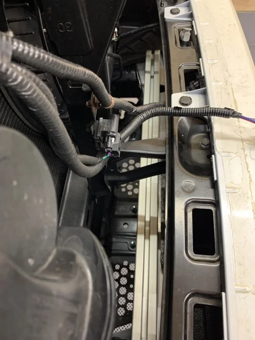

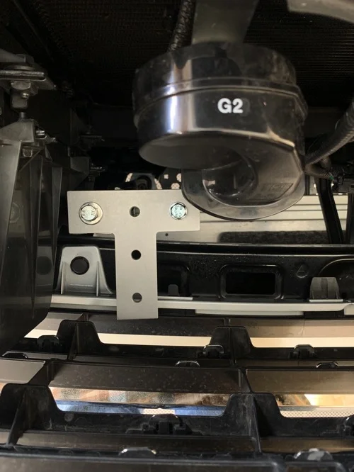

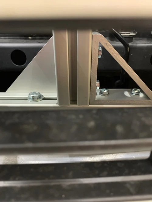

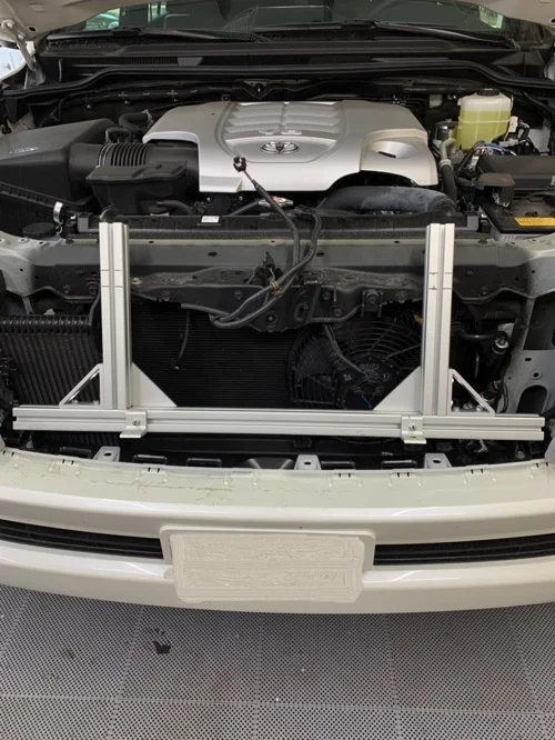

Mounts and Finished Install:

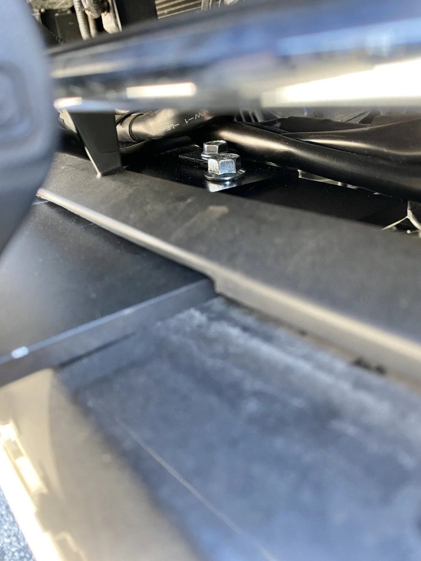

The 12mm nut/bolt at the end of the bar in the above pic goes through the aluminum crash bumper using existing holes so no modifications were done and this all can be removed.
Grille is not cut or modified either.
