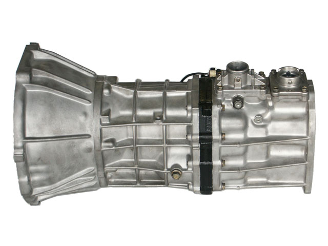

Last Fall I posted a picture of the R151F tranny that I had just rebuilt. Yesterday I finally finished up the companion transfer case, with a Marlin 4.7 crawler gearset installed. Prepare to drool...

I tore it totally down, ran the case parts thru a parts cleaner at a local tranny shop, then I bead blasted them. Then I put on a coat of Rustoleum primer, followed by 3 coats of Rustoleum Matte Nickel. The paint is less about making it pretty, I'm really just trying to keep it from getting all corroded and nasty again. It was disgusting when I pulled it out of the parts truck.
