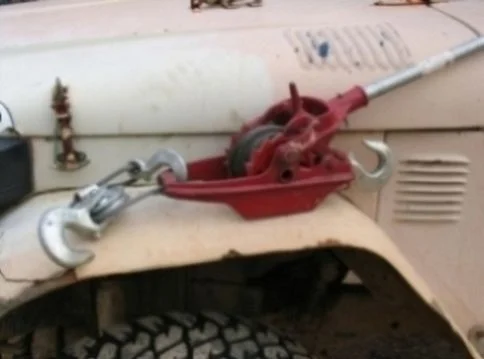

Did a search and nothing came up on the Power Puller, so I wanted to pass this along.
If you're in need of a come-a-long skip the cheapies and pick up a More Power Puller, the Hi-Lift equivalent of a hand winch. They're rated at either 2 or 3 tons and have 20 to 40 feet of 5/16" cable, depending on the model. I've had one about 3 years and it's been indispensible on several occasions.
The company's website: http://www.wyeth-scott.com/; a place to get them: http://www.cspoutdoors.com/morpowpul.html.
I've got one t0o.
This thing has saved my a** more than one time. It is on the heavy side, but for about $120.00, you can't beat it as a safety item. I've pullled my rig and many others through loads of deep mud with this thing. Sure, its not an electric winch, but you can't beat it for the price.
I went with the 3 ton model and paid about $130.

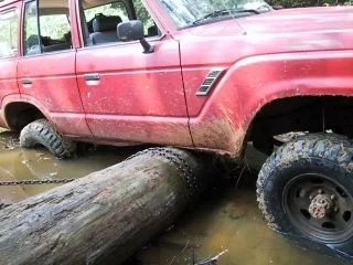

In one instance, while backing down an eroded road which crossed a creek, I ran the FJ60 up onto a halfway submerged log. The rocker panel was crushed and the Cruiser became stuck. The Power Puller was used to pull the log from beneath the Cruiser, but to keep the Cruiser in place, and to aid in pulling in away from the log, a chain and Hi-Lift were attached at the front left frame. A regular front mounted winch could have been used here but only by increasing the degree of body damage.

If you read the companies website the rating if for lifting, and its rating for dragging something is twice its lifting rating. So a 3ton puller will drag 6tons. I am hoping to buy one of these soon, been wanting one for awhile. With that kind of power it could be more versital than a front mounted winch.
