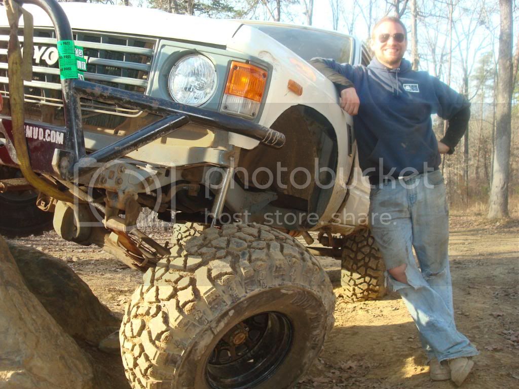

Had the ONSC December trip to Uwharrie to close out the 2011 wheeling season. Blew a motor mount and split the shock mount welds on the PS frame rail. The ONSC crew is awesome and hanging out with them is always a blast:grinpimp:
Stupid tire still rubs even with the carved up fender.
