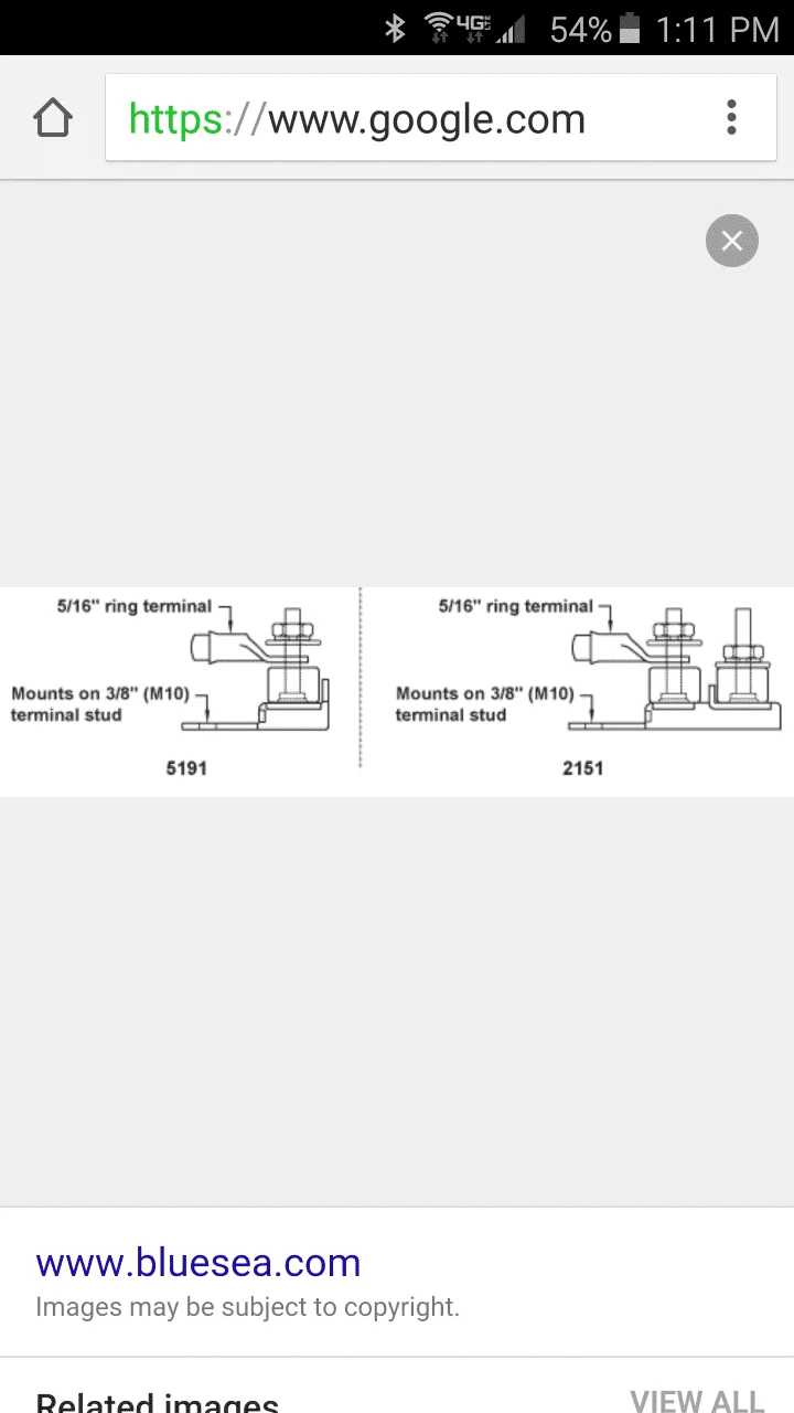

I'm using these for my dual battery install. One per es terminal.
How do you attach the MRBF to the battery terminal?
That's a lot more compact than the ANL fuses. I might go that route.
Looks like a good solution. Be sure to have 1 or 2 spare fuses because they will be quite uncommon in the field.
