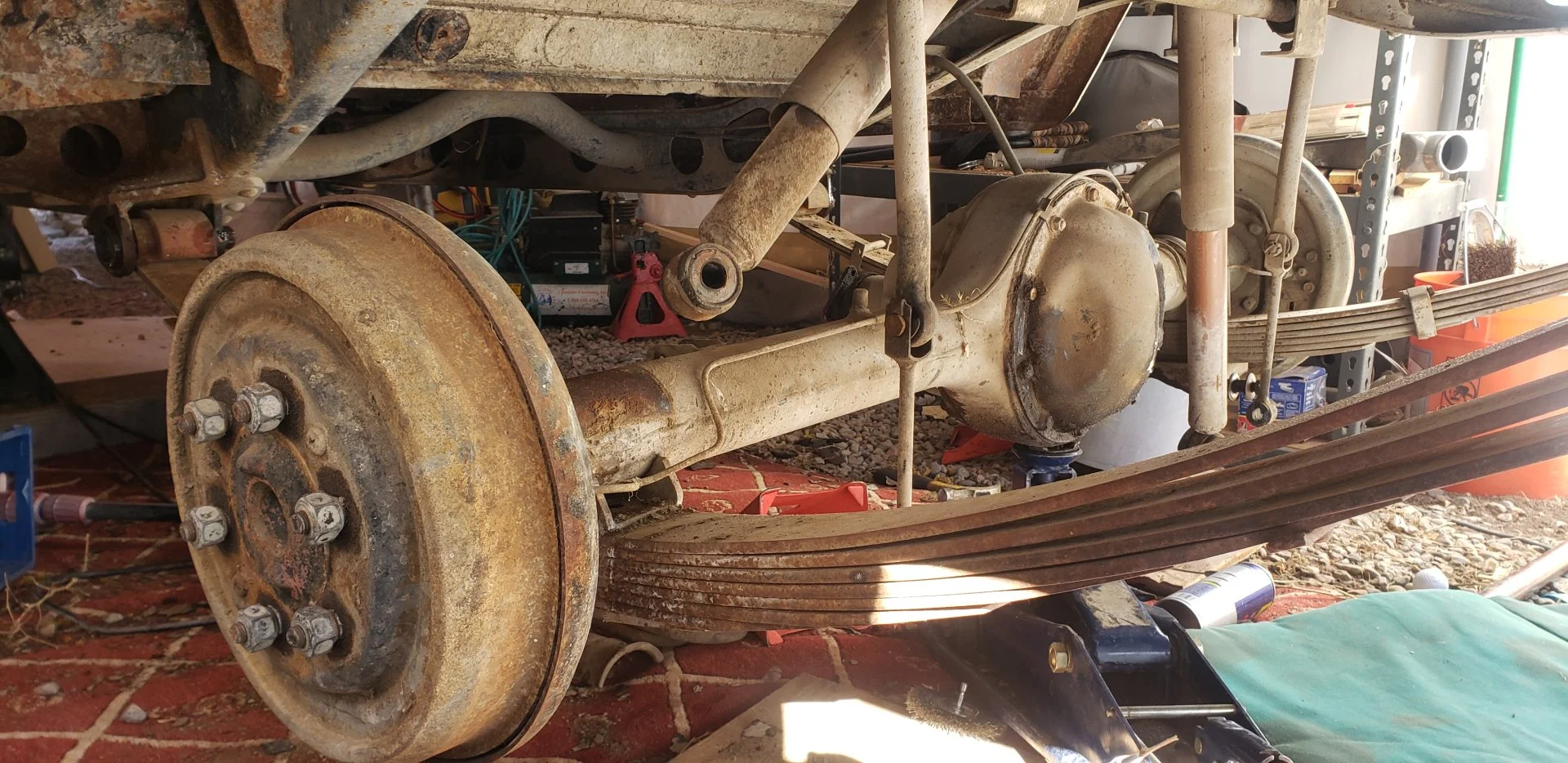

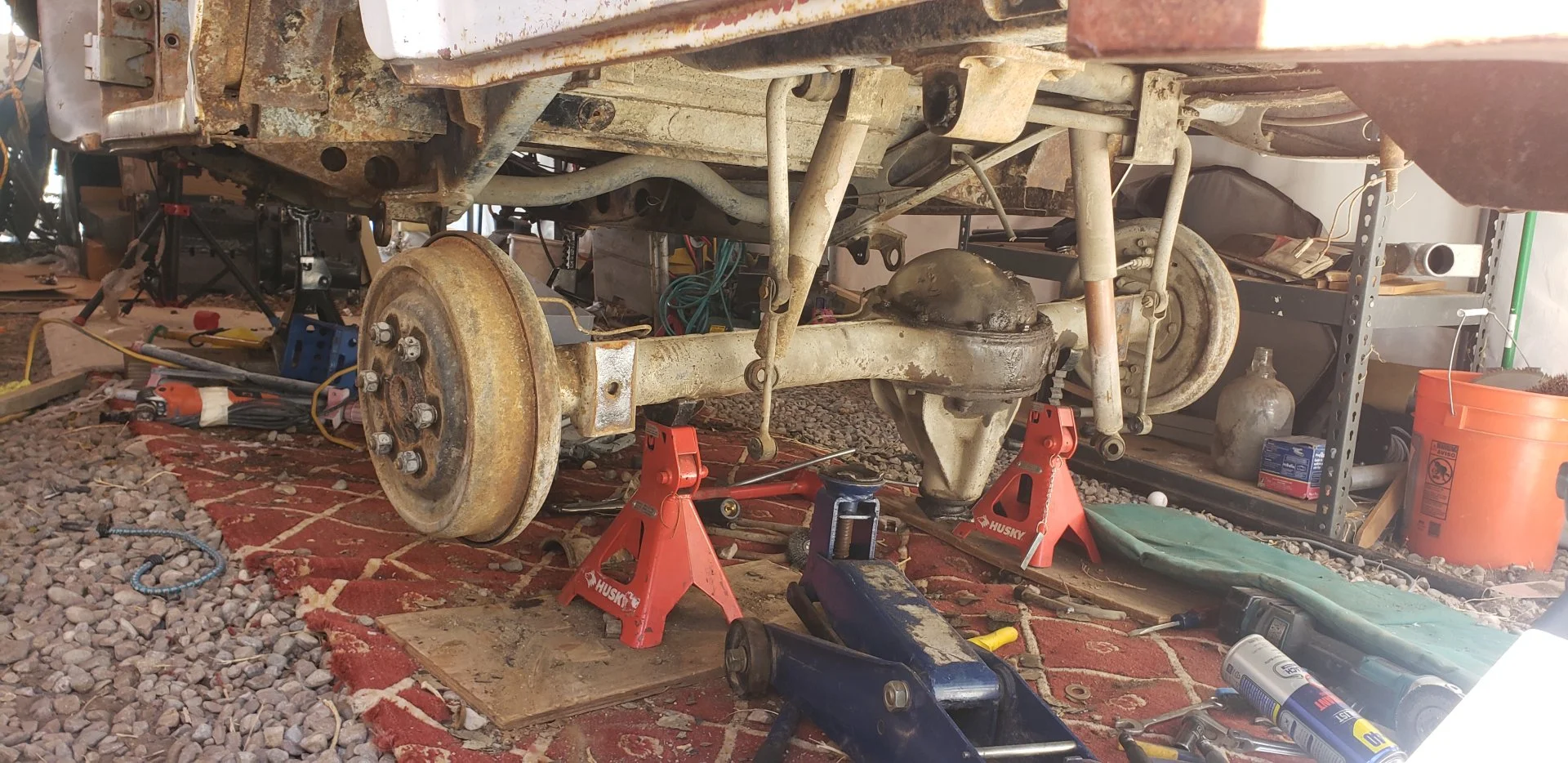

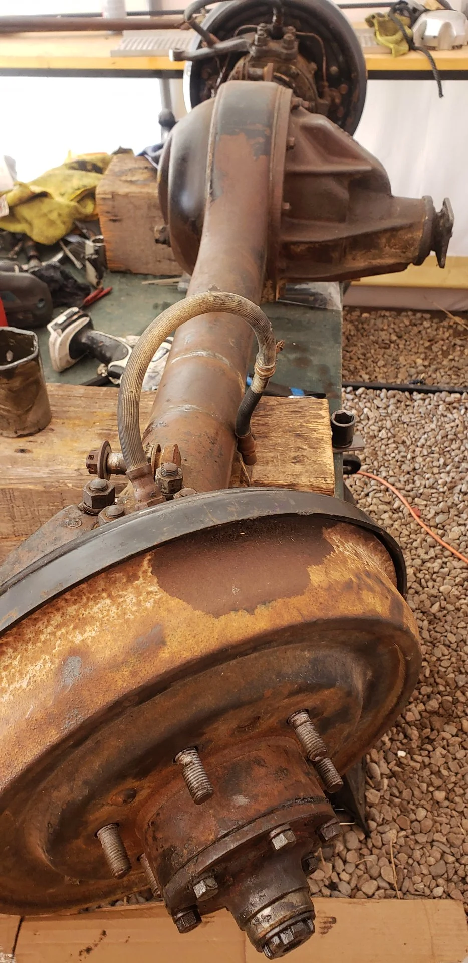

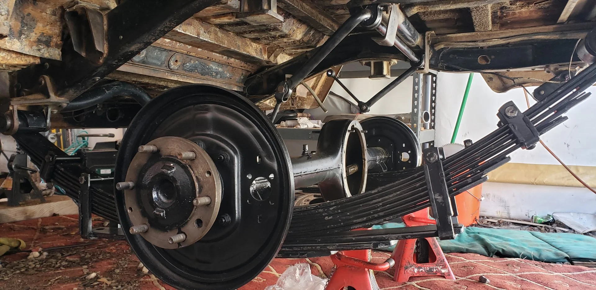

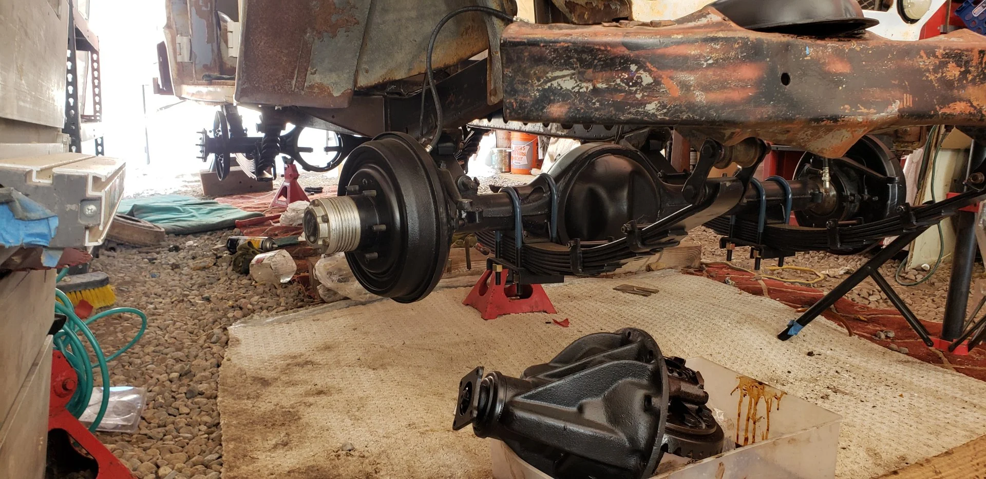

With the "new" axles due in on Tuesday, I took a few hours today to re-assemble the original front axle and pull the rear axle from the car.

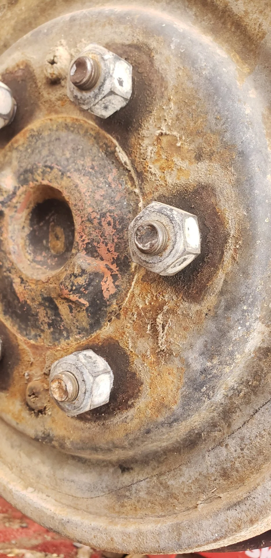

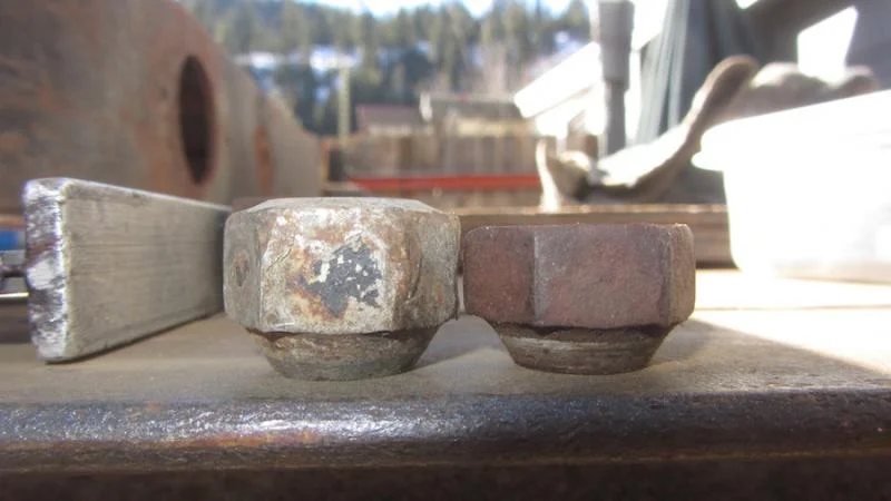

Good questions Ken. Alll I know about them for sure is that they 24mm on this one, all my other Cruiser stuff is 21mm.
I guess that brings up a question about the larger lug nuts.
Was it just early years that had these?
Did all models have them?
Was there a reason for them?
Yes just early years had the 23mm lug nut, Toyota switched to 21mm lug nut in August of 1963.
They were on 20 series Cruisers and FJ40/43/45s. Two different versions also, tall and short. Tall ones are most common, shorts i think were for spare tire, and also used every where on 1959 and earlier Cruisers. My 59 Cruiser had shorts on all wheels, my 60 Cruiser had tall ones on all wheels. Hijack over.
Pure knowledge! Thank you!

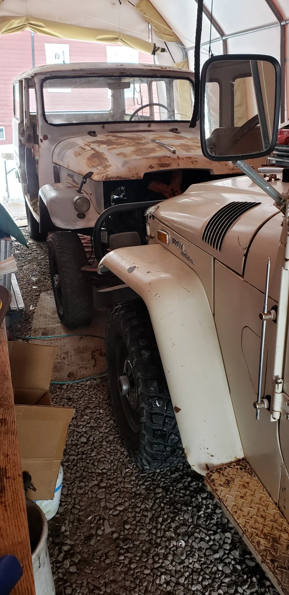

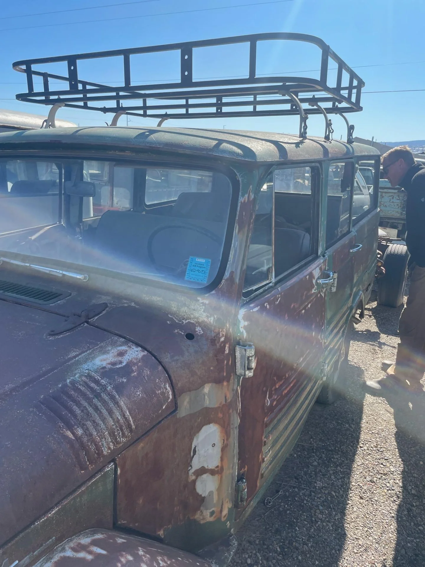

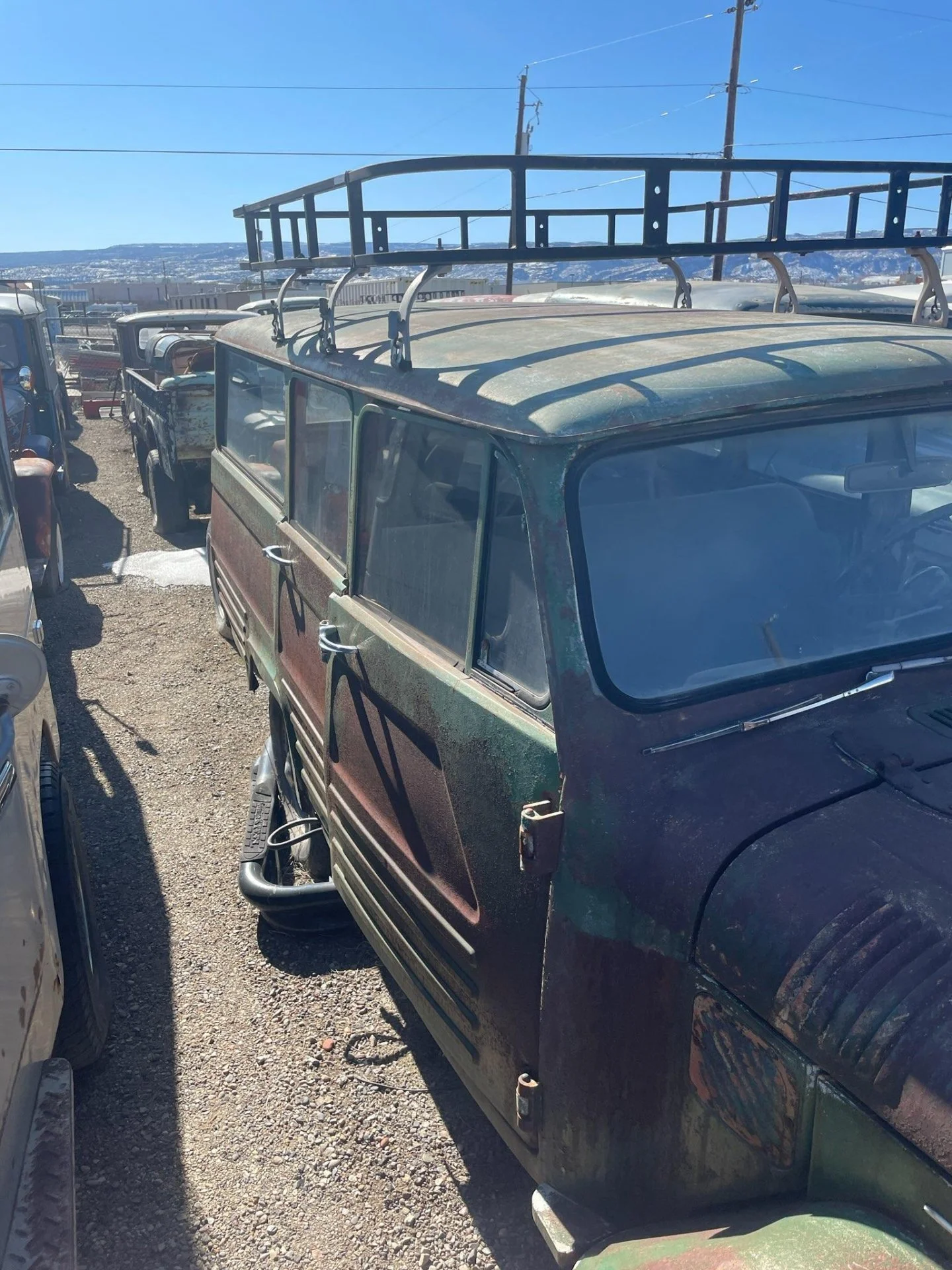

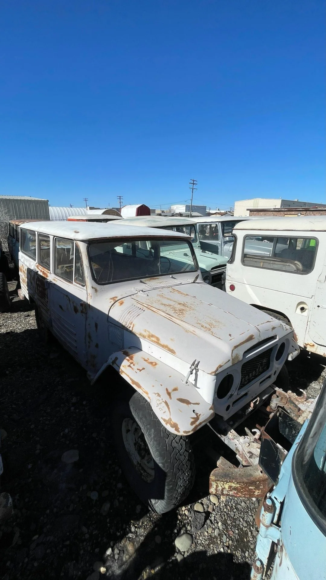

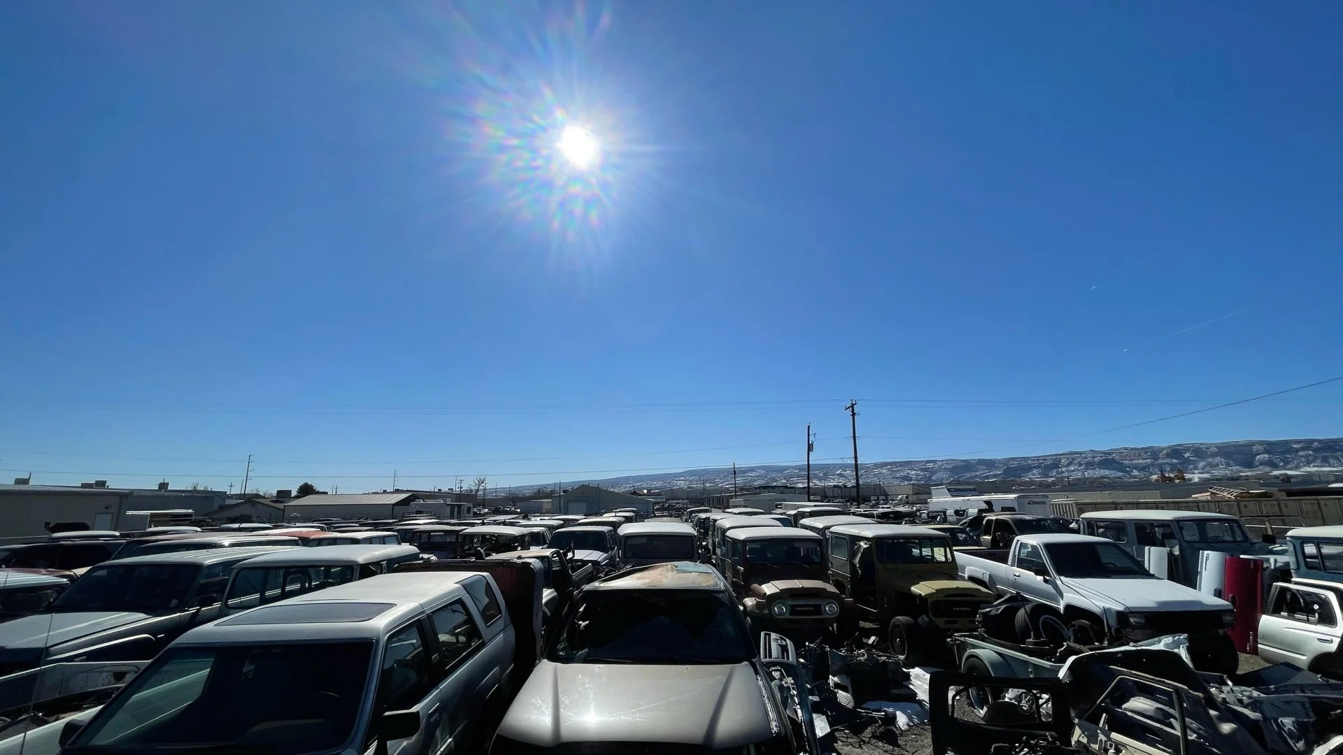

There are 5 LV's available, the 6th one is sold to FJCo and is headed south. One of the LV's has had the VIN scrubbed from the chassis, so it's a parts car. That leaves 4 LV's with VIN's and titles waiting for someone to love them.
I'm not a broker and I have no financial interest in these whatsoever. I simply want to see these things go to some good homes. PM me if you would like to be put in touch with the owner.

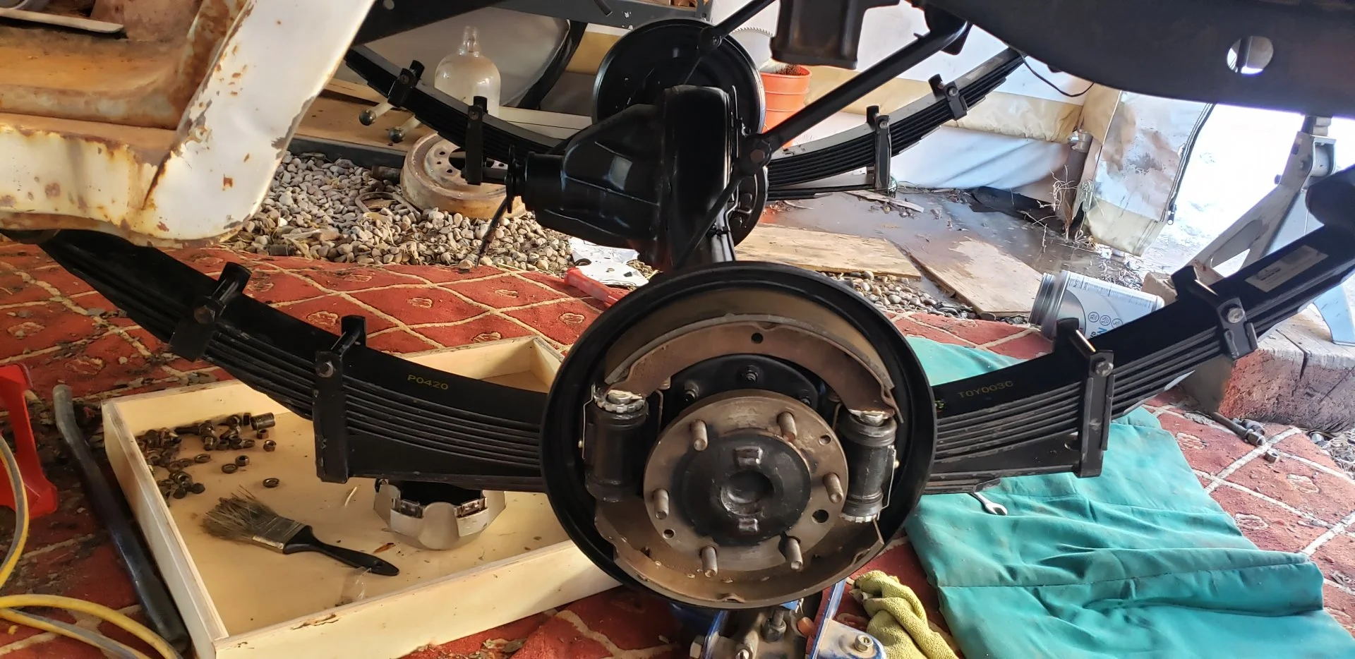

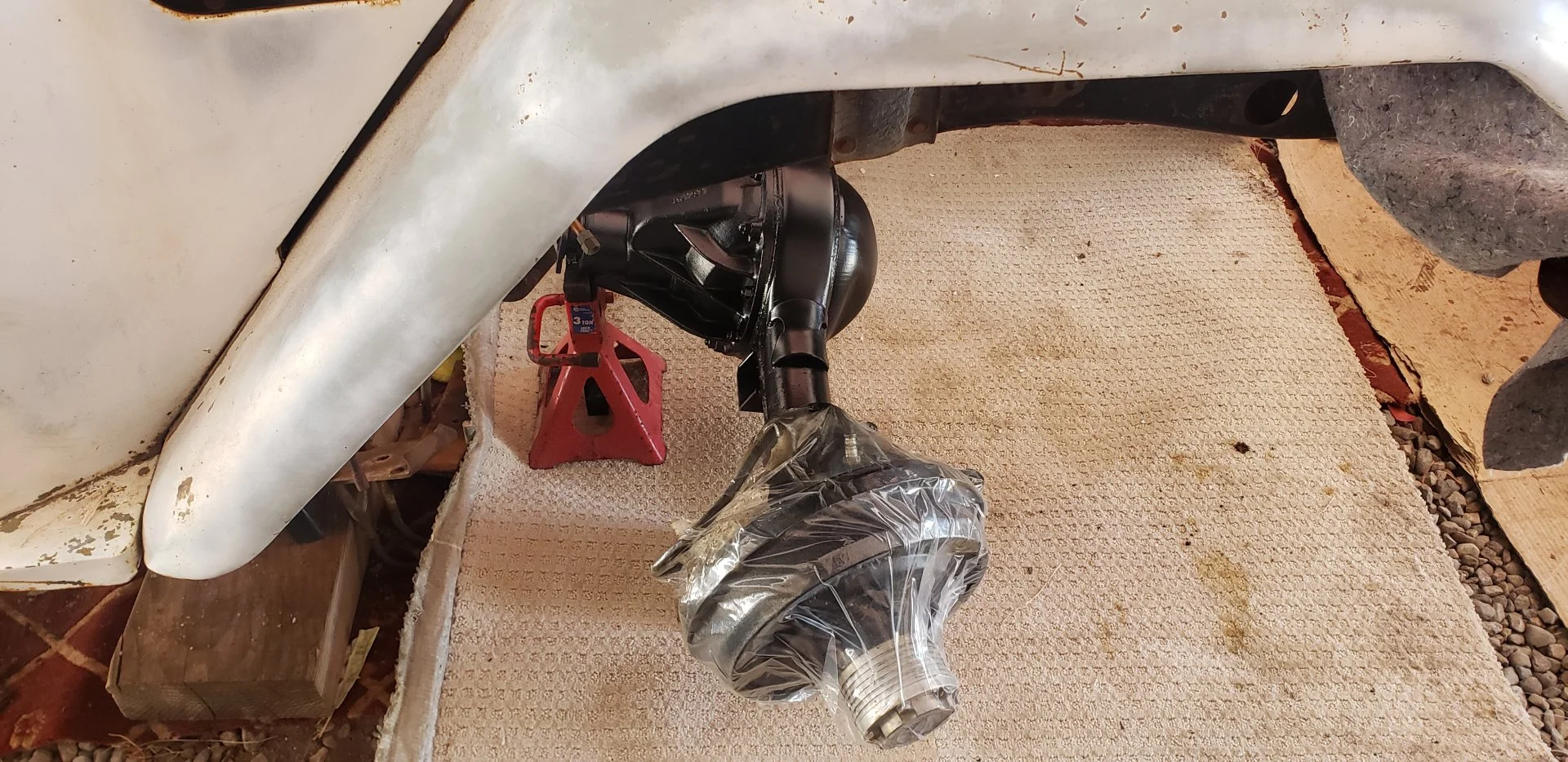

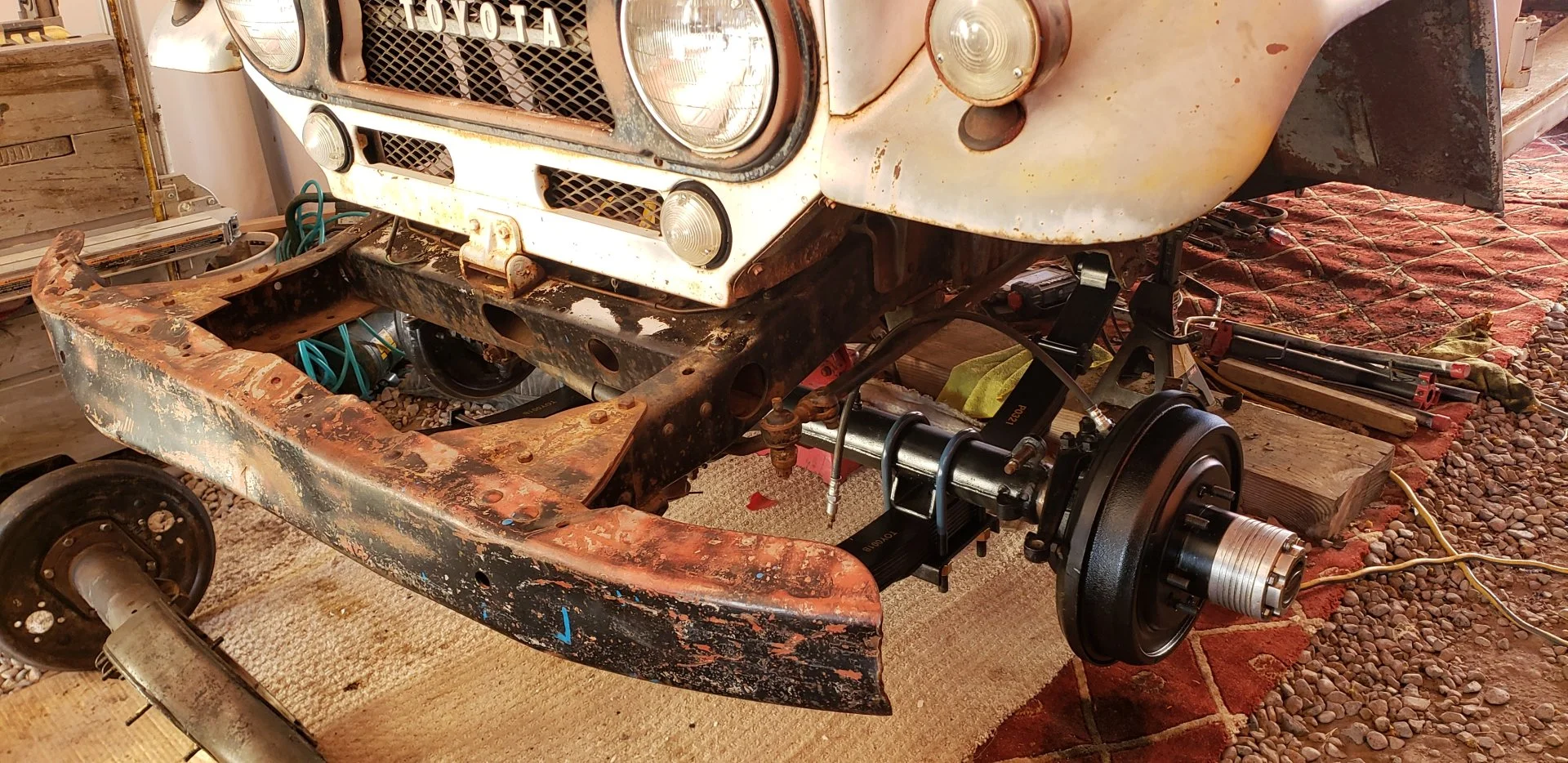

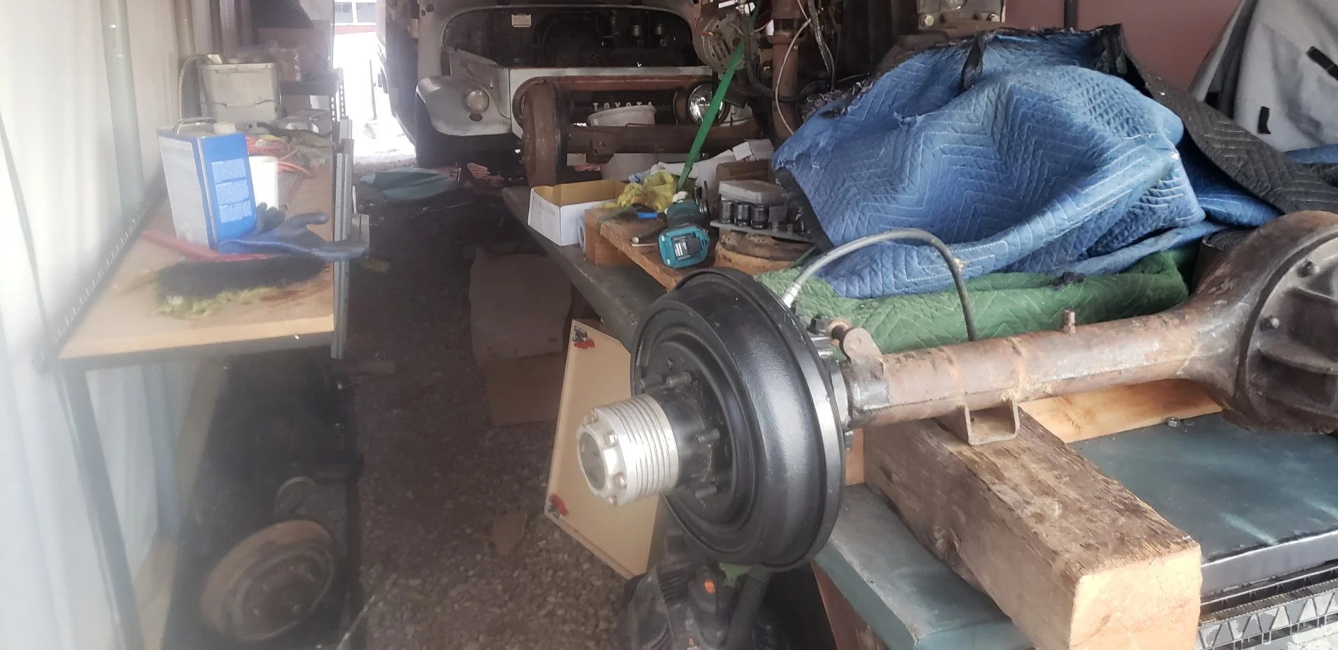

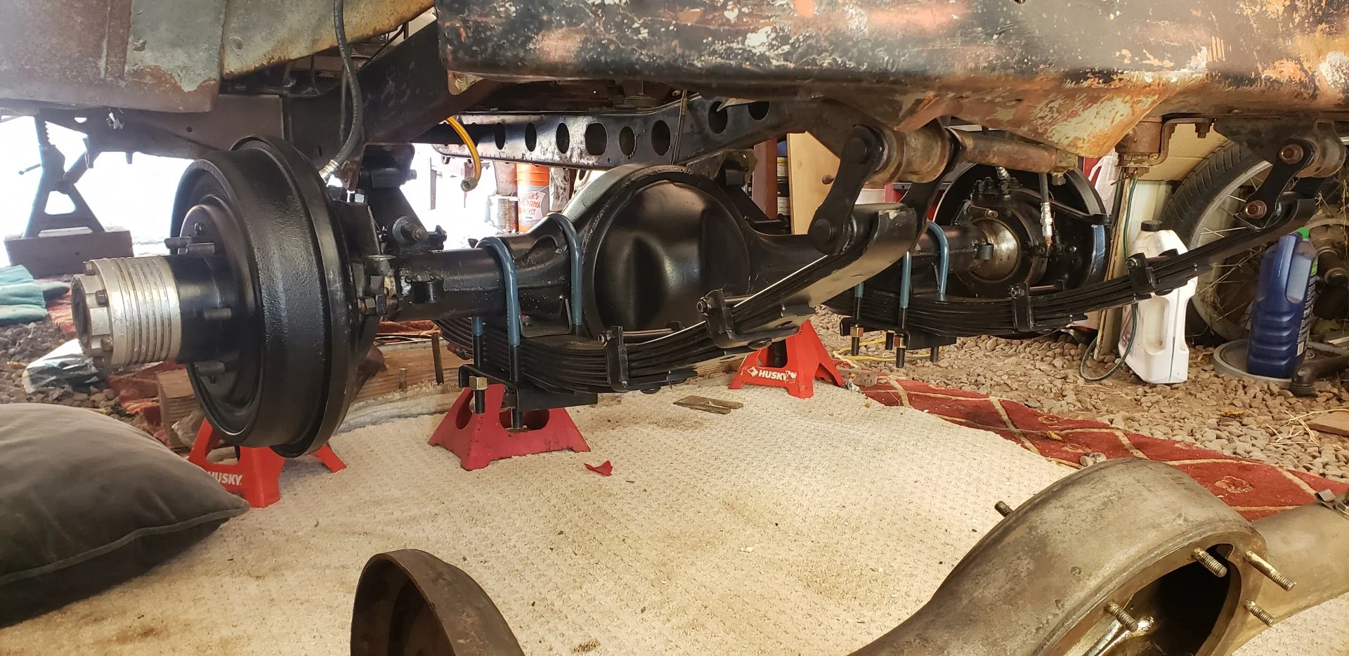

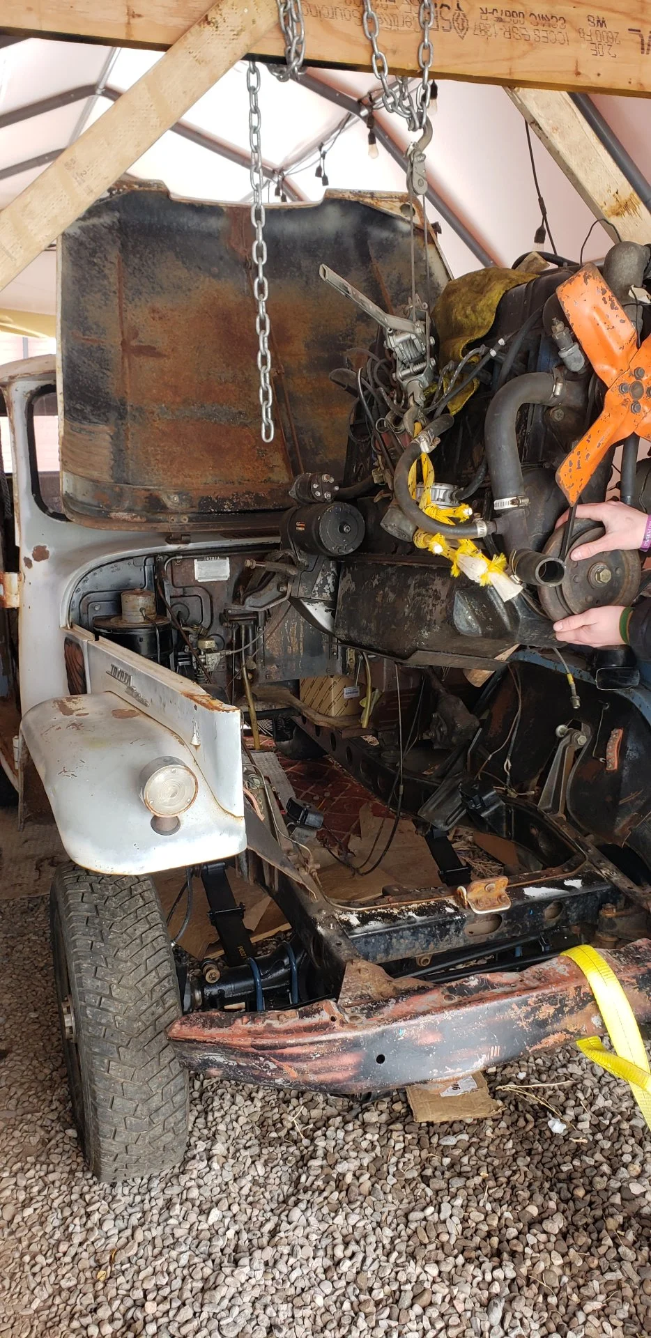

Met up with an all-star cast for breakfast and some parts swapping earlier this week. Always a treat to see each one of these guys, just some really damn good people. Besides myself, there was @greenbeast, @thorslc1977, @riderjgs and @Sunny Sticks all in one place for some great storytelling. Huge thanks to Dennis for bringing me the axles from CA, I've wasted no time tearing into them. Got the front axle stripped, painted and bolted to the truck. Ended up ordering some parts for the rear axle, hopefully installing that next week.

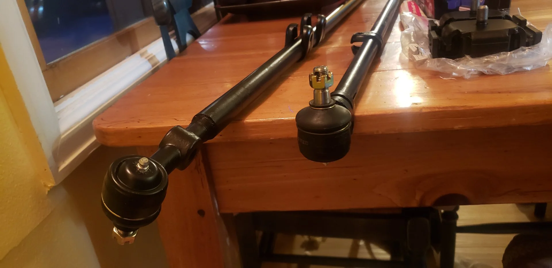

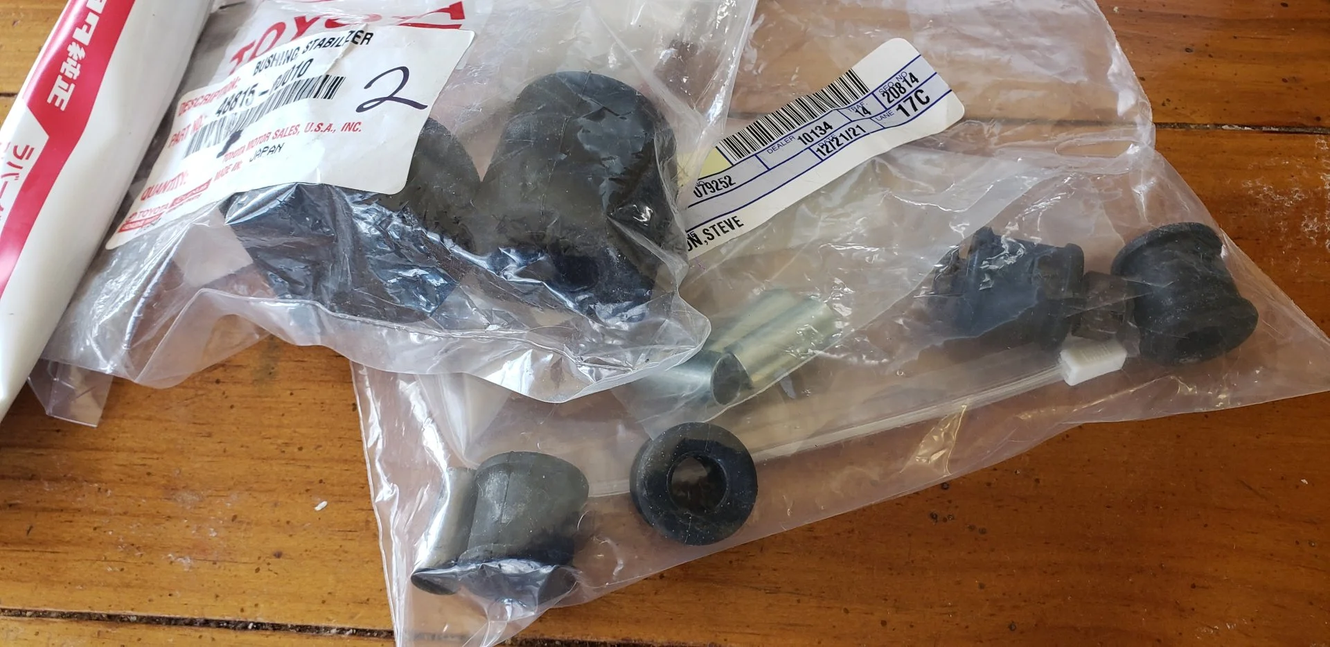

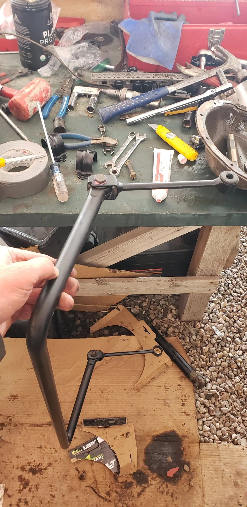

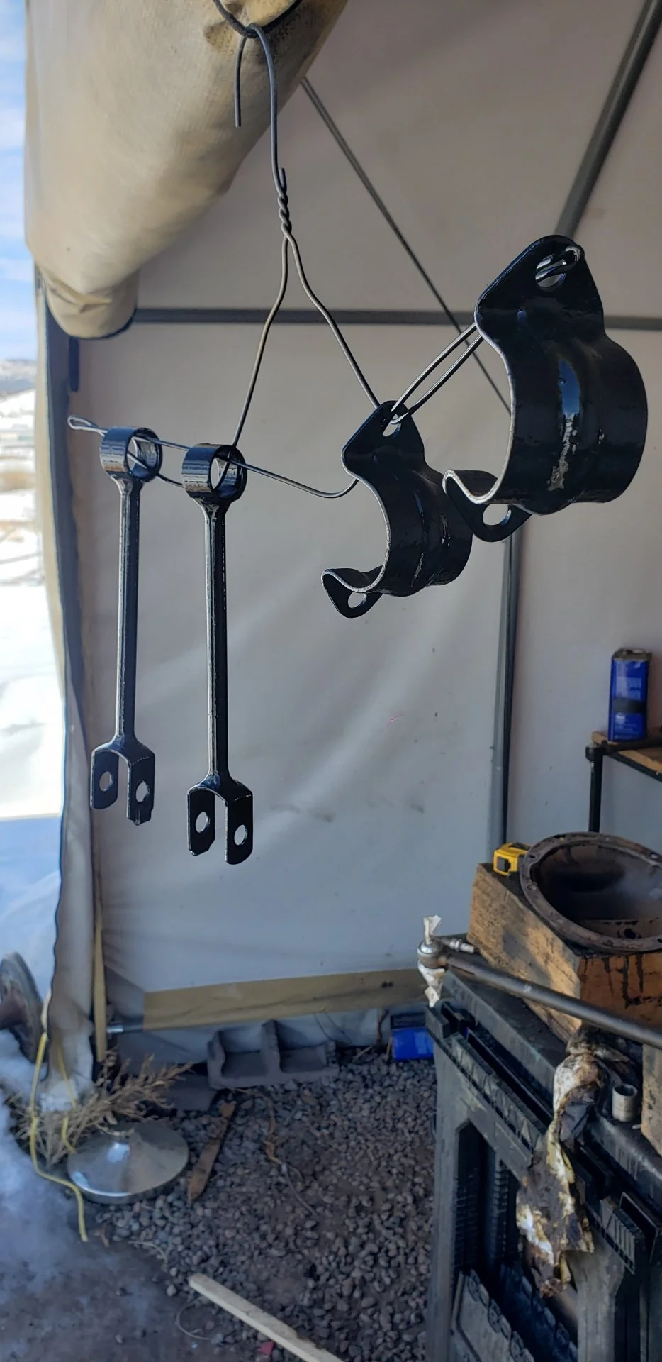

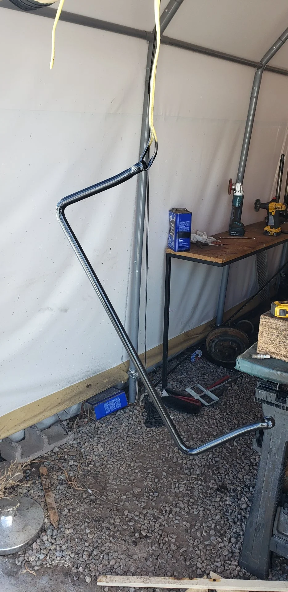

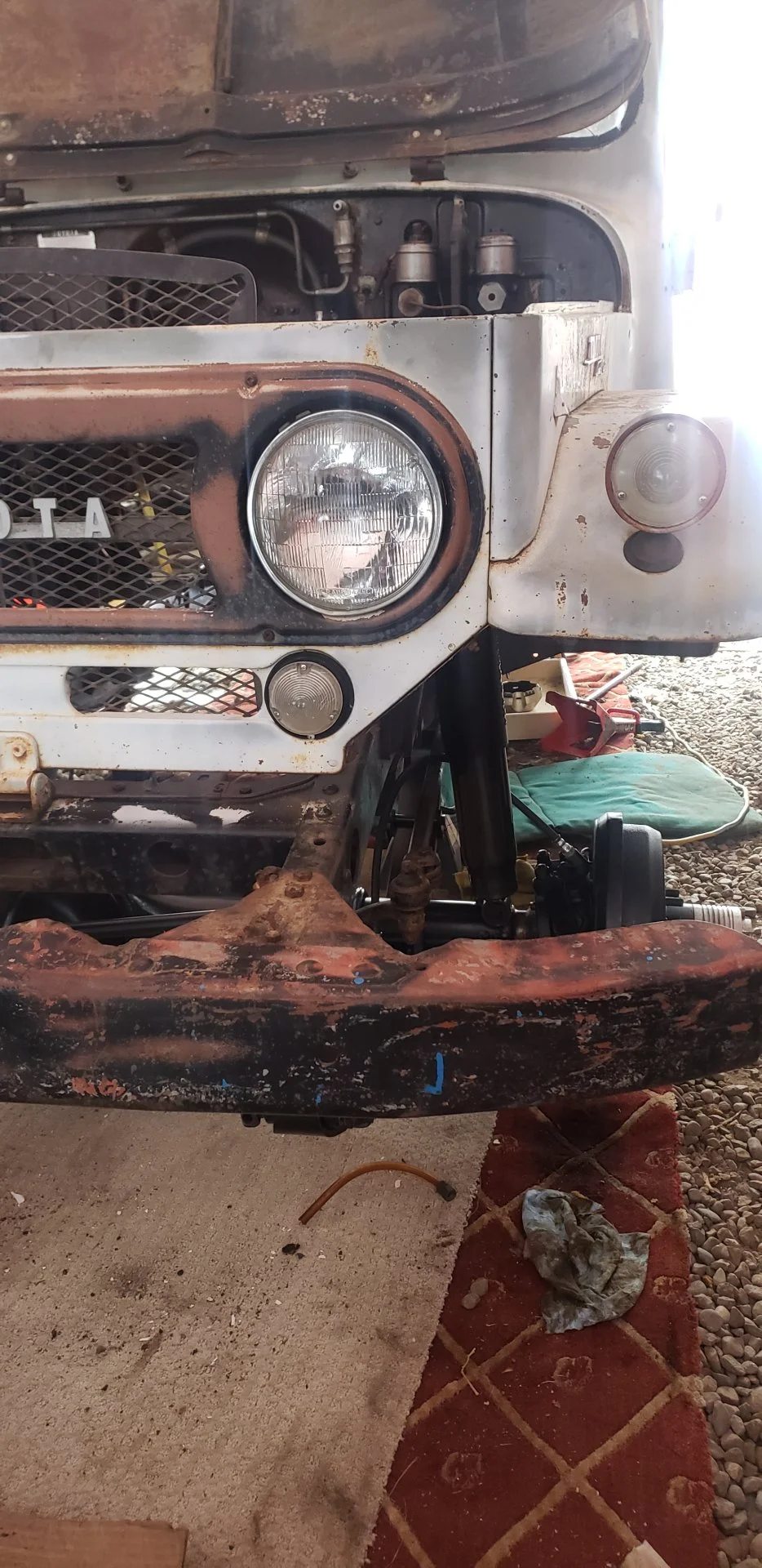

Pulled the sway bar and refinished it, complete with new OEM rubber bushings. Also hit the steering rods with new tie-rod ends and paint.
