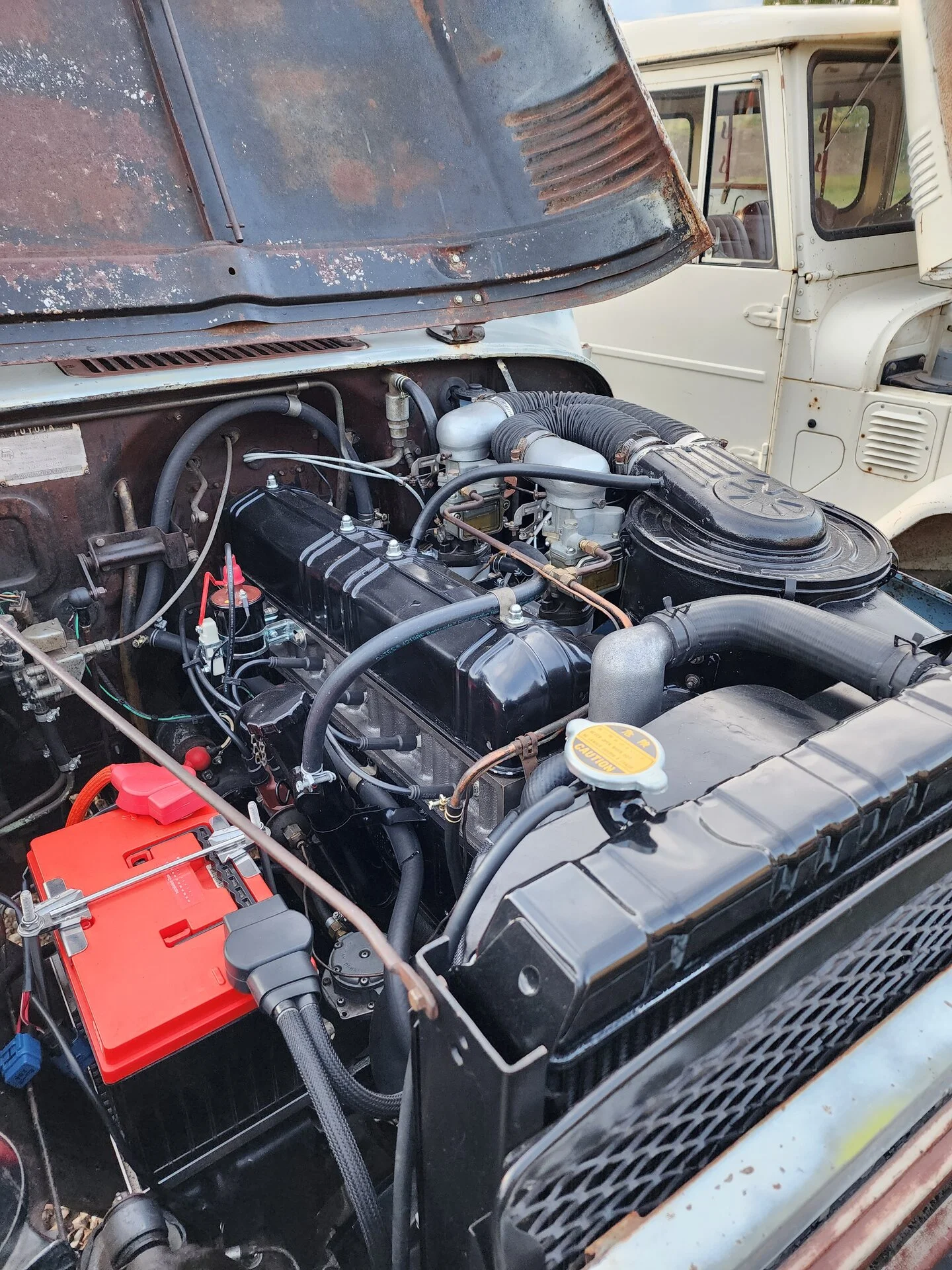

Barely any progress. The most recent chapter has been long and frustrating. I tried to set up an Offenhauser twin-carb intake with a pair of SD40's but after trying several configurations and adjustments it just wasn't right. It was no small task assembling the pieces for the Offy intake, such as a split fuel rail, split air filter, and the dual throttle linkage, all period correct first Gen FJ40 mods. The Offy intake also necessitated that the oil filter housing be re-located. Currently though it's all yanked and sitting on the shelf and it's running the OEM intake.

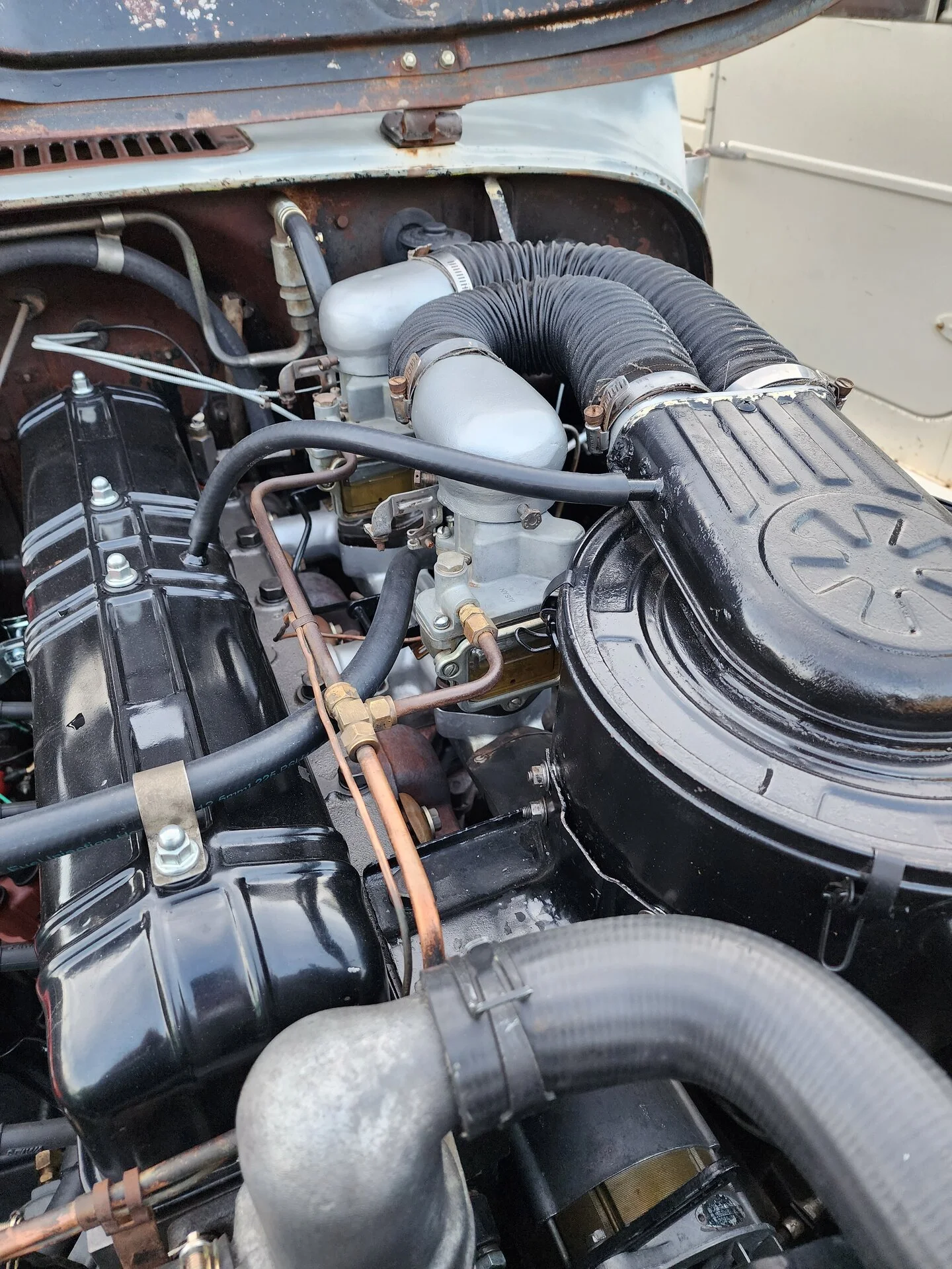

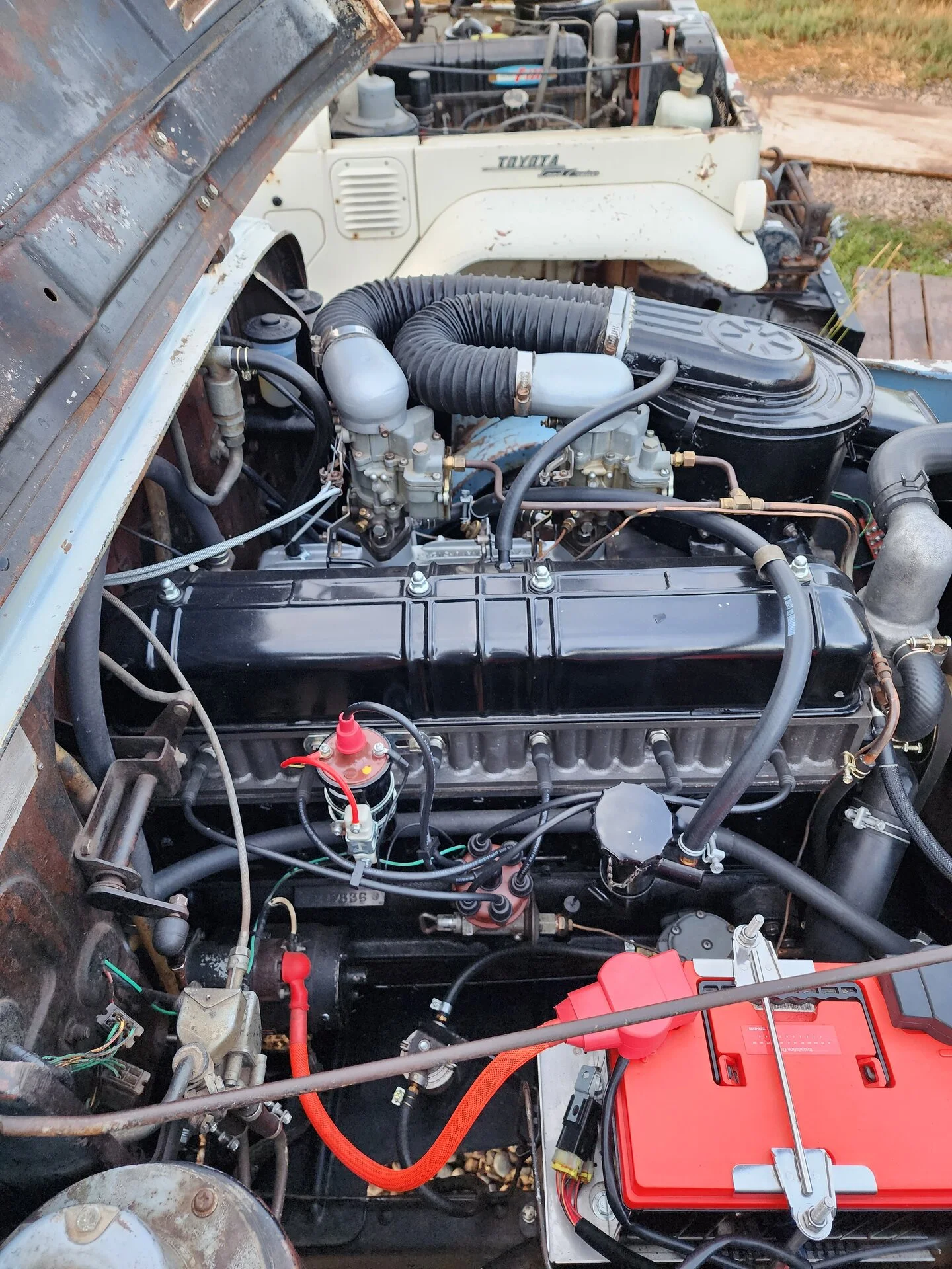

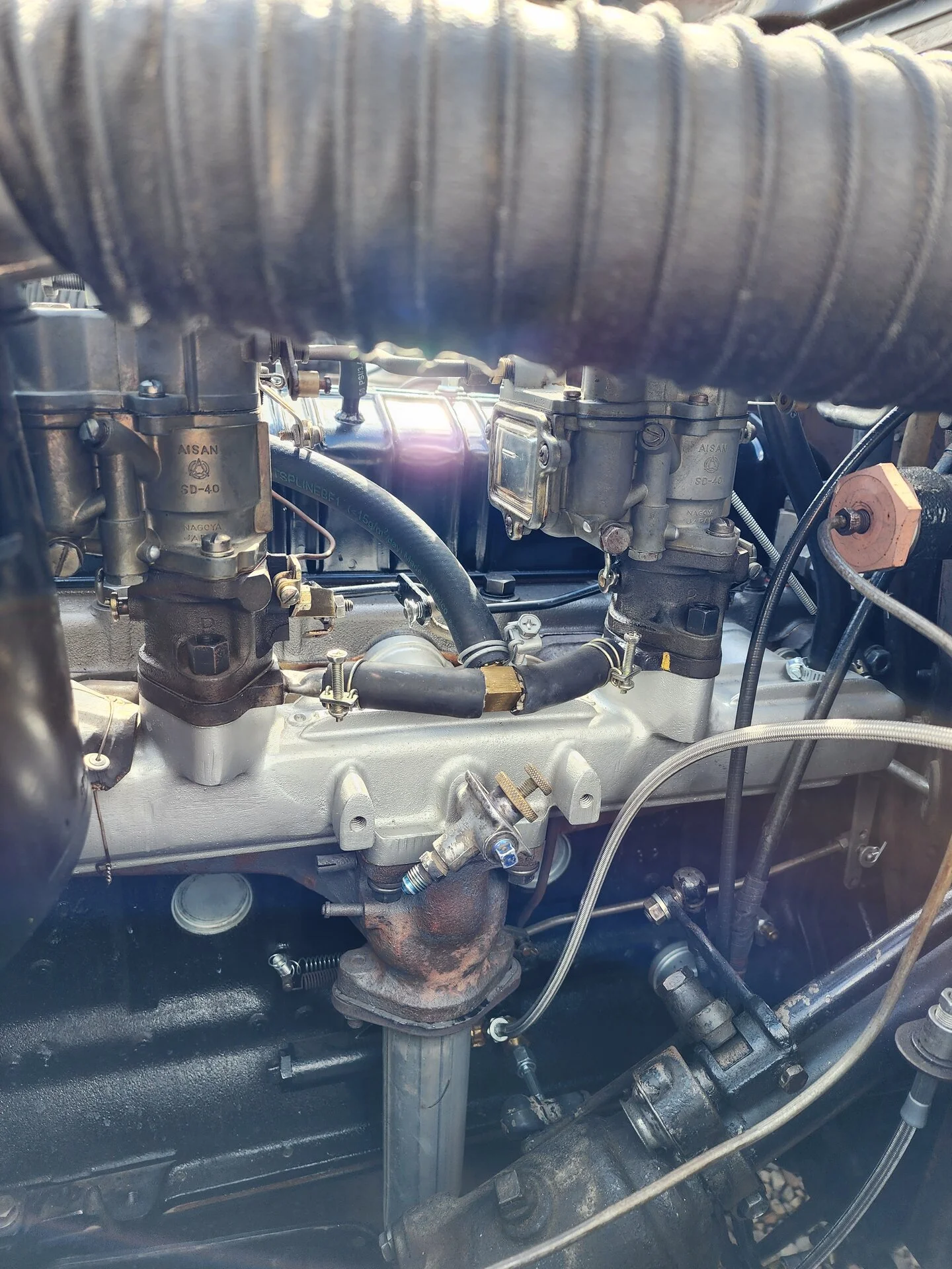

You beat me to using SD40’s in your dually carb setup, mine are sitting on the shelf and I’m still running the Carter WA1’s. Runs pretty good so I haven’t been inclined to swap them out (have to put rebuild kits into the SD40s first as well). But I’m not pushing the rig, just motoring around on dirt roads and the dry ground hills. What is “just not right” alluding to? I think you and I are the only misfits running the dual carb thingy on 1Fs.
Where’d you get the air horn intake adapters for the carbs? I have’t found anything like yours that fits the small 1-barrel carbs. So I’m using individual air filters, with lots of chrome so everything looks really redneck 😂.
Are you pulling dizzy vacuum advance from just one of the carbs? Not sure from first pic but looks like it.
Always thought how cool that would be (and difficult to build), the dual single barrels. I'm curious too what wasnt working? Too hard to dial in? Hesitation? Idle?
