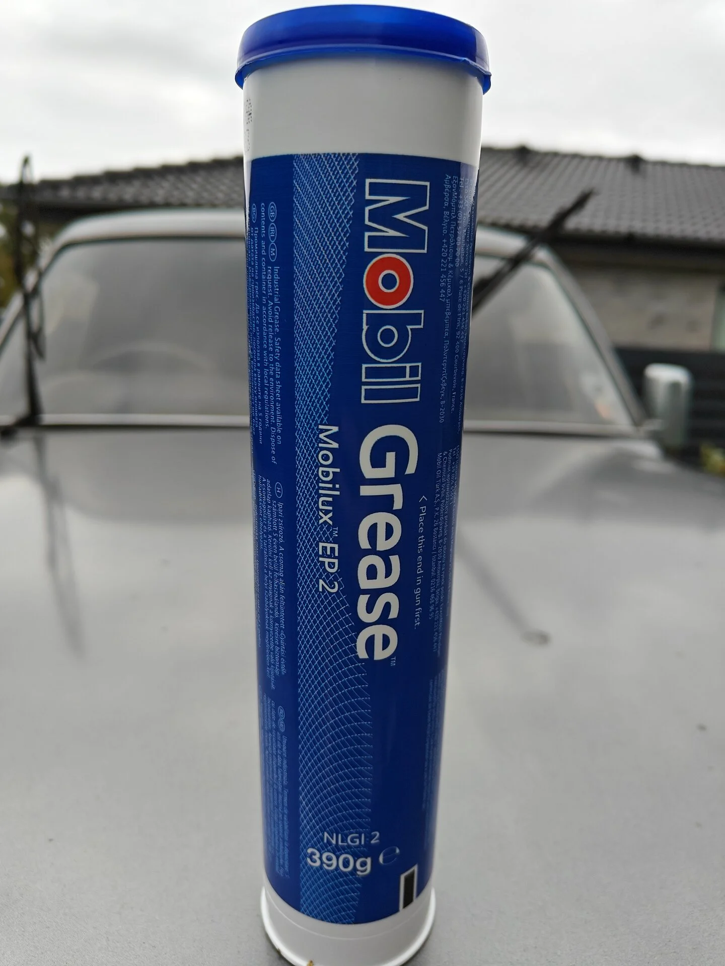

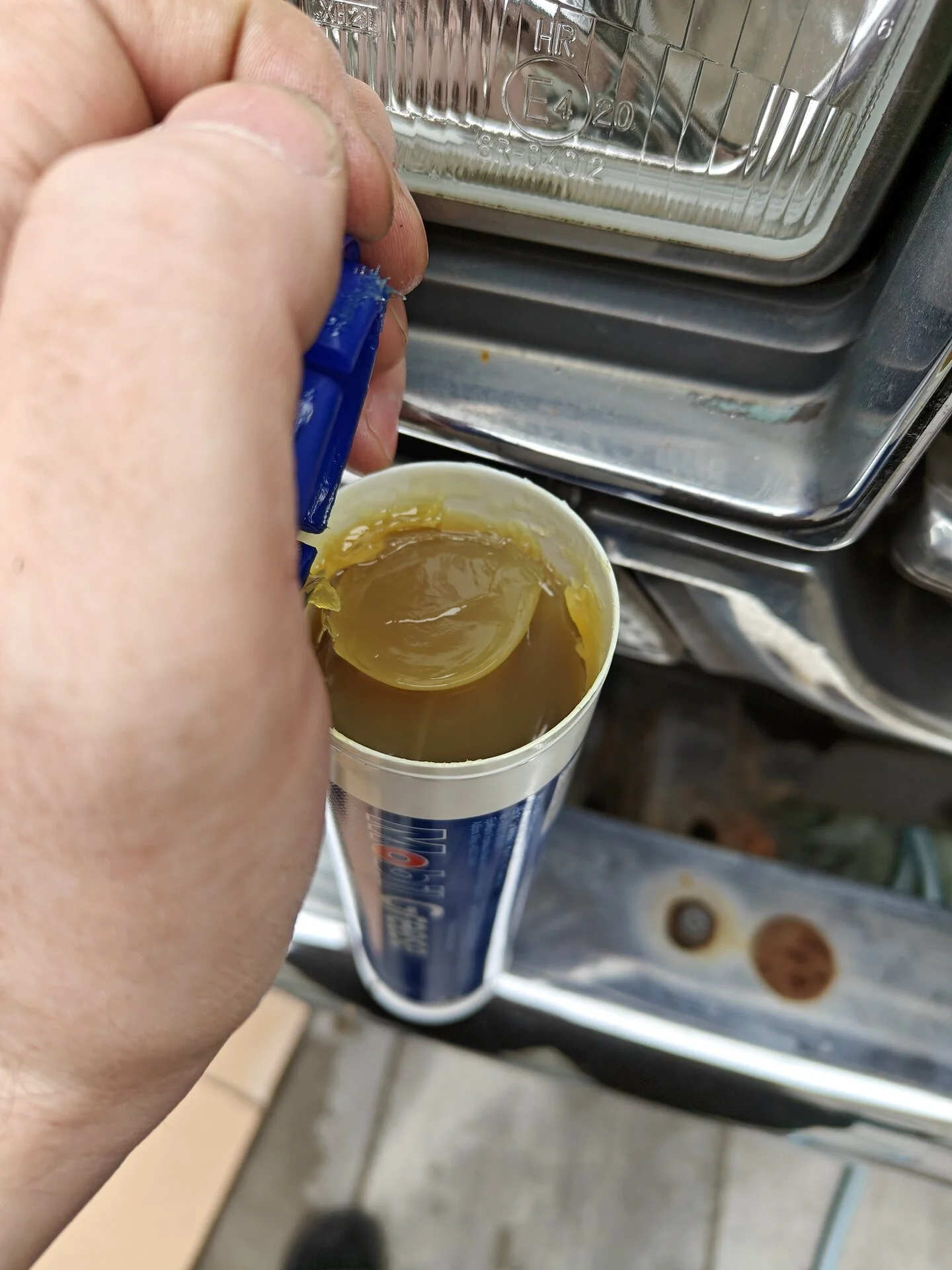

I just bought this stuff thinking it would be grey in colour but it's brown. Can i use this to pack the birf and housing? Has anyone used this before? Does the colour matter?
Color doesn’t matter but the ingredients are super critical.
Whatever old grease is in your knuckle cavity, the new grease needs to be similar. If it’s not, the disimilar greases with mix and LIQUIFY. You’ll get oil oozing out eventually.

What makes it "moly"? This stuff has 3% molybdenum disulfide content, which was the main reason I thought this would do the job
The moly version of the EP2 has moly, I don’t think (I could be wrong) that the version you have has any. Moly is almost always black in some manner. For your application it may or may not even matter
Ok thanks for your help...this is a minefield to the uninitiated 😅
Looking at the Mobil website is confusing: It says Mobil EP2 does have moly. If I google Mobilux EP2 moly the tube you posted turns up, sometimes.
Is there a different flavor that is moly, I can't tell. Generally, any grease that is 'EP' (extreme pressure) has moly and other pressure additives.
Mobil lists it as a general purpose industrial grease. It's probably fine for the birf but I've never used that. I either use Mobil 1 or Red-line, but don't know what's available to you in the Netherlands.
Color doesn't mean anything. Red-Line 5% moly is red.
If grease has moly it will be black, or at least blackish, and more opaque.
