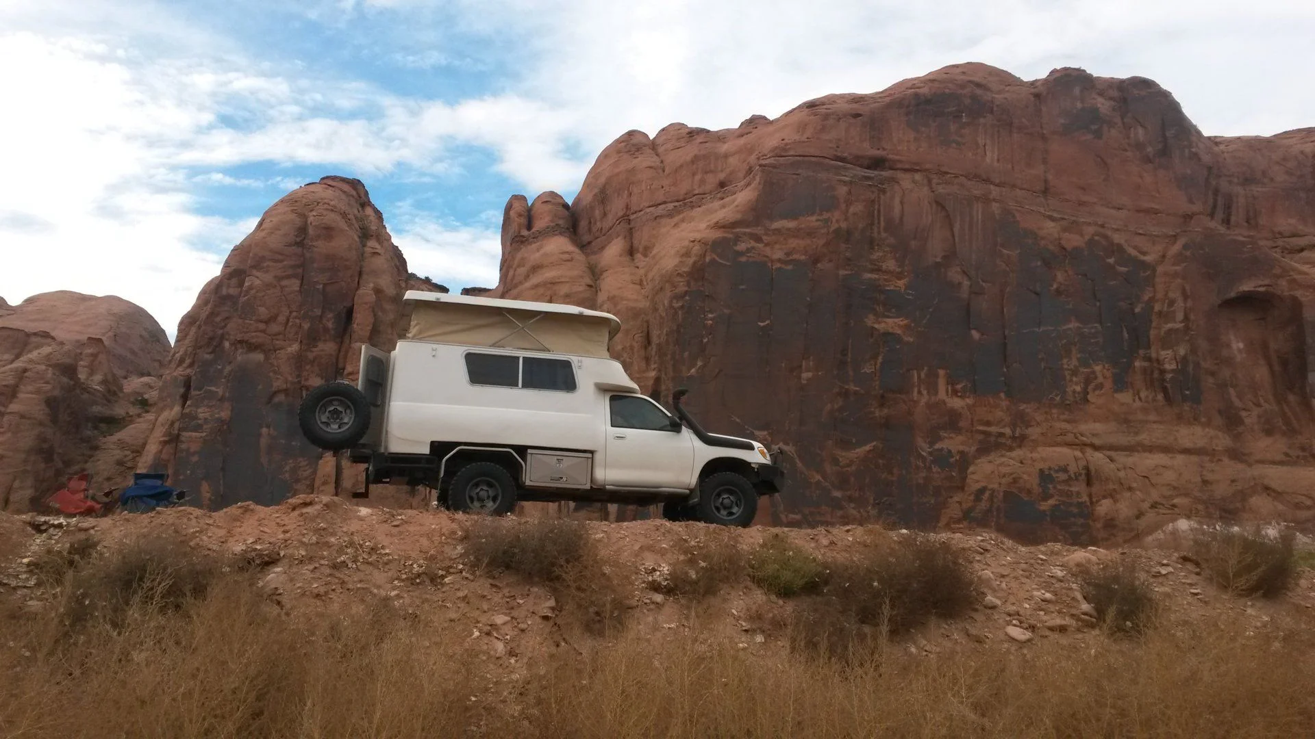

For what you are describing I think a chinook popup is ideal and you can still find them for a decent price. Swap the chinook shell onto a newer chassis and they make a great. Overland rig. My version of this was built on a 01 tundra single cab long bed with 4.7l engine. We love it!
Build here:
[URL="http://www.expeditionportal.com/forum/threads/tunook-build-has-new-life.115353/[/URL]"]www.expeditionportal.com/forum/threads/tunook-build-has-new-life.115353/[/URL]
There is another member in the expedition build thread that built one on a newer tacoma chassis and it turned out nice too.
